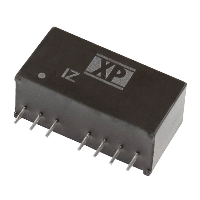

xppower.com Specification Regulated Single & Dual Output • Wide 2:1 Input Range • SIP Package • 1600 VDC Isolation • Continuous Short Circuit Protection • Remote On/Off • 3 Year Warranty Input Voltage Input Input Voltage Range Input Reflected Ripple Current Input Filter • • See table • 35 mA pk-pk through 12 μH inductor and 47 μF capacitor, 5 Hz to 20 MHz • Capacitor No Load(1) Input Current 4.5-9.0 V Output Output Voltage • Minimum Load • Line Regulation • Load Regulation • Setpoint Accuracy • Ripple & Noise • Short Circuit Protection • Cross Regulation • Temperature Coefficient • Remote On/Off See table None(4) ±0.5% max ±1.0% max for a 25-100% load change ±1% max 75 mV pk-pk max, 20 MHz bandwidth Continuous with auto recovery (foldback) ±5% on dual output models(5) 0.02%/C 9.0-18.0 V 18.0-36.0 V • Module "on" if pin 3 is open circuit. Module "off" by driving 3-6mA into pin 3. Maximum applied voltage 9.7VDC relative to -Vin. See below. +Vin 36.0-72.0 V 2 1K 3 3-6mA -Vin IZ 1 65 70 75 75 90 90 90 25 35 35 35 45 45 45 15 15 20 20 20 20 20 10 10 15 15 35 20 20 mA mA mA mA mA mA mA mA mA mA mA mA mA mA mA mA mA mA mA mA mA mA mA mA mA mA mA mA • • • • • • See table 1600 VDC 109Ω 680 pF 100-650 kHz >1.34 MHrs to MIL-HDBK-217F at 25 °C, Operating Temperature • -40 °C to +100 °C, derate from 100% load at +70 °C to 0% load at +100 °C Storage Temperature • -40 °C to +125 °C Case Temperature • +100 °C max Cooling • Convection cooled Safety Safety Approvals 700 600 250 200 ±300 ±125 ±100 700 600 250 200 ±300 ±125 ±100 700 600 250 200 ±300 ±125 ±100 700 600 250 200 ±300 ±125 ±100 mA mA mA mA mA mA mA mA mA mA mA mA mA mA mA mA mA mA mA mA mA mA mA mA mA mA mA mA Max Efficiency Capacitive Load 74% 2200 μF 76% 1000 μF 82% 470 μF 82% 220 μF 77% ±470 μF 81% ±220 μF 82% ±100 μF 76% 2200 μF 81% 1000 μF 84% 470 μF 84% 220 μF 80% ±470 μF 83% ±220 μF 82% ±100 μF 74% 2200 μF 79% 1000 μF 82% 470 μF 84% 220 μF 80% ±470 μF 83% ±220 μF 83% ±100 μF 75% 2200 μF 78% 1000 μF 81% 470 μF 81% 220 μF 78% ±470 μF 80% ±220 μF 81% ±100 μF Model Number(2) IZ0503SA IZ0505SA IZ0512SA IZ0515SA IZ0505S IZ0512S IZ0515S IZ1203SA IZ1205SA IZ1212SA IZ1215SA IZ1205S IZ1212S IZ1215S IZ2403SA IZ2405SA IZ2412SA IZ2415SA IZ2405S IZ2412S IZ2415S IZ4803SA IZ4805SA IZ4812SA IZ4815SA IZ4805S IZ4812S IZ4815S 0.36 (9.20) 0.86 (21.85) 0.42 (10.60) 0.44 (11.10) 0.02 (0.50) 0.12 (3.05) 0.10 (2.54) Environmental 3.3 V 5.0 V 12.0 V 15.0 V ±5.0 V ±12.0 V ±15.0 V 3.3 V 5.0 V 12.0 V 15.0 V ±5.0 V ±12.0 V ±15.0 V 3.3 V 5.0 V 12.0 V 15.0 V ±5.0 V ±12.0 V ±15.0 V 3.3 V 5.0 V 12.0 V 15.0 V ±5.0 V ±12.0 V ±15.0 V Output Current Mechanical Details General Efficiency Isolation Voltage Isolation Resistance Isolation Capacitance Switching Frequency MTBF GB Output Voltage 0.70 (17.78) 0.02 (0.50) 0.13 0.36 (3.20) (9.20) 1 2 3 0.02 (0.50) 5 6 7 8 0.01 (0.25) PIN CONNECTIONS Pin Single Dual 1 -V Input -V Input 2 +V Input +V Input 3 Remote On/Off Remote On/Off 5 N.C. N.C. 6 +V Output +V Output 7 -V Output Common 8 NC -V Output Bottom View • UL60950-1, CAN/CSA C22.2 No.60950-1, UL62368-1, CE & UKCA meets all applicable directives & legislation Notes 1. Measured at nominal input voltage. 2. Minimum load of 25% required to meet load regulation & ripple & noise specifications. 3. Operation at no load will not damage the part but it may not meet all specifications. 4. When one output is set to 100% load and the other varies between 25-100% load. 5. Pin pitch tolerance: ±0.014 (±0.35) 6. Case tolerance: ±0.02 (±0.5) 7. Weight: SIP 0.009 lbs (3.9 g), DIP 0.013 lbs (5.9 g) 8. All dimensions in inches (mm) 23 Sept 2021 DC-DC 3 Watts IZ Series
