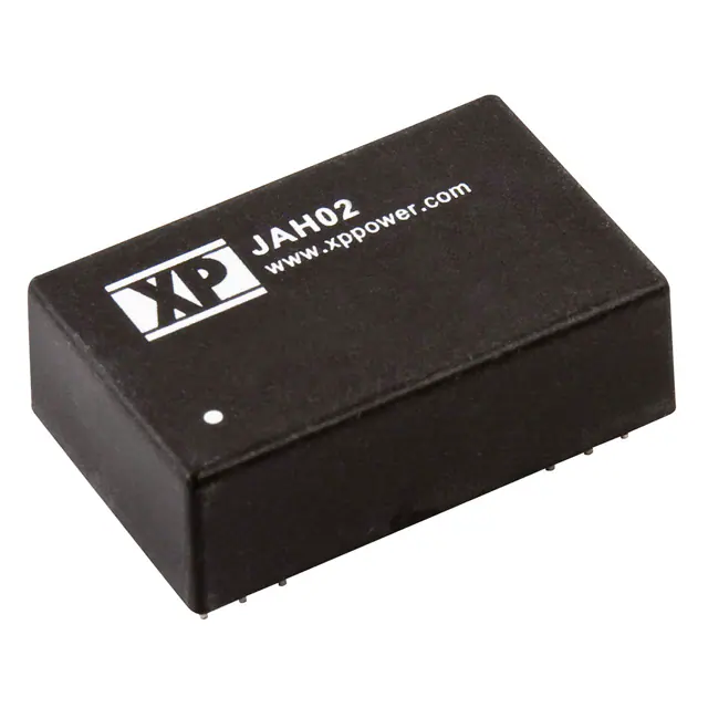

DC-DC 2 Watts xppower.com JAH Series • Low Cost • DIP-24 Package • Operating Temperature -40 °C to +100 °C • Single & Dual Outputs • Optional Metal Case • Optional Isolation to 6000 VDC • 3 Year Warranty Specification Input Input Voltage Range Input Current Input Filter Input Reverse Voltage Protection Undervoltage Lockout Input Reflected Ripple Input Surge General • • • • Nominal ±10% See table Pi network None • None • 35 mA pk-pk through 12 μH inductor, 5 Hz to 20 MHz • 5 V models 7 VDC for 100 ms 12 V models 15 VDC for 100 ms 24 V models 28 VDC for 100 ms Output Output Voltage Minimum Load Initial Set Accuracy Start Up Delay Start Up Rise Time Line Regulation Load Regulation • • • • • • • Cross Regulation Transient Response • • Ripple & Noise • See table No minimum load required ±2% max 20 ms typical 20 ms typical ±0.5% max ±0.5% max single & dual models (±1.0% max for 3V3 versions) (see note 6) ±5% on dual output models (see note 4) ±3% max deviation (±5% for 3V3 output), recovery to within 1% in 2 ms for a 50% load change 75 mV pk-pk measured with 20 MHz bandwidth Output shuts down with auto recovery See tables Short Circuit Protection • Maximum Capacitive • Load Temperature • ±0.02/°C max Coefficient Efficiency Isolation • See tables • 1000 VDC input to output, for optional high isolation versions up to 6000 VDC input to output (see note 1) 60s test. 1000 VDC input to case 1000 VDC output to case Isolation Resistance Switching Frequency • 109Ω • 40 kHz typical singles, 300 kHz typical duals • 5.21 W/in3 • >3 MHrs to MIL-HDBK-217F at 25 °C, GB Power Density MTBF Environmental Operating Temperature • -40 °C to +100 °C, derate from 100% load at +85 °C to no load at +100 °C Case Temperature • +100 °C max Storage Temperature • -40 °C to +125 °C Humidity • Up to 90%, non-condensing Cooling • Natural convection EMC & Safety Emissions ESD Immunity EFT/Burst Surge Conducted Immunity Magnetic Fields Safety Approvals • EN55032 class A, conducted & radiated with external components (see Application Notes) • EN61000-4-2, level 3, Perf Criteria A • EN61000-4-4, level 3, Perf Criteria A (see note 5) • EN61000-4-5, installation class 2, Perf Criteria A (see note 5) • EN61000-4-6, 10 Vrms, Perf Criteria A • EN61000-4-8, 1 A/m, Perf Criteria A • CE (Meets all applicable directives), UKCA (Meets all applicable legislation) Input Voltage Output Voltage Output Current 5V 3.3 V 5.0 V 9.0 V 12.0 V 15.0 V 24.0 V ±3.3 V ±5.0 V ±9.0 V ±12.0 V ±15.0 V ±24.0 V 500 400 222 166 133 83 ±300 ±200 ±111 ±83 ±67 ±42 mA mA mA mA mA mA mA mA mA mA mA mA 75 75 75 75 75 75 30 30 40 40 40 50 mA mA mA mA mA mA mA mA mA mA mA mA 622 615 597 571 588 615 638 588 571 571 571 579 mA mA mA mA mA mA mA mA mA mA mA mA 330 330 330 330 330 330 ±1000 ±1000 ±470 ±470 ±470 ±220 12 V 3.3 V 5.0 V 9.0 V 12.0 V 15.0 V 24.0 V ±3.3 V ±5.0 V ±9.0 V ±12.0 V ±15.0 V ±24.0 V 500 400 222 166 133 83 ±300 ±200 ±111 ±83 ±67 ±42 mA mA mA mA mA mA mA mA mA mA mA mA 70 70 70 70 70 70 20 20 20 20 35 35 mA mA mA mA mA mA mA mA mA mA mA mA 245 260 245 238 252 256 250 228 222 213 216 219 mA mA mA mA mA mA mA mA mA mA mA mA 24 V 3.3 V 5.0 V 9.0 V 12.0 V 15.0 V 24.0 V ±3.3 V ±5.0 V ±9.0 V ±12.0 V ±15.0 V ±24.0 V 500 400 222 166 133 83 ±300 ±200 ±111 ±83 ±67 ±42 mA mA mA mA mA mA mA mA mA mA mA mA 25 mA 25 mA 25 mA 25 mA 25 mA 25 mA 15 mA 15 mA 15 mA 15 mA 20 mA 20 mA 120 132 132 122 122 122 121 114 111 104 108 111 mA mA mA mA mA mA mA mA mA mA mA mA Input Current(2) No Load Full Load Maximum Capacitive Load Efficiency Model Number(1,3) μF μF μF μF μF μF μF μF μF μF μF μF 53% 65% 67% 70% 68% 65% 62% 68% 70% 70% 70% 69% JAH0205S3V3 JAH0205S05 JAH0205S09 JAH0205S12 JAH0205S15 JAH0205S24 JAH0205D03 JAH0205D05 JAH0205D09 JAH0205D12 JAH0205D15 JAH0205D24 330 330 330 330 330 330 ±1000 ±1000 ±470 ±470 ±470 ±220 μF μF μF μF μF μF μF μF μF μF μF μF 56% 64% 68% 70% 66% 65% 66% 73% 75% 78% 77% 76% JAH0212S3V3 JAH0212S05 JAH0212S09 JAH0212S12 JAH0212S15 JAH0212S24 JAH0212D03 JAH0212D05 JAH0212D09 JAH0212D12 JAH0212D15 JAH0212D24 330 330 330 330 330 330 ±1000 ±1000 ±470 ±470 ±470 ±220 μF μF μF μF μF μF μF μF μF μF μF μF 57% 63% 63% 68% 68% 68% 68% 73% 75% 80% 77% 75% JAH0224S3V3 JAH0224S05 JAH0224S09 JAH0224S12 JAH0224S15 JAH0224S24 JAH0224D03 JAH0224D05 JAH0224D09 JAH0224D12 JAH0224D15 JAH0224D24 Notes 1. For optional 3000 VDC isolation add suffix ‘-H’ to model number. For optional 4000 VDC isolation add suffix ‘-H4’ to model number. For optional 5000 VDC isolation add suffix ‘-H5’ to model number. For optional 6000 VDC isolation add suffix ‘-H6’ to model number. 2. Input current measured at nominal input voltage. 3. For optional metal case add suffix ‘-M’. Metal case is only an option up to 3000 VDC isolation versions eg. JAH0212S15-HM. 4. Cross regulation is ±5% when one output is at 100% and the other is varied between 25% and 100%. 5. A 220 μF/250 V capacitor across the input is required in order to meet EN61000-4-4 and EN61000-4-5. 6. Dual output regulation is specified with a balanced load. Mechanical Details PIN CONNECTIONS Pin Single Dual Single -H Dual -H 1 +Vin +Vin +Vin +Vin 2 N.C. -Vout +Vin +Vin 3 N.C. Common N.P N.P 10 -Vout Common N.P Common 11 +Vout +Vout N.P Common 12 -Vin -Vin -Vout N.P 13 -Vin -Vin +Vout -Vout 14 +Vout +Vout N.P N.P 15 -Vout Common N.P +Vout 22 N.C. Common N.P N.P 23 N.C. -Vout -Vin -Vin 24 +Vin +Vin -Vin -Vin N.P : No Pin 0.01 (0.25) 1.25 (31.75) N.C : No Connection Notes 1. All dimensions are in inches (mm) 2. Weight: Plastic Case: 0.028 lbs (12.5 g), Metal Case: 0.033 lbs (15.0 g) 3. Pin diameter: 0.02±0.002 (0.5±0.05) 4. Pin pitch tolerance: ±0.014 (±0.35) 5. Case tolerance: ±0.02 (±0.5) 0.90 (22.86) 1 2 3 10 11 12 Bottom View 0.80 (20.32) 24 23 22 0.60 (15.24) 15 14 13 0.02 (0.50) 0.20 (5.08) 0.40 (10.16) 0.12 (3.05) Min. Application Notes Input Filter +Vout +Vin + L1 C1 - DC/DC Converter -Vin Single Output Models Load Dual Output Models C1 L1 C1 L1 220 μF/100 V 12 μH 220 μF/100 V 22 μH -Vout 29 Sept 2021 DC-DC JAH02 Models and Ratings
JAH0212S09
物料型号:JAH系列
器件简介:JAH系列是2瓦特DC-DC转换器,具有高效率和高功率密度的特点,适用于关键系统。
引脚分配:文档提供了单输出和双输出模型的引脚连接图,包括输入电压、输出电压、地和控制引脚。
参数特性:包括输入电压范围、输入电流、最小负载、初始设置精度、启动延迟、线路调节、负载调节、交叉调节、瞬态响应、纹波和噪声、短路保护等。
功能详解:JAH系列提供单输出和双输出模型,具有高隔离电阻、高效率、高MTBF(平均故障间隔时间),并提供3年保修。
应用信息:适用于关键系统,如军事、航空航天、医疗设备等。
封装信息:提供DIP-24封装,可选金属外壳,最高工作温度可达+100°C。
