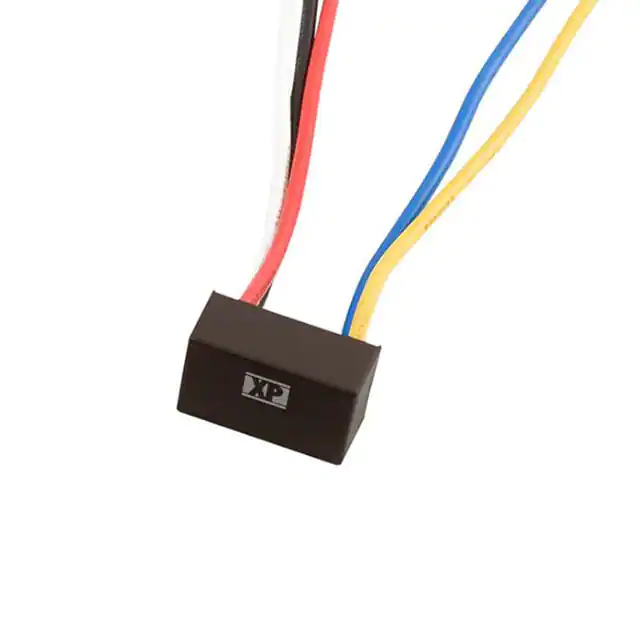

DCDC LED Driver LDU Series xppower.com • Constant Current Output • LED Drive Current up to 1000 mA • LED Strings from 2 V to 57 V • PWM & Analog Dimming Control • High Efficiency  up to 95% • Open or Short Circuit LED Protection • 3 Year Warranty Specification Input Input Voltage Input Filter Input Surge General • LDU08 & 24: 7-30 VDC LDU48: 7-60 VDC • Capacitor • LDU08 & 24: 40 VDC for 0.5 s LDU48: 65 VDC for 0.5 s Efficiency Switching Frequency MTBF Output • See tables (Vin must be at least 2 V greater than Vout) Output Current • See tables Output Current Trim • 25-100% Output Current • LDU08: ±6.0% max Accuracy LDU24: ±8.0% max LDU48: ±8.0% max Ripple & Noise • LDU08: 200 mV pk-pk max LDU24: 250 mV pk-pk max (except 1000 mA units: 300 mV pk-pk max) LDU48: See tables measured with 20 MHz bandwidth Short Circuit Protection • Current is limited to the rated output Temperature • LDU08: ±0.03%/°C max Coefficient LDU24: ±0.08%/°C max LDU48: ±0.03%/°C max Remote On/Off • On = 0.3-1.25 V or open circuit Off = ≤0.15 V (applied to control pin) LDU08 & 24: Quiescent input current is 25 µA max, LDU48: Quiescent input current is 100 µA max Remote On/Off Signal • 1 mA max Current Output Voltage Dimming PWM Output Current Range Operating Frequency On Time Off Time Amplitude • • • • • DC Voltage Control Output Current Range Control Input • 25% to 100% • 0.3 to 1.25 V max Variable Resistor Output Current Range • 25% to 100% 25% to 100% 1 kHz max 200 ns min 200 ns min 1.25 V max • See tables • LDU08: 40-380 kHz variable LDU24: 50-330 kHz variable LDU48: 20-500 kHz variable • LDU08: >1.6 MHrs LDU24: >1.6 MHrs LDU48: >950 KHrs to MIL-HDBK-217F at 25 °C, GB Environmental Operating Temperature • LDU08: -40 °C to +85 °C, LDU24: -40 °C to +85 °C, LDU24 1000 mA unit: -40 °C to +70 °C, LDU48: See derating curves Case Temperature • LDU08 & 24: +100 °C max LDU48: +110 °C max Storage Temperature • -40 °C to +125 °C Humidity • Up to 95%, non-condensing Thermal Impedance • 35-50 °C/W model dependant Ingress Protection • IP67 (wired versions) Rating EMC Emissions ESD Immunity Radiated Immunity EFT/Burst Surge Conducted Immunity • EN55022 class B conducted & radiated with external components - see application notes • EN61000-4-2, level 2 Perf Criteria A • EN61000-4-3, level 2 Perf Criteria A • EN61000-4-4, level 2 Perf Criteria A • EN61000-4-5, level 2 Perf Criteria A • EN61000-4-6, level 2 Perf Criteria A DCDC LDU08/24 Models and Ratings With Dimming Control Output Power 8.0 8.0 14.0 17.0 20.0 24.0 Input Voltage Range W W W W W W 7 7 7 7 7 7 - 30 30 30 30 30 30 Output Voltage V V V V V V 2 2 2 2 2 2 - 28 28 28 28 28 28 Output Current V V V V V V 300 350 500 600 700 1000 Efficiency mA mA mA mA mA mA Model Number 95% 95% 95% 95% 95% 95% LDU0830S300 LDU0830S350 LDU2430S500 LDU2430S600 LDU2430S700 LDU2430S1000 Wired Versions (No Dimming Control) Output Power 8.0 14.0 20.0 24.0 Input Voltage Range W W W W 7 7 7 7 - 30 30 30 30 Output Voltage V V V V 2 2 2 2 - 28 28 28 28 Output Current V V V V 350 500 700 1000 Efficiency Model Number 95% 95% 95% 95% LDU0830S350-W LDU2430S500-W LDU2430S700-W LDU2430S1000-W mA mA mA mA Wired Version with Dimming Control Output Power 8.0 14.0 20.0 24.0 Input Voltage Range W W W W 7 7 7 7 - 30 30 30 30 Output Voltage V V V V 2 2 2 2 - 28 28 28 28 Output Current V V V V 350 500 700 1000 Model Number Efficiency mA mA mA mA 95% 95% 95% 95% LDU0830S350-WD LDU2430S500-WD LDU2430S700-WD LDU2430S1000-WD Mechanical Details LDU08  Wired Versions LDU08: 14 Pin DIL 0.60 (15.24) 0.92 (23.4) 0.10 (2.54) 0.20 (5.08) 2 1 0.40 0.02 (10.16) (0.50) 8 0.80 (20.32) 0.27 (6.88) 0.02 (0.50) 0.12 (3.05) 0.55 (14.0) 8 2 0.40 (10.16) 0.55 (14.0) Bottom View 7 Bottom View 14 0.55 (14.0) 1 0.40 (10.16) 16 9 3.94 (100.0) 0.39 (10.0) 0.92 (23.4) 0.92 (23.4) 0.55 (14.00) 0.55 (14.0) 0.08 (1.92) 0.12 (3.05) 0.40 (10.16) 0.40 (10.16) 0.70 (17.78) 0.55 (14.0) DIA. 0.02 (0.50) 2 0.40 (10.16) 0.08 (1.92) 3 7 16 16 15 0.10 (2.54) 10 0.50 (12.70) 3.94 (100.0) 0.39 (10.0) Stripped & tinned 9 0.02 (0.50) LDU Connections LDU08 1. All dimensions are in inches (mm) 2. Weight: LDU08 - 0.006 lbs (2.6 g) approx. LDU08 (wired version) - 0.02 lbs (11.1 g) approx. LDU24 - 0.014 lbs (6.2 g) approx. LDU24 (wired version) - 0.02 lbs (11.1 g) approx. 3. Pin diameter: 0.02±0.002 (0.5±0.05) 4. Pin pitch tolerance: ±0.014 (±0.35) 5. Case tolerance: ±0.02 (±0.5) 9 0.02 (0.5) 9 Notes 10.16 (0.40) 8 8 16 0.02 (0.50) 2 1 3.94 (100.0) 1 2 8 Bottom View 0.55 (14.0) 10.16 (0.40) 0.55 (14.0) Bottom View 1 Stripped & tinned LDU24  Wired Versions LDU24 16 Pin DIL 0.11 (2.81) 9 8 3.94 (100.0) 0.20 (5.08) 0.40 (10.16) 2 1 16 LDU08-W LDU08-WD 1 1 (Black) 1 (Black) LDU24 LDU24-W LDU24-WD Function 1&2 1 (Black) 1 (Black) -Vin: -DC supply 2 No Wire 2 (White) 3 No Wire 2 (White) Control 7 8 (Blue) 8 (Blue) 7&8 8 (Blue) 8 (Blue) -Vout: LED cathode connection 8 9 (Yellow) 9 (Yellow) 9 &10 9 (Yellow) 9 (Yellow) +Vout: LED anode connection 14 16 (Red) 16 (Red) 15 & 16 16 (Red) 16 (Red) +Vin: +DC supply Note: LDU08: Do not connect Pin 1 (-Vin) to Pin 7 (-Vout). LDU24: Do not connect Pins 1 & 2 (-Vin) to Pins 7 & 8 (-Vout). With Dimming Control Output Power Input Voltage Range W W W W W W W W 9.0 14.0 17.0 20.0 29.0 34.0 40.0 48.0 7 7 7 7 7 7 7 7 - 60 60 60 60 60 60 60 60 Output Voltage V V V V V V V V 2 2 2 2 2 2 2 2 - 57 57 57 57 57 57 57 48 Output Current V V V V V V V V 150 250 300 350 500 600 700 1000 Ripple & Noise (pk-pk) mA mA mA mA mA mA mA mA 150 200 250 300 400 450 500 800 mV mV mV mV mV mV mV mV Model Number Efficiency 97% 97% 97% 97% 97% 97% 97% 97% LDU4860S150 LDU4860S250 LDU4860S300 LDU4860S350 LDU4860S500 LDU4860S600 LDU4860S700 LDU4860S1000 Wired Versions (No Dimming Control) Output Power 9.0 14.0 17.0 20.0 29.0 34.0 40.0 48.0 Input Voltage Range W W W W W W W W 7 7 7 7 7 7 7 7 - 60 60 60 60 60 60 60 60 Output Voltage V V V V V V V V 2 2 2 2 2 2 2 2 - 57 57 57 57 57 57 57 48 Output Current V V V V V V V V 150 250 300 350 500 600 700 1000 Ripple & Noise (pk-pk) mA mA mA mA mA mA mA mA 150 200 250 300 400 450 500 800 mV mV mV mV mV mV mV mV Efficiency Model Number 97% 97% 97% 97% 97% 97% 97% 97% LDU4860S150-W LDU4860S250-W LDU4860S300-W LDU4860S350-W LDU4860S500-W LDU4860S600-W LDU4860S700-W LDU4860S1000-W Wired Version with Dimming Control Output Power 9.0 14.0 17.0 20.0 29.0 34.0 40.0 48.0 Input Voltage Range W W W W W W W W 7 7 7 7 7 7 7 7 - 60 60 60 60 60 60 60 60 Output Voltage V V V V V V V V 2 2 2 2 2 2 2 2 - 57 57 57 57 57 57 57 48 Output Current V V V V V V V V 150 250 300 350 500 600 700 1000 Ripple & Noise (pk-pk) mA mA mA mA mA mA mA mA 150 200 250 300 400 450 500 800 mV mV mV mV mV mV mV mV Efficiency Model Number 97% 97% 97% 97% 97% 97% 97% 97% LDU4860S150-WD LDU4860S250-WD LDU4860S300-WD LDU4860S350-WD LDU4860S500-WD LDU4860S600-WD LDU4860S700-WD LDU4860S1000-WD Mechanical Details LDU48  24 Pin DIL LDU48  Wired Versions 1.25 (31.75) 0.90 (22.86) 2 3 0.60 (15.24) 4 11 0.10 (2.54) 16 1 12 2 0.80 (20.32) Bottom View 23 22 LDU48 2&3 4 9 & 11 14 & 16 22 & 23 9 1.25 (31.75) 0.80 (20.32) 0.12 (3.05) 0.49 (12.45) LDU48 Connections LDU48-W LDU48-WD Function 1 (Black) 1 (Black) -Vin: -DC supply No Wire 15 (White) Control -Vout: LED cathode connection 12 (Blue) 12 (Blue) 13 (Yellow) 13 (Yellow) +Vout: LED anode connection +Vin: +DC supply 24 (Red) 24 (Red) Note: Do not connect pins 1 & 2 (-Vin) to pins 9 & 11 (-Vout) 24 13 24 DIA. 0.02 (0.50) 0.60 (15.24) 0.49 (12.45) 0.80 (20.32) Bottom View 14 3.94 (100.0) 15 1 0.49 (12.45) 12 13 3.94 (100.0) 0.39 (10.0) Stripped & tinned Notes 1. All dimensions are in inches (mm) 2. Weight: LDU48 - 0.04 lbs (17.7 g) approx. LDU48 (wired version) - 0.04 lbs (18.0 g) approx. 3. Pin diameter: 0.02±0.002 (0.5±0.05) 4. Pin pitch tolerance: ±0.014 (±0.35) 5. Case tolerance: ±0.02 (±0.5) Derating Curve for LDU48 100 A Output Power (%) DCDC LDU48 Models and Ratings LDU48 Models 80 B 60 A 150 mA, 250 mA, 300 mA, 350 mA B 500 mA, 600 mA, 700 mA C C 1000 mA 40 20 -40 -20 0 20 40 55 60 70 80 100 85 Ambient Temperature (°C) 120 Notes For LDU08 & LDU24 please see Operating Temperature Spec. Output Current Adjustment by Variable Resistor +Vout Control By connecting a variable resistor between control and GND, simple dimming can be achieved. Capacitor is optional for HF noise rejection. Recommended value is 0.22 µF. LDU -Vin - Vout The output current can be determined using the equation: Where the value of R is between 0 and 2 MΩ, the maximum adjustment range of output current is 25% to 90% (For Vin-Vout, LDU08 & 24:
