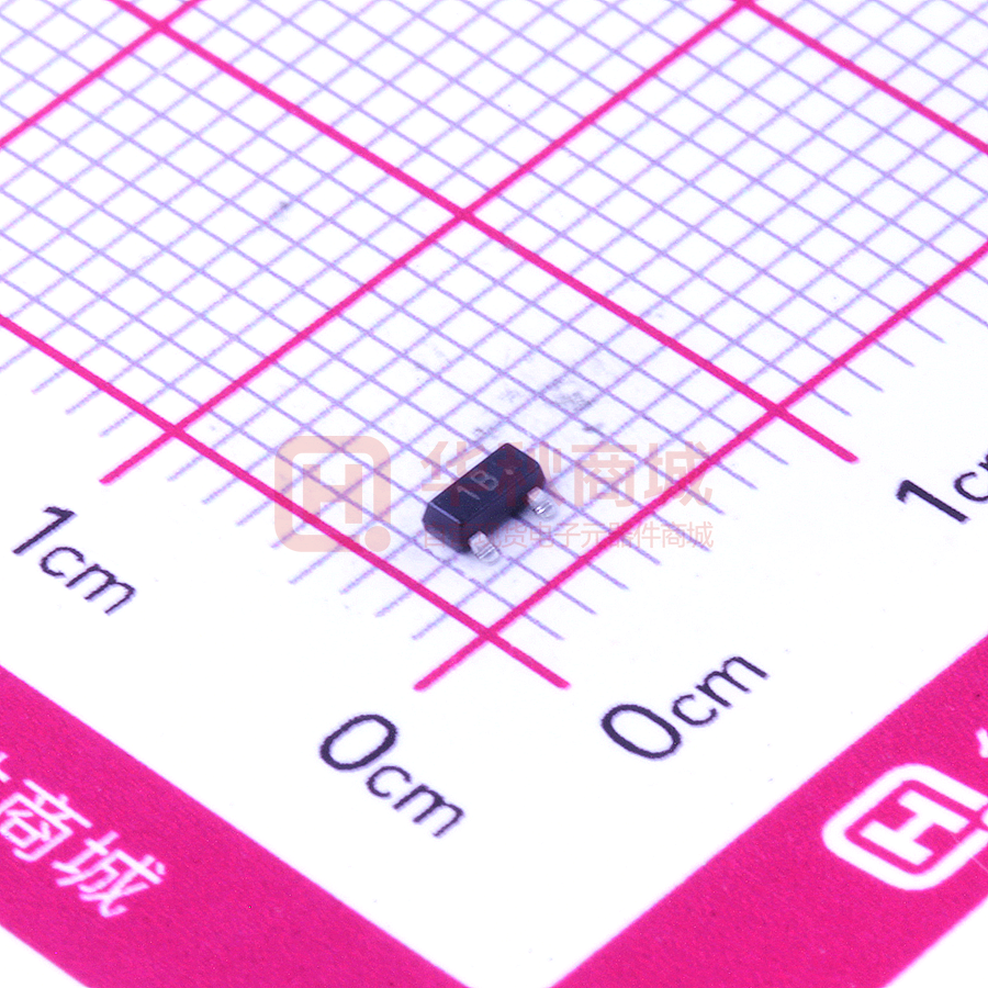

BC846B
BC846B
    YANGJIE(扬杰科技)
    SOT-23
    晶体管类型:NPN 集射极击穿电压(Vceo):65V 集电极电流(Ic):100mA 功率(Pd):200mW 集电极截止电流(Icbo):100nA 集电极-发射极饱和电压(VCE(sat)@Ic...
BC846B 数据手册
RoHS BC846/BC847/BC848   COMPLIANT   NPN Transistor Features ● Epoxy meets UL-94 V-0 flammability rating ● Halogen free available upon request by adding suffix ”HF” ● Moisture Sensitivity Level 1 ● Marking: BC846A BC846B BC847A BC847B BC847C BC848A BC848B BC848C 1A 1B 1E 1F 1G 1J 1K 1L ■ Maximum Ratings (Ta=25℃ unless otherwise noted) Symbol Parameter Collector-Base Voltage BC846 BC847 BC848 VCBO Collector-Emitter Voltage BC846 BC847 BC848 VCEO VEBO Emitter-Base Voltage Value Unit 80 50 30 V 65 45 30 V 6 V IC Collector Current 0.1 A PC Collector Power Dissipation 200 mW Thermal Resistance From Junction To Ambient 625 ℃/W Tj Junction Temperature 150 ℃ Tstg Storage Temperature -55~+150 ℃ RΘJA 1/5 S-S1693 Rev.1.2,10-Dec-19 Yangzhou Yangjie Electronic Technology Co., Ltd. www.21yangjie.com RoHS BC846/BC847/BC848   COMPLIANT   ■ Electrical Characteristics (Ta=25℃ unless otherwise noted) Parameter Symbol Test conditions Min VCBO IC= 10µA, IE=0 80 50 30 V VCEO IC= 10mA, IB=0 65 45 30 V VEBO IE= 10µA, IC=0 6 V ICBO VCB=70 V ,IE=0 VCB=50 V ,IE=0 VCB=30 V ,IE=0 0.1 μA ICEO VCE=60 V ,IB=0 VCE=45 V ,IB=0 VCE=30 V ,IB=0 0.1 μA Emitter-base cut-off current IEBO VEB=5 V , IC=0 0.1 μA DC current gain BC846A,847A,848A BC846B,847B,848B BC847C,BC848C hFE VCE= 5V, IC= 2mA Collector-emitter saturation voltage VCE(sat) IC=100mA, IB= 5mA 0.5 V Base-emitter saturation voltage VBE(sat) IC=100mA, IB= 5mA 1.1 V fT VCE= 5 V, IC= 10mA f=100MHz Cob VCB=10V,f=1MHz Collector-base breakdown voltage BC846 BC847 BC848 Collector-emitter breakdown voltage BC846 BC847 BC848 Emitter-base breakdown voltage Collector-base cut-off current BC846 BC847 BC848 Collector-emitter cut-off current BC846 BC847 BC848 Transition frequency Collector-base output capacitance 110 200 420 Max Unit 220 450 800 100 MHz 4.5 pF ■ Ordering Information (Example) PREFERED P/N PACKING CODE UNIT WEIGHT(g) MINIMUM PACKAGE(pcs) INNER BOX QUANTITY(pcs) OUTER CARTON QUANTITY(pcs) DELIVERY MODE BC846/BC847/BC848 F2 Approximate 0.008 3000 30000 120000 7” reel 2/5 S-S1693 Rev.1.2,10-Dec-19 Yangzhou Yangjie Electronic Technology Co., Ltd. www.21yangjie.com BC846/BC847/BC848 RoHS   COMPLIANT   ■ Characteristics(Typical) 3/5 S-S1693 Rev.1.2,10-Dec-19 Yangzhou Yangjie Electronic Technology Co., Ltd. www.21yangjie.com RoHS BC846/BC847/BC848   COMPLIANT   ■SOT-23 Package Outline Dimensions       ■SOT-23 Soldering Footprint 4/5 S-S1693 Rev.1.2,10-Dec-19 Yangzhou Yangjie Electronic Technology Co., Ltd. www.21yangjie.com BC846/BC847/BC848 RoHS   COMPLIANT   Disclaimer The information presented in this document is for reference only. Yangzhou Yangjie Electronic Technology Co., Ltd. reserves the right to make changes without notice for the specification of the products displayed herein to improve reliability, function or design or otherwise. The product listed herein is designed to be used with ordinary electronic equipment or devices, and not designed to be used with equipment or devices which require high level of reliability and the malfunction of with would directly endanger human life (such as medical instruments, transportation equipment, aerospace machinery, nuclear-reactor controllers, fuel controllers and other safety devices), Yangjie or anyone on its behalf, assumes no responsibility or liability for any damages resulting from such improper use of sale. This publication supersedes & replaces all information previously supplied. For additional information, please visit our website http:// www.21yangjie.com , or consult your nearest Yangjie’s sales office for further assistance. 5/5 S-S1693 Rev.1.2,10-Dec-19 Yangzhou Yangjie Electronic Technology Co., Ltd. www.21yangjie.com
