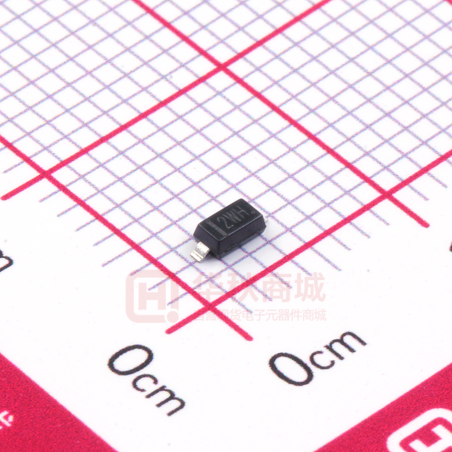

BZT52B12
BZT52B12
    YANGJIE(扬杰科技)
    SOD-123
    稳压值(标称值):12V 功率:500mW 反向电流(Ir):100nA@9V
BZT52B12 数据手册
RoHS BZT52B2V4 THRU BZT52B75  COMPLIANT   Zener Diodes Features ● High reliability ● Very sharp reverse characteristic ● Low reverse current level ● Zener Voltage 2.4V~75V Mechanical Data ● Package: SOD-123 ● Terminals: Tin plated leads, solderable per J-STD-002 and JESD22-B102 ● Polarity: Cathode line denotes the cathode end   ■ Maximum Ratings (Ta=25℃ Unless otherwise specified) SYMBOL UNIT VALUE PD mW 500 Storage Temperature Range Tstg °C -55~+150 Junction Temperature TJ °C -55~+150 Maximum Regulator Current IZM mA P D/ V z Forward Voltage(@IF=10mA) VF V 1.0 RθJA °C /W 250 PARAMETER Power Dissipation Thermal Resistance Junction to Ambient Air* ■ Ordering Information (Example) PREFERED P/N PACKING CODE UNIT WEIGHT(g) BZT52B2V4 THRU BZT52B75 F2 Approximate 0.009 MINIMUM INNER BOX PACKAGE(pcs) QUANTITY(pcs) 3000 30000 OUTER CARTON QUANTITY(pcs) DELIVERY MODE 120000 7” reel 1/5 S-S1348 Rev. 2.0, 25-Dec-19 Yangzhou Yangjie Electronic Technology Co., Ltd. www.21yangjie.com BZT52B2V4 THRU BZT52B75     ■ Electrical Characteristics (Ta=25℃ Unless otherwise specified) Vz at IzT (V) Type Number Device Marking Zzt(Ω) Zzk(Ω) IR(μA)@VR Typical Temperature Coefficient@ IZTC mV/℃ Test Current IZTC min. typ. max. IZT(mA) max. Izk(mA) max. max VR(V) Min Max mA BZT52B2V4 2WX 2.34 2.4 2.46 5 100 1.0 600 45 1.0 -3.5 0 5 BZT52B2V7 2W1 2.63 2.7 2.77 5 100 1.0 600 20 1.0 -3.5 0 5 BZT52B3V0 2W2 2.92 3.0 3.08 5 100 1.0 600 10 1.0 -3.5 0 5 BZT52B3V3 2W3 3.21 3.3 3.39 5 95 1.0 600 15 1.0 -3.5 0 5 BZT52B3V6 2W4 3.52 3.6 3.67 5 95 1.0 600 15 1.0 -3.5 0 5 BZT52B3V9 2W5 3.82 3.9 3.98 5 95 1.0 600 10 1.0 -3.5 0 5 BZT52B4V3 2W6 4.21 4.3 4.39 5 95 1.0 600 5 1.0 -3.5 0 5 BZT52B4V7 2W7 4.61 4.7 4.79 5 78 1.0 500 5 2.0 -3.5 0 5 BZT52B5V1 2W8 5.0 5.1 5.2 5 60 1.0 480 0.1 0.8 -2.7 1.2 5 BZT52B5V6 2W9 5.49 5.6 5.71 5 40 1.0 400 0.1 1.0 -2 2.5 5 BZT52B6V2 2WA 6.08 6.2 6.32 5 10 1.0 150 0.1 2.0 0.4 3.7 5 BZT52B6V8 2WB 6.66 6.8 6.94 5 8 1.0 80 0.1 3.0 1.2 4.5 5 BZT52B7V5 2WC 7.35 7.5 7.65 5 7 1.0 80 0.1 5.0 2.5 5.3 5 BZT52B8V2 2WD 8.04 8.2 8.36 5 7 1.0 80 0.1 6.0 3.2 6.2 5 BZT52B9V1 2WE 8.92 9.1 9.28 5 10 1.0 100 0.1 7.0 3.8 7.0 5 BZT52B10 2WF 9.8 10 10.2 5 15 1.0 150 0.1 7.5 4.5 8.0 5 BZT52B11 2WG 10.78 11 11.22 5 20 1.0 150 0.1 8.5 5.4 9.0 5 BZT52B12 2WH 11.76 12 12.24 5 20 1.0 150 0.1 9.0 6.0 10.0 5 BZT52B13 2WI 12.74 13 13.3 5 25 1.0 170 0.1 10.0 7.0 11.0 5 BZT52B15 2WJ 14.7 15 15.3 5 30 1.0 200 0.1 11.0 9.2 13.0 5 BZT52B16 2WK 15.68 16 16.3 5 40 1.0 200 0.1 12 10.4 14.0 5 BZT52B18 2WL 17.6 18 18.4 5 50 1.0 225 0.1 14.0 12.4 16.0 5 BZT52B20 2WM 19.6 20 20.4 5 55 1.0 225 0.1 15.0 14.4 18.0 5 BZT52B22 2WN 21.56 22 22.44 5 55 1.0 250 0.1 17.0 16.4 20.0 5 BZT52B24 2WO 23.52 24 24.5 5 70 1.0 250 0.1 18.0 18.4 22.0 5 BZT52B27 2WP 26.46 27 27.54 5 80 1.0 300 0.1 20.0 21.4 25.3 2 BZT52B30 2WQ 29.4 30 30.6 5 80 1.0 300 0.1 22.5 24.4 29.4 2 BZT52B33 2WR 32.34 33 33.7 5 80 1.0 325 0.1 25.0 27.4 33.4 2 BZT52B36 2WS 35.28 36 36.72 5 90 1.0 350 0.1 27.0 30.4 37.4 2 BZT52B39 2WT 38.22 39 39.8 5 90 1.0 350 0.1 29.0 33.4 41.2 2 BZT52B43 2WU 42.14 43 43.86 5 100 1 375 0.1 32.0 37.6 46.6 2 BZT52B47 2WV 46.06 47 47.94 5 110 1 375 0.1 35.0 42.0 51.8 2 BZT52B51 2X1 50.0 51 52.0 2 180 0.5 400 0.05 35.7 46.6 57.2 2 BZT52B56 2X2 54.9 56 57.1 2 200 0.5 425 0.05 39.2 52.2 63.8 2 BZT52B62 X3 60.8 62 63.2 2 215 0.5 450 0.05 43.4 58.8 71.6 2 BZT52B68 X4 66.6 68 69.4 2 240 0.5 475 0.05 47.6 65.6 79.8 2 BZT52B75 X5 73.5 75 76.5 2 255 0.5 500 0.05 52.5 73.4 88.6 2 2/5 S-S1348 Rev. 2.0, 25-Dec-19 Yangzhou Yangjie Electronic Technology Co., Ltd. www.21yangjie.com BZT52B2V4 THRU BZT52B75     ■ Characteristics (Typical) 3/5 S-S1348 Rev. 2.0, 25-Dec-19 Yangzhou Yangjie Electronic Technology Co., Ltd. www.21yangjie.com BZT52B2V4 THRU BZT52B75     ■ SOD-123 Package Outline Dimensions   ■ SOD-123 Soldering Footprint Unit: inches 4/5 S-S1348 Rev. 2.0, 25-Dec-19 Yangzhou Yangjie Electronic Technology Co., Ltd. www.21yangjie.com BZT52B2V4 THRU BZT52B75     Disclaimer The information presented in this document is for reference only. Yangzhou Yangjie Electronic Technology Co., Ltd. reserves the right to make changes without notice for the specification of the products displayed herein to improve reliability, function or design or otherwise. The product listed herein is designed to be used with ordinary electronic equipment or devices, and not designed to be used with equipment or devices which require high level of reliability and the malfunction of with would directly endanger human life (such as medical instruments, transportation equipment, aerospace machinery, nuclear-reactor controllers, fuel controllers and other safety devices), Yangjie or anyone on its behalf, assumes no responsibility or liability for any damages resulting from such improper use of sale. This publication supersedes & replaces all information previously supplied. For additional information, please visit our website http:// www.21yangjie.com , or consult your nearest Yangjie’s sales office for further assistance. 5/5 S-S1348 Rev. 2.0, 25-Dec-19 Yangzhou Yangjie Electronic Technology Co., Ltd. www.21yangjie.com
