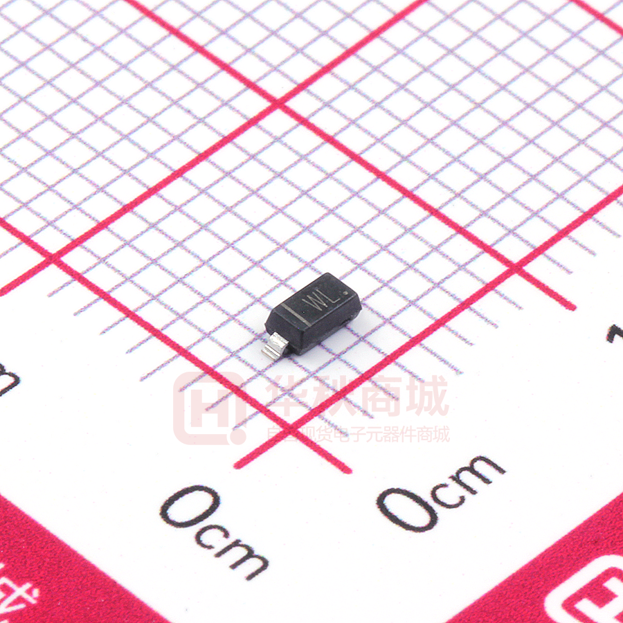

    稳压二极管 Vz=18V 16.8V~19.1V Izt=5mA P=500mW SOD123
BZT52C18 数据手册
RoHS BZT52C2V4 THRU BZT52C47   COMPLIANT   Zener Diodes Features ● High reliability ● Very sharp reverse characteristic ● Low reverse current level ● Zener Voltage 2.4V~47V Mechanical Data ● Package: SOD123 ● Terminals: Tin plated leads, solderable per J-STD-002 and JESD22-B102 ● Polarity: Cathode line denotes the cathode end   ■ Maximum Ratings (Ta=25℃ Unless otherwise specified) SYMBOL UNIT VALUE PD mW 500 Storage Temperature Range Tstg °C -55~+150 Maximum Junction Temperature TJ °C -55~+150 Maximum Regulator Current IZM mA PD/ Vz Maximum Forward Voltage(IF=10mAdc) VF V 0.9 Thermal Resistance Junction to Ambient Air* RθJA °C /W 250 PARAMETER Power Dissipation ■ Ordering Information (Example) PREFERED P/N PACKING CODE UNIT WEIGHT(g) MINIMUM PACKAGE(pcs) BZT52C2V4 THRU BZT52C47 F2 Approximate 0.009 3000 INNER BOX OUTER CARTON DELIVERY MODE QUANTITY(pcs) QUANTITY(pcs) 30000 120000 7” reel 1/5 S-S1349 Rev. 1.9, 28-Jan-19 Yangzhou Yangjie Electronic Technology Co., Ltd. www.21yangjie.com BZT52C2V4 THRU BZT52C47     ■ Electrical Characteristics (Ta=25℃ Unless otherwise specified) Type Number Izt Vz at Izt (V) Device Marking min. typ. max. mA Zzt(Ω) Zzk(Ω) IZ(mA) max. IR(μA)@VR Typical Test Temperature CurrentIZT Coefficient@ IZTC C mV/℃ Izk(mA) max. uA VR(V) Min Max mA BZT52C2V4 WX 2.28 2.4 2.56 5 5 100 1.0 600 50 1.0 -3.5 0 5 BZT52C2V7 W1 2.5 2.7 2.9 5 5 100 1.0 600 20 1.0 -3.5 0 5 BZT52C3V0 W2 2.8 3.0 3.2 5 5 95 1.0 600 10 1.0 -3.5 0 5 BZT52C3V3 W3 3.1 3.3 3.5 5 5 95 1.0 600 5 1.0 -3.5 0 5 BZT52C3V6 W4 3.4 3.6 3.8 5 5 90 1.0 600 5 1.0 -3.5 0 5 BZT52C3V9 W5 3.7 3.9 4.1 5 5 90 1.0 600 3 1.0 -3.5 0 5 BZT52C4V3 W6 4.0 4.3 4.6 5 5 90 1.0 600 3 1.0 -3.5 0 5 BZT52C4V7 W7 4.4 4.7 5.0 5 5 80 1.0 500 3 2.0 -3.5 0 5 BZT52C5V1 W8 4.8 5.1 5.4 5 5 60 1.0 480 2 2.0 -2.7 1.2 5 BZT52C5V6 W9 5.2 5.6 6.0 5 5 40 1.0 400 1 2.0 -2 2.5 5 BZT52C6V2 WA 5.8 6.2 6.6 5 5 10 1.0 150 3 4.0 0.4 3.7 5 BZT52C6V8 WB 6.4 6.8 7.2 5 5 15 1.0 80 2 4.0 1.2 4.5 5 BZT52C7V5 WC 7.0 7.5 7.9 5 5 15 1.0 80 1 5.0 2.5 5.3 5 BZT52C8V2 WD 7.7 8.2 8.7 5 5 15 1.0 80 0.7 5.0 3.2 6.2 5 BZT52C9V1 WE 8.5 9.1 9.6 5 5 15 1.0 100 0.5 6.0 3.8 7.0 5 BZT52C10 WF 9.4 10 10.6 5 5 20 1.0 150 0.2 7.0 4.5 8.0 5 BZT52C11 WG 10.4 11 11.6 5 5 20 1.0 150 0.1 8.0 5.4 9.0 5 BZT52C12 WH 11.4 12 12.7 5 5 25 1.0 150 0.1 8.0 6.0 10.0 5 BZT52C13 WI 12.4 13 14.1 5 5 30 1.0 170 0.1 8.0 7.0 11.0 5 BZT52C15 WJ 14.25 15 15.75 5 5 30 1.0 200 0.1 10.5 9.2 13.0 5 BZT52C16 WK 15.3 16 17.1 5 5 40 1.0 200 0.1 11.2 10.4 14.0 5 BZT52C18 WL 16.8 18 19.1 5 5 45 1.0 225 0.1 12.6 12.4 16.0 5 BZT52C20 WM 18.8 20 21.2 5 5 55 1.0 225 0.1 14.0 14.4 18.0 5 BZT52C22 WN 20.8 22 23.3 5 5 55 1.0 250 0.1 15.4 16.4 20.0 5 BZT52C24 WO 22.8 24 25.6 5 5 70 1.0 250 0.1 16.8 18.4 22.0 5 BZT52C27 WP 25.1 27 28.9 2 2 80 0.5 300 0.1 18.9 21.4 25.3 2 BZT52C30 WQ 28 30 32 2 2 80 0.5 300 0.1 21.0 24.4 29.4 2 BZT52C33 WR 31 33 35 2 2 80 0.5 325 0.1 23.1 27.4 33.4 2 BZT52C36 WS 34 36 38 2 2 90 0.5 350 0.1 25.2 30.4 37.4 2 BZT52C39 WT 37 39 41 2 2 130 0.5 350 0.1 27.3 33.4 41.2 2 BZT52C43 WU 40 43 46 5 5 100 1.0 750 0.1 32 10.0 12.0 5 BZT52C47 WV 44 47 50 5 5 100 1.0 750 0.1 35 10.0 12.0 5 * 2/5 S-S1349 Rev. 1.9, 28-Jan-19 Yangzhou Yangjie Electronic Technology Co., Ltd. www.21yangjie.com BZT52C2V4 THRU BZT52C47     ■ Characteristics (Typical) 3/5 S-S1349 Rev. 1.9, 28-Jan-19 Yangzhou Yangjie Electronic Technology Co., Ltd. www.21yangjie.com BZT52C2V4 THRU BZT52C47     ■ Outline Dimensions ■ Soldering Footprint Unit: inches 4/5 S-S1349 Rev. 1.9, 28-Jan-19 Yangzhou Yangjie Electronic Technology Co., Ltd. www.21yangjie.com BZT52C2V4 THRU BZT52C47     Disclaimer The information presented in this document is for reference only. Yangzhou Yangjie Electronic Technology Co., Ltd. reserves the right to make changes without notice for the specification of the products displayed herein to improve reliability, function or design or otherwise. The product listed herein is designed to be used with ordinary electronic equipment or devices, and not designed to be used with equipment or devices which require high level of reliability and the malfunction of with would directly endanger human life (such as medical instruments, transportation equipment, aerospace machinery, nuclear-reactor controllers, fuel controllers and other safety devices), Yangjie or anyone on its behalf, assumes no responsibility or liability for any damages resulting from such improper use of sale. This publication supersedes & replaces all information previously supplied. For additional information, please visit our website http:// www.21yangjie.com , or consult your nearest Yangjie’s sales office for further assistance. 5/5 S-S1349 Rev. 1.9, 28-Jan-19 Yangzhou Yangjie Electronic Technology Co., Ltd. www.21yangjie.com
