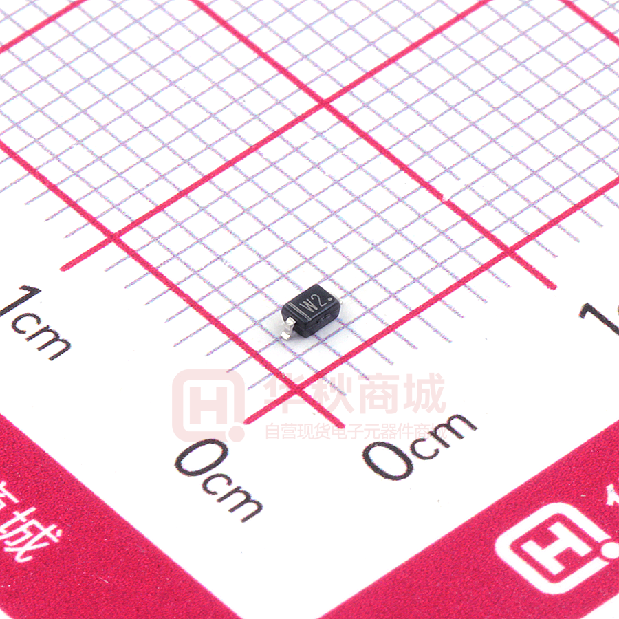

    稳压二极管 Vz=3V 2.8V~3.2V Izt=5mA P=200mW SOD323
BZT52C3V0S 数据手册
RoHS BZT52C2V4S THRU BZT52C47S   COMPLIANT   Zener Diodes Features ● High reliability ● Very sharp reverse characteristic ● Low reverse current level Mechanical Data ● Package: SOD323 ● Terminals: Tin plated leads, solderable per J-STD-002 and JESD22-B102 ● Polarity: Cathode line denotes the cathode end   ■ Maximum Ratings (Ta=25℃ Unless otherwise specified) SYMBOL UNIT VALUE PD mW 200 Storage Temperature Range Tstg °C -55~+150 Maximum Junction Temperature TJ °C -55~+150 Maximum Regulator Current IZM mA PD/ Vz VF V 0.9 RθJA °C /W 650 PARAMETER Power Dissipation Maximum Forward Voltage(IF=10mAdc) Thermal Resistance Junction to Ambient Air* ■ Ordering Information (Example) PREFERED P/N PACKING CODE UNIT WEIGHT(g) MINIMUM PACKAGE(pcs) BZT52C2V4S THRU BZT52C47S F2 Approximate 0.004 3000 INNER BOX OUTER CARTON DELIVERY MODE QUANTITY(pcs) QUANTITY(pcs) 30000 120000 7” reel 1/5 S-S1470 Rev.1.9, 15-Mar-19 Yangzhou Yangjie Electronic Technology Co., Ltd. www.21yangjie.com BZT52C2V4S THRU BZT52C47S     ■ Electrical Characteristics (Ta=25℃ Unless otherwise specified) 1 Type Number 2 Vz at IzT (V)* Device Marking Zzt(Ω)* Zzk(Ω)* 2 IR(μA)@VR min. typ. max. IZT(mA) max. Izk(mA) max. max VR(V) Typical Temperature Coefficient @IZTC mV/°C BZT52C2V4S WX 2.28 2.4 2.56 5 100 1.0 600 50 1.0 -3.5 0 BZT52C2V7S W1 2.5 2.7 2.9 5 100 1.0 600 20 1.0 -3.5 0 BZT52C3V0S W2 2.8 3.0 3.2 5 95 1.0 600 10 1.0 -3.5 0 BZT52C3V3S W3 3.1 3.3 3.5 5 95 1.0 600 5 1.0 -3.5 0 BZT52C3V6S W4 3.4 3.6 3.8 5 90 1.0 600 5 1.0 -3.5 0 BZT52C3V9S W5 3.7 3.9 4.1 5 90 1.0 600 3 1.0 -3.5 0 BZT52C4V3S W6 4.0 4.3 4.6 5 90 1.0 600 3 1.0 -3.5 0 BZT52C4V7S W7 4.4 4.7 5.0 5 80 1.0 500 3 2.0 -3.5 0.2 BZT52C5V1S W8 4.8 5.1 5.4 5 60 1.0 480 2 2.0 -2.7 1.2 BZT52C5V6S W9 5.2 5.6 6.0 5 40 1.0 400 1 2.0 -2.0 2.5 BZT52C6V2S WA 5.8 6.2 6.6 5 10 1.0 150 3 4.0 0.4 3.7 BZT52C6V8S WB 6.4 6.8 7.2 5 15 1.0 80 2 4.0 1.2 4.5 BZT52C7V5S WC 7.0 7.5 7.9 5 15 1.0 80 1 5.0 2.5 5.3 BZT52C8V2S WD 7.7 8.2 8.7 5 15 1.0 80 0.7 5.0 3.2 6.2 BZT52C9V1S WE 8.5 9.1 9.6 5 15 1.0 100 0.5 6.0 3.8 7.0 BZT52C10S WF 9.4 10 10.6 5 20 1.0 150 0.2 7.0 4.5 8.0 BZT52C11S WG 10.4 11 11.6 5 20 1.0 150 0.1 8.0 5.4 9.0 BZT52C12S WH 11.4 12 12.7 5 25 1.0 150 0.1 8.0 6.0 10.0 BZT52C13S WI 12.4 13 14.1 5 30 1.0 170 0.1 8.0 7.0 11.0 BZT52C15S WJ 14.25 15 15.75 5 30 1.0 200 0.1 10.5 9.2 13.0 BZT52C16S WK 15.3 16 17.1 5 40 1.0 200 0.1 11.2 10.4 14.0 BZT52C18S WL 16.8 18 19.1 5 45 1.0 225 0.1 12.6 12.4 16.0 BZT52C20S WM 18.8 20 21.2 5 55 1.0 225 01. 14.0 14.4 18.0 BZT52C22S WN 20.8 22 23.3 5 55 1.0 250 0.1 15.4 16.4 20.0 BZT52C24S WO 22.8 24 25.6 5 70 1.0 250 0.1 16.8 18.4 22.0 BZT52C27S WP 25.1 27 28.9 2 80 0.5 300 0.1 18.9 21.4 25.3 BZT52C30S WQ 28 30 32 2 80 0.5 300 0.1 21.0 24.4 29.4 BZT52C33S WR 31 33 35 2 80 0.5 325 0.1 23.1 27.4 33.4 BZT52C36S WS 34 36 38 2 90 0.5 350 0.1 25.2 30.4 37.4 BZT52C39S WT 37 39 41 2 130 0.5 350 0.1 27.3 33.4 41.2 BZT52C43S WU 40 43 46 5 100 1.0 750 0.1 32 10.0 12.0 BZT52C47S WV 44 47 50 5 100 1.0 750 0.1 35 10.0 12.0 2/5 S-S1470 Rev.1.9, 15-Mar-19 Yangzhou Yangjie Electronic Technology Co., Ltd. www.21yangjie.com BZT52C2V4S THRU BZT52C47S     ■ Characteristics (Typical) 3/5 S-S1470 Rev.1.9, 15-Mar-19 Yangzhou Yangjie Electronic Technology Co., Ltd. www.21yangjie.com BZT52C2V4S THRU BZT52C47S     ■ Outline Dimensions ■ Soldering Footprint 4/5 S-S1470 Rev.1.9, 15-Mar-19 Yangzhou Yangjie Electronic Technology Co., Ltd. www.21yangjie.com BZT52C2V4S THRU BZT52C47S     Disclaimer The information presented in this document is for reference only. Yangzhou Yangjie Electronic Technology Co., Ltd. reserves the right to make changes without notice for the specification of the products displayed herein to improve reliability, function or design or otherwise. The product listed herein is designed to be used with ordinary electronic equipment or devices, and not designed to be used with equipment or devices which require high level of reliability and the malfunction of with would directly endanger human life (such as medical instruments, transportation equipment, aerospace machinery, nuclear-reactor controllers, fuel controllers and other safety devices), Yangjie or anyone on its behalf, assumes no responsibility or liability for any damages resulting from such improper use of sale. This publication supersedes & replaces all information previously supplied. For additional information, please visit our website http:// www.21yangjie.com , or consult your nearest Yangjie’s sales office for further assistance. 5/5 S-S1470 Rev.1.9, 15-Mar-19 Yangzhou Yangjie Electronic Technology Co., Ltd. www.21yangjie.com
