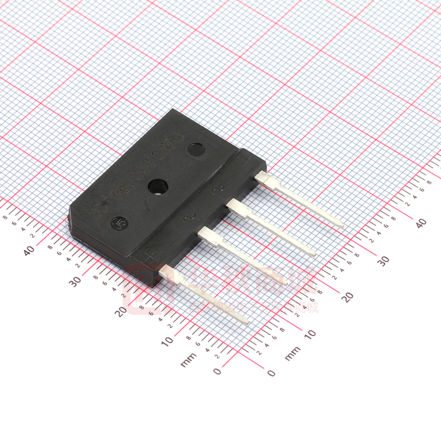

RoHS GBJ35005A THRU GBJ3510A COMPLIANT Bridge Rectifiers Features ● UL recognition, file #E230084 ● Thin single in-line package ● High surge current capability ● Solder dip 275 °C max. 7 s, per JESD 22-B106 Typical Applications General purpose use in AC/DC bridge full wave rectification for switching power supply, home appliances, office equipment, industrial automation applications. Mechanical Data ● Package: 6KBJ Molding compound meets UL 94 V-0 flammability rating, RoHS-compliant ● Terminals: Tin plated leads, solderable per J-STD-002 and JESD22-B102 ● Polarity: As marked on body + ~ - ~ ■Maximum Ratings (Ta=25℃ Unless otherwise specified) PARAMETER SYMBOL UNIT GBJ35005A GBJ3501A GBJ3502A GBJ3504A GBJ3506A GBJ3508A GBJ3510A GBJ35005A GBJ3501A GBJ3502A GBJ3504A GBJ3506A GBJ3508A GBJ3510A Device marking code Repetitive peak reverse voltage VRRM V IO A With heatsink Average rectified output Tc =87℃ current @60Hz sine wave, Without heatsink R-load, Ta =25℃ 50 100 200 400 600 800 1000 35.0 3.5 Surge(non-repetitive)forward current @60Hz half sine wave, 1 cycle, Tj=25℃ IFSM A 380 It 2 A2s 599 Storage temperature Tstg ℃ -55 ~+150 Junction temperature Tj ℃ -55 ~+150 Dielectric strength @terminals to case, AC 1 minute Vdis KV 2.5 Mounting torque @recommend torque:5kg·cm Tor kg· cm 8 Current squared time @1ms≤t≤8.3ms Tj=25℃, Rating of per diode ■Electrical Characteristics(Ta=25℃ Unless otherwise specified) PARAMETER Maximum instantaneous forward voltage drop per diode Maximum DC reverse current at rated DC blocking voltage per diode SYMBOL UNIT TEST GBJ35005A GBJ3501A GBJ3502A GBJ3504A GBJ3506A GBJ3508A GBJ3510A CONDITIONS VF V IFM=17.5A IRRM μA VRM=VRRM 1.00 5 1/4 S-B787 Rev.1.4, 27-Nov-18 Yangzhou Yangjie Electronic Technology Co., Ltd. www.21yangjie.com GBJ35005A THRU GBJ3510A ■Thermal Characteristics (Ta=25℃ Unless otherwise specified) SYMBOL UNIT GBJ35005A GBJ3501A GBJ3502A GBJ3504A GBJ3506A GBJ3508A GBJ3510A PARAMETER Thermal Resistance Between junction and ambient, Without heatsink RθJ-A Between junction and case, With heatsink RθJ-C 22.0 ℃/W 0.8 ■Ordering Information (Example) PREFERED P/N PACKING CODE UNIT WEIGHT(g) MINIIMUM PACKAGE(pcs) INNER BOX QUANTITY(pcs) OUTER CARTON QUANTITY(pcs) DELIVERY MODE GBJ35005A THRU GBJ3510A B1 Approximate 6.5 15 750 1500 TUBE ■ Characteristics (Typical) FIG2:Surge Forward Current Capability FIG1:Io-Tc Curve 600 40 Peak Forward Surge Current(A) Average Forward Output (A) 30 20 10 sine wave R-load with heatsink 0 70 0 IFSM half sine wave Tc heatsink 8.3ms 8.3ms 1cycle 400 non-repetitive Tj=25℃ 200 0 80 90 100 110 120 130 140 Case Temperature(℃) 150 1 160 2 5 10 20 Number of Cycles 50 100 ` FIG4:Typical Reverse Characteristics FIG3: Forward Voltage 100 60 Instantaneous Reverse Current (uA) Instantaneous Forward Current (A) 40 20 10 5.0 Ta=25℃ 1.0 0.5 Tj=125℃ 10 1.0 Tj=25℃ 0.1 0.2 0.01 0.1 0.4 0.6 0.8 1.0 1.2 Instantaneous Forward Voltage(V) 1.4 0 20 40 60 80 100 Percent of Rated Peak Reverse Voltage(%) 2/4 S-B787 Rev.1.4, 27-Nov-18 Yangzhou Yangjie Electronic Technology Co., Ltd. www.21yangjie.com GBJ35005A THRU GBJ3510A ■ Outline Dimensions 6KBJ 6KBJ HOLE FOR NO. 6 SCREW L A K O DIA B M + ~ - ~ J D E N I C H G F F P Dimensions in millimeters Dim Min Max A 29.7 30.3 B 19.7 20.3 C 17.0 18.0 D 4.8 5.8 E 3.8 4.2 F 7.3 7.7 G 9.8 10.2 H 0.9 1.1 I 2.0 2.4 J 2.3 2.7 K 3.4 3.8 L 4.4 4.8 M 10.8 11.2 N 3.1 3.7 O 3.1 3.4 P 0.6 0.8 3/4 S-B787 Rev.1.4, 27-Nov-18 Yangzhou Yangjie Electronic Technology Co., Ltd. www.21yangjie.com GBJ35005A THRU GBJ3510A Disclaimer The information presented in this document is for reference only. Yangzhou Yangjie Electronic Technology Co., Ltd. reserves the right to make changes without notice for the specification of the products displayed herein to improve reliability, function or design or otherwise. The product listed herein is designed to be used with ordinary electronic equipment or devices, and not designed to be used with equipment or devices which require high level of reliability and the malfunction of with would directly endanger human life (such as medical instruments, transportation equipment, aerospace machinery, nuclear-reactor controllers, fuel controllers and other safety devices), Yangjie or anyone on its behalf, assumes no responsibility or liability for any damages resulting from such improper use of sale. This publication supersedes & replaces all information previously supplied. For additional information, please visit our website http:// www.21yangjie.com , or consult your nearest Yangjie’s sales office for further assistance. 4/4 S-B787 Rev.1.4, 27-Nov-18 Yangzhou Yangjie Electronic Technology Co., Ltd. www.21yangjie.com
