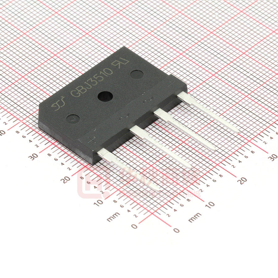

    YANGJIE(扬杰科技)
    DB-4P_14.5X3.5MM_TM
    桥式整流器 VR=1KV IR=5μA GBP
GBP310 数据手册
RoHS GBP3005 THRU GBP310  COMPLIANT   Bridge Rectifiers Features ● UL recognition, file #E230084 ● Glass passivated chip junction ● Ideal for printed circuit boards ● High surge current capability ● Solder dip 275 °C max. 7 s, per JESD 22-B106 Typical Applications General purpose use in AC/DC bridge full wave rectification for monitor, TV, printer, power supply, switching mode power supply, adapter, audio equipment, and home appliances applications. Mechanical Data + ~ ~ ● Package: GBP Molding compound meets UL 94 V-0 flammability rating, RoHS-compliant ● Terminals: Tin plated leads, solderable per J-STD-002 and JESD22-B102 ● Polarity: As marked on body - ■Maximum Ratings (Ta=25℃ Unless otherwise specified) PARAMETER SYMBOL UNIT Device marking code GBP3005 GBP301 GBP302 GBP304 GBP306 GBP308 GBP310 GBP3005 GBP301 GBP302 GBP304 GBP306 GBP308 GBP310 Maximum Repetitive Peak Reverse Voltage VRRM V 50 100 200 400 600 800 1000 Maximum RMS Voltage VRMS V 35 70 140 280 420 560 700 VDC V 50 100 200 400 600 800 1000 IO A IFSM A Maximum DC blocking Voltage Average rectified output current @60Hz sine wave, R-load, Tc =120℃ Forward Surge Current (Non-repetitive) @60Hz Half-sine wave,1 cycle, Tj=25℃ Forward Surge Current (Non-repetitive) @1ms, square wave, 1 cycle, Tj=25℃ Current squared time @1ms≤t≤8.3ms Tj=25℃, Rating of per diode Dielectric strength @ terminals to case, AC 1 minute 3.0 90 180 I2t A2s Vdis KV 2 Storage temperature Tstg ℃ -55 ~ +150 Junction temperature Tj ℃ -55 ~ +150 33.6 1/4 S-B219 Rev. 2.3, 23-Apr-22 Yangzhou Yangjie Electronic Technology Co., Ltd. www.21yangjie.com GBP3005 THRU GBP310    ■Electrical Characteristics(Ta=25℃ Unless otherwise specified) PARAMETER SYMBOL UNIT Maximum instantaneous forward voltage drop per diode VF V Maximum DC reverse current at rated DC blocking voltage per diode IR μA Typical junction capacitance Cj pF TEST CONDITIONS GBP3005 GBP301 GBP302 GBP304 GBP306 GBP308 GBP310 IFM=1.5A 1.0 Tj =25℃ 5 Tj =125℃ 100 Measured at 1MHz and Applied Reverse Voltage of 4.0 V.D.C 27 ■Thermal Characteristics (Ta=25℃ Unless otherwise specified) PARAMETER Thermal Resistance SYMBOL Between junction and ambient RθJ-A Between junction and Case RθJ-C UNIT GBP3005 GBP301 GBP302 GBP304 GBP306 GBP308 GBP310 45 ℃/W 5 ■Ordering Information (Example) PREFERED P/N PACKING CODE UNIT WEIGHT(g) MINIIMUM PACKAGE(pcs) INNER BOX QUANTITY(pcs) OUTER CARTON QUANTITY(pcs) DELIVERY MODE GBP3005-GBP310 B1 1.4 35 2100 4200 TUBE ■ Characteristics (Typical) FIG2:Surge Forward Current Capability FIG1:Io-Tc Curve 3.6 2.4 1.8 1.2 sine wave R-load free in air 0.6 0 Half sine wave 120 0 IFSM 3.0 Peak Forward Surge Current(A) Average Forward output Current(A) 140 8.3ms 8.3ms 1cycle 100 non-repetitive Tj=25℃ 90 80 60 40 20 0 40 80 120 Case Temperature(℃ ) 160 0 1 2 5 10 20 Number of Cycles 50 100 2/4 S-B219 Rev. 2.3, 23-Apr-22 Yangzhou Yangjie Electronic Technology Co., Ltd. www.21yangjie.com GBP3005 THRU GBP310    FIG3: Typical Forward Voltage 60 FIG4:Typical Reverse Characteristics 100 20 Instantaneous Reverse Current (uA) Instantaneous Forward Current(A) 40 10 5.0 2.0 1.0 0.5 0.2 0.1 0.6 1.0 0.1 Tj=25 ℃ 0.01 1.6 0.8 1.0 1.2 1.4 Instantaneous Forward Voltage(V) Tj=125 ℃ 10 0 20 40 60 80 100 Percent of Rated Peak Reverse Voltage (%) ■ Outline Dimensions GBP GBP A H C2.7 B I C E D F Dim Min A 14.25 Max 14.75 B 10.10 10.60 C 1.80 2.20 D 14.25 14.73 E 1.22 1.42 F 0.76 0.86 G 3.70 3.90 H 3.35 3.65 I 0.80 1.10 J 0.35 0.55 J G G G Dimensions in millimeters 3/4 S-B219 Rev. 2.3, 23-Apr-22 Yangzhou Yangjie Electronic Technology Co., Ltd. www.21yangjie.com GBP3005 THRU GBP310    Disclaimer The information presented in this document is for reference only. Yangzhou Yangjie Electronic Technology Co., Ltd. reserves the right to make changes without notice for the specification of the products displayed herein to improve reliability, function or design or otherwise. The product listed herein is designed to be used with ordinary electronic equipment or devices, and not designed to be used with equipment or devices which require high level of reliability and the malfunction of with would directly endanger human life (such as medical instruments, transportation equipment, aerospace machinery, nuclear-reactor controllers, fuel controllers and other safety devices), Yangjie or anyone on its behalf, assumes no responsibility or liability for any damages resulting from such improper use of sale. This publication supersedes & replaces all information previously supplied. For additional information, please visit our website http:// www.21yangjie.com , or consult your nearest Yangjie’s sales office for further assistance. 4/4 S-B219 Rev. 2.3, 23-Apr-22 Yangzhou Yangjie Electronic Technology Co., Ltd. www.21yangjie.com
