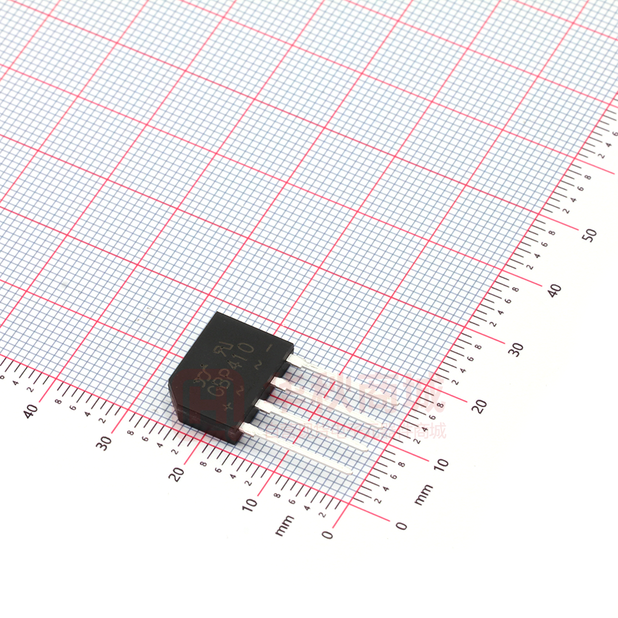

    DB-4P_14.5X3.5MM_TM
    桥式整流器 110A 5uA@1kV 1kV 1V@2A 4A -55℃~+150℃@(Tj) GBP
GBP410 数据手册
RoHS GBP4005 THRU GBP410 COMPLIANT Bridge Rectifiers Features ● UL recognition, file #E230084 ● Ideal for printed circuit boards ● High surge current capability ● Solder dip 275 °C max. 7 s, per JESD 22-B106 Typical Applications General purpose use in AC/DC bridge full wave rectification for monitor, TV, printer, power supply, switching mode power supply, adapter, audio equipment, and home appliances applications. Mechanical Data ● Package: GBP + ~ ~ Molding compound meets UL 94 V-0 flammability rating, RoHS-compliant ● Terminals: Tin plated leads, solderable per J-STD-002 and JESD22-B102 ● Polarity: As marked on body - ■Maximum Ratings (Ta=25℃ Unless otherwise specified) PARAMETER SYMBOL UNIT Device marking code GBP4005 GBP401 GBP402 GBP404 GBP406 GBP408 GBP410 GBP4005 GBP401 GBP402 GBP404 GBP406 GBP408 GBP410 50 100 200 400 600 800 1000 VRRM V IO A 4.0 IFSM A 110 It 2 A2S 50 Storage temperature Tstg ℃ -55 ~+150 Junction temperature Tj ℃ -55 ~+150 Repetitive peak reverse voltage With heatsink Tc =140℃ Without heatsink Tc =70℃ Surge(non-repetitive)forward current @60Hz half sine wave, 1 cycle, Tj=25℃ Average rectified output current @60Hz sine wave, R-load Current squared time @1ms≤t≤8.3ms Tj=25℃, Rating of per diode ■Electrical Characteristics(Ta=25℃ Unless otherwise specified) PARAMETER SYMBOL UNIT Maximum instantaneous forward voltage drop per diode Maximum DC reverse current at rated DC blocking voltage per diode TEST CONDITIONS VF V IFM=2.0A IRRM μA VRM=VRRM GBP4005 GBP401 GBP402 GBP404 GBP406 GBP408 GBP410 1.00 5 ■Thermal Characteristics (Ta=25℃ Unless otherwise specified) PARAMETER Thermal Resistance Between junction and ambient Between junction and lead SYMBOL UNIT GBP4005 GBP401 RθJ-A GBP402 GBP404 GBP406 GBP408 GBP410 47.0 ℃/W RθJ-L 10.0 1/4 S-B220 Rev. 2.2, 19-Jun-15 Yangzhou Yangjie Electronic Technology Co., Ltd. www.21yangjie.com GBP4005 THRU GBP410 ■Ordering Information (Example) PREFERED P/N PACKING CODE UNIT WEIGHT(g) MINIIMUM PACKAGE(pcs) INNER BOX QUANTITY(pcs) GBP4005 THRU GBP410 B1 1.4 35 2100 OUTER CARTON DELIVERY MODE QUANTITY(pcs) 4200 TUBE ■ Characteristics (Typical) FIG1:Io-Tc Curve FIG2:Surge Forward Current Capability sine wave R-load with 75*75*1.6mm Cu heatsink With heatsink 4.0 3.0 Without heatsink 2.0 heatsink Tc-sensing point 0 120 IFSM 5.0 sine wave 140 Peak Forward Surge Current(A) Average Rectified Output Current (A) 6.0 8.3ms 8.3ms 1cycle 100 non-repetitive Tj=25℃ 80 60 40 1.0 20 0 40 80 120 Case Temperature(℃) 0 160 1 FIG3: Forward Voltage 2 5 10 20 Number of Cycles 50 100 FIG4:Typical Reverse Characteristics 100 6 Tj=150℃ 4 Instantaneous Reverse Current(uA) Instantaneous Forward Current(A) ` 0 2 1 0.5 Ta=25℃ 0.1 0.05 0.02 10 1.0 Tj=25℃ 0.1 0.01 0 0.01 0.4 0.6 0.8 1.0 1.2 Instantaneous Forward Voltage(V) 1.4 20 40 60 80 Percent of Rated Peak Reverse Voltage(%) 100 2/4 S-B220 Rev. 2.2, 19-Jun-15 Yangzhou Yangjie Electronic Technology Co., Ltd. www.21yangjie.com GBP4005 THRU GBP410 ■ Outline Dimensions GBP A GBP H C2.7 B I C E D F J G G Dim Min Max A 14.25 14.75 B 10.10 10.60 C 1.80 2.20 D 14.25 14.73 E 1.22 1.42 F 0.76 0.86 G 3.70 3.90 H 3.35 3.65 I 0.80 1.10 J 0.35 0.55 G Dimensions in millimeters 3/4 S-B220 Rev. 2.2, 19-Jun-15 Yangzhou Yangjie Electronic Technology Co., Ltd. www.21yangjie.com GBP4005 THRU GBP410 Disclaimer The information presented in this document is for reference only. Yangzhou Yangjie Electronic Technology Co., Ltd. reserves the right to make changes without notice for the specification of the products displayed herein to improve reliability, function or design or otherwise. The product listed herein is designed to be used with ordinary electronic equipment or devices, and not designed to be used with equipment or devices which require high level of reliability and the malfunction of with would directly endanger human life (such as medical instruments, transportation equipment, aerospace machinery, nuclear-reactor controllers, fuel controllers and other safety devices), Yangjie or anyone on its behalf, assumes no responsibility or liability for any damages resulting from such improper use of sale. This publication supersedes & replaces all information previously supplied. For additional information, please visit our website http:// www.21yangjie.com , or consult your nearest Yangjie’s sales office for further assistance. 4/4 S-B220 Rev. 2.2, 19-Jun-15 Yangzhou Yangjie Electronic Technology Co., Ltd. www.21yangjie.com
