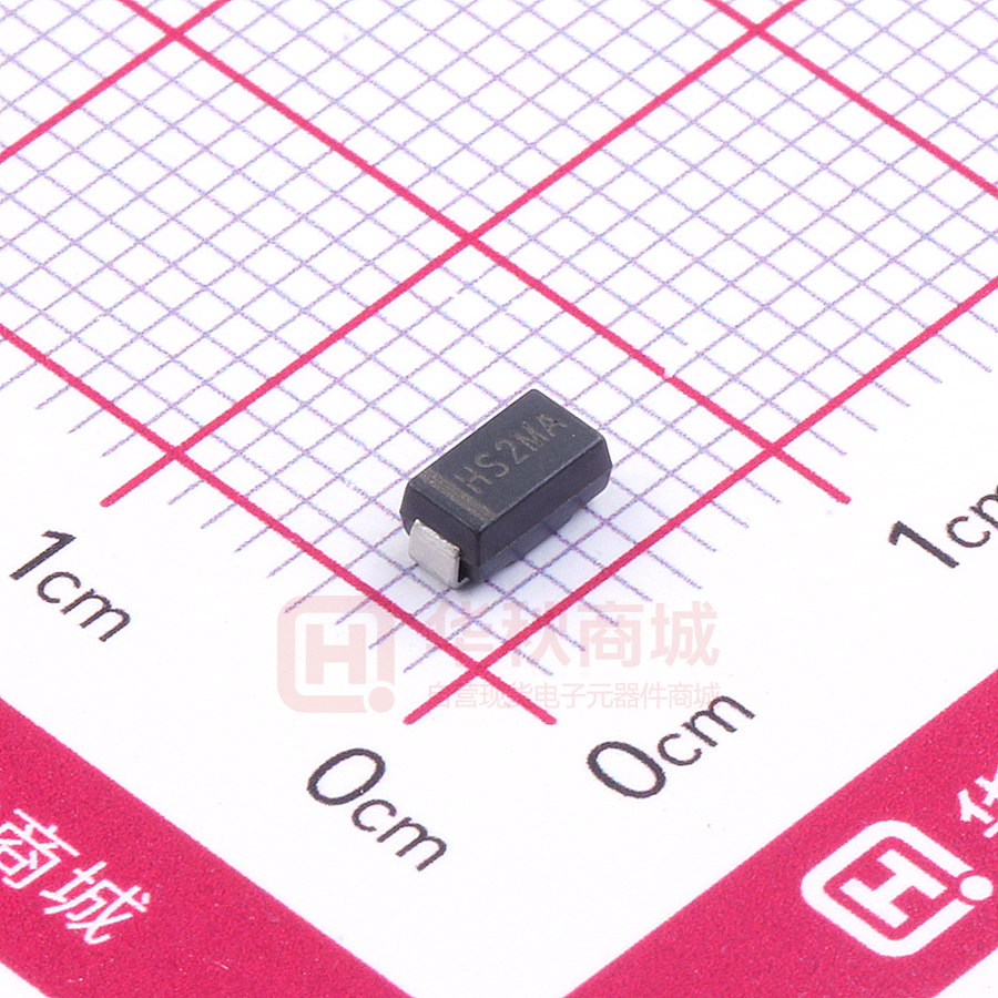

HS2AA THRU HS2MA 高效整流二极管 High Efficient Rectifier
■特征 Features ■外形尺寸和印记 Outline Dimensions and Mark
Mounting Pad Layout
0.065 (1.66) 0.080 (2.04) 0.077(1.96) 0.220 .012(0.31) (5.58) .006(0.15) .008(0.20) .003(0.08) .208(5.28) .194(4.93) D imensions in inches and (millimeters)
● Io 2A ● VRRM 50V-1000V ● 耐正向浪涌电流能力高 High surge current capability ● 封装:模压塑料 Cases: Molded plastic
DO-214AC(SMA)
.062(1.58) .049(1.25) .187(4.75) .167(4.25) .091(2.30) .075(1.90) .056(1.41) .030(0.76) .111(2.83) .094(2.40)
■用途
Applications
●整流用 Rectifier
■极限值(绝对最大额定值) Limiting Values (Absolute Maximum Rating)
参数名称 Item
反向重复峰值电压 Repetitive Peak Reverse Voltage 正向平均电流 Average Forward Current 正向(不重复)浪涌电流 Surge(Non-repetitive)Forward Current 结温 Junction Temperature 储存温度 Storage Temperature
符号 Symbol
VRRM IF(AV)
单位 Unit
V
测试条件 Test Conditions AA
50 正 弦 半 波 60Hz , 电 阻 负 载 , TL=110℃ 60HZ Half-sine wave, Resistance load, TL =110℃ 正弦半波 60Hz, 一个周期, Ta=25℃ 60Hz Half-sine wave ,1 cycle , Ta =25℃
HS2 BA
100
DA
200
GA
400
JA
600
KA
800
MA
1000
A
2.0
IFSM TJ TSTG
A ℃ ℃
50 -55~+150 -55 ~ +150
■电特性 (Ta=25℃ 除非另有规定) Electrical Characteristics (Ta=25℃ Unless otherwise specified)
参数名称 Item
正向峰值电压 Peak Forward Voltage 最大反向恢复时间 Maximum reverse recovery time 反向漏电流 Peak Reverse Current 热阻(典型) Thermal Resistance(Typical)
符号 Symbol
VF trr IRRM1 IRRM2 RθJ-A
单位 Unit
V ns μA
测试条件 Test Condition
IF =2.0A IF=0.5A,IR=1.0A,Irr=0.25A VRM=VRRM Ta =25℃ Ta =100℃
HS2 AA BA
1.0 50 5.0 100 801) 201)
DA
GA
JA
1.3
KA
1.7 75
MA
℃/W RθJ-L
结和环境之间 Between junction and ambient 结和终端之间 Between junction and terminal
备注:Notes:
1)
热阻从结到环境及从结到引线,在电路板的0.3" x 0.3" (8.0毫米 x 8.0毫米)铜垫片区 Thermal resistance from junction to ambient and from junction to lead mounted on P.C.B. with 0.3" x 0.3" (8.0 mm x 8.0 mm) copper pad areas
Document Number 0145 Rev. 1.0, 22-Sep-11
扬州扬杰电子科技股份有限公司 Yangzhou Yangjie Electronic Technology Co., Ltd.
www.21yangjie.com
