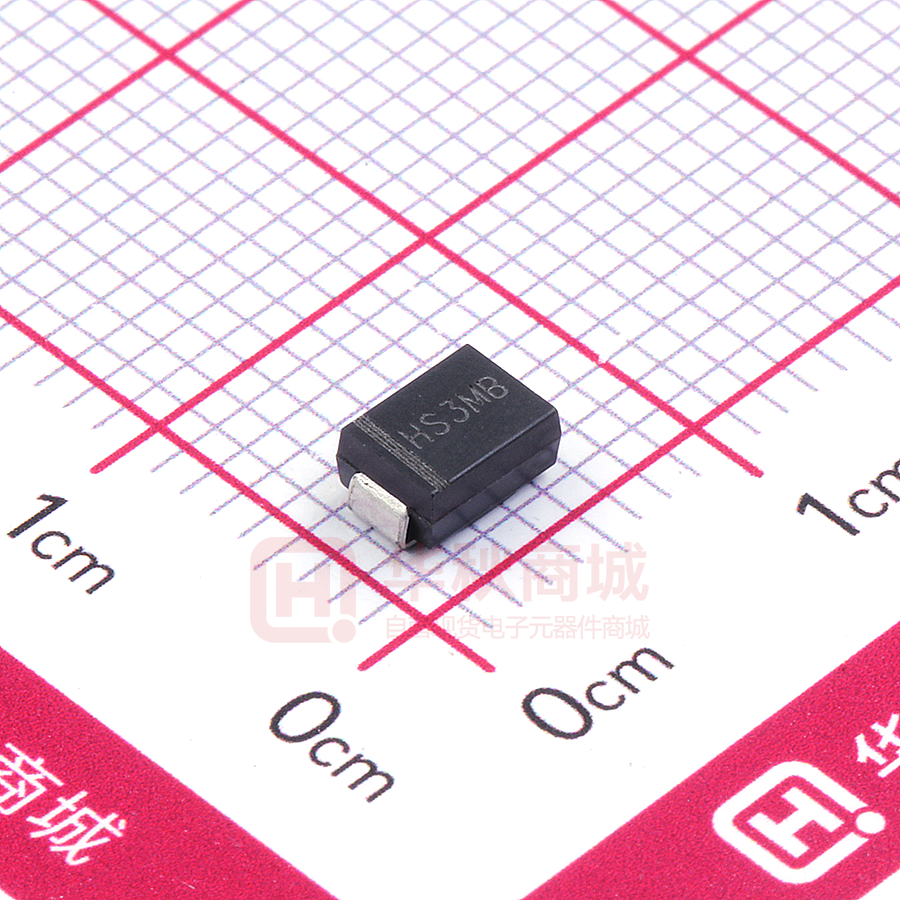

HS3AB THRU HS3MB    Surface Mount High Efficient Rectifier Features ● Low profile package ● Ideal for automated placement ● Glass passivated chip junction ● High forward surge capability ● Super fast reverse recovery time ● Meets MSL level 1, per J-STD-020, LF maximum peak of 260 °C Typical Applications For use in high frequency rectification of power supplies, inverters, converters, and freewheeling diodes for consumer and telecommunication. Mechanical Data ● Package: DO-214AA (SMB) Molding compound meets UL 94 V-0 flammability rating, RoHS-compliant, halogen-free ● Terminals: Tin plated leads, solderable per J-STD-002 and JESD22-B102 ● Polarity: Cathode line denotes the cathode end ■Maximum Ratings (Ta=25℃ Unless otherwise specified) PARAMETER SYMBOL UNIT Device marking code HS3AB HS3BB HS3DB HS3FB HS3GB HS3JB HS3KB HS3MB HS3AB HS3BB HS3DB HS3FB HS3GB HS3JB HS3KB HS3MB 50 100 200 300 400 600 800 1000 VRRM V IO A 3.0 Surge(non-repetitive)forward current @60Hz half-sine wave,1 cycle, Ta=25℃ IFSM A 100 Storage temperature Tstg ℃ -55~+150 Junction temperature Tj ℃ -55~+150 Repetitive peak reverse voltage Average rectified output current @60Hz sine wave, resistance load, TL (Fig.1) ■Electrical Characteristics(Ta=25℃ Unless otherwise specified) PARAMETER Maximum instantaneous forward voltage drop per diode Maximum reverse recovery time Maximum DC reverse current at rated DC blocking voltage per diode @ VRM=VRRM SYMBOL UNIT TEST CONDITIONS VF V IFM=3.0A trr ns IF=0.5A,IR=1.0A, Irr=0.25A IRRM μA HS3AB HS3BB HS3DB HS3FB HS3GB HS3JB HS3KB HS3MB 1.0 1.3 50 1.7 75 Ta =25℃ 5 Ta =125℃ 100 1/5 S-S066 Rev. 2.4, 10-Dec-19 Yangzhou Yangjie Electronic Technology Co., Ltd. www.21yangjie.com HS3AB THRU HS3MB    ■Thermal Characteristics (Ta=25℃ Unless otherwise specified) PARAMETER SYMBOL HS3AB UNIT HS3BB HS3DB HS3FB RθJ-A(1) HS3GB HS3JB HS3KB HS3MB 70 ℃/W Typical Thermal resistance RθJ-L(1) 15 Note: (1) Thermal resistance from junction to ambient and from junction to lead mounted on P.C.B. with 0.3" x 0.3" (8.0 mm x 8.0 mm) copper pad areas ■ Characteristics (Typical) FIG.2: Forward Surge Current Capability FIG.1: Io-TL Curve 120 3.0 Peak Forward Surge Current (A) Average Forward Output Current (A) 3.5 2.5 2.0 1.5 1.0 0 8.3ms Single Half Sine Wave JEDEC Method 80 60 40 20 Resistive or Inductive Load P.C.B. Mounted on 0.3"×0.3" (8.0mm×8.0mm)Copper Pad Areas 0.5 100 0 0 25 75 50 100 125 150 1 10 100 Number of Cycles Lead Temperature (℃) FIG.4: Typical Reverse Characteristics FIG.3: Typical Forward Voltage 100 HS3FB-HS3GB HS3AB-HS3DB 10 Instantaneous Reverse Current (uA) Instantaneous Forward Current (A) 100 HS3JB-HS3MB 1.0 0.1 0.01 0.5 0.9 0.7 1.1 1.3 1.5 Instantaneous Forward Voltage (V) 1.7 1.9                 10 Ta=125℃ 1.0 0.1 Ta=25℃ 0.01 0.001 0 20 40 60 80 100 Percent of Rated Peak Reverse Voltage (%) 2/5 S-S066 Rev. 2.4, 10-Dec-19 Yangzhou Yangjie Electronic Technology Co., Ltd. www.21yangjie.com HS3AB THRU HS3MB      FIG.5: Diagram of circuit and Testing wave form of reverse recovery time 10 Ω NONINDUCTIVE 50 Ω NONINDUCTIVE (-) DUT (+) PULSE GENERATOR (NOTE2) (-) OSCILLOSCOPE (NOTE1) 1Ω NONINDUCTIV (+) NOTES: 1.Rise Time=7ns max .Inpot Impedance=1M Ω 22pf 2.Rise Time=10ns max.Sourse Impedance=50 Ω                             trr +0.5A 0 -0.25A -1.0A 1cm SET TIME BASE FOR 5/10ns/cm ■Ordering Information (Example) PREFERED P/N PACKING CODE UNIT WEIGHT(g) MINIMUM PACKAGE(pcs) INNER BOX QUANTITY(pcs) OUTER CARTON QUANTITY(pcs) DELIVERY MODE HS3AB-HS3MB F1 Approximate 0.096 3000 6000 48000 13” reel HS3AB-HS3MB F2 Approximate 0.096 750 3000 24000 7” reel HS3AB-HS3MB F3 Approximate 0.096 500 2000 16000 7” reel ■ Outline Dimensions DO-214AA(SMB) A DO-214AA(SMB) B C D F G H Dim Min Max A 1.85 2.15 B 3.30 3.94 C 4.25 4.75 D 1.99 2.61 E 5.21 5.59 F 0.90 1.41 G 0.10 0.20 H 0.15 0.31 E Dimensions in millimeters 3/5 S-S066 Rev. 2.4, 10-Dec-19 Yangzhou Yangjie Electronic Technology Co., Ltd. www.21yangjie.com HS3AB THRU HS3MB    ■ Suggested pad layout DO-214AA(SMB) P2 Q2 Q1 P3 Dim Millimeters P1 6.8 P2 4.3 P3 1.8 Q1  2.5 Q2  2.3 P1 Dimensions in millimeters 4/5 S-S066 Rev. 2.4, 10-Dec-19 Yangzhou Yangjie Electronic Technology Co., Ltd. www.21yangjie.com HS3AB THRU HS3MB    Disclaimer The information presented in this document is for reference only. Yangzhou Yangjie Electronic Technology Co., Ltd. reserves the right to make changes without notice for the specification of the products displayed herein to improve reliability, function or design or otherwise. The product listed herein is designed to be used with ordinary electronic equipment or devices, and not designed to be used with equipment or devices which require high level of reliability and the malfunction of with would directly endanger human life (such as medical instruments, transportation equipment, aerospace machinery, nuclear-reactor controllers, fuel controllers and other safety devices), Yangjie or anyone on its behalf, assumes no responsibility or liability for any damages resulting from such improper use of sale. This publication supersedes & replaces all information previously supplied. For additional information, please visit our website http:// www.21yangjie.com , or consult your nearest Yangjie’s sales office for further assistance. 5/5 S-S066 Rev. 2.4, 10-Dec-19 Yangzhou Yangjie Electronic Technology Co., Ltd. www.21yangjie.com
