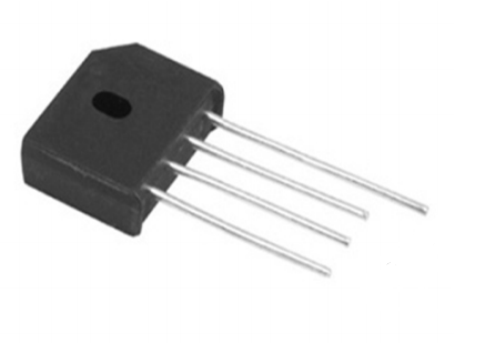

    桥式整流器 2.5A 10uA@1kV 1kV 135A 1V@3A -55℃~+150℃@(Tj) KBU
KBU610 数据手册
RoHS KBU6005 THRU KBU610  COMPLIANT   Bridge Rectifiers Features ● UL recognition, file #E230084 ● Ideal for printed circuit boards ● High surge current capability ● Solder dip 275 °C max. 7 s, per JESD 22-B106 +  ~  ‐ ~  Typical Applications General purpose use in AC/DC bridge full wave rectification for switching power supply, home appliances, office equipment, industrial automation applications. Mechanical Data ● Package: KBU Molding compound meets UL 94 V-0 flammability rating, RoHS-compliant ● Terminals: Tin plated leads, solderable per J-STD-002 and JESD22-B102 ● Polarity: As marked on body   ■Maximum Ratings (Ta=25℃ Unless otherwise specified) PARAMETER SYMBOL UNIT Device marking code Repetitive Peak Reverse Voltage VRRM V IO A With heatsink Average Rectified Output Tc =105℃ Current @60Hz sine wave, Without heatsink R-load Ta =25℃ Surge(Non-repetitive)Forward Current @60Hz half-sine wave, 1 cycle, Ta=25℃ Current Squared Time @1ms≤t≤8.3ms Tj=25℃,Rating of per diode KBU6005 KBU601 KBU602 KBU604 KBU606 KBU608 KBU610 KBU6005 KBU601 KBU602 KBU604 KBU606 KBU608 KBU610 50 100 200 400 600 800 1000 6 2.5 IFSM A 135 I2t A2S 75 Storage Temperature Tstg ℃ -55 ~+150 Junction Temperature Tj ℃ -55 ~+150 ■Electrical Characteristics(Ta=25℃ Unless otherwise specified) PARAMETER Maximum instantaneous forward voltage drop per diode Maximum DC reverse current at rated DC blocking voltage per diode SYMBOL UNIT TEST KBU6005 KBU601 KBU602 KBU604  KBU606  KBU608 KBU610 CONDITIONS VF V IFM=3A 1.0 IRRM μA VRM=VRRM 10 1/4 S-C064 Rev.2.2, 13-Aug-19 Yangzhou Yangjie Electronic Technology Co., Ltd. www.21yangjie.com KBU6005 THRU KBU610    ■Thermal Characteristics (Ta=25℃ Unless otherwise specified) PARAMETER Thermal Resistance SYMBOL Between junction and ambient, Without heatsink Between junction and case, With heatsink UNIT KBU6005 KBU601 KBU602 RθJ-A KBU604 KBU606 KBU608 KBU610 26(1) ℃/W RθJ-C 5(2) Notes (1) Thermal resistance from junction to ambient with units mounted in free air ,no heat sink,P.C.B. at 0.375” (9.5mm) lead length with 0.5×0.5”(12×12mm) copper pads. Thermal resistance from junction to case with units mounted on an aluminum plate heat sink. (2) ■Ordering Information (Example) PREFERED P/N PACKAGE CODE UNIT WEIGHT(g) MINIIMUM PACKAGE(pcs) INNER BOX QUANTITY(pcs) OUTER CARTON QUANTITY(pcs) DELIVERY MODE KBU6005~KBU610 A1 Approximate 7.2 400 400 2400 Paper Box ■ Characteristics(Typical) Half-sine wave 0 135 6 Peak Forward Surge Current (A) Average Forward Output Current(A) FIG2:Surge Forward Current Capability FIG1:Io-Tc Curve 8 Heatsink mounting Tc,2.6×1.4×0..06 (6.5×3.5×1.5cm) Al.Plate 4   2 0 100 50 0 non-repetitive Ta=25℃ 95 45 0 150 1 Case Temperature(℃) 2 5 10 20 50 100 Number of Cycles ` F IG 3:In sta nta neou s F orw ard V oltage 60 F IG 4 :T y p ic a l R e v e rs e C h a ra c te ris tic s 100 T j= 1 2 5 ℃ Ta=25℃ 20 Instantaneous Reverse Current(μA) Instantaneous Forward Current(A) 40 10 5 .0 1 .0 0 .5 10 1 T j= 2 5 ℃ 0 .1 0 .2 0.1 0 .4 0 .6 0 .8 1 .0 1 .2 0 .0 1 1 .4 0 Instantan eous F orw a rd V olta ge (V ) 20 40 60 80 100 P e rc e n t o f R a te d P e a k R e v e rs e V o lta g e (% ) 2/4 S-C064 Rev.2.2, 13-Aug-19 Yangzhou Yangjie Electronic Technology Co., Ltd. www.21yangjie.com KBU6005 THRU KBU610    ■ Outline Dimensions KBU 3.8× 5.7 HOLE THRU KBU 8.2 A - AC + B C DIA Dim Min Max A 18.8 19.8 B C 20.0 / 1.2 1.3 D 4.6 5.6 E 6.8 7.1 F 4.6 5.0 G 22.7 23.7 D F E G D im e n s io n s in m illim e te rs 3/4 S-C064 Rev.2.2, 13-Aug-19 Yangzhou Yangjie Electronic Technology Co., Ltd. www.21yangjie.com KBU6005 THRU KBU610    Disclaimer The information presented in this document is for reference only. Yangzhou Yangjie Electronic Technology Co., Ltd. reserves the right to make changes without notice for the specification of the products displayed herein to improve reliability, function or design or otherwise. The product listed herein is designed to be used with ordinary electronic equipment or devices, and not designed to be used with equipment or devices which require high level of reliability and the malfunction of with would directly endanger human life (such as medical instruments, transportation equipment, aerospace machinery, nuclear-reactor controllers, fuel controllers and other safety devices), Yangjie or anyone on its behalf, assumes no responsibility or liability for any damages resulting from such improper use of sale. This publication supersedes & replaces all information previously supplied. For additional information, please visit our website http:// www.21yangjie.com , or consult your nearest Yangjie’s sales office for further assistance. 4/4 S-C064 Rev.2.2, 13-Aug-19 Yangzhou Yangjie Electronic Technology Co., Ltd. www.21yangjie.com
