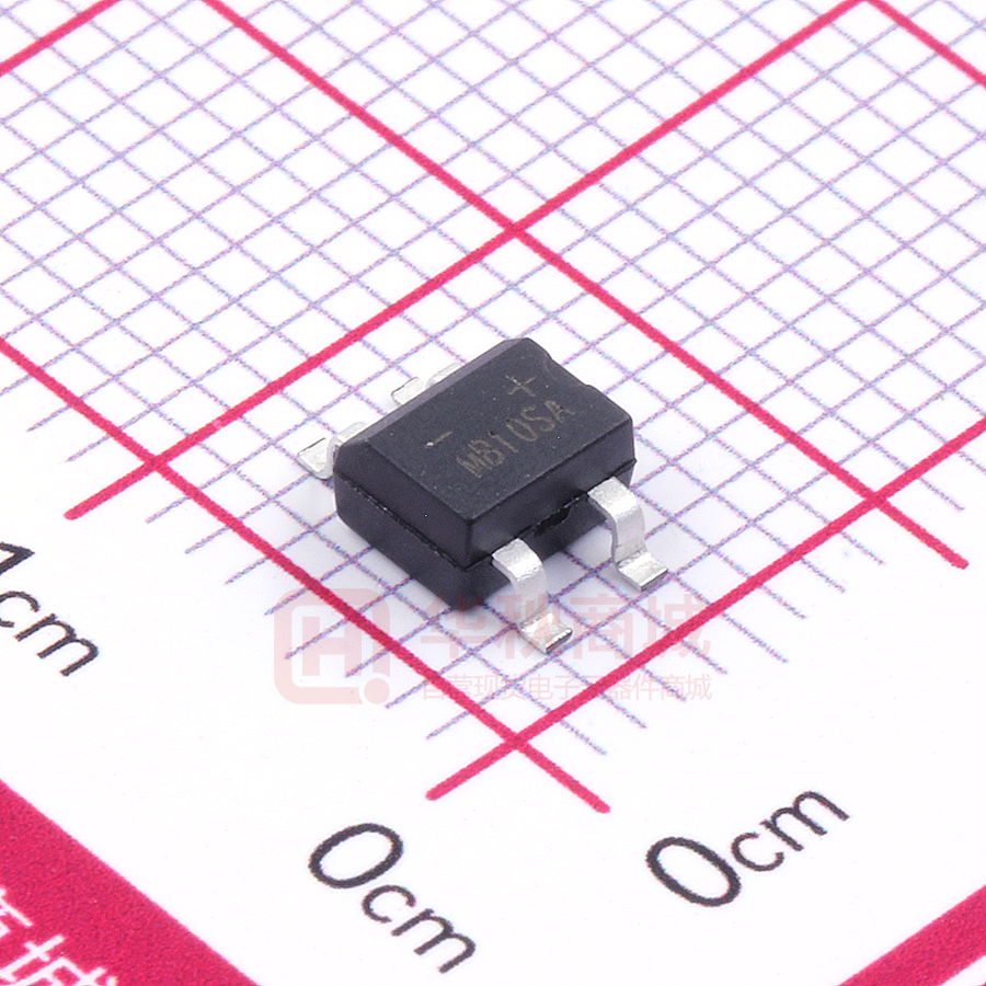

RoHS MB1SA THRU MB10SA COMPLIANT Bridge Rectifiers Features ● UL recognition,file #E313149 ● Ideal for automated placement ● High surge current capability ● Meets MSL level 1, per J-STD-020, LF maximum peak of 260 °C Typical Applications General purpose use in AC/DC bridge full wave rectification for power supply, lighting ballast, battery charger, home appliances, office equipment, and telecommunication applications. Mechanical Data ● Package: MBS Molding compound meets UL 94 V-0 flammability rating, RoHS-compliant ● Terminals: Tin plated leads, solderable per J-STD-002 and JESD22-B102 ● Polarity: As marked on body ■Maximum Ratings (Ta=25℃ Unless otherwise specified) PARAMETER SYMBOL UNIT Device marking code MB1SA MB2SA MB4SA MB6SA MB8SA MB10SA MB1SA MB2SA MB4SA MB6SA MB8SA MB10SA Repetitive peak reverse voltage VRRM V 100 200 400 600 800 1000 RMS Bridge input Voltage VRMS V 70 140 280 420 560 700 VDC V 100 200 400 600 800 1000 IO A DC Reverse Voltage On alumina substrate Average rectified output current @60Hz sine wave, On glass-epoxi R-load, Ta=40℃ substrate Surge(non-repetitive)forward current @60Hz half sine wave, 1 cycle, Tj=25℃ 1.0 0.8 IFSM A 35 It 2 A2S 5.1 Storage temperature Tstg ℃ -55 ~+150 Junction temperature Tj ℃ -55 ~+150 Current squared time @1ms≤t≤8.3ms Tj=25℃,rating of per diode ■Electrical Characteristics(Ta=25℃ Unless otherwise specified) PARAMETER Maximum instantaneous forward voltage drop per diode Maximum DC reverse current at rated DC blocking voltage per diode SYMBOL UNIT TEST CONDITIONS VF V IFM=0.5A IRRM μA VRM=VRRM MB1SA MB2SA MB4SA MB6SA MB8SA MB10SA 1.00 5 1/4 S-S752 Rev. 2.1, 27-Apr-16 Yangzhou Yangjie Electronic Technology Co., Ltd. www.21yangjie.com MB1SA THRU MB10SA ■Thermal Characteristics (Ta=25℃ Unless otherwise specified) PARAMETER SYMBOL Between junction and ambient, On alumina substrate Between junction and ambient, On glassepoxi substrate Between junction and lead Thermal Resistance UNIT MB1SA MB2SA MB4SA RθJ-A RθJ-A MB6SA MB8SA MB10SA 76.0 ℃/W 134.0 RθJ-L 20.0 ■Ordering Information (Example) PREFERED P/N PACKING CODE UNIT WEIGHT(g) MINIIMUM PACKAGE(pcs) INNER BOX QUANTITY(pcs) MB1SA-MB10SA F1 Approximate 0.12 2500 5000 OUTER CARTON DELIVERY MODE QUANTITY(pcs) 40000 13’ reel ■ Characteristics(Typical) FIG1:Io-Ta Curve FIG2:Surge Forward Current Capability 1.2 ① 1mm×1mm 35um ② 1mm×1mm 20um 0.64mm 35 ②.on alumina substrate 1.0 0.8 0.6 0.4 ①.on glass-epoxi substrate 0 30 25 non-repetitive Tj=25℃ 20 15 10 0 0 40 80 120 Ambient Temperature(°C) ` 1 160 FIG3: Forward Voltage 2 5 10 20 Number of Cycles 50 100 FIG4:Typical Reverse Characteristics 100 6 4 Tj=150℃ Instantaneous Reverse Current (uA) Instantaneous Forward Current (A) 8.3ms 8.3ms 1cycle 5 0.2 0 half sine wave IFSM soldering land conductor layer substrate thickness Peak Forward Surge Current(A) Average Forward Output Current(A) 1.4 2 1 0.5 Ta=25℃ 0.1 0.05 10 1.0 Tj=25℃ 0.1 0.02 0.01 0.01 0.4 0.6 0.8 1.0 1.2 Instantaneous Forward Voltage (V) 0 1.4 20 40 60 80 Percent of Rated Peak Reverse Voltage (%) 100 2/4 S-S752 Rev. 2.1, 27-Apr-16 Yangzhou Yangjie Electronic Technology Co., Ltd. www.21yangjie.com MB1SA THRU MB10SA ■ Outline Dimensions MBS H MBS I A J B L C K D E F Dim Min Max A 3.60 4.00 B C 2.20 2.60 D 4.50 4.90 E 2.30 2.70 F Dimensions in millimeters 3.00 Max G 0.56 0.84 H 0.15 0.35 I 1.10 2.12 J G 7.00 Max 0.20 Max K 0.70 1.10 L 0.95 1.53 ■ Suggested pad layout P2 Dim Min P1 6.00 P2 2.40 Q1 1.84 Q2 1.20 P1 Q1 Q2 Dimensions in millimeters 3/4 S-S752 Rev. 2.1, 27-Apr-16 Yangzhou Yangjie Electronic Technology Co., Ltd. www.21yangjie.com MB1SA THRU MB10SA Disclaimer The information presented in this document is for reference only. Yangzhou Yangjie Electronic Technology Co., Ltd. reserves the right to make changes without notice for the specification of the products displayed herein to improve reliability, function or design or otherwise. The product listed herein is designed to be used with ordinary electronic equipment or devices, and not designed to be used with equipment or devices which require high level of reliability and the malfunction of with would directly endanger human life (such as medical instruments, transportation equipment, aerospace machinery, nuclear-reactor controllers, fuel controllers and other safety devices), Yangjie or anyone on its behalf, assumes no responsibility or liability for any damages resulting from such improper use of sale. This publication supersedes & replaces all information previously supplied. For additional information, please visit our website http:// www.21yangjie.com , or consult your nearest Yangjie’s sales office for further assistance. 4/4 S-S752 Rev. 2.1, 27-Apr-16 Yangzhou Yangjie Electronic Technology Co., Ltd. www.21yangjie.com
