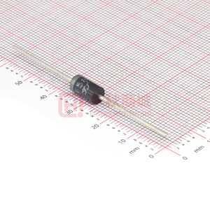

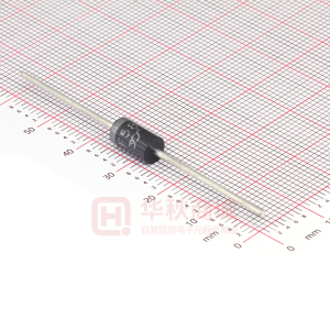

SF51 THRU SF58 超快恢复二极管 Super Fast Rectifier ■特征 Features ■外形尺寸和印记 Outline Dimensions and Mark (DO-201AD ) .375(9.50) 1.0(25.4) MIN .335(8.50) 1.0(25.4) MIN ●Io 5.0A ●VRRM 50V-600V ●耐正向浪涌电流能力高 ●High surge current capability ■用途 Applications ●整流用 Rectifier .197(5.00) .048(1.20) Unit: in inches (millimeters) ■极限值(绝对最大额定值) Limiting Values (Absolute Maximum Rating) 参数名称 Item 反向重复峰值电压 Repetitive Peak Reverse Voltage 正向平均电流 Average Forward Current 正向(不重复)浪涌电流 Surge(Non-repetitive)Forward Current 结温 Junction Temperature 储存温度 Storage Temperature 符号 Symb ol VRRM IF(AV) IFSM TJ TSTG 单位 Unit V A 条件 Conditions 51 50 正弦半波 60Hz,电阻负载,Ta=50℃ 60Hz Half-sine wave, Resistance load, Ta=50℃ 正弦半波 60Hz, 一个周期, Ta=25℃ 60Hz Half-sine wave,1 cycle, Ta=25℃ SF 52 100 53 150 54 200 5.0 55 300 56 400 57 500 DIA .220(5.60) .052(1.30) 58 600 A ℃ ℃ 150 -55~+125 -55 ~ +150 ■电特性 (Ta=25℃ 除非另有规定) Electrical Characteristics (Ta=25℃ Unless otherwise specified) 参数名称 Item 正向峰值电压 Peak Forward Voltage 反向峰值电流 Peak Reverse Current 反向恢复时间 Reverse Recovery time 热阻(典型) Thermal Resistance(Typical) 符号 Symbol VFM IRRM1 IRRM2 trr RθJ-A 单位 Unit V μA ns 测试条件 Test Condition IFM=5.0A VRM=VRRM Ta=25℃ SF 51 52 0.95 5 50 35 30 10 53 54 55 1.3 56 57 1.7 58 ℃/W RθJ-L Ta=125℃ IF=0.5A IR=1A IRR=0.25A 结和环境之间 Between junction and ambient 结和引线之间 Between junction and lead Document Number 0154 Rev. 1.0, 22-Sep-11 扬州扬杰电子科技股份有限公司 Yangzhou Yangjie Electronic Technology Co., Ltd. www.21yangjie.com SF51 THRU SF58 ■特性曲线 (典型) Characteristics(Typical) 图1: 正向电流降额曲线 FIG.1: FORWARD CURRENT DERATING CURVE IO(A) 5.0 图2: 最大正向浪涌冲击耐受力 FIG.2: MAXIMUM NON-REPETITIVE FORWARD SURGE CURRENT IFSM(A) 200 170 8.3毫秒正弦半波 8.3ms Single Half Sine Wave JEDEC Method 4.0 140 3.0 110 2.0 90 60 1.0 单相半波电压电阻和电感负载 0.375”(9.5毫米)引线长度 Single Phase Half Wave 60Hz Resistive or Inductive Load 0.375''(9.5mm) Lead Length 0 25 50 100 150 Ta(℃) 30 0 0 1 2 10 20 周波数 100 Number of Cycles IR(uA) 图3: 典型正向特性曲线 FIG.3: TYPICAL FORWARD CHARACTERISTICS IF(A) 20 10 4.0 2.0 1.0 0.4 0.2 0.1 TJ=25℃ Pulse width=300us 1% Duty Cycle 0.02 0.01 0.2 0.4 0.6 0.8 1.0 1.2 1.4 1.6 VF(V) SF51-SF54 SF55-SF56 图4: 典型反向特性曲线 FIG.4:TYPICAL REVERSE CHARACTERISTICS 1000 100 SF57-SF58 Tj=125℃ 10 Tj=100℃ 1.0 Tj=25℃ 0.1 0.01 0 20 40 60 80 100 Voltage(%) 图 5: 反 向恢复时间试验电路及测试波形示意图 F IG.5: Diagram of circuit and Testing wave form of reverse recovery time I D IF trr VR IF RL 0 IRR t IR Document Number 0154 Rev. 1.0, 22-Sep-11 扬州扬杰电子科技股份有限公司 Yangzhou Yangjie Electronic Technology Co., Ltd. www.21yangjie.com
