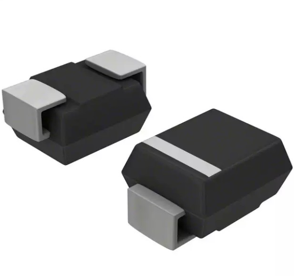

    TVS二极管 VRWM=26V VBR(Min)=28.9V VC=42.1V IPP=14.25A Ppp=600W SMB
SMBJ26A 数据手册
SMBJ SERIES 瞬变电压抑制二极管 Transient Voltage Suppressor Diodes ■特征 Features ■外形尺寸和印记 Outline Dimensions and Mark DO-214AA(SMB) .0 85(2.15) .0 73(1.85) .1 87(4.75) .1 67(4.25) .1 03(2.61) .0 78(1.99) .056 (1.4 1) .035 (0.9 0) .0 08(0.20) .0 04(0.10) .220 (5.5 9) .205 (5.2 1) .155 (3.9 4) .130 (3.3 0) ●PPP 600W ●VBR 5.0V-188V M ounting P ad Layout 0.069 (1.76) 0.1 07 (2 .72) 0 .08 1(2 .072) ■用途  Applications  ●箝位电压用  Clamping Voltage .0 12(0.31) .0 06(0.15) 0 .228 (5.8 0) D im ensions in inches and (m illim eters) ■极限值(绝对最大额定值)  Limiting Values (Absolute Maximum Rating) 参数名称 Item 最大损耗功率(1)(2) Peak power dissipation 最大脉冲电流(1) Peak pulse current 最大正向浪涌电流(2) Peak forward surge current 工作结温和存储温度范围 Operating junction and storage temperature range 符号 Symbol PPPM IPPM IFSM TJ,TSTG 单位 Unit W A A ℃ 条件 Conditions 在10/1000us 波形下测试 with a 10/1000us waveform 在10/1000us 波形下测试 with a 10/1000us waveform 8.3ms正弦半波,仅单向型 8.3 ms single half sine-wave unidirectional only 最大值 Max 600 见下面表格 See Next Table 100 -55 to +150 ■电特性 (Ta=25℃ 除非另有规定) Electrical Characteristics(Ta=25℃ Unless otherwise specified) 参数名称 Item 最大瞬间正向电压 Maximum instantaneous forward Voltage 典型热阻 Thermal resistance 符号 Symbol VF 单位 Unit V 条件 Conditions 在50A下测试,仅单向型 at 50A for unidirectional only 结到引线 junction to lead 结到环境 junction to ambient 最大值 Max 3.5 RθJL RθJA ℃/W ℃/W 20 100 备注:Notes: (1) 不重复脉冲电流,如图3,在TA= 25℃下功率降额曲线见如图2。 Non-repetitive current pulse, per Fig. 3 and derated above TA= 25℃ per Fig.2. (2) 每个端子安装在 0.2 x 0.2" (5.0 x 5.0 mm)铜焊盘上 Mounted on 0.2 x 0.2" (5.0 x 5.0 mm) copper pads to each terminal Document Number 0240 Rev. 1.0, 22-Sep-11 扬州扬杰电子科技体股份有限公司 Yangzhou Yangjie Electronic Technology Co., Ltd.  www.21yangjie.com SMBJ SERIES ■电性参数 (TA=25℃ 除非另有规定) Electrical Characteristics (TA =25℃ unless otherwise noted) 产品型号(单 向) Part Number(Uni) SMBJ5.0 SMBJ5.0A SMBJ6.0 SMBJ6.0A SMBJ6.5 SMBJ6.5A SMBJ7.0 SMBJ7.0A SMBJ7.5 SMBJ7.5A SMBJ8.0 SMBJ8.0A SMBJ8.5 SMBJ8.5A SMBJ9.0 SMBJ9.0A SMBJ10 SMBJ10A SMBJ11 SMBJ11A SMBJ12 SMBJ12A SMBJ13 SMBJ13A SMBJ14 SMBJ14A SMBJ15 SMBJ15A SMBJ16 SMBJ16A SMBJ17 SMBJ17A SMBJ18 SMBJ18A SMBJ20 SMBJ20A 产品型号(双 向) Part Number(Bi) SMBJ5.0C SMBJ5.0CA SMBJ6.0C SMBJ6.0CA SMBJ6.5C SMBJ6.5CA SMBJ7.0C SMBJ7.0CA SMBJ7.5C SMBJ7.5CA SMBJ8.0C SMBJ8.0CA SMBJ8.5C SMBJ8.5CA SMBJ9.0C SMBJ9.0CA SMBJ10C SMBJ10CA SMBJ11C SMBJ11CA SMBJ12C SMBJ12CA SMBJ13C SMBJ13CA SMBJ14C SMBJ14CA SMBJ15C SMBJ15CA SMBJ16C SMBJ16CA SMBJ17C SMBJ17CA SMBJ18C SMBJ18CA SMBJ20C SMBJ20CA (4) 击穿电压 VBR@IT Breakdown Voltage VBR@IT 最小 Min(V) 6.40 6.40 6.67 6.67 7.22 7.22 7.78 7.78 8.33 8.33 8.89 8.89 9.44 9.44 10.0 10.0 11.1 11.1 12.2 12.2 13.3 13.3 14.4 14.4 15.6 15.6 16.7 16.7 17.8 17.8 18.9 18.9 20.0 20.0 22.2 22.2 最大 Max (V) 7.82 7.07 8.15 7.37 8.82 7.98 9.51 8.60 10.2 9.21 10.9 9.83 11.5 10.4 12.2 11.1 13.6 12.3 14.9 13.5 16.3 14.7 17.6 15.9 19.1 17.2 20.4 18.5 21.8 19.7 23.1 20.9 24.4 22.1 27.1 24.5 测试电流 IT(1)(mA) 10 10 10 10 10 10 10 10 1.0 1.0 1.0 1.0 1.0 1.0 1.0 1.0 1.0 1.0 1.0 1.0 1.0 1.0 1.0 1.0 1.0 1.0 1.0 1.0 1.0 1.0 1.0 1.0 1.0 1.0 1.0 1.0 最大反向漏电 流 IR @VWM Maximum Reverse Leakage IR (3) (μA) 800 800 800 800 500 500 200 200 100 100 50 50 10 10 5.0 5.0 1.0 1.0 1.0 1.0 1.0 1.0 1.0 1.0 1.0 1.0 1.0 1.0 1.0 1.0 1.0 1.0 1.0 1.0 1.0 1.0 最大工作电压 VRWM Working Peak Reverse Voltage VRWM (V) 5.0 5.0 6.0 6.0 6.5 6.5 7.0 7.0 7.5 7.5 8.0 8.0 8.5 8.5 9.0 9.0 10 10 11 11 12 12 13 13 14 14 15 15 16 16 17 17 18 18 20 20 最大反向浪涌 电流 IPP Maximum Reverse Surge Current IPP(2) (A) 62.5 65.2 52.6 58.3 48.8 53.6 45.1 50.0 42.0 46.5 40.0 44.1 37.7 41.7 35.5 39.0 31.9 35.3 29.9 33.0 27.3 30.2 25.2 27.9 23.3 25.9 22.3 24.6 20.8 23.1 19.7 21.7 18.6 20.5 16.8 18.5 最大箝位电压 Maximum Clamping Voltage Vc @ IPP (V) 9.6 9.2 11.4 10.3 12.3 11.2 13.3 12.0 14.3 12.9 15.0 13.6 15.9 14.4 16.9 15.4 18.8 17.0 20.1 18.2 22.0 19.9 23.8 21.5 25.8 23.2 26.9 24.4 28.8 26.0 30.5 27.6 32.2 29.2 35.8 32.4 Document Number 0240 Rev. 1.0, 22-Sep-11 扬州扬杰电子科技体股份有限公司 Yangzhou Yangjie Electronic Technology Co., Ltd.  www.21yangjie.com SMBJ SERIES ■电性参数 (TA =25℃ 除非另有规定) Electrical Characteristics (TA =25℃ unless otherwise noted) 产品型号 (单向) Part Number(Uni) SMBJ22 SMBJ22A SMBJ24 SMBJ24A SMBJ26 SMBJ26A SMBJ28 SMBJ28A SMBJ30 SMBJ30A SMBJ33 SMBJ33A SMBJ36 SMBJ36A SMBJ40 SMBJ40A SMBJ43 SMBJ43A SMBJ45 SMBJ45A SMBJ48 SMBJ48A SMBJ51 SMBJ51A SMBJ54 SMBJ54A SMBJ58 SMBJ58A SMBJ60 SMBJ60A SMBJ64 SMBJ64A SMBJ70 SMBJ70A SMBJ75 SMBJ75A 产品型号 (双向) Part Number(Bi) SMBJ22C SMBJ22CA SMBJ24C SMBJ24CA SMBJ26C SMBJ26CA SMBJ28C SMBJ28CA SMBJ30C SMBJ30CA SMBJ33C SMBJ33CA SMBJ36C SMBJ36CA SMBJ40C SMBJ40CA SMBJ43C SMBJ43CA SMBJ45C SMBJ45CA SMBJ48C SMBJ48CA SMBJ51C SMBJ51CA SMBJ54C SMBJ54CA SMBJ58C SMBJ58CA SMBJ60C SMBJ60CA SMBJ64C SMBJ64CA SMBJ70C SMBJ70CA SMBJ75C SMBJ75CA 击穿电压 VBR@IT Breakdown Voltage VBR@IT 最小 Min(V) 24.4 24.4 26.7 26.7 28.9 28.9 31.1 31.1 33.3 33.3 36.7 36.7 40.0 40.0 44.4 44.4 47.8 47.8 50.0 50.0 53.3 53.3 56.7 56.7 60.0 60.0 64.4 64.4 66.7 66.7 71.1 71.1 77.8 77.8 83.3 83.3 最大 Max (V) 29.8 26.9 32.6 29.5 35.3 31.9 38.0 34.4 40.7 36.8 44.9 40.6 48.9 44.2 54.3 49.1 58.4 52.8 61.1 55.3 65.1 58.9 69.3 62.7 73.3 66.3 78.7 71.2 81.5 73.7 86.9 78.6 95.1 86.0 102 92.1 测试电 流 IT(1)(mA) 1.0 1.0 1.0 1.0 1.0 1.0 1.0 1.0 1.0 1.0 1.0 1.0 1.0 1.0 1.0 1.0 1.0 1.0 1.0 1.0 1.0 1.0 1.0 1.0 1.0 1.0 1.0 1.0 1.0 1.0 1.0 1.0 1.0 1.0 1.0 1.0 最大反向漏电 流 IR @VWM Maximum Reverse Leakage IR (3) (μA) 1.0 1.0 1.0 1.0 1.0 1.0 1.0 1.0 1.0 1.0 1.0 1.0 1.0 1.0 1.0 1.0 1.0 1.0 1.0 1.0 1.0 1.0 1.0 1.0 1.0 1.0 1.0 1.0 1.0 1.0 1.0 1.0 1.0 1.0 1.0 1.0 最大工作电压 VRWM Working Peak Reverse Voltage VRWM (V) 22 22 24 24 26 26 28 28 30 30 33 33 36 36 40 40 43 43 45 45 48 48 51 51 54 54 58 58 60 60 64 64 70 70 75 75 最大反向浪涌 电流 IPP Maximum Reverse Surge Current IPP(2) (A) 15.2 16.9 14.0 15.4 12.9 14.3 12.0 13.2 11.2 12.4 10.2 11.3 9.3 10.3 8.4 9.3 7.8 8.6 7.5 8.3 7.0 7.8 6.6 7.3 6.2 6.9 5.8 6.4 5.6 6.2 5.3 5.8 4.8 5.3 4.5 5.0 最大箝位电压 Maximum Clamping Voltage Vc @ IPP (V) 39.4 35.5 43.0 38.9 46.6 42.1 50.0 45.4 53.5 48.4 59.0 53.3 64.3 58.1 71.4 64.5 76.7 69.4 80.3 72.7 85.5 77.4 91.1 82.4 96.3 87.1 103 93.6 107 96.8 114 103 125 113 134 121 Document Number 0240 Rev. 1.0, 22-Sep-11 扬州扬杰电子科技体股份有限公司 Yangzhou Yangjie Electronic Technology Co., Ltd.  www.21yangjie.com SMBJ SERIES ■电性参数 (TA =25℃ 除非另有规定) Electrical Characteristics (TA =25℃ unless otherwise noted) 产品型号(单 向) Part Number(Uni) SMBJ78 SMBJ78A SMBJ85 SMBJ85A SMBJ90 SMBJ90A SMBJ100 SMBJ100A SMBJ110 SMBJ110A SMBJ120 SMBJ120A SMBJ130 SMBJ130A SMBJ150 SMBJ150A SMBJ160 SMBJ160A SMBJ170 SMBJ170A SMBJ188 SMBJ188A 产品型号(双 向) Part Number(Bi) SMBJ78C SMBJ78CA SMBJ85C SMBJ85CA SMBJ90C SMBJ90CA SMBJ100C SMBJ100CA SMBJ110C SMBJ110CA SMBJ120C SMBJ120CA SMBJ130C SMBJ130CA SMBJ150C SMBJ150CA SMBJ160C SMBJ160CA SMBJ170C SMBJ170CA SMBJ188C SMBJ188CA 击穿电压 VBR@IT Breakdown Voltage VBR@IT 最小 Min(V) 86.7 86.7 94.4 94.4 100 100 111 111 122 122 133 133 144 144 167 167 178 178 189 189 209 209 最大 Max (V) 106 95.8 115 104 122 111 136 123 149 135 163 147 176 159 204 185 218 197 231 209 255 231 测试电流 IT(1)(mA) 1.0 1.0 1.0 1.0 1.0 1.0 1.0 1.0 1.0 1.0 1.0 1.0 1.0 1.0 1.0 1.0 1.0 1.0 1.0 1.0 1.0 1.0 最大反向漏电 流 IR @VWM Maximum Reverse Leakage IR (3) (μA) 1.0 1.0 1.0 1.0 1.0 1.0 1.0 1.0 1.0 1.0 1.0 1.0 1.0 1.0 1.0 1.0 1.0 1.0 1.0 1.0 1.0 1.0 最大工作电压 VRWM Working Peak Reverse Voltage VRWM (V) 78 78 85 85 90 90 100 100 110 110 120 120 130 130 150 150 160 160 170 170 188 188 最大反向浪涌 电流 IPP Maximum Reverse Surge Current IPP(2) (A) 4.3 4.8 4.0 4.4 3.8 4.1 3.4 3.7 3.1 3.4 2.8 3.1 2.6 2.9 2.2 2.5 2.1 2.3 2.0 2.2 1.7 2.0 最大箝位电压 Maximum Clamping Voltage Vc @ IPP (V) 139 126 151 137 160 146 179 162 196 177 214 193 231 209 268 243 287 259 304 275 344 328 备注:Notes: (1) 脉冲测试:tp≤50ms Pulse test: tp≤50ms (2) 浪涌电流波形,如图3,功率降额曲线如图2。 Surge current waveform per Fig. 3 and derated per Fig.2. (3) 对于双向型,VWM在10V及10V以下,IR值加倍 For bi-directional types having VWM of 10 V and less, the IR limit is doubled (4) 对于双向SMBJ5.0CA,VBR最大值为7.25V For the bi-directional SMBJ5.0CA, the maximum VBR is 7.25 V Document Number 0240 Rev. 1.0, 22-Sep-11 扬州扬杰电子科技体股份有限公司 Yangzhou Yangjie Electronic Technology Co., Ltd.  www.21yangjie.com SMBJ SERIES ■特性曲线(典型) Characteristics(Typical) 图1:最大脉冲功率曲线 FIG1:Peak Pulse Power Rating Curve PPPM(KW) PPP or IPP(%) 图 2 :脉冲功率或电流与结温关系 FIG2: Pulse Power or Current vs. Initial Junction Temperature 100 100 不重复脉冲波形见图 3 Non-Repetitive Pulse Waveform shown in Fige.3 TA=25 ℃ 75 10 50 1.0 25 0.1 0.2×0.2"(5.0×5.0mm) Copper Pad Areas 0.1μs 1μs 10μs 100μs 1.0ms 10ms td(μs) 图 3:脉冲波形 FIG3: Pulse Waveform 0 0 25 50 75 100 125 150 175 200 TJ (℃) 图 4 :典型瞬态热阻 FIG4:Typical Transient Thermal Impedance Rth(℃/W) 4.0 t( ms ) IPPM(%) 150 100 tr=10μs Peak Value IPPM TJ=25 ℃ Pulse Width(td) is defined as the Point where the Peak Current Decays to 50% of IPPM 100 10 Half Value - IPP 2 IPPM 50 10/1000 μs Waveform as Defined by R.E.A. 1 td 0 0 1.0 2.0 3.0 0.1 0.001 0.01 0.1 1 10 100 1000 tp(s) 图 5:最大不重复浪涌电流 FIG5: Maximum Non-Repetitive Surge Current IFSM(A) 200 TJ=TJMax. 8.3 毫秒正弦半波 8.3ms Single Half Sine-Wave 100 50 10 0 10 周 波数 100 Number of Cycles Document Number 0240 Rev. 1.0, 22-Sep-11 扬州扬杰电子科技体股份有限公司 Yangzhou Yangjie Electronic Technology Co., Ltd.  www.21yangjie.com
