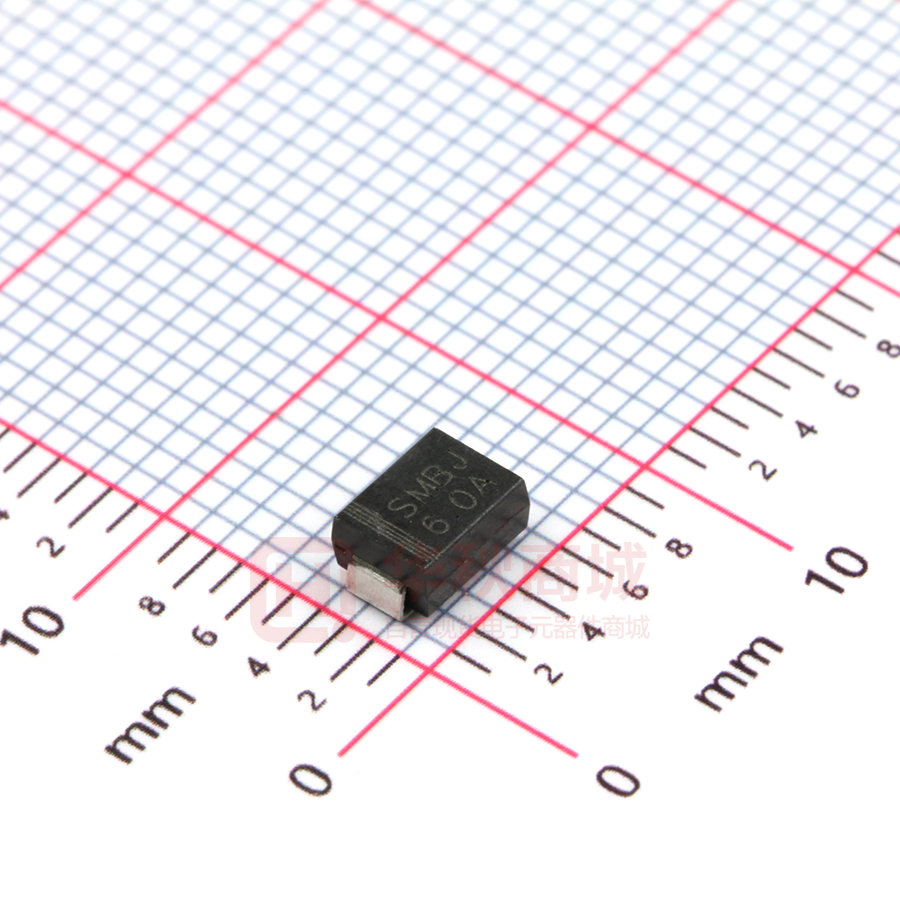

SMBJ SERIES 瞬变电压抑制二极管 Transient Voltage Suppressor Diodes
■特征 Features ■外形尺寸和印记 Outline Dimensions and Mark
DO-214AA(SMB)
.0 85(2.15) .0 73(1.85) .1 87(4.75) .1 67(4.25) .1 03(2.61) .0 78(1.99) .056 (1.4 1) .035 (0.9 0) .0 08(0.20) .0 04(0.10) .220 (5.5 9) .205 (5.2 1) .155 (3.9 4) .130 (3.3 0)
●PPP 600W ●VBR 5.0V-188V
