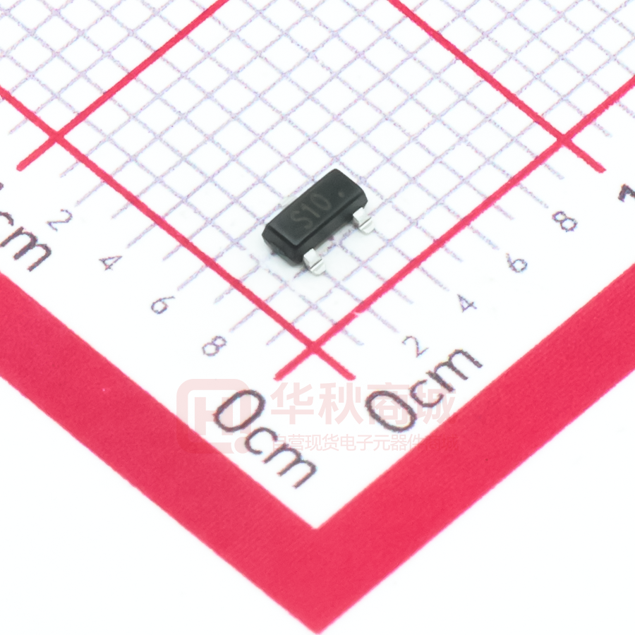

    MOSFETs N-沟道 60V 3A SOT-23
YJL03N06A 数据手册
RoHS YJL03N06A COMPLIANT N-Channel Enhancement Mode Field Effect Transistor Product Summary ● VDS ● ID ● RDS(ON)( at VGS=10V) ● RDS(ON)( at VGS=4.5V) 60V 3.0A <100 mohm <120 mohm General Description ● Trench Power MV MOSFET technology ● Excellent package for heat dissipation ● High density cell design for low RDS(ON) Applications ● DC-DC Converters ● Power management functions ■ Absolute Maximum Ratings (TA=25℃unless otherwise noted) Parameter Symbol Limit Drain-source Voltage VDS 60 V Gate-source Voltage VGS ±20 V TA=25℃ Drain Current 3 ID TA=70℃ Unit A 2.4 Pulsed Drain Current A IDM 12 A Total Power Dissipation @ TC=25℃ PD 1.2 W RθJA 105 ℃/ W TJ ,TSTG -55~+150 ℃ Thermal Resistance Junction-to-Ambient B Junction and Storage Temperature Range ■ Ordering Information (Example) PREFERED P/N PACKING CODE Marking MINIMUM PACKAGE(pcs) INNER BOX QUANTITY(pcs) OUTER CARTON QUANTITY(pcs) DELIVERY MODE YJL03N06A F2 S10. 3000 30000 120000 7“ reel 1/6 S-S1967 Rev.2.1,25-Dec-18 Yangzhou Yangjie Electronic Technology Co., Ltd. www.21yangjie.com YJL03N06A ■ Electrical Characteristics (TJ=25℃ unless otherwise noted) Parameter Symbol Conditions Min Typ Max Units Drain-Source Breakdown Voltage BVDSS VGS= 0V, ID=250μA 60 Zero Gate Voltage Drain Current IDSS VDS=60V,VGS=0V 1 μA IGSS1 VGS= ±20V, VDS=0V ±100 nA IGSS2 VGS= ±10V, VDS=0V ±50 nA Gate Threshold Voltage VGS(th) VDS= VGS, ID=250μA 1.3 2.0 V VGS= 10V, ID=3A 86 100 Static Drain-Source On-Resistance RDS(ON) VGS= 4.5V, ID=2A 92 120 IS=3.0A,VGS=0V 0.8 1.2 V 3.0 A Static Parameter V Gate-Body Leakage Current Diode Forward Voltage mΩ VSD Maximum Body-Diode Continuous Current 1.0 IS Dynamic Parameters Input Capacitance Ciss 330 Output Capacitance Coss Reverse Transfer Capacitance Crss 17 Total Gate Charge Qg 5.1 Gate-Source Charge Qgs Gate-Drain Charge Qgd 1.7 Turn-on Delay Time tD(on) 13 Turn-on Rise Time tr VDS=30V,VGS=0V,f=1MHZ 90 pF Switching Parameters VGS=10V,VDS=30V,ID=3.0A 1.3 51 VGS=10V,VDD=30V, ID=1.5A,RL=1Ω RGEN=3Ω Turn-off Delay Time Turn-off fall Time A. B. nC ns tD(off) 19 tf 12 Pulse Test: Pulse Width≤300us,Duty cycle ≤2%. Device mounted on FR-4 PCB, 1 inch x 0.85 inch x 0.062 inch. 2/6 S-S1967 Rev.2.1,25-Dec-18 Yangzhou Yangjie Electronic Technology Co., Ltd. www.21yangjie.com YJL03N06A ■ Typical Performance Characteristics Figure1. Output Characteristics Figure2. Transfer Characteristics Figure3. Capacitance Characteristics Figure4. Gate Charge Figure5. Drain-Source on Resistance Figure6. Drain-Source on Resistance 3/6 S-S1967 Rev.2.1,25-Dec-18 Yangzhou Yangjie Electronic Technology Co., Ltd. www.21yangjie.com YJL03N06A Figure7. Safe Operation Area Figure8. Switching wave 4/6 S-S1967 Rev.2.1,25-Dec-18 Yangzhou Yangjie Electronic Technology Co., Ltd. www.21yangjie.com YJL03N06A ■ SOT-23 Package information ■ SOT-23 Suggested Pad Layout 5/6 S-S1967 Rev.2.1,25-Dec-18 Yangzhou Yangjie Electronic Technology Co., Ltd. www.21yangjie.com YJL03N06A Disclaimer The information presented in this document is for reference only. Yangzhou Yangjie Electronic Technology Co., Ltd. reserves the right to make changes without notice for the specification of the products displayed herein to improve reliability, function or design or otherwise. The product listed herein is designed to be used with ordinary electronic equipment or devices, and not designed to be used with equipment or devices which require high level of reliability and the malfunction of with would directly endanger human life (such as medical instruments, transportation equipment, aerospace machinery, nuclear-reactor controllers, fuel controllers and other safety devices), Yangjie or anyone on its behalf, assumes no responsibility or liability for any damages resulting from such improper use of sale. This publication supersedes & replaces all information previously supplied. For additional information, please visit our website http:// www.21yangjie.com , or consult your nearest Yangjie’s sales office for further assistance. 6/6 S-S1967 Rev.2.1,25-Dec-18 Yangzhou Yangjie Electronic Technology Co., Ltd. www.21yangjie.com
