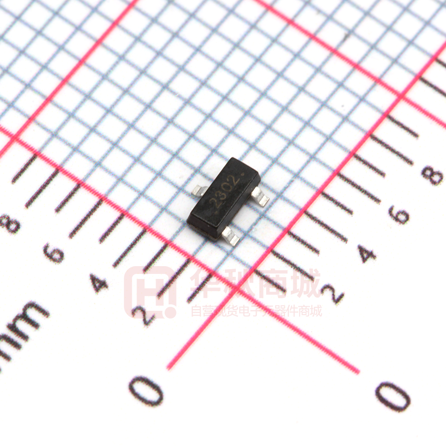

    MOSFET SOT23-3 N-Channel ID=4.3A
YJL2302A 数据手册
RoHS YJL2302A COMPLIANT N-Channel Enhancement Mode Field Effect Transistor Product Summary ● VDS ● ID ● RDS(ON)( at VGS= 4.5V) ● RDS(ON)( at VGS= 2.5V) 20V 4.3A < 27mohm < 37mohm General Description ● Trench Power LV MOSFET technology ● High Density Cell Design for Low RDS(ON) ● High Speed switching Applications ● Battery protection ● Load switch ● Power management ■ Absolute Maximum Ratings (TA=25℃unless otherwise noted) Parameter Symbol Limit Drain-source Voltage VDS 20 V Gate-source Voltage VGS ±10 V TA=25℃ Unit 4.3 Drain Current ID A TA=70℃ 3.4 Pulsed Drain Current A IDM 17.2 A Total Power Dissipation @ TA=25℃ Steady State PD 1 W Thermal Resistance Junction-to-Ambient B RθJA 125 ℃/ W Junction and Storage Temperature Range TJ ,TSTG -55~+150 ℃ ■ Ordering Information (Example) PREFERED P/N PACKING CODE Marking MINIMUM PACKAGE(pcs) INNER BOX QUANTITY(pcs) OUTER CARTON QUANTITY(pcs) DELIVERY MODE YJL2302A F2 .2302. 3000 30000 120000 7“ reel 1/7 S-E667 Rev.3.0,11-Nov-20 Yangzhou Yangjie Electronic Technology Co., Ltd. www.21yangjie.com YJL2302A ■ Electrical Characteristics (TJ=25℃ unless otherwise noted) Parameter Symbol Conditions Min Typ Max Units Drain-Source Breakdown Voltage BVDSS VGS=0V, ID= 250μA 20 Zero Gate Voltage Drain Current IDSS VDS= 20V,VGS=0V 1 μA IGSS VGS=±10V, VDS=0V ±100 nA VGS(th) VDS= VGS, ID= 250μA 0.85 1.25 V VGS= 4.5V, ID= 4.3A 21 27 VGS= 2.5V, ID= 3.0A 28 37 IS= 4.3A,VGS=0V 0.8 1.2 Static Parameter Gate-Body Leakage Current Gate Threshold Voltage Static Drain-Source On-Resistance Diode Forward Voltage 0.55 V RDS(ON) VSD mΩ V Dynamic Parameters Input Capacitance Ciss 602 Output Capacitance Coss Reverse Transfer Capacitance Crss 62 Total Gate Charge Qg 6.5 Gate-Source Charge Qgs Gate-Drain Charge Qgd Reverse Recovery Chrage Qrr VDS=20V,VGS=0V,f=1MHZ 79 pF Switching Parameters VGS= 4.5V,VDS= 10V,ID= 4.3A 1.6 nC 1.5 0.6 IF= 15A, di/dt=100A/us Reverse Recovery Time trr 9.9 Turn-on Delay Time tD(on) 8 Turn-on Rise Time tr Turn-off Delay Time tD(off) Turn-off fall Time VGS= 4.5V, VDS= 10V, ID= 6.7A RGEN= 3Ω tf 58 ns 20 68 A. Pulse Test: Pulse Width≤300us,Duty cycle ≤2%. B. RθJA is the sum of the junction-to-lead and lead-to-ambient thermal resistance, where the lead thermal reference is defined as the solder mounting surface of the drain pins. RθJL is guaranteed by design, while RθJA is determined by the board design. The maximum rating presented here is based on mounting on a 1 in 2 pad of 2oz copper. 2/7 S-E667 Rev.3.0,11-Nov-20 Yangzhou Yangjie Electronic Technology Co., Ltd. www.21yangjie.com YJL2302A ■ Typical Performance Characteristics Figure1. Output Characteristics Figure2. Transfer Characteristics Figure 3: On-Resistance vs. Drain Current and Gate Voltage Figure 4: On-Resistance vs. Junction Temperature Figure6. Gate Charge Figure5. Capacitance Characteristics 3/7 S-E667 Rev.3.0,11-Nov-20 Yangzhou Yangjie Electronic Technology Co., Ltd. www.21yangjie.com YJL2302A Figure8. Maximum Continuous Drain Current vs Ambient Temperature Figure7. Safe Operation Area Figure9. Normalized Maximum Transient Thermal Impedance 4/7 S-E667 Rev.3.0,11-Nov-20 Yangzhou Yangjie Electronic Technology Co., Ltd. www.21yangjie.com YJL2302A Resistive Switching Test Circuit & Waveforms Diode Recovery Test Circuit & Waveforms Gate Charge Test Circuit & Waveform Unclamped Inductive Switching (UIS) Test Circuit & Waveforms 5/7 S-E667 Rev.3.0,11-Nov-20 Yangzhou Yangjie Electronic Technology Co., Ltd. www.21yangjie.com YJL2302A ■ SOT-23 Package Information 6/7 S-E667 Rev.3.0,11-Nov-20 Yangzhou Yangjie Electronic Technology Co., Ltd. www.21yangjie.com YJL2302A Disclaimer The information presented in this document is for reference only. Yangzhou Yangjie Electronic Technology Co., Ltd. reserves the right to make changes without notice for the specification of the products displayed herein to improve reliability, function or design or otherwise. The product listed herein is designed to be used with ordinary electronic equipment or devices, and not designed to be used with equipment or devices which require high level of reliability and the malfunction of with would directly endanger human life (such as medical instruments, transportation equipment, aerospace machinery, nuclear-reactor controllers, fuel controllers and other safety devices), Yangjie or anyone on its behalf, assumes no responsibility or liability for any damages resulting from such improper use of sale. This publication supersedes & replaces all information previously supplied. For additional information, please visit our website http:// www.21yangjie.com , or consult your nearest Yangjie’s sales office for further assistance. 7/7 S-E667 Rev.3.0,11-Nov-20 Yangzhou Yangjie Electronic Technology Co., Ltd. www.21yangjie.com
