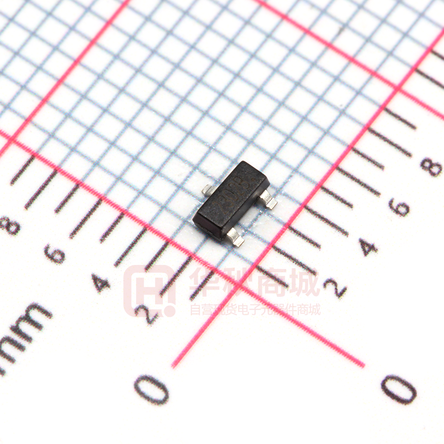

    MOSFET SOT23-3 N-Channel ID=3A
YJL2302B 数据手册
RoHS YJL2302B COMPLIANT N-Channel Enhancement Mode Field Effect Transistor Product Summary ● VDS ● ID ● RDS(ON)( at VGS=4.5V) ● RDS(ON)( at VGS=2.5V) 20V 3.0A <50 mohm <70 mohm General Description ● Trench Power LV MOSFET technology ● High Power and current handing capability Applications ● PWM application ● Load switch ■ Absolute Maximum Ratings (TA=25℃unless otherwise noted) Parameter Symbol Limit Drain-source Voltage VDS 20 V Gate-source Voltage VGS ±10 V TA=25℃ @ Steady State Drain Current 3.0 ID TA=70℃ @ Steady State Unit A 2.4 Pulsed Drain Current A IDM 14 A Total Power Dissipation @ TA=25℃ PD 0.7 W RθJA 178 ℃/ W TJ ,TSTG -55~+150 ℃ Thermal Resistance Junction-to-Ambient @ Steady State B Junction and Storage Temperature Range ■ Ordering Information (Example) PREFERED P/N PACKING CODE Marking MINIMUM PACKAGE(pcs) INNER BOX QUANTITY(pcs) OUTER CARTON QUANTITY(pcs) DELIVERY MODE YJL2302B F2 2302B. 3000 30000 120000 7“ reel 1/6 S-E064 Rev.3.0,30-Sep-20 Yangzhou Yangjie Electronic Technology Co., Ltd. www.21yangjie.com YJL2302B ■ Electrical Characteristics (TJ=25℃ unless otherwise noted) Parameter Symbol Conditions Min Typ Max Units Drain-Source Breakdown Voltage BVDSS VGS= 0V, ID=250μA 20 Zero Gate Voltage Drain Current IDSS VDS=20V,VGS=0V,TC=25℃ 1 μA IGSS VGS= ±10V, VDS=0V ±100 nA Gate Threshold Voltage VGS(th) VDS= VGS, ID=250μA 0.78 1.1 V 38.5 50 Static Drain-Source On-Resistance RDS(ON) Static Parameter Gate-Body Leakage Current 0.55 VGS= 4.5V, ID=3.0A mΩ VGS= 2.5V, ID=2.0A Diode Forward Voltage VSD Maximum Body-Diode Continuous Current V 53.5 IS=3.0A,VGS=0V IS 70 1.2 V 3.0 A Dynamic Parameters Input Capacitance Ciss 220 Output Capacitance Coss Reverse Transfer Capacitance Crss 26 Total Gate Charge Qg 3.61 Gate Source Charge Qgs Gate Drain Charge Qgd 0.77 Turn-on Delay Time tD(on) 6.8 Turn-on Rise Time tr Turn-off Delay Time tD(off) VDS=10V,VGS=0V,f=1MHZ 34 pF Switching Parameters Turn-off Fall Time VGS=4.5V,VDS=10V,ID=3.0A VGS=4.5V,VDD=10V, RL=1.5Ω, RGEN=3Ω tf 0.88 nC 57 ns 14 53 A. Pulse Test: Pulse Width≤300us,Duty cycle ≤2%. B. Device mounted on FR-4 PCB, 1 inch x 0.85 inch x 0.062 inch. 2/6 S-E064 Rev.3.0,30-Sep-20 Yangzhou Yangjie Electronic Technology Co., Ltd. www.21yangjie.com YJL2302B ■ Typical Performance Characteristics Figure1. Output Characteristics Figure2. Transfer Characteristics Figure3. Capacitance Characteristics Figure4. Gate Charge Figure5. Drain-Source on Resistance Figure6. Drain-Source on Resistance 3/6 S-E064 Rev.3.0,30-Sep-20 Yangzhou Yangjie Electronic Technology Co., Ltd. www.21yangjie.com YJL2302B Figure7. Safe Operation Area Figure8. Switching wave 4/6 S-E064 Rev.3.0,30-Sep-20 Yangzhou Yangjie Electronic Technology Co., Ltd. www.21yangjie.com YJL2302B ■SOT-23 Package information 5/6 S-E064 Rev.3.0,30-Sep-20 Yangzhou Yangjie Electronic Technology Co., Ltd. www.21yangjie.com YJL2302B Disclaimer The information presented in this document is for reference only. Yangzhou Yangjie Electronic Technology Co., Ltd. reserves the right to make changes without notice for the specification of the products displayed herein to improve reliability, function or design or otherwise. The product listed herein is designed to be used with ordinary electronic equipment or devices, and not designed to be used with equipment or devices which require high level of reliability and the malfunction of with would directly endanger human life (such as medical instruments, transportation equipment, aerospace machinery, nuclear-reactor controllers, fuel controllers and other safety devices), Yangjie or anyone on its behalf, assumes no responsibility or liability for any damages resulting from such improper use of sale. This publication supersedes & replaces all information previously supplied. For additional information, please visit our website http:// www.21yangjie.com , or consult your nearest Yangjie’s sales office for further assistance. 6/6 S-E064 Rev.3.0,30-Sep-20 Yangzhou Yangjie Electronic Technology Co., Ltd. www.21yangjie.com
