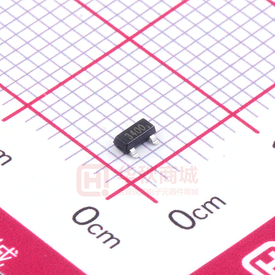

    MOSFETs N-沟道 30V 5.6A SOT-23
YJL3400A 数据手册
RoHS YJL3400A COMPLIANT N-Channel Enhancement Mode Field Effect Transistor Product Summary ● VDS ● ID ● RDS(ON)( at VGS=10V) ● RDS(ON)( at VGS=4.5V) ● RDS(ON)( at VGS=2.5V) 30V 5.6A <27 mohm <33 mohm <51 mohm General Description ● Trench Power LV MOSFET technology ● High density cell design for low RDS(ON) ● High Speed switching Applications ● Battery protection ● Load switch ● Power management ■ Absolute Maximum Ratings (TA=25℃unless otherwise noted) Parameter Symbol Limit Drain-source Voltage VDS 30 V Gate-source Voltage VGS ±12 V TA=25℃ @ Steady State Drain Current 5.6 ID TA=70℃ @ Steady State Unit A 4.5 Pulsed Drain Current A IDM 23 A Total Power Dissipation @ TA=25℃ PD 1.2 W RθJA 104 ℃/ W TJ ,TSTG -55~+150 ℃ Thermal Resistance Junction-to-Ambient @ Steady State B Junction and Storage Temperature Range ■ Ordering Information (Example) PREFERED P/N PACKING CODE Marking MINIMUM PACKAGE(pcs) INNER BOX QUANTITY(pcs) OUTER CARTON QUANTITY(pcs) DELIVERY MODE YJL3400A F2 3400. 3000 30000 120000 7“ reel 1/6 S-S1973 Rev.2.0,25-Dec-18 Yangzhou Yangjie Electronic Technology Co., Ltd. www.21yangjie.com YJL3400A ■ Electrical Characteristics (TJ=25℃ unless otherwise noted) Parameter Symbol Conditions Min Typ Max Units Drain-Source Breakdown Voltage BVDSS VGS= 0V, ID=250μA 30 Zero Gate Voltage Drain Current IDSS VDS=30V,VGS=0V 1 μA IGSS VGS= ±12V, VDS=0V ±100 nA VGS(th) VDS= VGS, ID=250μA 0.9 1.5 V VGS=10V, ID=5.6A 21 27 VGS= 4.5V, ID=5.0A 25 33 VGS=2.5V, ID=3.0A 33 51 IS=5.6A,VGS=0V 0.8 1.2 V 5.6 A Static Parameter Gate-Body Leakage Current Gate Threshold Voltage Static Drain-Source On-Resistance RDS(ON) Diode Forward Voltage VSD Maximum Body-Diode Continuous Current 0.65 V IS mΩ Dynamic Parameters Input Capacitance Ciss 535 Output Capacitance Coss Reverse Transfer Capacitance Crss 36 Total Gate Charge Qg 4.8 Gate Source Charge Qgs Gate Drain Charge Qgd 1.7 Turn-on Delay Time tD(on) 12 Turn-on Rise Time tr VDS=15V,VGS=0V,f=1MHZ 130 pF Switching Parameters VGS=4.5V,VDS=15V,ID=5.6A 1.2 52 VGS=4.5V,VDD=15V, ID=1A, RGEN=2.8Ω Turn-off Delay Time Turn-off Fall Time nC ns tD(off) 17 tf 10 A. Pulse Test: Pulse Width≤300us,Duty cycle ≤2%. B. Device mounted on FR-4 PCB, 1 inch x 0.85 inch x 0.062 inch. 2/6 S-S1973 Rev.2.0,25-Dec-18 Yangzhou Yangjie Electronic Technology Co., Ltd. www.21yangjie.com YJL3400A ■ Typical Performance Characteristics Figure1. Output Characteristics Figure2. Transfer Characteristics Figure3. Capacitance Characteristics Figure4. Gate Charge Figure5. Drain-Source on Resistance Figure6. Drain-Source on Resistance 3/6 S-S1973 Rev.2.0,25-Dec-18 Yangzhou Yangjie Electronic Technology Co., Ltd. www.21yangjie.com YJL3400A Figure7. Safe Operation Area Figure8. Switching wave 4/6 S-S1973 Rev.2.0,25-Dec-18 Yangzhou Yangjie Electronic Technology Co., Ltd. www.21yangjie.com YJL3400A ■ SOT-23 Package information ■ SOT-23 Suggested Pad Layout 5/6 S-S1973 Rev.2.0,25-Dec-18 Yangzhou Yangjie Electronic Technology Co., Ltd. www.21yangjie.com YJL3400A Disclaimer The information presented in this document is for reference only. Yangzhou Yangjie Electronic Technology Co., Ltd. reserves the right to make changes without notice for the specification of the products displayed herein to improve reliability, function or design or otherwise. The product listed herein is designed to be used with ordinary electronic equipment or devices, and not designed to be used with equipment or devices which require high level of reliability and the malfunction of with would directly endanger human life (such as medical instruments, transportation equipment, aerospace machinery, nuclear-reactor controllers, fuel controllers and other safety devices), Yangjie or anyone on its behalf, assumes no responsibility or liability for any damages resulting from such improper use of sale. This publication supersedes & replaces all information previously supplied. For additional information, please visit our website http:// www.21yangjie.com , or consult your nearest Yangjie’s sales office for further assistance. 6/6 S-S1973 Rev.2.0,25-Dec-18 Yangzhou Yangjie Electronic Technology Co., Ltd. www.21yangjie.com
