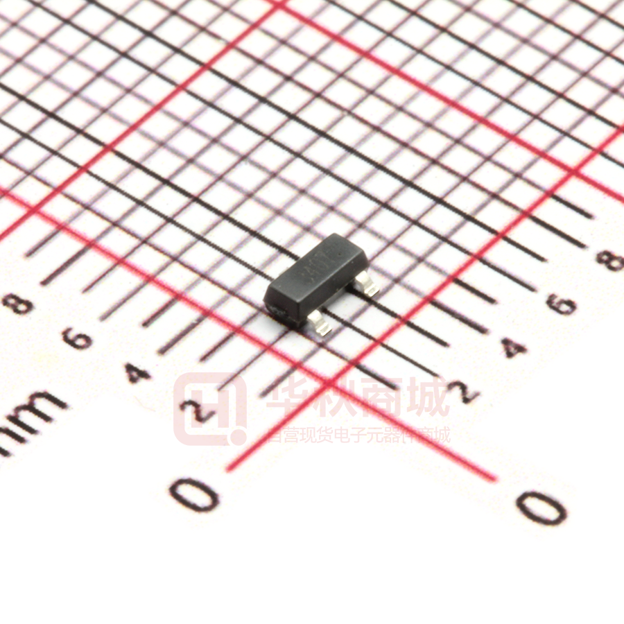

    P沟道增强型场效应晶体管 30V 4.1A 55mΩ@10V,4.1A 1.2W 2.4V@250uA P Channel SOT-23
YJL3407A 数据手册
RoHS COMPLIANT YJL3407A P-Channel Enhancement Mode Field Effect Transistor Product Summary ● VDS ● ID ● RDS(ON)( at VGS=-10V) ● RDS(ON)( at VGS=-4.5V) -30V -4.1A <55 mohm <68 mohm General Description ● Trench Power LV MOSFET technology ● High density cell design for Low RDS(ON) ● High Speed switching Applications ● Battery protection ● Load switch ● Power management ■ Absolute Maximum Ratings (TA=25℃unless otherwise noted) Parameter Symbol Maximum Drain-source Voltage VDS -30 V Gate-source Voltage VGS ±20 V TA=25℃ @ Steady State Drain Current -4.1 ID TA=70℃ @ Steady State Unit A -3.2 Pulsed Drain CurrentA IDM -15 A Total Power Dissipation @ TA=25℃ PD 1.2 W RθJA 105 ℃/ W TJ ,TSTG -55~+150 ℃ Thermal Resistance Junction-to-Ambient @ Steady State B Junction and Storage Temperature Range ■ Ordering Information (Example) PREFERED P/N PACKING CODE Marking MINIMUM PACKAGE(pcs) INNER BOX QUANTITY(pcs) OUTER CARTON QUANTITY(pcs) DELIVERY MODE YJL3407A F2 3407. 3000 30000 120000 7“ reel 1/6 S-S1976 Rev.2.0,25-Dec-18 Yangzhou Yangjie Electronic Technology Co., Ltd. www.21yangjie.com YJL3407A ■ Electrical Characteristics (TJ=25℃ unless otherwise noted) Parameter Symbol Conditions Min Typ Max Units Drain-Source Breakdown Voltage BVDSS VGS= 0V, ID=-250μA -30 Zero Gate Voltage Drain Current IDSS VDS=-30V,VGS=0V,TC=25℃ -1 μA IGSS VGS= ±20V, VDS=0V ±100 nA Gate Threshold Voltage VGS(th) VDS= VGS, ID=-250μA -1.5 -2.4 V 40 55 Static Drain-Source On-Resistance RDS(ON) Static Parameter Gate-Body Leakage Current -1.0 VGS= -10V, ID=-4.1A Diode Forward Voltage Maximum Body-Diode Continuous Current V mΩ VSD VGS= -4.5V, ID=-3.5A 53 68 IS=-4.1A,VGS=0V -0.8 -1.2 V -4.1 A IS Dynamic Parameters Input Capacitance Ciss 580 Output Capacitance Coss Reverse Transfer Capacitance Crss 74 Total Gate Charge Qg 6.8 Gate Source Charge Qgs Gate Drain Charge Qgd 1.4 Turn-on Delay Time tD(on) 14 Turn-on Rise Time tr VDS=-15V,VGS=0V,f=1MHZ 98 pF Switching Parameters VGS=-10V,VDS=-15V,ID=-4.1A 1.0 61 VGS=-10V,VDD=-15V, RL=15Ω,ID=-1A, RGEN=2.5Ω Turn-off Delay Time Turn-off Fall Time nC ns tD(off) 19 tf 10 A. Pulse Test: Pulse Width≤300us,Duty cycle ≤2%. B. Device mounted on FR-4 PCB, 1 inch x 0.85 inch x 0.062 inch. 2/6 S-S1976 Rev.2.0,25-Dec-18 Yangzhou Yangjie Electronic Technology Co., Ltd. www.21yangjie.com YJL3407A ■ Typical Performance Characteristics Figure1. Output Characteristics Figure2. Transfer Characteristics Figure3. Capacitance Characteristics Figure4. Gate Charge Figure5. Drain-Source on Resistance Figure6. Drain-Source on Resistance 3/6 S-S1976 Rev.2.0,25-Dec-18 Yangzhou Yangjie Electronic Technology Co., Ltd. www.21yangjie.com YJL3407A Figure7. Safe Operation Area Figure8. Switching wave 4/6 S-S1976 Rev.2.0,25-Dec-18 Yangzhou Yangjie Electronic Technology Co., Ltd. www.21yangjie.com YJL3407A ■ SOT-23 Package information ■ SOT-23 Suggested Pad Layout 5/6 S-S1976 Rev.2.0,25-Dec-18 Yangzhou Yangjie Electronic Technology Co., Ltd. www.21yangjie.com YJL3407A Disclaimer The information presented in this document is for reference only. Yangzhou Yangjie Electronic Technology Co., Ltd. reserves the right to make changes without notice for the specification of the products displayed herein to improve reliability, function or design or otherwise. The product listed herein is designed to be used with ordinary electronic equipment or devices, and not designed to be used with equipment or devices which require high level of reliability and the malfunction of with would directly endanger human life (such as medical instruments, transportation equipment, aerospace machinery, nuclear-reactor controllers, fuel controllers and other safety devices), Yangjie or anyone on its behalf, assumes no responsibility or liability for any damages resulting from such improper use of sale. This publication supersedes & replaces all information previously supplied. For additional information, please visit our website http:// www.21yangjie.com , or consult your nearest Yangjie’s sales office for further assistance. 6/6 S-S1976 Rev.2.0,25-Dec-18 Yangzhou Yangjie Electronic Technology Co., Ltd. www.21yangjie.com
