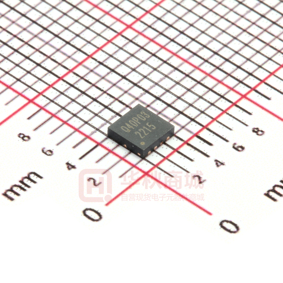

    DFN-8(3.3x3.3)
    P沟道 漏源电压(Vdss):30V 连续漏极电流(Id):40A 功率(Pd):32W
YJQ40P03A 数据手册
RoHS YJQ40P03A COMPLIANT P-Channel Enhancement Mode Field Effect Transistor Product Summary ● VDS ● ID ● RDS(ON)( at VGS=-20V) ● RDS(ON)( at VGS=-10V) ● RDS(ON)( at VGS=-4.5V) -30V -40A <13mohm <15mohm <25mohm General Description ● Trench Power LV MOSFET technology ● High density cell design for Low RDS(ON) ● High Speed switching Applications ● Battery protection ● Power management ● Load switch ■ Absolute Maximum Ratings (TA=25℃unless otherwise noted) Parameter Symbol Maximum Drain-source Voltage VDS -30 V Gate-source Voltage VGS ±25 V TA=25℃ @ Steady State Drain Current -40 ID TA=70℃ @ Steady State Unit A -33 Pulsed Drain Current A IDM -160 A Single Pulse Avalanche Energy @L=0.5mH B EAS 72 mJ PD 32 W RθJC 4.0 ℃/ W TJ ,TSTG -55~+150 ℃ Total Power Dissipation @ TA=25℃ C Thermal Resistance Junction-to-Ambient @ Steady State D Junction and Storage Temperature Range ■ Ordering Information (Example) PREFERED P/N PACKING CODE Marking MINIMUM PACKAGE(pcs) INNER BOX QUANTITY(pcs) OUTER CARTON QUANTITY(pcs) DELIVERY MODE YJQ40P03A F1 Q40P03 5000 10000 100000 13“ reel 1/7 S-E651 Rev.3.0,20-Feb-20 Yangzhou Yangjie Electronic Technology Co., Ltd. www.21yangjie.com YJQ40P03A ■ Electrical Characteristics (TJ=25℃ unless otherwise noted) Parameter Symbol Conditions Min Typ Max Units Drain-Source Breakdown Voltage BVDSS VGS= 0V, ID=-250μA -30 Zero Gate Voltage Drain Current IDSS VDS=-30V,VGS=0V,TC=25℃ -1 μA IGSS VGS= ±25V, VDS=0V ±100 nA VGS(th) VDS= VGS, ID=-250μA -1.8 -2.8 V VGS= -20V, ID=-20A 8.6 13 VGS= -10V, ID=-15A 9.8 15 VGS= -6.0V, ID=-12A 12.1 22 VGS= -4.5V, ID=-10A 15.5 25 Static Parameter Gate-Body Leakage Current Gate Threshold Voltage Static Drain-Source On-Resistance Diode Forward Voltage -1.2 V mΩ RDS(ON) VSD IS=-20A,VGS=0V -1.2 V Dynamic Parameters Input Capacitance Ciss Output Capacitance Coss Reverse Transfer Capacitance Crss Gate Resistance Rg 2152 VDS=-15V,VGS=0V,f=1MHZ pF 308 242 f= 1MHZ Ω 20 Switching Parameters Total Gate Charge Qg Gate Source Charge Qgs Gate Drain Charge Qgd Reverse Recovery Charge Qrr 40.1 VGS=-10V,VDS=-15V,ID=-12A 8.4 nC 8.6 7.8 IF= -12A, di/dt=100A/us Reverse Recovery Time trr 18 Turn-on Delay Time tD(on) 8 Turn-on Rise Time tr Turn-off Delay Time tD(off) 75 tf 46 Turn-off Fall Time VGS=-10V,VDD=-15V, ID=-1A, RGEN=2.5Ω 19 ns A. Pulse Test: Pulse Width≤300us,Duty cycle ≤2%. B. RθJA is the sum of the junction-to-case and case-to-ambient thermal resistance, where the case thermal reference is defined as the solder mounting surface of the drain pins. RθJC is guaranteed by design, while RθJA is determined by the board design. The maximum rating presented here is based on mounting on a 1 in 2 pad of 2oz copper. 2/7 S-E651 Rev.3.0,20-Feb-20 Yangzhou Yangjie Electronic Technology Co., Ltd. www.21yangjie.com YJQ40P03A ■ Typical Performance Characteristics Figure 1. Output Characteristics Figure 2. Transfer Characteristics Figure 3. On-Resistance vs. Drain Current and Gate Voltage Figure 4. On-Resistance vs. Junction Temperature Figure 5. Capacitance Characteristics Figure 6. Gate Charge 3/7 S-E651 Rev.3.0,20-Feb-20 Yangzhou Yangjie Electronic Technology Co., Ltd. www.21yangjie.com YJQ40P03A Figure 8. Maximum Continuous Drain Current vs Case Temperature Figure 7. Safe Operation Area Figure 9. Normalized Maximum Transient Thermal Impedance 4/7 S-E651 Rev.3.0,20-Feb-20 Yangzhou Yangjie Electronic Technology Co., Ltd. www.21yangjie.com YJQ40P03A Resistive Switching Test Circuit & Waveforms Diode Recovery Test Circuit & Waveforms Gate Charge Test Circuit & Waveform Unclamped Inductive Switching (UIS) Test Circuit & Waveforms 5/7 S-E651 Rev.3.0,20-Feb-20 Yangzhou Yangjie Electronic Technology Co., Ltd. www.21yangjie.com YJQ40P03A ■ DFN3.3×3.3 Package information 6/7 S-E651 Rev.3.0,20-Feb-20 Yangzhou Yangjie Electronic Technology Co., Ltd. www.21yangjie.com YJQ40P03A Disclaimer The information presented in this document is for reference only. Yangzhou Yangjie Electronic Technology Co., Ltd. reserves the right to make changes without notice for the specification of the products displayed herein to improve reliability, function or design or otherwise. The product listed herein is designed to be used with ordinary electronic equipment or devices, and not designed to be used with equipment or devices which require high level of reliability and the malfunction of with would directly endanger human life (such as medical instruments, transportation equipment, aerospace machinery, nuclear-reactor controllers, fuel controllers and other safety devices), Yangjie or anyone on its behalf, assumes no responsibility or liability for any damages resulting from such improper use of sale. This publication supersedes & replaces all information previously supplied. For additional information, please visit our website http:// www.21yangjie.com , or consult your nearest Yangjie’s sales office for further assistance. 7/7 S-E651 Rev.3.0,20-Feb-20 Yangzhou Yangjie Electronic Technology Co., Ltd. www.21yangjie.com
