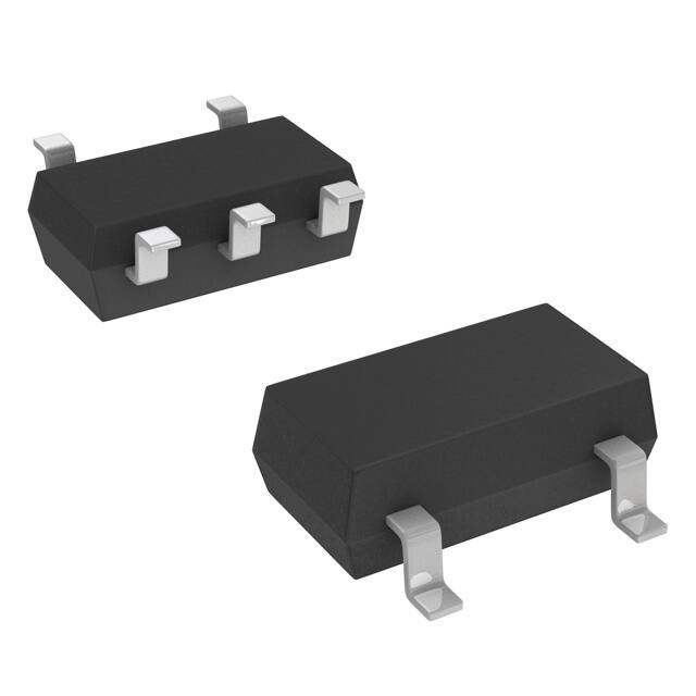

    IC REG BUCK 1.8V 600MA SOT25
IXD3236A18CMR-G 数据手册
Product Specification IXD3235/36/37 Synchronous 600 mA Step-Down DC/DC Converter Operating voltage range is from 2.0 V to 6.0 V (A ~ C types) or 1.8 V to 6.0 V (D ~ G types). For the D/F types, which have a reference voltage of 0.8 V with ± 2.0% accuracy, the output voltage can be set from 0.9 V by using two external resistors. The A/B/C/E/G types have a fixed output voltage from 0.8 V to 4.0 V in increments of 0.05 V with ± 2.0% accuracy. The device requires only an inductor and two externally connected ceramic capacitors. The built-in oscillator, either 1.2 MHz or 3.0 MHz, can be selected. The IXD3235 operates in PWM mode, the IXD3236 automatically switches between PWM/PFM modes, and the IXD3237 allows switch manually between the PWM and the automatic PWM/PFM switching control modes. This allows fast response, low ripple, and high efficiency over the full range of loads from light to heavy. The soft start and current control functions are internally optimized. All circuits are disabled in a standby mode to reduce current consumption to less than 1.0 μA. The B/F/G types have a 0.25 ms high-speed softstart for quick turn-on. The built-in Under Voltage Lockout (UVLO) function forces the internal P-channel transistor OFF, when input voltage becomes 1.4 V or lower. The B to G types have the output capacitor CL discharge circuitry, which allows fast CL discharge when IC goes into standby mode. Device is available in four types of packages: SOT25, USP-6C, USP-6EL, and WLP-5-03. FEATURES  Built-in transistors  Operating Input Voltage Range: 2.0 V ~ 6.0 V (A/B/C types) or 1.8 V ~ 6.0 V (D/E/F/G types)  Output Voltage Range Externally Set: 0.8 V ~ 4.0 V (internally set) or 0.9 ~ 6.0 V (externally set)  Output Current: 600 mA  High Efficiency: 92%  Oscillation Frequency: 1.2 MHz, 3 MHz  Maximum Duty Cycle: 100%  Operating Modes: PWM, PWM/PFM auto select or PWM/PFM manual select  Functions: Build-in Current Limit, Load Capacitor Discharge, High Speed Soft start  Operating Ambient temperature: -40 ~ +85 C  Packages: SOT-25, USP-6C, USP-6EL, WLP-5-03  EU RoHS Compliant, Pb Free 0 APPLICATION      Mobile Phones Bluetooth headsets Digital home appliances Office automation equipment Various portable equipment DESCRIPTION The IXD3235/36/37 series is a group of synchronousrectification type DC/DC converters with a built-in 0.52 Ω N-channel synchronous rectification transistor and 0.42 Ω P-channel switching transistor providing up to 600 mA output current. TYPICAL APPLICATION CIRCUITS TYPICAL PERFORMANCE CHARACTERISTIC Efficiency vs. Output Current (fOSC = 1.2 MHz, VOUT = 1.8 V) PWM/PFM Automatic Switching mode IXD3235/36/37 A, B, C, E, and G types IXD3235/36/37 D and F types PS034201-0515 PRELIMINARY 1 Product Specification IXD3235/36/37 ABSOLUTE MAXIMUM RATINGS PARAMETER SYMBOL RATINGS UNITS VIN Pin Voltage VIN – 0.3 ~ 6.5 V LX Pin Voltage VLX – 0.3 ~ VIN + 0.31 V VOUT Pin Voltage VOUT – 0.3 ~ 6.5 V FB Pin Voltage VFB – 0.3 ~ 6.5 V CE/MODE Pin Voltage VCE – 0.3 ~ 6.5 V Lx Pin Current ILX ±1500 mA SOT-25 Power Dissipation 250 USP-6C 120 PD USP-6EL mW 120 WLP-5-03 750 Operating Temperature Range TOPR – 40 ~ + 85 0 Storage Temperature Range TSTG – 50 ~ +125 0 C C ELECTRICAL OPERATING CHARACTERISTICS IXD3235/36/37 A series, VOUT = 1.8 V, Ta = 250C PARAMETER SYMBOL Operating Voltage Range Output Voltage VOUT Maximum Output Current UVLO Voltage Supply Current IXD323xA18Dxx Standby Current Oscillation Frequency IOUT_MAX VUVLO IXD323xA18Cxx IQ ISTB IXD323xA18Cxx IXD323xA18Dxx PFM IXD323xA18Cxx Switching IXD323xA18Dxx Current P-channel ON time maximum CONDITIONS VIN fOSC IPFM12) tPON_MAX12) VIN = VCE = 5.0 V, IOUT = 30 mA MAX. UNIT CIRCUIT - 6.0 V  1.764 1.800 1.836 600 VCE = VIN, VOUT = 01), 11) 1.00 VIN = VCE = 5.0 V, VOUT = VOUT(E) x 1.1 V VIN = 5.0 V, VCE = 0 V, VOUT = VOUT(E) x 1.1 V VIN = VOUT(E) + 2 V, VCE = 1.0 V, IOUT = 100 mA VIN = VCE = VOUT(E) + 2 V, , IOUT = 1 mA (see table A) VIN = VCE = 5.0 V, VOUT = VOUT(E) x 0.9 V Minimum Duty Cycle Ratio DMIN VIN = VCE = 5.0 V, VOUT = VOUT(E) x 1.1 V 1.40 1.78 15 33 21 35 0 1.0 1020 1220 1380 2550 3000 3460 120 160 200 170 220 270 VIN = VCE = (see table B), IOUT = 1 mA DMAX Efficiency 2) TYP. 2.0 VIN = VOUT(E) + 2.0 V, VCE = 1.0 V9) Maximum Duty Cycle Ratio IXD323xA18Cxx MIN. V mA  V  µA µA kHz    mA 2Dmax 3DMAX 100 0 92 %  %  %  EFFI VIN = VCE = VOUT(E) + 1.2 V, IOUT = 100 mA LX “H” ON Resistance 13) RLXH1 VIN = VCE = 5.0 V, VOUT = 0 V, ILX = 100 mA 0.35 0.55 Ω  LX “H” ON Resistance 23) RLXH2 VIN = VCE = 3.6 V, VOUT = 0 V, ILX = 100 mA 0.42 0.67 Ω  LX “L” ON Resistance 14) RLXL1 VIN = VCE = 5.0 V 0.45 0.65 Ω  LX “L” ON Resistance 24) RLXL2 VIN = VCE = 3.6 V 0.52 0.77 Ω  IXD323xA18Dxx 86 5) ILXH VIN = VCE = 5.0 V, VOUT = 0 V, VLX = 5.0 V 0.01 1.0 µA  LX “L” Leakage Current5) ILXH VIN = VCE = 5.0 V, VOUT = 0 V, VLX = 5.0 V 0.01 1.0 µA  Current Limit10) Output Voltage Temperature Characteristics CE “H” Voltage14) ILIM VIN = VCE = 5.0 V, VOUT = VOUT(E) x 0.9 V8) 1050 1350 mA VCEH VOUT = 0 V 0.65 CE “L” Voltage15) VCEL VOUT = 0 V 0 PWM mode Start Voltage6), 13) PWM/PFM mode Start Voltage6), 13) CE “H” Current VPWM IOUT = 1 mA VPFM IOUT = 1 mA IENH VIN = VCE = 5.0 V, VOUT = 0 V LX “H” Leakage Current PS034201-0515 900 -400C ≤ TOPR ≤ 850C, IOUT = 30 mA PRELIMINARY ppm/0C  6.0 V  0.25 V  µA  ±100 VIN -1.0 VIN – 0.25 -0.1 0.1 2 Product Specification IXD3235/36/37 CE “L” Current Soft-Start Time IXD323xA18Cxx IXD323xA18Dxx Latch Time7) Short Protection Threshold Voltage IENL tSS tLAT VSHORT VIN = 5.0 V, VCE = 0 V, VOUT = 0 V IOUT = 1 mA (see table C) VIN = VCE = 5.0 V, VOUT = 0.8 x VOUT(E), LX short with 1 Ω resistor to ground VIN = VCE = 5.0 V, LX short with 1 Ω resistor to ground -0.1 0.1 0.5 1.0 2.5 0.5 0.9 2.5 1.0 20.0 0.675 0.900 1.150 µA  ms  ms V NOTE: Test conditions: Unless otherwise stated, VIN = 5.0 V, VOUT(E) = Nominal Voltage 1) Including hysteresis operating voltage range 2) EFFI = {(output voltage × output current) / (input voltage × input current)} × 100% 3) ON resistance (Ω) = (VIN - Lx pin measurement voltage) / 100mA 4) Design target value 5) A 10μA (maximum) current may leak at high temperature 6) The CE/MODE pin of the IXD3237A series functions also as an external switching pin between PWM and PWM/PFM control. Control is switched to the automatic PWM/PFM switching mode when the CE/MODE pin voltage is equal to or greater than V IN minus 0.3 V, and to the PWM mode when the CE/MODE pin voltage is equal to or lower than VIN minus 1.0V. However, it should be equal to or greater than VCEH 7) Time from moment when VOUT is shorted to GND via 1 Ω resistor to the moment, when Current Limit generates pulse stopping LX oscillations 8) When VIN is less than 2.4 V, current limit may not be reached because of voltage drop across ON resistance 9) When the difference between input and output voltage is small, some cycles may be skipped completely before current maximizes. If load current increases in this state, output voltage will decrease because of the voltage drop across P-channel transistor 10) Current limit denotes the level of an inductor peak current 11) Voltage, when LX pin voltage is “L”=+0.1 V ~ -0.1 V 12) Not for IXD3235 series, because they have PWM mode only 13) The IXD3237 series only 14) Voltage at which LX pin state changes from “L” to “H” = VIN ~ VIN - 1.2 V” 15) Voltage at which LX pin state changes from “H” to “L” ”=+0.1 V ~ -0.1 V PS034201-0515 PRELIMINARY 3 Product Specification IXD3235/36/37 ELECTRICAL OPERATING CHARACTERISTICS (CONTINUED) IXD3235/36/37 B/C/E/G series, VOUT = 1.8 V, Ta = 250C PARAMETER Operating Voltage Range SYMBOL B/C series E/G series Output Voltage UVLO Voltage IXD323xx18Dxx Standby Current IQ ISTB IXD323xx18Cxx Oscillation Frequency IOUT_MAX VUVLO IXD323xx18Cxx Supply Current VIN VOUT Maximum Output Current IXD323xx18Dxx PFM IXD323xx18Cxx Switching IXD323xx18Dxx Current P-channel ON time maximum CONDITIONS fOSC IPFM12) tPON_MAX12) MIN. TYP. MAX. 2.0 - 6.0 1.8 VIN = VCE = 5.0 V, IOUT = 30 mA 1.764 1.800 1.836 VIN = VOUT(E) + 2.0 V, VCE = 1.0 V9) 600 VCE = VIN, VOUT = VOUT(E) x 0.5 V 1), 11), 16) 1.00 VIN = VCE = 5.0 V, VOUT = VOUT(E) x 1.1 V VIN = VCE = VOUT(E) + 2 V, , IOUT = 1 mA (see table A) 1.40 1.78 15 33 21 35 0 1.0 1020 1220 1380 2550 3000 3460 120 160 200 170 220 270 VIN = 5.0 V, VCE = 0 V, VOUT = VOUT(E) x 1.1 V VIN = VOUT(E) + 2 V, VCE = 1.0 V, IOUT = 100 mA 6.0 VIN = VCE = (see table B), IOUT = 1 mA UNIT CIRCUIT V  V mA  V  µA µA kHz    mA 2Dmax 3DMAX  %  DMAX VIN = VCE = 5.0 V, VOUT = VOUT(E) x 0.9 V Minimum Duty Cycle Ratio DMIN VIN = VCE = 5.0 V, VOUT = VOUT(E) x 1.1 V EFFI VIN = VCE = VOUT(E) + 1.2 V, IOUT = 100 mA LX “H” ON Resistance 13) RLXH1 VIN = VCE = 5.0 V, VOUT = 0 V, ILX = 100 mA 0.35 0.55 Ω  3) LX “H” ON Resistance 2 RLXH2 VIN = VCE = 3.6 V, VOUT = 0 V, ILX = 100 mA 0.42 0.67 Ω  LX “L” ON Resistance 14) RLXL1 VIN = VCE = 5.0 V 0.45 0.65 Ω  LX “L” ON Resistance 24) RLXL2 VIN = VCE = 3.6 V 0.52 0.77 Ω  IXD323xx18Cxx Efficiency 2) IXD323xx18Dxx 100 % Maximum Duty Cycle Ratio 0 92 % 86  5) ILXH VIN = VCE = 5.0 V, VOUT = 0 V, VLX = 5.0 V 0.01 1.0 µA  LX “L” Leakage Current5) ILXH VIN = VCE = 5.0 V, VOUT = 0 V, VLX = 5.0 V 0.01 1.0 µA  Current Limit10) Output Voltage Temperature Characteristics CE “H” Voltage14) ILIM VIN = VCE = 5.0 V, VOUT = VOUT(E) x 0.9 V8) 1050 1350 mA LX “H” Leakage Current CE “L” Voltage 15) PWM mode Start Voltage6), 13) PWM/PFM mode Start Voltage6), 13) CE “H” Current CE “L” Current 900 -400C ≤ TOPR ≤ 850C, IOUT = 30 mA VCEH VOUT = 0 V 0.65 0 VCEL VOUT = 0 V VPWM IOUT = 1 mA VPFM IOUT = 1 mA IENH IENL Latch Time B/C series Short Protection Threshold Voltage E/G series CL Discharge Resistance  0.25 V  0.1 µA  VIN = 5.0 V, VCE = 0 V, VOUT = 0 V -0.1 0.1 µA  ms  tSS IOUT = 1 mA (see table C) tLAT VIN = VCE = 5.0 V, VOUT = 0.8 x VOUT(E), LX short with 1 Ω resistor to ground 0.5 0.5 RDCL V VIN = VCE = 5.0 V, VOUT = 0 V 0.25 VSHORT 6.0 VIN – 0.25 -0.1 IXD323xC(E)18Dxx 7)  VIN -1.0 IXD323xB(G)18Cxx Soft-Start IXD323xC(E)18Cxx Time IXD323xB(G)18Dxx ppm/0C ±100 VIN = VCE = 5.0 V, LX short with 1 Ω resistor to ground VIN = VLX = 5.0 V, VCE = 0 V, VOUT - open 0.4 1.0 2.5 0.32 0.50 0.9 2.5 1.0 20.0 0.675 0.900 1.150 0.338 0.450 0.563 200 300 450 ms V Ω NOTE: Test conditions: Unless otherwise stated, VIN = 5.0 V, VOUT(E) = Nominal Voltage 1) Including hysteresis operating voltage range 2) EFFI = {(output voltage × output current) / (input voltage × input current)} × 100% 3) ON resistance (Ω) = (VIN - Lx pin measurement voltage) / 100mA 4) Design target value PS034201-0515 PRELIMINARY 4 Product Specification IXD3235/36/37 5) 6) 7) 8) 9) 10) 11) 12) 13) 14) 15) 16) A 10μA (maximum) current may leak at high temperature The CE/MODE pin of the IXD3237A series functions also as an external switching pin between PWM and PWM/PFM control. Control is switched to the automatic PWM/PFM switching mode when the CE/MODE pin voltage is equal to or greater than V IN minus 0.3 V, and to the PWM mode when the CE/MODE pin voltage is equal to or lower than VIN minus 1.0V. However, it should be equal to or greater than VCEH Time from moment when VOUT is shorted to GND via 1 Ω resistor to the moment, when Current Limit generates pulse stopping LX oscillations When VIN is less than 2.4 V, current limit may not be reached because of voltage drop across ON resistance When the difference between input and output voltage is small, some cycles may be skipped completely before current maximizes. If load current increases in this state, output voltage will decrease because of the voltage drop across P-channel transistor Current limit denotes the level of an inductor peak current Voltage, when LX pin voltage is “L”=+0.1 V ~ -0.1 V Not for IXD3235 series, because they have PWM mode only The IXD3237 series only Voltage at which LX pin state changes from “L” to “H” = VIN ~ VIN - 1.2 V” Voltage at which LX pin state changes from “H” to “L” ”=+0.1 V ~ -0.1 V Voltage at which VOUT becomes more than VIN, while VIN is rising from 0 V to VOUT (E) x 0.5 V PS034201-0515 PRELIMINARY 5 Product Specification IXD3235/36/37 ELECTRICAL OPERATING CHARACTERISTICS (CONTINUED) IXD3235/36/37 D/F series, VOUT = 1.8 V, Ta = 250C PARAMETER SYMBOL Operating Voltage Range VIN FB Voltage VFB Maximum Output Current IOUT_MAX UVLO Voltage VUVLO IXD323xx18Cxx Supply Current IXD323xx18Dxx Standby Current ISTB IXD323xx18Cxx Oscillation Frequency IQ IXD323xx18Dxx PFM IXD323xx18Cxx Switching IXD323xx18Dxx Current P-channel ON time maximum fOSC IPFM12) tPON_MAX12) CONDITIONS VIN = VCE = 5.0 V, IOUT = 30 mA MIN. TYP. MAX. UNIT CIRCUIT 1.8 - 6.0 V  1.784 1.800 1.816 VIN = VOUT(E) + 2.0 V, VCE = 1.0 V9) 600 VCE = VIN, VOUT = 01), 11) 1.00 21 VIN = 5.0 V, VCE = 0 V, VOUT = VOUT(E) x 1.1 V VIN = VCE = VOUT(E) + 2 V, , IOUT = 1 mA (see table A) 1.78 15 VIN = VCE = 5.0 V, VOUT = VOUT(E) x 1.1 V VIN = VOUT(E) + 2 V, VCE = 1.0 V, IOUT = 100 mA 1.40 35 0 1.0 1020 1220 1380 2550 3000 3460 120 160 200 170 220 270 VIN = VCE = (see table B), IOUT = 1 mA V mA  V  µA µA kHz    mA 2Dmax 3DMAX  %  DMAX VIN = VCE = 5.0 V, VOUT = VOUT(E) x 0.9 V Minimum Duty Cycle Ratio DMIN VIN = VCE = 5.0 V, VOUT = VOUT(E) x 1.1 V EFFI VIN = VCE = VOUT(E) + 1.2 V, IOUT = 100 mA LX “H” ON Resistance 13) RLXH1 VIN = VCE = 5.0 V, VOUT = 0 V, ILX = 100 mA 0.35 0.55 Ω  LX “H” ON Resistance 23) RLXH2 VIN = VCE = 3.6 V, VOUT = 0 V, ILX = 100 mA 0.42 0.67 Ω  4) LX “L” ON Resistance 1 RLXL1 VIN = VCE = 5.0 V 0.45 0.65 Ω  LX “L” ON Resistance 24) RLXL2 VIN = VCE = 3.6 V 0.52 0.77 Ω  LX “H” Leakage Current5) ILXH VIN = VCE = 5.0 V, VOUT = 0 V, VLX = 5.0 V 0.01 1.0 µA  5) ILXH VIN = VCE = 5.0 V, VOUT = 0 V, VLX = 5.0 V  ILIM VIN = VCE = 5.0 V, VOUT = VOUT(E) x 0.9 V8) IXD323xx18Cxx Efficiency 2) IXD323xx18Dxx LX “L” Leakage Current 100 % Maximum Duty Cycle Ratio 0 92 86 Current Limit10) Output Voltage Temperature Characteristics CE “H” Voltage14) VCEH VOUT = 0 V 0.65 CE “L” Voltage15) VCEL VOUT = 0 V 0 VPWM IOUT = 1 mA PWM mode Start Voltage PWM/PFM mode Start Voltage6), 13) CE “H” Current 6), 13) CE “L” Current IXD323xF18Cxx Soft-Start Time IXD323xD18Dxx 900 -400C ≤ TOPR ≤ 850C, IOUT = 30 mA IOUT = 1 mA IENH VIN = VCE = 5.0 V, VOUT = 0 V IENL VIN = 5.0 V, VCE = 0 V, VOUT = 0 V -0.1 0.5 IOUT = 1 mA (see table C) 0.5 IXD323xF18Dxx Latch Time 7) Short Protection Threshold Voltage CL Discharge Resistance tLAT VSHORT RDCL VIN = VCE = 5.0 V, VOUT = 0.8 x VOUT(E), LX short with 1 Ω resistor to ground VIN = VCE = 5.0 V, LX short with 1 Ω resistor to ground VIN = VLX = 5.0 V, VCE = 0 V, VOUT - open 1.0 µA 1350 mA  ppm/0C  6.0 V  0.25 V  VIN -1.0 VPFM tSS 0.01 1050 ±100 VIN – 0.25 -0.1 IXD323xD18Cxx % 0.1 µA  0.1 µA  ms  1.0 2.5 0.25 0.40 1.0 2.5 0.25 0.40 1.0 20.0 0.675 0.900 1.150 200 300 450 ms V Ω NOTE: Test conditions: Unless otherwise stated, VIN = 5.0 V, VOUT(E) = Nominal Voltage 1) Including hysteresis operating voltage range 2) EFFI = {(output voltage × output current) / (input voltage × input current)} × 100% 3) ON resistance (Ω) = (VIN - Lx pin measurement voltage) / 100mA 4) Design target value 5) A 10μA (maximum) current may leak at high temperature PS034201-0515 PRELIMINARY 6 Product Specification IXD3235/36/37 6) 7) 8) 9) 10) 11) 12) 13) 14) 15) The CE/MODE pin of the IXD3237A series functions also as an external switching pin between PWM and PWM/PFM control. Control is switched to the automatic PWM/PFM switching mode when the CE/MODE pin voltage is equal to or greater than V IN minus 0.3 V, and to the PWM mode when the CE/MODE pin voltage is equal to or lower than VIN minus 1.0V. However, it should be equal to or greater than VCEH Time from moment when VOUT is shorted to GND via 1 Ω resistor to the moment, when Current Limit generates pulse stopping LX oscillations When VIN is less than 2.4 V, current limit may not be reached because of voltage drop across ON resistance When the difference between input and output voltage is small, some cycles may be skipped completely before current maximizes. If load current increases in this state, output voltage will decrease because of the voltage drop across P-channel transistor Current limit denotes the level of an inductor peak current Voltage, when LX pin voltage is “L”=+0.1 V ~ -0.1 V Not for IXD3235 series, because they have PWM mode only The IXD3237 series only Voltage at which LX pin state changes from “L” to “H” = VIN ~ VIN - 1.2 V” Voltage at which LX pin state changes from “H” to “L” ”=+0.1 V ~ -0.1 V TABLE A PFM Switching Current (IPFM) vs. Oscillation Frequency and Setting Voltage fOSC = 1.2 MHz SETTING VOLTAGE fOSC = 3.0 MHz MIN TYP MAX MIN TYP MAX VOUT(E) ≤ 1.2 V 140 180 240 190 260 350 1.2 V < VOUT(E) ≤ 1.75 V 130 170 220 180 240 300 VOUT(E) ≥ 1.8 V 120 160 200 170 220 270 TABLE B Input Voltage (VIN) for Measuring P-channel ON time maximum tPON_MAX fOSC VIN 1,2 MHZ VOUT(E) + 0.5 V 3 MHZ VOUT(E) +1.0 V NOTE: Example: When VOUT(E) = 1.2V and fOSC = 1.2 MHz, VIN should be 1.7 V, however, VIN should be at least 2.0 V if the minimum operating voltage is 2.0 V TABLE C Soft-Start Time vs. Setting Voltage and Oscillation Frequency (IXD3235/36/37 B and G Series only) SERIES IXD3235B/G IXD3237B/G fOSC 1.2 MHz IXD3236B/G IXD3235/36/37 B/G PS034201-0515 3.0 MHz SETTING VOLTAGE, V 0.8 ≤ VOUT(E) < 1.75 1.5 ≤ VOUT(E) < 1.8 1.8 ≤ VOUT(E) < 2.5 2.5 ≤ VOUT(E) < 4.0 0.8 ≤ VOUT(E) < 2.5 2.5 ≤ VOUT(E) < 4.0 0.8 ≤ VOUT(E) < 1.8 1.8 ≤ VOUT(E) < 4.0 SOFT START TIME, µS MIN TYP MAX 250 400 320 500 250 400 320 500 250 400 320 500 250 400 320 500 PRELIMINARY 7 Product Specification IXD3235/36/37 PIN CONFIGURATION SOT-25 (Top View) USP-6C (Bottom View) USP-6EL (Bottom View) WLP-5-03 (Bottom View) NOTE: The dissipation pad for the USP-6C and USP-6EL packages should be soldered in recommended mount pattern and metal masking to enhance mounting strength and heat release. If the pad needs to be connected to other pins, it should be connected to the VSS (No 2 and No 5) pins. VSS pins (No. 2 and 5) should be tied together. PIN ASSIGNMENT SOT-25 1 2 3 PIN NUMBER USP-6C/USP-6EL 6 2, 5 4 WLP-5-03 2 3 1 4 3 4 VOUT (FB) 5 1 5 LX PS034201-0515 PIN NAME VIN VSS CE/MODE FUNCTIONS Power Input Ground Enable (Active HIGH), Mode Selection Pin Fixed Output Voltage - A/B/C/E/G series (Output Voltage Sense Pin - D/F series) Switching Node PRELIMINARY 8 Product Specification IXD3235/36/37 BLOCK DIAGRAMS IXD3235/36/37 A Series IXD3235/36/37 B/C/E/G Series IXD3235/36/37 D/F Series Internal diodes include an ESD protection and a parasitic diode BASIC OPERATION The IXD3235/36/37 series consists of a Reference Voltage source, Ramp Wave Generator, Error Amplifier, PWM Comparator, Phase Compensation circuit, output voltage resistive divider, P-channel switching transistor, Nchannel transistor for the synchronous switch, Current Limiter circuit, UVLO circuit, and others. (See the block diagram above.) The Error Amplifier compares output voltage divided by internal (external for D/F versions) resistors RFB1/RFB2 with the internal reference voltage. Amplified difference between these two signals applies to the one input of the PWM Comparator, while ramp voltage from the Ramp Wave Generator applies to the second input. Resulting PWM pulse determines switching transistor ON time. It goes through the Buffer and it appears at the gate of the internal Pchannel switching transistor. This continuous process stabilizes output voltage. The Current Feedback circuit monitors current of the P-channel transistor at each switching cycle, and modulates output signal from the Error Amplifier to provide additional feedback. This guarantees a stable converter operation even with low ESR ceramic load capacitor. Reference Voltage Source The Reference Voltage Source provides the reference voltage to ensure stable output voltage of the DC/DC converter. Ramp Wave Generator The Ramp Wave Generator produces ramp waveform signal needed for PWM operation, and signals to synchronize all the internal circuits. It operates at internally fixed 1.2 MHz or 3.0 MHz frequency. PS034201-0515 PRELIMINARY 9 Product Specification IXD3235/36/37 Error Amplifier The Error Amplifier monitors output voltage through resistive divider connected to VOUT (FB) pin. If output voltage falls below preset value and Error Amplifier’s input signal becomes less than internal reference voltage, the Error Amplifier/s output signal increases. That results in wider PWM pulse and respectively longer ON time for switching transistor to increase output voltage. The gain and frequency characteristics of the error amplifier output are fixed internally to optimize IC performance. Current Limiter The Current Limiter circuit monitors current flowing through the P-channel transistor connected to the Lx pin, and combines function of the current limit and operation suspension. When transistor’s current is greater than a specified level, the Current Limiter turns off P-channel transistor immediately. After that, the Current Limiter turns off too, returning to monitoring mode. The driver transistor turns on at the next cycle, but the Current Limiter will turn it off immediately if an over current exists. When the over current state is eliminated, the IC resumes its normal operation. The IC waits for end of the over current state repeating above steps (t1 on figure below). If an over-current state continues for a few ms with IC repeatedly performing above steps, the Current Limiter latches the P-channel transistor in OFF state, and IC suspends operations (t2 on figure below). To restart IC operation after this condition, either EN pin should be toggled H – L – H, or VIN pin voltage should be set below UVLO to resume operations from soft start. The suspension mode is not a standby mode. In the suspension mode, pulse output is suspended; however, internal circuitries remain in operation mode consuming power. Short-Circuit Protection The short-circuit protection monitors the RFB1/RFB2 divider voltage (FB point in the block diagram). If output is accidentally shorted to the ground, FB voltage starts falling. When this voltage becomes less than half of the reference voltage (VREF) and P-channel switching transistor’s current is more than the ILIM threshold, the ShortCircuit Protection turns off and latches quickly the P-channel transistor. At D/E/F/G series, Short Circuit Protection starts once FB voltage becomes less than 0.25 of reference voltage (VREF), disregard to transistor’s current. To restart IC operation after this condition, either EN pin should be toggled H – L – H, or VIN pin voltage should be set below UVLO to resume operations from soft start. The sharp load transients creating a voltage drop at the VOUT, propagate to the FB point through CFB, that may result in Short Circuit protection operating at voltages higher than 1/2 VREF voltage. UVLO Circuit When the VIN pin voltage becomes 1.4V or lower, the P-channel transistor is forced OFF to prevent false pulse output caused by unstable operation of the internal circuitry. When the V IN pin voltage becomes 1.8 V or higher, switching operations resume with the soft start. The soft start function operates even when the VIN voltage falls PS034201-0515 PRELIMINARY 10 Product Specification IXD3235/36/37 below the UVLO threshold for a very short time. The UVLO circuit does not cause a complete shutdown of the IC, but causes pulse output to be suspended; therefore, the internal circuitry remains in operation. PFM Switch Current In PFM mode, the IC keeps the P-channel transistor on until inductor current reaches a specified level (IPFM). P-channel transistor’s ON time is equal tON = L×IPFM / (VIN - VOUT), µs, where L is an inductance in µH, and IPFM is a current limit in A. PFM Duty Limit In PFM mode, P-channel ON time maximum (tPON_MAX) is set to 2DMAX, i.e. two periods of the switching frequency. Therefore, under conditions, when the ON time increases (i.e. step-down ratio is small), it is possible that P-channel transistor to be turned off, even when inductor current does not reach to IPFM. (See Figures 1 and 2 below) Figure 1 Figure 2 CL High Speed Discharge The IXD3235/36/37 B, C, D, E, F, and G series can quickly discharge the output capacitor (C L) to avoid application malfunction, when CE pin set logic LOW to disable IC. CL Discharge Time is proportional to the resistance (R) of the N-channel transistor located between the LX pin and ground and the output CL capacitance as shown below. tDSH = RCL x Ln (V OUT(E) / V), where V - Output voltage after discharge VOUT(E) - Output voltage R = 300 Ω (Typical value) Output Voltage Discharge Characteristics PS034201-0515 PRELIMINARY 11 Product Specification IXD3235/36/37 CE/MODE Pin Function The IXD3235/36/37 series enter the shut down mode, when a LOW logic-level signal applies to the CE/MODE pin. In the shutdown mode, IC current consumption is ~0 μA (Typical value), with the Lx and VOUT pins at high impedance state. The IC starts its operation when a HIGH logic-level signal applies to the CE/MODE pin. Intermediate voltage, generated by external resistive divider can be used to select PWM/PFM auto or PWM only switching modes in respect with the table below. OPERATION MODE CE/MODE VOLTAGE LEVEL IXD3235 IXD3236 Synchronous PWM/PFM auto switching mode 0.65 V ≤ V CE/MODE ≤ 6.0 V Synchronous Fixed PWM mode VIN – 0.25 V ≤ V CE/MODE ≤ VIN - - 0.65 V ≤ V CE/MODE ≤ VIN – 1.0 V 0 V ≤ V CE/MODE ≤ 0.25 V Standby mode Standby mode IXD3537 Synchronous PWM/PFM auto switching mode Synchronous Fixed PWM mode Standby mode Examples of CE/MODE pin use are shown below. Please set the value of each resistor from few hundreds kΩ to few hundred MΩ. For switches, CPU open-drain I/O port and transistor can be used. The CE/MODE pin is a CMOS input with a sink current ~ 0 μA. IXD3235/36 series - Examples of how to use CE/MODE pin SW-CE POSITION ON OFF IC STATUS SCHEMATIC A SCHEMATIC B Standby Active Active Standby IXD3237 series - Examples of how to use CE/MODE pin SW-CE POSITION SW-PWM/PFM POSITION ON X OFF ON OFF OFF IC STATUS SCHEMATIC A SCHEMATIC B PWM/PFM Auto Standby Switching Mode PWM Mode PWM Mode PWM/PFM Auto Standby Switching Mode Soft Start Soft start time is available in two options via product selection. The soft-start time of IXD3235/36/37 series is optimized by using internal circuits and it is 1.0 ms (Typically.) for A/C/D/E series and 0.25 ms for B/F/G series. D and F series require external resistors and a capacitor to set the output voltage, so the soft-start time might vary based on value of those external components. The definition of the soft-start time is the time when the output voltage goes up to the 90% of nominal output voltage after the IC is enabled by CE ”H” signal. PS034201-0515 PRELIMINARY 12 Product Specification IXD3235/36/37 TYPICAL APPLICATION CIRCUITS IXD3235/36/37 A, B, C, E, G Series (Fixed Output Voltage) IXD3235/36/37 D, F Series (Adjustable Output Voltage) EXTERNAL COMPONENTS fOSC 1.2 MHz 3.0 MHz L, µH CIN, µF CL, µF 4.7 4.7 10 1.5 4.7 10 Setting Output Voltage The IXD3235/36/37 D, F Series allows set output voltage externally by two resistors RFB1 and RFB2 as sown on schematic diagram above. Output voltage can be set starting from 0.9V. However, when input voltage (VIN) is lower than the set output voltage, output voltage (VOUT) cannot be higher than the input voltage. VOUT = 0.8 × (RFB1+RFB2)/RFB2 RFB1 + RFB2 < 1 MΩ. The value of the phase compensation capacitor CFB is calculated by the follow equation fZFB = 1/(2×π×CFB×RFB1), where fZFB < 10 kHz. For optimization, fZFB can be adjusted in the range of 1 kHz to 20 kHz depending on the inductance L and the load capacitance CL. Example: When RFB1 = 470 kΩ and RFB2 = 150 k, VOUT = 0.8 × (470 k+150 k) / 150 k = 3.3 V VOUT, V 0.9 1.2 1.5 1.8 PS034201-0515 RFB1, kΩ 100 150 130 300 RFB2, kΩ 820 300 150 240 CFB, pF 150 100 220 150 VOUT, V 2.5 3.0 3.3 4.0 PRELIMINARY RFB1, kΩ 510 330 470 120 RFB2, kΩ 240 120 150 30 CFB, pF 100 150 100 470 13 Product Specification IXD3235/36/37 LAYOUT AND USE CONSIDERATIONS 1. Wire external components as close to the IC as possible and use thick, short connecting traces to reduce the circuit impedance. Please, pay special attention to the VIN and GND wiring. Switching noise, which occurs from the GND, may cause the instability of the IC, so, position VIN and VCL capacitors as close to IC as possible. 2. Transitional voltage drops or voltage rising phenomenon could make the IC unstable if ratings are exceeded. 3. The IXD3235/36/37 series are designed to work with ceramic output capacitors. However, if the difference between input and output voltages is too high, a ceramic capacitor may fail to absorb the resulting high switching energy and oscillation could occur. In this case, connect an electrolytic capacitor in parallel to ceramic one to compensate for insufficient capacitance. 4. In PWM mode, IC generates very narrow pulses, and there is a possibility that some cycles will be skipped completely, if the difference between VIN and VOUT is high. 5. If the difference between VIN and VOUT is small, IC generates very wide pulses, and there is a possibility that some cycles will be skipped completely at the heavy load current. 6. When dropout voltage or load current is high, Current Limit may activate prematurely that will lead to IC instability. To avoid this condition, choose inductor’s value to set peak current below Current Limit threshold. Calculate the peak current according to the following formula: IPK = (VIN - VOUT) x D / (2 x L x fOSC) + IOUT, where L - Inductance fOSC -- Oscillation Frequency D – Duty cycle 7. Inductor’s rated current should exceed Current Limit threshold to avoid damage, which may occur until P-channel transistor turns off after Current Limiter activates (see figure below).  Current flows into P-channel transistor reaches the current limit (ILIM).  Current is more than ILIM due the circuit’s delay time from the current limit detection to the P-channel transistor OFF.  The inductor’s current time rate becomes quite small.  IC generates very narrow pulses for several milliseconds.  The circuit latches, stopping operation. 8. If VIN voltage is less than 2.4 V, current limit threshold may be not reached due voltage drop caused by switching transistor’s ON resistance 9. Latch time may become longer or latch may not work due electrical noise. To avoid this effect, the board should be laid out so that input capacitors are placed as close to the IC as possible. 10. Use of the IC at voltages below recommended voltage range may lead to instability. 11. At high temperature, output voltage may increase up to input voltage level at no load, because of the leakage current of the driver transistor. 12. High step-down ratio and very light load may be cause of intermittent oscillations. 13. In PWM/PFM automatic switching mode, IC may become unstable during transition to continuous mode. Please verify with actual components. PS034201-0515 PRELIMINARY 14 Product Specification IXD3235/36/37 VOUT = 3.3 V, fOSC = 1.2 MHz, VIN = 3.7 V, IOUT = 100 mA Ch 1 – VLX – 5 V/div; Ch 2 – VOUT – 2.0 mV/div External components: L = 4.7 µH (NP4018) CIN = 4.7 µF (ceramic) CL = 10 µF (ceramic) 14. The IC may enter unstable operation if the combination of ambient temperature, setting voltage, oscillation frequency, and inductor’s value are not adequate. If IC operates close to the maximum duty cycle, it may become unstable, even if inductor values listed below are used. fOSC, MHz 3.0 VOUT = 3.3 V, fOSC = 1.2 MHz, VIN = 4.0 V, IOUT = 150 mA Ch 1 – VLX – 2.0 V/div; Ch 2 – VOUT – 20 mV/div 1.2 External components: L = 1.5 µH (NP3015) CIN = 4.7 µF (ceramic) CL = 10 µF (ceramic) VOUT, V 0.8 V 2.5 V L, µH 1.0 – 2.2 3.3 – 6.8 4.7 – 6.8 If an inductor less than 4.7μH is used at fOSC = 1.2 MHz, or inductor less than 1.5 μH is used at fOSC = 3.0 MHz, inductor peak current may easy reach the current limit threshold ILIM. In this case, the IC may be not able to provide 600mA output current. 15. The IC may become unstable, when it goes into continuous operation mode, and difference between V IN and VOUT is high. VOUT = 1.8 V, fOSC = 1.2 MHz, VIN = 6.0 V, IOUT = 100 mA Ch 1 – VOUT – 10 mV/div Ch 2 – VLX – 5.0 V/div; External components: L = 4.7 µH (NP4018) CIN = 4.7 µF (ceramic) CL = 10 µF (ceramic) 16. Note on mounting (WLP-5-03) a) Mounting pad design should be optimized for user's conditions. b) Do not use eutectics solder paste. Sn-AG-Cu solder is used for the package terminals. If eutectic solder is used, mounting reliability decreases. c) When under fill agent is used to increase interfacial bonding strength, please take enough evaluation for selection. Some under fill materials and application conditions may decrease bonding reliability. d) The IC has exposed surface of silicon material in the top marking face and sides, so it is weak against mechanical damages and external short circuit conditions. Please, take care of handling to avoid cracks and breaks and keep the circuit open to avoid short-circuit from the outside. e) Semi-transparent resin is coated on the circuit face of the package. Please be noted that the usage under strong lights may affects device’s performance. PS034201-0515 PRELIMINARY 15 Product Specification IXD3235/36/37 TEST CIRCUITS Circuit  A/B/C/E/G series D/F series External Components L = 1.5 µH (NR3015) at 3.0 MHz L = 4.7 µH (NR4018) at 1.2MHz CIN = 4.7 μF (ceramic), CL = 10 μF (ceramic) External Components L = 1.5 µH (NR3015) at 3.0 MHz L = 4.7 µH (NR4018) at 1.2MHz CIN = 4.7 μF (ceramic), CL = 10 μF (ceramic) RFB1 = 150 kΩ, RFB2 = 300 kΩ, CFB = 120 pF Circuit  Circuit  RPULL = 200 Ω Circuit  Circuit  IOUT = 100 mA, ON Resistance = (VIN – VOUT/0.1, Ω Circuit  Circuit  b RPULL = 1 Ω Circuit  Circuit  PS034201-0515 PRELIMINARY 16 Product Specification IXD3235/36/37 TYPICAL PERFORMANCE CHARACTERISTICS 0 (1) Efficiency vs. Output Current Topr = 25 C IXD3237A18C IXD3237A18D L = 4.7 µH (NR4018), CIN = 4.7 μF, CL= 10 μF L = 1.5 μH (NR3015), CIN = 4.7 μF, CL = 10 μF (2) Output Voltage vs. Output Current IXD3237A18C IXD3237A18D L = 4.7 µH (NR4018), CIN = 4.7 μF, CL= 10 μF L = 1.5 μH (NR3015), CIN = 4.7 μF, CL = 10 μF (3) Ripple Voltage vs. Output Current IXD3237A18C IXD3237A18D L = 4.7 µH (NR4018), CIN = 4.7 μF, CL= 10 μF L = 1.5 μH (NR3015), CIN = 4.7 μF, CL = 10 μF PS034201-0515 PRELIMINARY 17 Product Specification IXD3235/36/37 TYPICAL PERFORMANCE CHARACTERISTICS (Continued) (4) Oscillation Frequency vs. Ambient Temperature IXD3237A18C IXD3237A18D L = 4.7 µH (NR4018), CIN = 4.7 μF, CL= 10 μF L = 1.5 μH (NR3015), CIN = 4.7 μF, CL = 10 μF (5) Supply Current vs. Ambient Temperature IXD3237A18C (6) Output Voltage vs. Ambient Temperature IXD3237A18D PS034201-0515 IXD3237A18D (7) UVLO Voltage vs. Ambient Temperature IXD3237A18D PRELIMINARY 18 Product Specification IXD3235/36/37 TYPICAL PERFORMANCE CHARACTERISTICS (Continued) (8) CE “H” Voltage vs. Ambient Temparature IXD3237A18D (9) CE “L” Voltage vs. Ambient Temperature IXD3237A18D (10) Soft Start Time vs. Ambient Temperature IXD3237A18C IXD3237A18D L = 4.7 µH (NR4018), CIN = 4.7 μF, CL= 10 μF L = 1.5 μH (NR3015), CIN = 4.7 μF, CL = 10 μF (11) ON Resistance vs. Ambient Temperature IXD3237A18D PS034201-0515 PRELIMINARY 19 Product Specification IXD3235/36/37 (12) IXD3235/36/37 B version Start Wave Form IXD3237B12C IXD3237B33D L = 4.7 µH (NR4018), CIN = 4.7 μF, CL= 10 μF L = 1.5 μH (NR3015), CIN = 4.7 μF, CL = 10 μF 100 µs/div 100 µs/div (13) IXD3235/36/37 B version Soft Start Time vs. Ambient Temperature IXD3237B12C IXD3237B33D L = 4.7 µH (NR4018), CIN = 4.7 μF, CL= 10 μF L = 1.5 μH (NR3015), CIN = 4.7 μF, CL = 10 μF (14) IXD3235/36/37 B version CL Discharge Time vs. Ambient Temperature IXD3237B33D PS034201-0515 PRELIMINARY 20 Product Specification IXD3235/36/37 TYPICAL PERFORMANCE CHARACTERISTICS (Continued) (15) Load Transient Response IXD3237A18C L = 4.7 µH (NR4018), CIN = 4.7 μF, CL= 10 μF, VIN = VCE = 3.6 V, (PWM/PFM Auto Switching mode) IOUT = 1 mA  100 mA IOUT = 1 mA  300 mA Ch1 – IOUT, Ch2 – VOUT 50 mV/div, Time – 50 µs/div IOUT = 100 mA  1 mA IOUT = 300 mA  1 mA Ch1 – IOUT, Ch2 – VOUT 50 mV/div, Time – 200 µs/div Ch1 – IOUT, Ch2 – VOUT 50 mV/div, Time – 50 µs/div Ch1 – IOUT, Ch2 – VOUT 50 mV/div, Time – 200 µs/div IXD3237A18C L = 4.7 µH (NR4018), CIN = 4.7 μF, CL= 10 μF, VIN = 3.6 V, VCE = 1.8 V (PWM mode) IOUT = 1 mA  100 mA IOUT = 1 mA  300 mA Ch1 – IOUT, Ch2 – VOUT 50 mV/div, Time – 50 µs/div IOUT = 100 mA  1 mA IOUT = 300 mA  1 mA Ch1 – IOUT, Ch2 – VOUT 50 mV/div, Time – 200 µs/div PS034201-0515 Ch1 – IOUT, Ch2 – VOUT 50 mV/div, Time – 50 µs/div Ch1 – IOUT, Ch2 – VOUT 50 mV/div, Time – 200 µs/div PRELIMINARY 21 Product Specification IXD3235/36/37 TYPICAL PERFORMANCE CHARACTERISTICS (Continued) (15) Load Transient Response (Continued) IXD3237A18D L = 1.5 µH (NR3015), CIN = 4.7 μF, CL= 10 μF, VIN = VCE = 3.6 V, (PWM/PFM Auto Switching mode) IOUT = 1 mA  100 mA IOUT = 1 mA  300 mA Ch1 – IOUT, Ch2 – VOUT 50 mV/div, Time – 50 µs/div IOUT = 100 mA  1 mA IOUT = 300 mA  1 mA Ch1 – IOUT, Ch2 – VOUT 50 mV/div, Time – 200 µs/div Ch1 – IOUT, Ch2 – VOUT 50 mV/div, Time – 50 µs/div Ch1 – IOUT, Ch2 – VOUT 50 mV/div, Time – 200 µs/div IXD3237A18D L = 1.5 µH (NR3015), CIN = 4.7 μF, CL= 10 μF, VIN = 3.6 V, VCE = 1.8 V (PWM mode) IOUT = 1 mA  100 mA IOUT = 100 mA  1 mA Ch1 – IOUT, Ch2 – VOUT 50 mV/div, Time – 50 µs/div IOUT = 1 mA  300 mA IOUT = 300 mA  1 mA Ch1 – IOUT, Ch2 – VOUT 50 mV/div, Time – 200 µs/div PS034201-0515 Ch1 – IOUT, Ch2 – VOUT 50 mV/div, Time – 50 µs/div Ch1 – IOUT, Ch2 – VOUT 50 mV/div, Time – 200 µs/div PRELIMINARY 22 Product Specification IXD3235/36/37 ORDERING INFORMATION IXD3235- IXD3236- IXD3237- DESIGNATOR  DESCRIPTION SYMBOL Type of DC/DC Controller A B C E G D F  Fixed Output Voltage, V 08 - 40 Reference Voltage  Oscillation Frequency -* Packages (Order Limit) 08 C D MR MR-G ER ER-G 4R-G 0R-G DESCRIPTION Refer to Product Classification  - integer part,  - decimal part, i.e. VOUT = 2.8 V -  = 2,  = 8 VOUT = 2.85 V -  = 2,  = L 0.05 V increments: 0.05 = A, 0.15 = B, 0.25 = C. 0.35 = D, 0.45 = E, 0.55 = F, 0.65 = H, 0.75 = K, 0.85 = L, 0.95 = M Reference Voltage (Fixed) 0.8 V -  = 0,  = 8 1.2 MHz 3.0 MHz SOT-25 (3000/reel) SOT-25 (3000/reel) USP-6C (3000/reel) USP-6C (3000/reel) USP-6EL (3000/reel) WLP-5-03 (3000/reel) NOTE: 1) 2) 3) The “-G” suffix denotes halogen and antimony free, as well as being fully RoHS compliant. SOT-25, USP-6EL package are available for the A/B/C series only. WLP-5-03 package is available for the A/B series only. PRODUCT CLASSIFICATION VOUT Type A B C D E F G Fixed Yes Yes Yes No Yes No Yes PS034201-0515 VIN Adjustable No No No Yes No Yes No ≥ 1.8 V No No No Yes Yes Yes Yes Soft Start CL Auto discharge ≥2V Yes Yes Yes No No No No PRELIMINARY No Yes Yes Yes Yes Yes Yes High Speed No Yes No No No Yes Yes Low Speed Yes No Yes Yes Yes No No 23 Product Specification IXD3235/36/37 PACKAGE DRAWING AND DIMENSIONS (Units: mm) SOT-25 USP-6C USP-6C Reference Pattern Layout USP-6C Reference Metal Mask Design PS034201-0515 PRELIMINARY 24 Product Specification IXD3235/36/37 PACKAGE DRAWING AND DIMENSIONS (CONTINUED) (Units: mm) USP-6EL WLP-5-03 NOTE: A part of the pin may appear from the side of the package because of its structure, but reliability of the package and strength will be not below the standard. USP-6EL Reference Pattern Layout PS034201-0515 USP-6EL Reference Metal Mask Design PRELIMINARY 25 Product Specification IXD3235/36/37 MARKING SOT-25  Represents product series PRODUCT SERIES A B C D E F G USP-6C/USP-6EL oscillation frequency MARK IXD3236 5 D L L 5 7 D IXD3235 4 C K K 4 2 C IXD3237 6 E M M 6 B E  Represents integer number of the output voltage and A/B/C/F series VOUT, V 0.x 1.x 2.x 3.x 4.x WLP-5-03 MARK fOSC = 1.2 MHz A B C D E fOSC = 3.0 MHz F H K L M E/G/D Series VOUT, V 0.x 1.x 2.x 3.x 4.x MARK fOSC = 1.2 MHz A B C D E fOSC = 3.0 MHz F H K L M  Represents decimal value of the output voltage VOUT, V x.00 x.10 x.20 x.30 x.40 x.50 x/60 x.70 x.80 x.90 MARK 0 1 2 3 4 5 6 7 8 9 VOUT, V x.05 x.15 x.25 x.35 x.45 x.55 x.65 x.75 x.85 X,95 MARK A B C D E F H K L M  represents production lot number 01~09、0A~0Z、11~9Z、A1~A9、AA~AZ、B1~ZZ in order (G, I, J, O, Q, and W excluded) PS034201-0515 PRELIMINARY 26 Product Specification IXD3235/36/37 Customer Support To share comments, get your technical questions answered, or report issues you may be experiencing with our products, please visit Zilog’s Technical Support page at http://support.zilog.com. To learn more about this product, find additional documentation, or to discover other fac-ets about Zilog product offerings, please visit the Zilog Knowledge Base at http:// zilog.com/kb or consider participating in the Zilog Forum at http://zilog.com/forum. This publication is subject to replacement by a later edition. To determine whether a later edition exists, please visit the Zilog website at http://www.zilog.com. Warning: DO NOT USE THIS PRODUCT IN LIFE SUPPORT SYSTEMS. LIFE SUPPORT POLICY ZILOG’S PRODUCTS ARE NOT AUTHORIZED FOR USE AS CRITICAL COMPONENTS IN LIFE SUPPORT DEVICES OR SYSTEMS WITHOUT THE EXPRESS PRIOR WRITTEN APPROVAL OF THE PRESIDENT AND GENERAL COUNSEL OF ZILOG CORPORATION. As used herein Life support devices or systems are devices which (a) are intended for surgical implant into the body, or (b) support or sustain life and whose failure to perform when properly used in accordance with instructions for use provided in the labeling can be reasonably expected to result in a significant injury to the user. A critical component is any component in a life support device or system whose failure to perform can be reasonably expected to cause the failure of the life support device or system or to affect its safety or effectiveness. Document Disclaimer ©2015 Zilog, Inc. All rights reserved. Information in this publication concerning the devices, applications, or technology described is intended to suggest possible uses and may be superseded. ZILOG, INC. DOES NOT ASSUME LIABILITY FOR OR PROVIDE A REPRESENTATION OF ACCURACY OF THE INFORMATION, DEVICES, OR TECHNOLOGY DESCRIBED IN THIS DOCUMENT. ZILOG ALSO DOES NOT ASSUME LIABILITY FOR INTELLECTUAL PROPERTY INFRINGEMENT RELATED IN ANY MANNER TO USE OF INFORMATION, DEVICES, OR TECHNOLOGY DESCRIBED HEREIN OR OTHERWISE. The information contained within this document has been verified according to the general principles of electrical and mechanical engineering. PS034201-0515 PRELIMINARY 27
