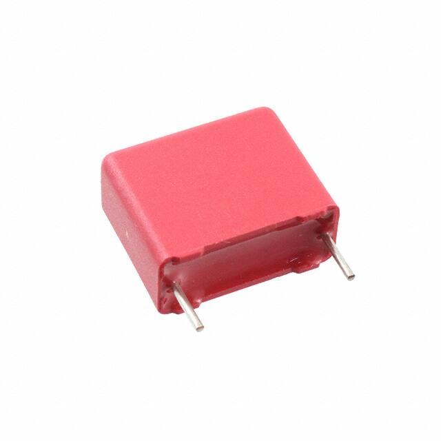

    0.056 µF 薄膜电容器 300V 聚丙烯(PP),金属化 径向
MKY22W25604F00KSSD 数据手册
® WIMA MKP-Y2 Metallized Polypropylene (PP) RFI-Capacitors Class Y2 in PCM 10 mm to 37.5 mm. Capacitances from 1000 pF to 1.0 F. Rated Voltage 300 VAC. Special Features Electrical Data O Reliable self-healing O High degree of interference suppression due to good attenuation and low ESR O AEC-Q200 qualified O According to RoHS 2015/863/EU Typical Applications Class Y2 RFI applications to meet EMC regulations O Capacitors connected to the mains between phase or neutral and earthed casing O By-passing of the basic or supplementary insulation, pulse peak voltage  5 kV Construction Capacitance range: 1000 pF to 1.0 F Rated voltage: 300 VAC Continuous DC voltage* (general guide):  1000 V Capacitance tolerances: ±20%, ±10%, ±5% Operating temperature range: –55° C to +105° C Climatic test category: 55/105/56 in accordance with IEC Passive flammability class: B for capacitors with  V  1750 mm3 C for capacitors with V  1750 mm3 Dissipation factors at + 20° C: tan  at f   1 kHz   10 kHz 100 kHz Insulation resistance at +20° C: C T 0.33 F:  1.5 x104 MΩ C  0.33 F:  5 000 sec (MΩ x F) Measuring voltage: 100 V/1 min. Test specifications: In accordance with IEC 60384-14 Maximum pulse rise time: 100 V/sec for pulses equal to a voltage amplitude with 2 x 300 VAC = 425 V according to IEC 60384-14 Test voltage: 2700 VDC, 2 sec. Reliability: Operational life  300 000 hours Failure rate  2 fit (0.5 x Ur and 40° C) C  0.1 F 0.1 F < C T 1.0 F  18 x 10-4  20 x 10-4  20 x 10-4  60 x 10-4 100 x 10-4 – Approvals: Dielectric: Polypropylene (PP) film Capacitor electrodes: Vacuum-deposited Internal construction: Country Authority Specification Symbol Approval-No. Germany VDE IEC 60384-14/4 40008997 USA/Canada UL UL 60384-14 CAN/CSA-E60384-14 E 134915 Dielectric Vacuum-deposited electrode Metal contact layer (schoopage) Terminating wire PCM 10: triple series connection Encapsulation: Solvent-resistant, flame-retardant plastic case with epoxy resin seal, UL 94 V-0 Terminations: Tinned wire. Marking: Colour: Red. Marking: Black. Mechanical Tests Packing Pull test on pins: 10 N in direction of pins according to IEC 60068-2-21 Vibration: 6 hours at 10 ... 2000 Hz and 0.75 mm displacement amplitude or 10 g in accordance with IEC 60068-2-6 Low air density: 1kPa = 10 mbar in accordance with IEC 60068-2-13 Bump test: 4000 bumps at 390 m/sec2 in accordance with IEC 60068-2-29 Available taped and reeled. * If safety-approved EMI suppression capacitors are operated with a DC voltage being above the specified AC voltage rating the given approvals are no longer valid (IEC 60384-14). For further details and graphs please refer to Technical Information. Detailed taping information and graphs at the end of the catalogue. Furthermore the permissible pulse rise time du/dt (Fmax.) will be subject to a reduction according to 04.23 Fmax. = Fr x 2 x UAC / UDC if the DC operating voltage UDC is higher than 2 x UAC 95 ® WIMA WIMAMKP-Y2 FKP 4 Continuation General Data pF W 4 H 9.5 300 VAC* L 13 „ 4 9.5 13 „ 4 9.5 13 10 „ 4 9.5 13 10 Capacitance 1000 1200 1500 1800 2200 2700 3300 3900 4700 5600 6800 PCM** 10 10 „ 4 9.5 13 10 „ 4 9.5 13 10 „ 4 9.5 13 10 „ 4 9.5 13 10 „ 5 11 13 10 „ 5 11 13 10 „ 6 12.5 13 10 5 11 18 15 8200 „ 6 12.5 13 10 0.01 F 5 8 11 12 18 13 15 10 5 11 18 15 5 11 18 15 5 11 18 15 5 11 18 15 6 12.5 18 15 6 12.5 18 15 8 15 18 15 8 15 18 15 8 15 18 15 8 15 18 15 9 16 18 15 6 15 26.5 22.5 7 16.5 26.5 22.5 0.012 „ 0.015 „ 0.018 „ 0.022 „ 0.027 „ 0.033 „ 0.039 „ 0.047 „ 0.056 „ 0.068 „ 0.082 „ Part number MKY22W11003D00_ _ _ _ MKY22W11203D00_ _ _ _ MKY22W11503D00_ _ _ _ MKY22W11803D00_ _ _ _ MKY22W12203D00_ _ _ _ MKY22W12703D00_ _ _ _ MKY22W13303D00_ _ _ _ MKY22W13903D00_ _ _ _ MKY22W14703F00_ _ _ _ MKY22W15603F00_ _ _ _ MKY22W16803H00_ _ _ _ MKY22W16804B00_ _ _ _ MKY22W18203H00_ _ _ _ MKY22W18204B00_ _ _ _ MKY22W21003I00_ _ _ _ MKY22W21004B00_ _ _ _ MKY22W21204B00_ _ _ _ MKY22W21504B00_ _ _ _ MKY22W21804B00_ _ _ _ MKY22W22204C00_ _ _ _ MKY22W22704C00_ _ _ _ MKY22W23304F00_ _ _ _ MKY22W23904F00_ _ _ _ MKY22W24704F00_ _ _ _ MKY22W25604F00_ _ _ _ MKY22W26804J00_ _ _ _ MKY22W26805B00_ _ _ _ MKY22W28205D00_ _ _ _ * f = 50/60 Hz ** PCM = Printed circuit module = pin spacing Dims. in mm. Part number completion: Tolerance: 20 % = M 10 % = K   5 % = J Packing: bulk = S Pin length: 6-2 = SD Taped version see page 157. d = 0.6 Ø if PCM = 10 d = 0.8 Ø if PCM = 15 - 22.5 Rights reserved to amend design data without prior notification. 04.23 Continuation page 97 96 ® WIMA WIMAMKP-Y2 FKP 4 Continuation General Data Capacitance 0.1 F 0.12 „ 0.15 „ 0.18 „ W 7 H 16.5 300 VAC* L 26.5 8.5 18.5 26.5 8.5 18.5 26.5 22.5 9 19 31.5 27.5 22.5 19 32 41.5 37.5 Part number MKY22W31005D00_ _ _ _ MKY22W31205F00_ _ _ _ MKY22W31505F00_ _ _ _ MKY22W31506A00_ _ _ _ MKY22W31805G00_ _ _ _ MKY22W31806A00_ _ _ _ MKY22W32205I00_ _ _ _ MKY22W32206A00_ _ _ _ MKY22W32706B00_ _ _ _ MKY22W33306B00_ _ _ _ MKY22W33307C00_ _ _ _ MKY22W33906D00_ _ _ _ MKY22W33907C00_ _ _ _ MKY22W34706F00_ _ _ _ MKY22W34707C00_ _ _ _ MKY22W35606F00_ _ _ _ MKY22W35607C00_ _ _ _ MKY22W35607D00_ _ _ _ MKY22W36806G00_ _ _ _ MKY22W36807D00_ _ _ _ MKY22W36807E00_ _ _ _ MKY22W38206I00_ _ _ _ MKY22W38207E00_ _ _ _ MKY22W38207F00_ _ _ _ 20 17 20 39.5 29 39.5 31.5 41.5 41.5 27.5 37.5 37.5 MKY22W41006J00_ _ _ _ MKY22W41007E00_ _ _ _ MKY22W41007G00_ _ _ _ 22.5 19 26.5 9 19 31.5 27.5 0.22 „ 11 21 26.5 22.5 9 19 31.5 27.5 0.27 „ 11 21 31.5 27.5 0.33 „ 0.39 „ 0.47 „ 0.56 „ 0.68 „ 0.82 „ 1.0 F 10.5 PCM** 22.5 11 21 31.5 27.5 13 24 41.5 37.5 13 24 31.5 27.5 13 24 41.5 37.5 15 26 31.5 27.5 13 24 41.5 37.5 15 26 31.5 27.5 13 24 41.5 37.5 15 26 41.5 37.5 17 29 31.5 27.5 15 26 41.5 37.5 17 29 41.5 37.5 17 34.5 31.5 27.5 17 29 41.5 37.5 * f = 50/60 Hz 10 ** PCM = Printed circuit module = pin spacing Z  Dims. in mm. 1 Taped version see page 157. 0.1 7 5 3 0.01 7 5 3 0.001 d = 0.8 Ø if PCM  27.5 d = 1.0 Ø if PCM = 37.5 M PC µF/ 1.0 -- Tolerance: 20 % = M 10 % = K   5 % = J Packing: bulk = S Pin length: 6-2 = SD 0 M1 PC 0 pF/ M1 00 PC 33 / F -5 1µ M1 0.0 PC -5 µF/ 22 M1 PC 2.5 0.0 2 -µF/ 68 PCM 2.5 / 0.0 M2 -- .1 µF /PC 0 F -2µ 0.2 .5 -27 Part number completion: 7 5 3 105 3 5 3 5 7 107 108 f/Hz Impedance change with frequency (general guide). Rights reserved to amend design data without prior notification. 04.23 AC current graphs see page 94 97 ® WIMA MKP-X2 Continuation Permissible AC current in relation to frequency at 10° C internal temperature rise (general guide). 10 Irms A 10 Irms A 10 Irms A 1 1 1 0.1 7 .04 µF 0.1 µF 12 0.0 pF 00 33 0 pF 0 10 0 0.01 PCM 7.5 0.01 0.1 µF µF 0.1 047 . 0 F 1µ 0.0 PCM 10 102 2 103 2 5 5 104 2 5 105 f Hz 0.001 102 2 106 5 103 2 5 104 2 5 105 f Hz 102 2 106 100 Irms A 100 Irms A 100 Irms A 10 10 10 1 0.1 µF 3.9 7 µF 2. F 7µ 0.4 1 F 2µ F 0.8 47 µ F . 0 5µ 0.1 PCM 22.5 5 103 2 5 104 2 5 105 f Hz 5 104 2 5 105 f Hz 106 PCM 37.5 0.1 0.01 102 2 106 103 2 PCM 27.5 0.01 102 2 5 µF 10 µF 3.3 µF 1.5 1 0.1 0.01 PCM 15 0.01 0.001 0.001 F 3µ F 0.3 15 µ F 0. .1 µ µF 0 056 0. 5 103 2 5 104 2 5 105 f Hz 102 2 106 5 103 2 5 104 2 5 105 f Hz 106 WIMA MKP-Y2 10 Irms A 10 Irms A 1 1 0.1 0.1 F 1µ 0.0 0 pF 0 3 3 pF 00 10 0.01 0.001 102 2 5 103 2 PCM 10 0.01 104 2 5 105 f Hz 102 2 106 100 Irms A 100 Irms A 10 10 10 1 1 F 2µ 0.2 1 µF µF 0. 068 0. 0.1 PCM 27.5 0.1 102 2 5 103 2 5 104 2 5 105 f Hz 106 5 103 2 5 104 2 5 µF .68 µF F 0 .33 µ F 1.0 7 µ 0 0.4 105 f Hz 106 PCM 37.5 0.01 0.01 0.01 102 2 5 103 2 Technical information and general data see page 95 94 1 µF 1.0 9 µF 0.3 5 µF 0.1 PCM 22.5 PCM 15 0.001 5 100 Irms A 0.1 µF 68 F 0.0 22 µ F 0.0 01 µ pF 0. 00 8 6 5 104 2 5 105 f Hz 106 102 2 5 103 2 5 104 2 5 105 f Hz 106 04.23 Permissible AC current in relation to frequency at 10° C internal temperature rise (general guide). ® Recommendation for Processing and Application of Through-Hole Capacitors Soldering Process Internal temperature of the capacitor must be kept as follows: Polyester: preheating: Tmax. T125° C soldering: Tmax. T135° C Polypropylene: preheating: Tmax. T100° C soldering: Tmax. T110° C Single wave soldering Soldering bath temperature: T P 260 ° C Dwell time: t P 5 sec Double wave soldering Soldering bath temperature: T P 260 ° C Dwell time: ∑t P 5 sec Due to different soldering processes and heat requirements the graphs are to be regarded as a recommendation only. WIMA Quality and Environmental Philosophy ISO 9001:2015 Certification ISO 9001:2015 is an international basic standard of quality assurance systems for all branches of industry. The approval according to ISO 9001:2015 of our factories certifies that organisation, equipment and monitoring of quality assurance in our factories correspond to internationally recognized standards. WIMA WPCS The WIMA Process Control System (WPCS) is a quality surveillance and optimization system developed by WIMA. WPCS is a major part of the quality-oriented WIMA production. Points of application during production process: All WIMA capacitors, irrespective of whether through-hole devices or SMD, are made of environmentally friendly materials. Neither during manufacture nor in the product itself any toxic substances are used, e.g. – Lead – PBB/PBDE – PCB – Arsenic – CFC – Cadmium – Hydrocarbon chloride – Mercury – Chromium 6+ – etc. We merely use pure, recyclable materials for packing our components, such as: ! ! ! ! carton cardboard adhesive tape made of paper polystyrene We almost completely refrain from using packing materials such as: ! adhesive tapes made of plastic ! metal clips RoHS Compliance According to the RoHS Directive 2015/863/EU as amended from time to time certain hazardous substances like e.g. lead, cadmium, mercury must not be used any longer in electronic equipment as of July 1st, 2006. For the sake of the environment WIMA has re-fraind from using such substances since years already. WIMA Kondensatoren sind bleifrei konform RoHS 2015/863/EU WIMA capacitors are lead free in accordance with RoHS 2015/863/EU Tape for lead-free WIMA capacitors DIN EN ISO 14001:2004 WIMA’s environmental management has been established in accordance with the guidelines of DIN EN ISO 14001:2004 to optimize the production processes with regard to energy and resources. 04.23 ! incoming material inspection ! metallization ! film inspection ! schoopage ! pre-healing ! pin attachment ! cast resin preparation/encapsu lation ! 100% final inspection ! Testing as per customer require ments WIMA Environmental Policy 15 ® Typical Dimensions for Taping Configuration Vh P P2 Diagram 1: PCM 2.5/5/7.5mm W W1 W0 H H1 W2 P1 D0 d P t F P0 H1 P P1 H P1 d d F P0 P2 Diagram 2: PCM 10/15 mm Diagram 3: PCM 22.5 and 27.5*mm *PCM 27.5 taping possible with two feed holes between components Designation Carrier tape width Dimensions for Radial Taping Symbol PCM 2.5 taping W P0 P2 F PCM 5 taping PCM 7.5 taping PCM 10 taping* PCM 15 taping* PCM 22.5 taping PCM 27.5 taping 18.0 ±0.5 18.0 ±0.5 18.0 ±0.5 18.0 ±0.5 18.0 ±0.5 18.0 ±0.5 18.0 ±0.5 for hot-sealing for hot-sealing for hot-sealing for hot-sealing for hot-sealing for hot-sealing for hot-sealing Hold-down tape width W0 6.0 6.0 12.0 12.0 12.0 12.0 12.0       adhesive tape       adhesive tape        adhesive tape        adhesive tape        adhesive tape        adhesive tape        adhesive tape Hole position W1 9.0 ±0.5 9.0 ±0.5 9.0 ±0.5 9.0 ±0.5 9.0 ±0.5 9.0 ±0.5 9.0 ±0.5 Hold-down tape position W2 Feed hole diameter D0 4.0 ±0.2 4.0 ±0.2 4.0 ±0.2 4.0 ±0.2 4.0 ±0.2 4.0 ±0.2 4.0 ±0.2 *38.1 ±1.5 or 50.8 ±1.5 P 12.7 ±1.0 12.7 ±1.0 12.7 ±1.0 25.4 ±1.0 25.4 ±1.0 38.1 ±1.5 0.5 to 3.0 max. 0.5 to 3.0 max. Pitch of component cumulative pitch Feed hole pitch P0 12.7  ±0.3 error max. 12.7 ±0.3 1.0 mm/20 pitch 0.5 to 3.0 max. cumulative pitch error max. 1.0 mm/20 pitch 12.7 ±0.3 0.5 to 3.0 max. cumulative pitch error max. 1.0 mm/20 pitch 12.7 ±0.3 cumulative pitch error max. 1.0 mm/20 pitch 0.5 to 3.0 max. 12.7 ±0.3 0.5 to 3.0 max. cumulative pitch error max. 1.0 mm/20 pitch 12.7 ±0.3 cumulative pitch error max. 1.0 mm/20 pitch 0.5 to 3.0 max. 12.7 ±0.3 cumulative pitch error max. 1.0 mm/20 pitch Feed hole centre to pin P1 5.1 ±0.5 3.85 ±0.7 2.6 ±0.7 7.7 ±0.7 5.2 ±0.7 7.8 ±0.7 5.3 ±0.7 Hole centre to component centre P2 6.35 ±1.3 6.35 ±1.3 6.35 ±1.3 12.7 ±1.3 12.7 ±1.3 19.05 ±1.3 19.05 ±1.3 Feed hole centre to bottom H▲ edge of the component 16.5 ±0.3 16.5 ±0.3 16.5 ±0.5 16.5 ±0.5 16.5 ±0.5 16.5 ±0.5 16.5 ±0.5 18.5 ±0.5 18.5 ±0.5 18.5 ±0.5 18.5 ±0.5 18.5 ±0.5 18.5 ±0.5 18.5 ±0.5 Feed hole centre to top H+Hcomponent < H1 H+Hcomponent < H1 H+Hcomponent < H1 H+Hcomponent < H1 H+Hcomponent < H1 H+Hcomponent < H1 H+Hcomponent < H1 H edge of the component 1 32.25 max. 32.25 max. 24.5 to 31.5 25.0 to 31.5 26.0 to 37.0 30.0 to 43.0 35.0 to 45.0 Pin spacing at +0.8 F 2.5 ±0.5 5.0 7.5 ±0.8 10.0 ±0.8 15 ±0.8 22.5 ±0.8 27.5 ±0.8 upper edge of carrier tape     –0.2 Pin diameter d Component alignment ∆h Total tape thickness t 0.4 ±0.05 0.5 ±0.05 ± 2.0 max. ± 2.0 max. $ +0.06 ± 3.0 max. ± 3.0 max. 04.23 +0.08 +0.08 ± 3.0 max. ± 3.0 max. ± 3.0 max. AMMO 52 ±2 max. REEL   Ø 360 max. B 58 ±2 or REEL ØØ 500 25 ±1  Ø 30 ±1 66 ±2 Unit ▲ +0.08 0.6 ±0.2 0.6 ±0.2 0.6 ±0.2 0.6 ±0.2 0.6 ±0.2 0.6 ±0.2 0.6 ±0.2 ROLL/AMMO Package ▲ 52 ±2 depending on Ø 360 max. (see also page 158) B REEL Ø 30 ±1 58 ±2 comp. dimensions  +0.06 0.5 ±0.05 or 0.6–0.05 $0.5 ±0.05 or 0.6 –0.05 0.8  –0.05 0.8  –0.05 0.8  –0.05 When ordering please specify dimension H and required packaging type. $ Diameter of pins see General Data.  54 ±2 B 60 ±2  68 ±2 depending on PCM and component dimensions see details page 159. Dims in mm. Please clarify customer-specific deviations with the manufacturer. * PCM 10 and PCM 15 can be crimped to PCM 7.5. Position of components according to PCM 7.5 (sketch 1). P0 = 12.7 or 15.0 is possible 157 ® Types of Tape Packaging of Capacitors for Automatic Radial Insertion O REEL Packaging 340 max.  30±1 25±1 360 max. 500 max. O AMMO Packaging 340 max. 370 max. O ROLL Packaging 34 0m ax. 50 max. 50 max. 70 max. . ax 0 m ax. 34 0 m 49 B BAR CODE (Labelling) Labelling of package units in plain text and with alphanumerical Bar Code BARCODE PDF417 BARCODE 2D Datamatrix ! WIMA supplier number ! Date code ! Customer‘s P/O number ! P/O line ! Customer‘s part number ! WIMA part number ! Quantity ! WIMA confirmation number ! Country of origin ! Customer name ! Handling unit number ! Week of delivery. In addition part description of article capacitance value rated voltage dimensions technical note capacitance tolerance packing connecting information 04.23 – – – – – – – – 158 ® Packing Quantities for Capacitors with Radial Pins in PCM 2.5 mm to 27.5 mm Size PCM 2.5 mm 5 mm 7.5 mm 10 mm 15 mm 22.5 mm 04.23 27.5 mm W  2.5  3  3.8  4.6  5.5  2.5  3  3.5  4.5  4.5  5  5.5  5.5  6.5  7.2  7.2  8.5  8.5 11  2.5  3  4  4.5  5  5.7  7.2  3  4  4  5  6  6  8  5  6  7  8  9  9 11  5  6  7  8.5 10.5 10.5 11  9 11 13 15 17 17 20 H  7  7.5  8.5  9 10  6.5  7.5  8.5  6  9.5 10  7 11.5  8  8.5 13 10 14 16  7  8.5  9  9.5 10.5 12.5 12.5  9  9  9.5 11 12 12.5 12 11 12.5 14 15 14 16 14 14 15 16.5 18.5 19 20.5 21 19 21 24 26 29 34.5 39.5 pcs. per packing unit REEL AMMO Ø 360 Ø 500 340 x 340 490 x 370 H16.5 H18.5 H16.5 H18.5 H16.5 H18.5 H16.5 H18.5 H16.5 H18.5 N O F I H J A C B D 2200 2500 – 2800 – 2000 2300 – 2300 – 1500 1800 – 1800 – 1200 1500 – 1500 –  900 1200 – 1200 – 2200 2500 – 2800 – 2000 2300 – 2300 – 1600 2000 – 2000 – 1300 1500 – 1500 – 1300 1500 – 1500 – 1100 1400 – 1400 – 1000 1200 – 1200 – 1000 1200 – 1200 –  800 1000 – 1000 –  700 1000 – 1000 –  700  950 – 1000 –  600  800 –  800 –  600  800 –  800 –  500  600 –  640 – – 2500 4400 2500 – – 2200 4300 2300 4150 – 1700 3200 1700 3000 – 1500 2900 1400 2700 – 1300 2500 1300 – – 1000 2200 1100 – –  900 1800 1000 – – 1100 2200 – 1900 –  900 1600 – 1450 –  900 1600 – 1400 –  700 1300 – 1100 –  550 1100 – 1000 –  550 1100 – 1000 –  400  800 –  740 –  600 1200 – 1150 –  500 1000 – 1000 –  450  900 –  850 –  400  800 –  740 –  350  700 –  650 –  350  700 –  650 –  300  600 –  540 – –  800 –  770 – –  700 –  640 – –  600 –  550 – –  480 –  450 – –  400 –  360 – –  400 –  360 – –  380 –  350 – – 460/340* – – – – 380/280* – – – –  300 – – – –  270 – – – – – – – – – – – – – – – – – ROLL bulk L Codes  4.6 0B  4.6 0C  4.6 0D  4.6 0E  4.6 0F  7.2 1A  7.2 1B  7.2 1C  7.2 1D  7.2 1E  7.2 1F  7.2 1G  7.2 1H  7.2 1I  7.2 1J  7.2 1K  7.2 1L  7.2 1M  7.2 1N 10 2A 10 2B 10 2C 10.3 2D 10.3 2E 10.3 2F 10.3 2G 13 3A 13 3C 13 3D 13 3F 13 3G 13 3H 13 3I 18 4B 18 4C 18 4D 18 4F 18 4H 18 4J 18 4M 26.5 5A 26.5 5B 26.5 5D 26.5 5F 26.5 5G 26.5 5H 26.5 5I 31.5 6A 31.5 6B 31.5 6D 31.5 6F 31.5 6G 31.5 6I 31.5 6J S 5000 5000 5000 5000 5000 5000 5000 5000 6000 4000 3500 4000 2500 2500 2500 2000 2000 1500 1000 5000 5000 4000 3500 3000 2000 1500 3000 3000 3000 3000 2400 2400 2000 2400 2000 1600 1200 1200  900 1000 1200 1000  760  500 594* 594* 561*  567*  459*  378*  324*  198*  198*   162* * for 2-inch transport pitches. * TPS (Tray-Packing-System). Plate versions may have different packing units. Samples and pre-production needs on request. Rights reserved to amend design data without prior notification. 159 ® Packing Quantities for Capacitors with Radial Pins in PCM 37.5 mm to 52.5 mm Size PCM pcs. per packing unit REEL AMMO Ø 360 Ø 500 340 x 340 490 x 370 H16.5 H18.5 H16.5 H18.5 H16.5 H18.5 H16.5 H18.5 H16.5 H18.5 N O F I H J A C B D – – – – – – – – – – – – – – – – – – – – – – – – – – – – – – – – – – – – – – – – – – – – – – – – – – – – – – – – – – – – ROLL bulk W  9 11 13 15 17 19 20 24 28 31 35 40 H 19 22 24 26 29 32 39.5 45.5 38 46 50 55 L Codes 41.5 7A 41.5 7B 41.5 7C 41.5 7D 41.5 7E 41.5 7F 41.5 7G 41.5 7H 41.5 7L 41.5 7I 41.5 7J 41.5 7K S 441* 357* 294* 252* 154* 140* 126* 112*  84*  84*  35*  28* 48.5 mm** 19 23 27 33 37 31 34 37.5 48 54 56 56 56 56 56 8D 8E 8H 8J 8L 120*  80*  84*  25*  25* – – – – – – – – – – – – – – – – – – – – – – – – – 52.5 mm 25 30 35 45 45 45 45 50 55 65 57 57 57 57 57 9D 9E 9F 9H 9J  70*  60*  25*  20*  20* – – – – – – – – – – – – – – – – – – – – – – – – – 37.5 mm** * TPS (Tray-Packing-System). Plate versions may have different packing units. **For Snubber capacitors in 2-pin version the PCM is changing to 38.5 respective 49.5 mm. Samples and pre-production needs on request. Rights reserved to amend design data without prior notification. 04.23 Updated data on www.wima.com 160 ® WIMA Part Number System A WIMA part number consists of 18 digits and is composed as follows: Field   1 -   4: Type description Field   5 -   6: Rated voltage Field   7 - 10: Capacitance Field 11 - 12: Size and PCM Field 13 - 14: Version code (e.g. Snubber versions) Field 15: Capacitance tolerance Field 16: Packing Field 17 - 18: Pin length (untaped) 1 2 3 4 5 6 7 8 9 10 11 12 13 14 15 16 17 18 M K S 2 C 0 2 1 0 0 1 A 0 0 M S S D 20 % bulk MKS 2 04.23 Type description: SMD-PET = SMDT SMD-PEN = SMDN SMD-PPS = SMDI FKP 02 = FKP0 MKS 02 = MKS0 FKS 2 = FKS2 FKP 2 = FKP2 FKS 3 = FKS3 FKP 3 = FKP 3 MKS 2 = MKS2 MKP 2 = MKP2 MKS 4 = MKS4 MKP 4 = MKP4 MKP 10 = MKP1 FKP 4 = FKP4 FKP 1 = FKP1 MKP-X2 = MKX2 MKP-X1 R = MKX1 MKP-Y2 = MKY2 MKP 4F = MKPF Snubber MKP = SNMP Snubber FKP = SNFP GTO MKP = GTOM DC-LINK MKP 4 = DCP4 DC-LINK MKP 6 = DCP6 DC-LINK HC = DCHC 63 VDC Rated voltage: 50 VDC = B0 63 VDC = C0 100 VDC = D0 250 VDC = F0 400 VDC = G0 450 VDC = H0 520 VDC = H2 600 VDC = I0 630 VDC = J0 700 VDC = K0 800 VDC = L0 850 VDC = M0 900 VDC = N0 1000 VDC = O1 1100 VDC = P0 1200 VDC = Q0 1250 VDC = R0 1500 VDC = S0 1600 VDC = T0 1700 VDC = TA 2000 VDC = U0 2500 VDC = V0 3000 VDC = W0 4000 VDC = X0 6000 VDC = Y0 230 VAC = 3Y 275 VAC = 1W 300 VAC = 2W 305 VAC = AW 350 VAC = BW 440 VAC = 4W ... 0.01 F Capacitance: 22 pF = 0022 47 pF = 0047 100 pF = 0100 150 pF = 0150 220 pF = 0220 330 pF = 0330 470 pF = 0470 680 pF = 0680 1000 pF = 1100 1500 pF = 1150 2200 pF = 1220 3300 pF = 1330 4700 pF = 1470 6800 pF = 1680 0.01 F = 2100 0.022 F = 2220 0.047 F = 2470 0.1 F = 3100 0.22 F = 3220 0.47 F = 3470 = 4100 1 F 2.2 F = 4220 4.7 F = 4470 = 5100 10 F = 5220 22 F = 5470 47 F 100 F = 6100 220 F = 6220 1000 F = 7100 1500 F = 7150 ... 2.5 x 6.5 x 7.2 Size: 4.8 x 3.3 x 3 Size 1812 4.8 x 3.3 x 4 Size 1812 5.7 x 5.1 x 3.5 Size 2220 5.7 x 5.1 x 4.5 Size 2220 7.2 x 6.1 x 3 Size 2824 7.2 x 6.1 x 5 Size 2824 10.2 x 7.6 x 5 Size 4030 12.7 x 10.2 x 6 Size 5040 15.3 x 13.7 x 7 Size 6054 2.5 x 7 x 4.6 PCM 2.5 3 x 7.5 x 4.6 PCM 2.5 2.5 x 6.5 x 7.2 PCM 5 3 x 7.5 x 7.2 PCM 5 2.5 x 7 x 10 PCM 7.5 3 x 8.5 x 10 PCM 7.5 3 x 9 x 13 PCM 10 4 x 9 x 13 PCM 10 5 x 11 x 18 PCM 15 6 x 12.5 x 18 PCM 15 5 x 14 x 26.5 PCM 22.5 6 x 15 x 26.5 PCM 22.5 9 x 19 x 31.5 PCM 27.5 11 x21 x 31.5 PCM 27.5 9 x 19 x 41.5 PCM 37.5 11 x 22 x 41.5 PCM 37.5 19 x 31 x 56 PCM 48.5 25 x 45 x 57 PCM 52.5 ... Version code: Standard Version A1 Version A1.1.1 Version A2 ... = 00 = 1A = 1B = 2A - = KA = KB = QA = QB = TA = TB = VA = XA = YA = 0B = 0C = 1A = 1B = 2A = 2B = 3A = 3C = 4B = 4C = 5A = 5B = 6A = 6B = 7A = 7B = 8D = 9D 6 -2 Tolerance: ±20 % = M ±10 % = K ±5 % =J ±2.5 % = H ±1 % =E ... Packing: AMMO H16.5 340 x 340 AMMO H16.5 490 x 370 AMMO H18.5 340 x 340 AMMO H18.5 490 x 370 REEL H16.5 360 REEL H16.5 500 REEL H18.5 360 REEL H18.5 500 ROLL H16.5 ROLL H18.5 BLISTER W12 180 BLISTER W12 330 BLISTER W16 330 BLISTER W24 330 Bulk/TPS Standard ... =A =B =C =D =F =H =I =J =N =O =P =Q =R =T =S Pin length (untaped) 3.5 ±0.5 = C9 6 -2 = SD 16 ±1 = P1 ... Pin length (taped) none = 00 The data on this page is not complete and serves only to explain the part number system. Part number information is listed on the pages of the respective WIMA range. 155
