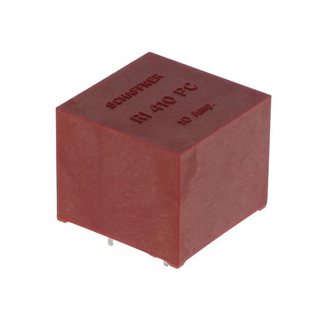

RI410PC
RI410PC
    SCHAFFNER(夏弗纳)
    插件,33x33mm
    1 mH 无屏蔽 电感器 10 A 28 毫欧 径向,水平 - 角端子
RI410PC 数据手册
DATA SHEET Saturating Chokes RI series Saturating Chokes Rated currents from 1.5 to 25 A Approvals & Compliances Up to 500 VAC operating voltage DC to 1 kHz frequency Single or dual-choke configurations Performance indicators RI saturating type chokes change impedance at the moment of switching, and can be used to attenuate differential-mode noise or symmetrical interference as generated in fast switching high current applications. These chokes are typically used in conjunction with suppression capacitors. For optimum attenuation chokes must be connected as close as possible to the semiconductor switching device. Features and Benefits Excellent thermal behavior Through hole or wire connections Single or dual-choke configurations Up to 25 A single configuration Technical Specifications Custom-specific versions are available on request Typical Applications Maximum continuous operating voltage 500 VAC @ 40°C Rated currents 1.5 to 25 A Suppressing high interference levels generated by fast switching circuits and/or winding-to-inserts 2500 V, 50 Hz, 2 sec, factory test DC voltage smoothing Surge current @ 10 msec 20 x IN @ 25°C EMC/EMI filters Temperature range (operation and storage) -25°C to +110°C (25/110/21) Phase angle control circuits Flammability corresponding to UL 94 V-0 Power supplies High potential test voltage Chargers Typical electrical schematic 2 Saturating Chokes Schaffner Group DATA SHEET 10. May 2023 Choke Selection Table Choke Nominal current Resistance Choke Input/Output @ 40°C R configuration connections [A] [mΩ/path] [Qty] 6 42 2 02 170 RI 401 PC 1.5 620 1 02 15 RI 403 PC 3 105 1 02 30 RI 406 PC 6 53 1 02 55 RI 410 PC 10 28 1 02 RI 415 15 8 1 07 205 RI 425 25 4 1 07 325 RI 111 PC Test conditions: Resistance tolerance: ±15% @ 25°C Electrical characteristics @ 25°C: ±2°C Typical Saturation Characteristics Inductance (typical value in %) vs. nominal current in % RI series Weight [g] 95 3 Saturating Chokes Schaffner Group DATA SHEET 10. May 2023 Mechanical Data RI 111 RI 401, RI 403, RI 406 RI 410 RI 415, RI 425 1 3 2 4 1, 2 3, 4 Dimensions RI 111 RI 401 RI 403 RI 406 RI 410 RI 415 RI 425 A 49 19.5 23.3 28.5 33 35 48 B 35 19.5 23.3 28.5 33 49 48 C 34 15 18 21.5 28 34 43 D 15 4 ±0.5 6 ±0.5 4.5 ±0.5 6 ±0.5 200 200 E Ø1.15 0.6 x 0.88 Ø0.9 0.6 x 0.88 0.75 x 1.1 F 1 10 ±2 10 ±2 20 12.5 15 20 17.5 22 39 H 40 7.5 10 10 15 36 35 M4 M4 M4 ±0.3 ±0.1 G I 1 Tolerances J 6 6 6 +0/-0.5 L 21 30 30 ±0.25 All dimensions in mm; 1 inch = 25.4 mm Tolerances according: ISO 2768-m/EN 22768-m Please visit www.schaffner.com to find more details on filter connections. 4 Saturating Chokes Schaffner Group DATA SHEET 10. May 2023 Headquarters, Global Innovation and Development Switzerland Schaffner Group Industrie Nord Nordstrasse 11e 4542 Luterbach +41 32 681 66 26 info@schaffner.com Sales and Application Centers Finland Schaffner Oy Sauvonrinne 19 H 8500 Lohja +358 50 468 7284 finlandsales@schaffner.com Sweden Schaffner EMC AB Östermalmstrorg 1 114 42 Stockholm +46 8 5050 2425 swedensales@schaffner.com France Schaffner EMC S.A.S. 16-20 Rue Louis Rameau 95875 Bezons +33 1 34 34 30 60 francesales@schaffner.com Switzerland Schaffner EMV AG Industrie Nord Nordstrasse 11e 4542 Luterbach +41 32 681 66 26 switzerlandsales@schaffner.com Germany Schaffner Deutschland GmbH Schoemperlenstrasse 12B 76185 Karlsruhe +49 721 56910 germanysales@schaffner.com India Schaffner India Pvt. Ltd Regus World Trade Centre WTC 22nd Floor Unit No 2238 Brigade Gateway Campus 26/1 Dr. Rajkumar Road Malleshwaram (W) 560055 Bangalore +91 8067935355 indiasales@schaffner.com To find your local partner within Schaffner‘s global network schaffner.com Taiwan Schaffner EMV Ltd. U-Town 20 Floor-2 No 97 Section 1 XinTai 5th Road XiZhi District 22175 New Taipei City +886 226975500 taiwansales@schaffner.com Italy Schaffner EMC S.r.l. Via Ticino, 30 20900 Monza (MB) +39 039 21 41 070 italysales@schaffner.com United Kingdom Schaffner Ltd. Suite 1 Oakmede Place Terrace Road RG42 4JF Binfield +44 118 9770070 uksales@schaffner.com Japan Schaffner EMC K.K. ISM Sangenjaya 7F 1-32-12 Kamiuma Setagaya-ku 154-0011 Tokyo +81 3 5712 3650 japansales@schaffner.com United States Schaffner EMC Inc. 52 Mayfield Avenue Edison, New Jersey +1 732 225 9533 usasales@schaffner.com Singapore Schaffner EMC Pte Ltd. Blk 3015A Ubi Road 1 #05-09 Kampong Ubi Industrial Estate 408705 Singapore +65 63773283 singaporesales@schaffner.com © 2023 Schaffner Group The content of this document has been carefully checked and understood. However, neither Schaffner nor its subsidiaries assume any liability whatsoever for any errors or inaccuracies of this document and the consequences thereof. Published specifica-tionsw are subject to change without notice. Product suitability for any area of application must ultimately be determined by the customer. In all cases, products must never be operated outside their published specifications. Schaffner does not guarantee the availability of all published products. This disclaimer shall be governed by substantive Swiss law and resulting disputes shall be settled by the courts at the place of business of Schaffner Holding AG. Latest publications and a complete disclaimer can be downloa-ded from the Schaffner website. All trademarks recognized.
