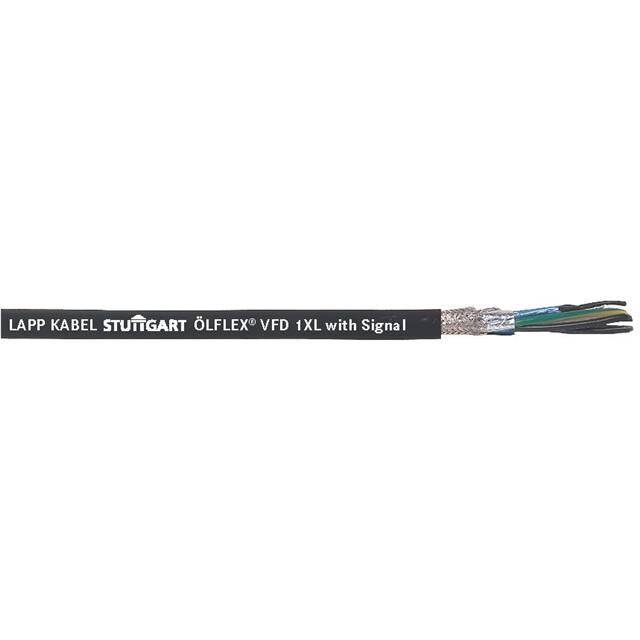

ÖLFLEX® UNCONTROLLED COPY VFD cable Flexible cable for drives, motors & assemblies ÖLFLEX® VFD 1XL with Signal Flexible VFD cable; 600V/1000V; UL & c(UL) TC-ER approval LAPP KABEL Construction Conductors: tinned copper fine wire ÖLFLEX® VFD 1XL with Signal Insulation: XLPE (plus) ÖLFLEX® VFD 1XL w/Signal is a robust oil- and UV-resistant shielded motor cable for VFD drives. Enhanced electrical properties of XLPE insulation provide problem-free performance where precision control is critical. The new leaner design enables reduced cable diameters and increases flexibility. UL TC-ER rating allows for installation without conduit. Shielding: barrier tape; triple layer foil tape (100% coverage); tinned copper braid (85% coverage); tinned copper drain wire Signal Pair: individually foil shielded with TC drain wire Jacket: specially formulated thermoplastic elastomer (TPE); black Application advantage Recommended applications VFD drive and motor connections; pumps; compressors; conveyors; elevators; extruders; presses; HVAC; on/off, slow down/speed up applications. Approvals FIRE PROTECTION Cable attributes page 648 OIL OR-03 FLAME FR-03 MOTION FL-02 MECH. MP-03 •O  ne cable for applications • Low capacitance design •U  L TC-ER & c(UL) CIC approved • Industrial grade phthalate-free jacket design for harsh environments •Reduces space and weight in tray • No conduit required due to TC-ER rating • Resistant to a wide range of disinfecting solutions used in the food, beverage, chemical and related industries, according to ECOLAB® PM 40-1 test procedure Complete the installation SKINTOP® MS-M BRUSH EPIC® ULTRA HB page 524 page 407 Technical data Minimum bend radius: for installation: 7.5 x OD Temperature range: - UL/CSA: -25°C to +90°C - for stationary use: -40°C to +90°C - for flexible use: -25°C to +90°C Color code: black with white numbers, plus green/yellow ground 1-pair: black with white numbers Approvals: UL: TC-ER per UL 1277 Flexible Motor Supply Cable per UL 2277 AWM 22022 per UL 758 Attributes: UL Oil Res I/II 90°C wet or dry -40°C cold bend; -25°C cold impact sunlight resistant direct burial NFPA 79 NEC: Class 1 Division 2 per NEC Article 501 Canada: c(UL) CIC FT4 cRU AWM II A/B FT4 Additional: NFPA 79 RoHS II Meets XHHW-2 performance requirements per UL 44 Nominal voltage: - UL TC: 600V - UL Flexible Motor Supply: 1000V - UL/CSA AWM: 1000V Test voltage: - 18 AWG - 10 AWG: 3000V - 8 AWG - 4 AWG: 3500V - 2 AWG: 4000V Conductor stranding: - 16 AWG - 2 AWG Class K Part number Number of conductors incl. ground 16 AWG (1.5 mm²) 701710 4 + (18 AWG) 14 AWG (2.5 mm²) 701711 4 + (18 AWG) 12 AWG (4 mm²) 701712 4 + (18 AWG) 10 AWG (6 mm²) 701713 4 + (18 AWG) Nominal outer diameter in mm Copper weight lbs/mft Approx. weight lbs/mft SKINTOP® MS-SC metric thread SKINTOP® MS-M BRUSH metric thread 0.446 11.3 72.1 137 53112630 53112676 0.486 12.3 93.4 166 53112630 53112676 0.533 13.5 129.1 210 53112640 53112676 0.593 15.1 179.1 289 53112650 53112677 Part number Number of conductors incl. ground 8 AWG (10 mm²) 701714 4 + (14 AWG) 6 AWG (16 mm²) 701715 4 + (14 AWG) 4 AWG (21 mm²) 701716 4 + (14 AWG) 2 AWG (33.7 mm²) 701717 4 + (14 AWG) Nominal outer diameter in mm Copper weight lbs/mft Approx. weight lbs/mft SKINTOP® MS-SC metric thread SKINTOP® MS-M BRUSH metric thread 0.767 19.5 292.5 448 53112650 53112677 0.958 24.3 442.9 694 53112660 53112678 1.079 27.4 652.1 976 53112660 53112678 1.234 31.3 1008.6 1483 53112670 53112679 ECOLAB® is a registered trademark of Ecolab, Inc. Recommended SKINTOP® assumes minimal OD variance. Additional configurations are available; please see our SKINTOP® section. If not otherwise specified, all values relating to the product are nominal values. Photographs are not to scale and are not true representations of the products in question. for current information see:  www.lappusa.com • www.lappcanada.com 733
