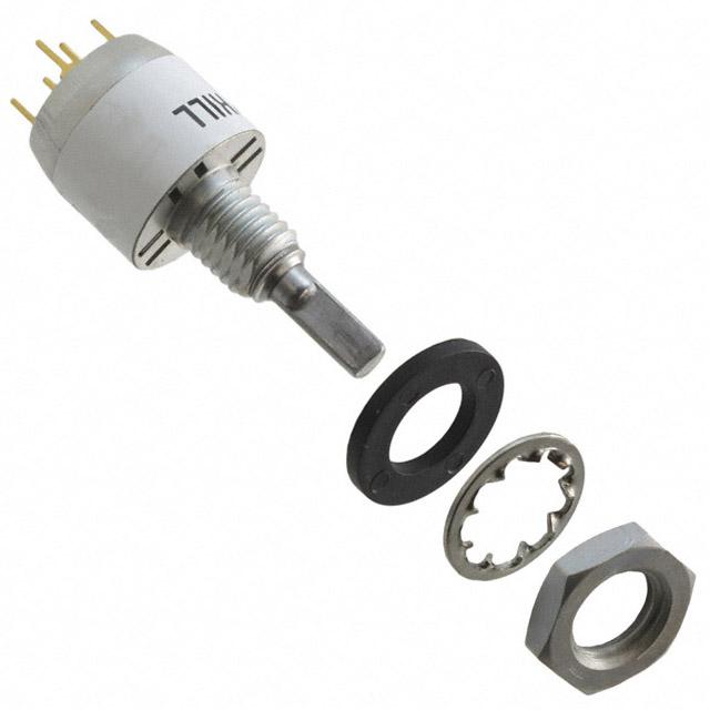

Single Deck Rotary Switches SERIES 50 SERIES 51 0.5" Diameter, 200mA, .698" Behind Panel FEATURES • Optional Complete Seal for PC Board Assembly and Cleaning • Small 1/2" Diameter • Choice of 22.5°, 30°, 36°, 45°, 60° and 90° Angles of Throw • Up to 4 Poles on 1 Deck • Up to 16 Positions Per Switch • PC or Solder Lug Termination • Positive Shaft Grounding for EMI/RFI Shielding DIMENSIONS In inches (and millimeters) PC Mount Style .250±.015 (6,35±0,38) .203 ± .003 (5,16 ± 0,08) ACROSS FLATS DIMENSION "B" .375±.015 (9,53±0,38) Side View All others as shown at left .125±.015 (3,18±0,38) .171 ± .015 (4,34 ± 0,38) .250±.015 (6,35±0,38) .125 (3,18) REF. DIMENSION D POS. 1 Rotary Switches OPTIONAL PANEL SEAL GASKET Ø.125 +.001- .002 (3,18 + 0,03 -0,05) .125 ± .015 (3,18 ± 0,38) Angle of Throw Angle A 45° 60° 90° 112.5° 120° 135° 101.25° 105° 108° Dimension Series 50 D .500 ± .015 (12,70 ± 0,38) Series 51 .562 ± .015 (14,27 ± 0,38) Solder Lug Style .658±.015 (16,71±0,38) .375±.015 (9,53±0,38) Ø .025 ± .002 (0,64 ± 0,05) .062 ± .003 (1,57 ± 0,08) Dimension B Style T .576 ± .015 (14,63 ± 0,38) All Others All 22.5° .537 ± .015 (13,64 ± 0,38) .537 ± .015 (13,64 ± 0,38) .064 ± .005 (1,63 ± 0,13) .020 ± .004 (0,51 ± 0,10) .234±.015 (5,94±0,38) .250±.015 (6,35±0,38) 2 1 10 9 GRAYHILL .153±.015 (3,89±0,38) Ø.125 + .001 - .002 (3,18 + 0,03 - 0,05) Rotary 4 PC COMMON DETAIL All angles of throw, except 22.5° SOLDER LUG TERMINAL DETAIL All angles of throw, except 22.5° .250±.015 (6,35±0,38) Front view same as PC Mount style. TERMINAL SEALANT IN STYLE T .171 ± .015 (4,34 ± 0,38) .020 ± .004 (0,51 ± 0,10) .020 ± .003 (0,51 ± 0,08) 22.5° 30° 36° TERMINAL SEALANT IN STYLE "T" PC TERMINAL DETAIL All angles of throw, except 22.5° Grayhill part number and date code marked on label. Customer part number marked on request. Military part number marked when required. Angle A COMMON Ø .025 ± .002 (0,64 ± 0,06) AND EXTEND TO SAME PLANE AS POSITION TERMINALS 1/4-28 UNF-2A THREAD .093 ± .005 (2,36 ± 0,13) Angle of Throw TERMINALS ARE .016 ± .003 (0,41 ± 0,08) SQ. 2 1 10 9 GRAYHILL A 1/4-28 UNF-2A THREAD Grayhill, Inc. • 561 Hillgrove Avenue • LaGrange, Illinois .032 ± .004 (0,81 ± 0,10) .062 ± .004 (1,57 ± 0,10) SOLDER LUG TERMINAL DETAIL 22.5° .064 ± .005 (1,63 ± 0,13) .016 ± .004 (0,41 ± 0,10) TERMINAL SEALANT IN STYLE "T" .021 ± .004 (0,53 ± 0,10) .046 ± .004 (1,17 ± 0,10) 60525-5997 • USA • Phone: 708-354-1040 • Fax: 708-354-2820 • www.grayhill.com Single Deck Rotary Switches Circuit Diagrams and Rear Views: Solder Lug and PC Mount Rear View SOLDER LUG Circuit as Viewed From Shaft End PC MOUNT COMMON TERMINAL (1 POLE) .382 ± .015 (9,70 ± 0,13) DIAMETER CIRCLE OF TERMINAL CENTERS .156 ± .015 (3,96 ± 0,13) 11.25˚ POS. 1 22.5˚ LOCATION OF COMMONS 2 POLES .500 ± .015 (12,7 ± 0,13) DIA. CIRCLE OF CENTERS 11.25˚ POS. 1 22.5˚ 15˚ 6 9 8 POLE 1 POS. 1 POLE 1 FOUR POLES THREE POLES Dimension A, diameter circle of common centers, is .175 (4,45) for Solder Lug and .232 (5,89) for PC. 6 1 6 .175 ± .005 (4,45 ± 0,13) DIAMETER CIRCLE OF COMMON CENTERS 7 C2 6 5 .125 ± .015 (3,18 ± 0,38) C1 1 5 4 5 1 5 3 2 9 10 C2 1 C1 4 2 36° Angle of Throw 2 3 TWO POLES 7 7 6 8 1 4 5 8 C2 C1 4 2 3 1 8 ONE POLE LOCATION OF COMMONS 2 POLES 12 FOUR POLES 6 6 30° Angle of Throw 11 C4 C1 7 5 45˚ 6 10 COMMON TERMINAL (1 POLE) .320 ± .015 (8,13 ± 0,38) DIAMETER CIRCLE OF TERMINAL CENTERS 22.5˚ POS. 1 C2 9 3 10 C3 6 4 3 9 7 2 8 LOCATION OF COMMONS 2 POLES .125 ± .015 (3,18 ± 0,38) 4 8 12 THREE POLES 7 1 2 TWO POLES 11 3 12 C1 5 C3 4 11 C2 2 10 10 Rotary Switches .320 ± .015 (8,13 ± 0,38) DIAMETER CIRCLE OF TERMINAL CENTERS 36˚ 9 ONE POLE 9 3 5 4 8 7 COMMON TERMINAL (1 POLE) 18˚ POS. 1 6 22.5° Angle of Throw TWO POLES 11 3 1 2 7 12 4 15 16 C1 7 8 DIM. A ± .005 (0,13) 10 14 C2 8 3 5 4 12 13 11 10 9 ONE POLE LOCATION OF COMMONS 2 POLES POS. 1 15 16 2 7 5 30˚ 14 1 LOCATION OF COMMONS 2 POLES COMMON TERMINAL (1 POLE) .156 ± .005 (3,96 ± 0,13) 12 13 8 .156 ± .015 (3,96 ± 0,13) COMMON TERMINAL (1 POLE) .382 ± .005 (9,70 ± 0,13) DIAMETER CIRCLE OF TERMINAL CENTERS POS. 1 11 10 9 1 45° Angle of Throw 2 3 TWO POLES ONE POLE COMMON TERMINAL (1 POLE) .320 ± .015 (8,13 ± 0,38) DIAMETER CIRCLE OF TERMINAL CENTERS 5 5 6 4 4 30˚ 1 3 POS. 1 LOCATION OF COMMONS 2 POLES 60˚ 6 C2 .125 ± .015 (3,18 ± 0,38) C1 3 1 2 2 ONE POLE TWO POLES 60° Angle of Throw COMMON TERMINAL (1 POLE) LOCATION OF COMMONS 2 POLES .320 ± .015 (8,13 ± 0,38) DIAMETER CIRCLE OF TERMINAL CENTERS 4 3 3 4 90° Angle of Throw C2 .125 ± .015 (3,18 ± 0,38) C1 1 2 45˚ ONE POLE POS. 1 2 1 TWO POLES 90˚ Grayhill, Inc. • 561 Hillgrove Avenue • LaGrange, Illinois 60525-5997 • USA • Phone: 708-354-1040 • Fax: 708-354-2820 • www.grayhill.com Rotary 5 Single Deck Rotary Switches SPECIFICATIONS Military Qualification The dimensions for qualified switches are the same as those indicated in the drawings of standard switches. Switches with standard variations, such as shaft and bushing length, which do not affect switch performance, can be marked as qualified product. Contact Grayhill for complete information on variations. 36°, 45°, 60°, 90° (Series 50): The C and M style switches are qualified to MIL‑S‑3786/20. They include the following: Solder lug or PC terminals With or without panel seal Series 50 qualified switches may be ordered by the ‘M’ number or by the Grayhill part number. 30° (Series 51): The C and M style switches are qualified to MIL‑S‑3786/35. They include the following: Solder lug or PC terminals With or without panel seal Series 51 qualified switches may be ordered by the ‘M’ number or by the Grayhill part number. Electrical Ratings Contact Resistance: 20 milliohms maximum, (10 milliohms initially). Insulation Resistance: 1,000 Mohms minimum between mutually insulated parts. Voltage Breakdown: 600 Vac minimum between mutually insulated parts at standard atmospheric pressure. Life Expectancy: Listed for the voltage source and make and break current levels. Contact Grayhill for more information if any of the following is true: the life limiting criteria are more critical than those listed; longer operation is required; a larger make and break current is required; the operating environment includes elevated temperatures or reduced pressures. Contact Carry Rating: Switch will carry 6 amperes continuously with a maximum contact temperature rise of 20°C. Life Expectancy: With the limiting criteria stated here, the Series 50 and 51 with non-shorting contacts will switch the following loads at atmospheric and reduced pressures for 25,000 cycles of operations. One cycle is 360° rotation clockwise and 360° return. At 85°C, atmospheric pressure 200 mA, 28 Vdc resistive 150 mA, 115 Vac resistive 30 mA, 28 Vdc inductive 100 mA, 28 Vdc lamp load 75 mA, 220 Vac lamp load At 25°C, reduced pressure (70,000 feet) 200 mA, 28 Vdc resistive 150 mA, 115 Vac resistive 75 mA, 220 Vac resistive SPECIFICATIONS: Other Rotary Switches Additional Characteristics Contact Type and Forces: Shorting or nonshorting wiping contacts with over 80 grams of contact force. Shaft Flat Orientation: Flat opposite contacting position of pole number one (see circuit diagrams). Terminals: Switches have the full circle of terminals, regardless of number of active position. Stop Strength: 7.5 pound-inches minimum Rotational Torque: 8–24 ounce-inches, depending on the number of poles. Process Sealed–Style T Materials and Finishes 1/4" SHAFT: Style K Switch can be mounted on PC board with other components and subjected to wave soldering and conventional board cleaning techniques. No secondary wiring or soldering is necessary. .250 ±.015 .219 ±.004 Bushing is o-ring sealed; epoxy potting seals the terminals and the rear of the switch. Designed for PC assembly, this sealing technique can also be applied to solder lug terminal switches. A bushing to panel seal can also be added to the process sealed versions. Military qualified ver‑ sions are available, see ordering information. .250 +.001 -.002 .250 ±.015 .340 ±.005 0.208 Grayhill, Inc. • 561 Hillgrove Avenue • LaGrange, Illinois 3/8-32 UNEF-2A THREAD .375 ±.015 1/8"Shaft CIRCLE SHOWING DIMENSIONS OF HOLE TO BE CUT IN PANEL. Rotary 6 Panel Seal: Silicone rubber Shaft Seal: Fluorosilicone Mounting Nuts: Brass, tin-zinc plated Mounting Hardware: One mounting nut .089" thick by .375" across flats and one internal tooth lockwasher are supplied with the switch. Maximum Mounting Torque: 15in-lbs Switch Base: Thermoset Detent Rotor: Nylon Shaft, Stop Blades, Stop Arm, Thrust washer, and Retaining Ring: Stainless steel Detent Balls: Steel, nickel-plated Bushing: Zinc, tin-zinc plated Detent and Contact Springs: Stainless steel Common Ring: Brass, gold-plated over silver plate. Terminals: Brass, gold-plated over silver plate and nickel plate Rotor Contact: Precious metal alloy, goldplated Ø0.254 POS. 1 "E" Style Ø0.280 "K" "K"Style Style Ø0.380 Ø0.380 POS. 1 1 POS.POS. 1 0.240 0.350 0.350 60525-5997 • USA • Phone: 708-354-1040 • Fax: 708-354-2820 • www.grayhill.com Single Deck Rotary Switches SUGGESTED ADJUSTABLE STOP SUBSTITUTION GUIDE Fixed Stop Style Adj. Stop Style Equivalent Fixed Stop Style Adj. Stop Style Equivalent 50A 50C 50CP 50M 50MP 50P 50S 50SP 50D 50CD 50CDP 50CD* 50CDP* 50DP 50D* 50DP* 51A 51C 51CP 51M 51MP 51P 51S 51SP 51D 51CD 51CDP 51CD* 51CDP* 51DP 51D* 51DP* ADJUSTABLE STOPS: Style D Adjustable stops permit the user to set and reset the number of positions per poles. Shown in the diagram, a plastic washer can be removed to reveal slots at the base of the bushing. Stop blades can be inserted into the appropriate slots to limit switch rotation. Positions per pole configuration can thus be changed to meet the needs of the application. Dimensions are the same as the fixed stop version, when plastic washer is in place. Most desirable for prototype work. Readily available from local distributor. *Form fit and function equivalents, but not watertight sealed to the panel. Stop Blade Slots Plastic Washer Stop Blades ACCESSORY: Non-Turn Washers In Inches (and millimeters) SHAFT AND PANEL SEAL: Styles S and M Shaft and panel seal switches are watertight to the panel. They are not totally process sealed like the Style “T”. Panel is sealed by a gasket at the base of the bushing. Shaft is sealed by an O-ring inside the bushing. After mounting, seals do not alter switch dimensions. See Style “S” (standard switches) and Style “M” (military switches) in the Choices and Limitations chart. SEAL .400 ± .005 DIA. (10,16 ± 0,13) .025 ± .001 (0,64 ± 0,03) 90° ± 1° .250 ± .003 (6,35 ± 0,08) .015 (0,38) RADIUS MAX. .125 ± .005 (3,16 ± 0,13) .060 ± .001 (1,52 ± 0,25) Part No. 50J1066 Cut round hole for the bushing and for the non-turn tab. Washer fits the double D bushing flats. Washer is sold only when accompanied by an order for a like number of switches. Washer is 302 stainless steel. Dimensions are in millimeters Form, fit and function equivalent to standard shaft switches. The dimensions shown have evolved as the most popular for this type of switch. See Style “B” in the Choices and Limitations chart. Previous users may have ordered these switches by a non-descriptive part number containing a “Y”. Contact Grayhill, if in doubt about a cross-reference. .125±.015 (3,18±0,38) .032±.005 (0,81±0,13) "A" .050±.005 (1,27±0,13) METRIC SHAFT AND BUSHING: Style E 9,53 ±0,38 6,0±0,08 "A" 3,15 ±0,12 6,35 ±0,38) 4,0 ±0,03 7,0 ±0,51 M7 x 0,75 Metric standard dimensions for the shaft and bushing are shown in the drawing. Other dimensions approximately the same as shown in dimensional drawing. Contact Grayhill for exact dimensions. See Style “E” in the Choices and Limitations chart. 11,13 ± 0,13 DIA. 0,64 ± 0,05 90˚ ± 1˚ .015 (0,38) RADIUS MAX. CL 5,08 ± 0,05 2,36 ± 0,13 1,57 ± 0,08 Part No. 71J1103 Designed to fit the double flatted bushing of the metric dimensioned bushing, this non-turn washer permits a round hole for the bushing and the tab while still preventing switch rotation. Washer is only sold when accompanied by a like number of switches. Washer is 302 stainless steel. 0.032 0.375 0.125 0.187 Part No. 50J5140-4 Designed to fit the single flatted bushing of the "K" style switches, this non-turn washer prevents switch rotation when using a full round hole in the panel. Washer is only sold when accompanied by a like number of switches. Washer is 302 stainless steel. Grayhill, Inc. • 561 Hillgrove Avenue • LaGrange, Illinois 60525-5997 • USA • Phone: 708-354-1040 • Fax: 708-354-2820 • www.grayhill.com Rotary 7 Rotary Switches SCREWDRIVER SLOTTED SHAFT: Style B Single Deck Rotary Switches CHOICES AND LIMITATIONS: Series 50 A = Standard, 1/8" Shaft B = Screwdriver Slot Shaft C = Military, Without Panel Seal D = Adjustable Stop (Adj. Stop) P = PC Mount Terminals S = Shaft/Panel Seal (S/P Seal) T = Process Sealed E = Metric, 4mm Shaft K = 1/4" Shaft M = Military Standard Style Series Std., 1/8" Shaft Style Choices1 1/4" Shaft A AT B BS BST BT D S ST K KS KST KT KB KBS KBST KT BP BPT BSP BSPT DP P PT SP SPT KP KPT KSP KSPT KBP KBSP KBSPT KBT Metric, 4mm Shaft E ES EST ET EB EBS EBST EBT Terminals Solder Lug Angle of Throw Number of Poles 36° 1 2 02 thru 10 02 thru 05 N or S N or S 45° 1 2 02 thru 08 02 thru 04 N N 60° 1 2 02 thru 06 02 or 03 N N 90° 1 2 02 thru 04 02 N N 36° 1 2 02 thru 10 02 thru 05 N or S N or S 45° 1 2 02 thru 08 02 thru 04 N N 60° 1 2 02 thru 06 02 or 03 N N 90° 1 2 02 thru 04 02 N N Angle of Throw Number of Poles 36° 1 2 02 thru 10 02 thru 05 N or S N or S 45° 1 2 02 thru 08 02 thru 04 N N 60° 1 2 02 thru 06 02 or 03 N N 90° 1 2 02 thru 04 02 N N 36° 1 2 02 thru 10 02 thru 05 N or S N or S 45° 1 2 02 thru 08 02 thru 04 N N 60° 1 2 02 thru 06 02 or 03 N N 90° 1 2 02 thru 04 02 N N 50 EP EPT ESP ESPT EBP EBSP KBSPT EBT PC Mount Number of Positions Per Pole Shorting or Non-Shorting Contacts Rotary Switches Military Style Series Std., 1/8" Shaft C CB CBT CD CT M MB MBT MT Style Choices 1/4" Shaft KM KMB KMBT KMT Metric, 4mm Shaft EM EMB EMBT EMT Terminals Solder Lug 50 CBP CBPT CDP CP CPT MBP MBPT MP MPT Rotary 8 KMBP KMBPT KMP KMPT EMBP EMBPT EMP EMPT Grayhill, Inc. • 561 Hillgrove Avenue • LaGrange, Illinois PC Mount Number of Positions Per Pole Shorting or Non-Shorting Contacts 60525-5997 • USA • Phone: 708-354-1040 • Fax: 708-354-2820 • www.grayhill.com Single Deck Rotary Switches CHOICES AND LIMITATIONS: Series 51 A = Standard, 1/8" Shaft B = Screwdriver Slot Shaft C = Military, Without Panel Seal D = Adjustable Stop (Adj. Stop) P = PC Mount Terminals S = Shaft/Panel Seal (S/P Seal) T = Process Sealed E = Metric, 4mm Shaft K = 1/4" Shaft M = Military Standard Style Series Std., 1/8" Shaft A B S BS 51 AT BT ST BST A AT B BS BST BT D S ST P BP SP BSP PT BPT SPT BSPT Metric, 4mm Shaft1 SEE BELOW SEE BELOW K KS KST KT E ES EST ET SEE BELOW SEE BELOW KP KPT KSP KSPT EP EPT ESP ESPT Terminals Angle of Throw Number of Poles Number of Positions Per Pole Shorting or Non-Shorting Contacts Solder Lug 22.5° 1 2 02 thru 16 02 thru 08 N or S N or S 30° 1 2 3 4 02 thru 12 02 thru 06 02 thru 04 02 or 03 N or S N or S N or S N or S 1 2 02 thru 16 02 thru 08 N or S N or S 02 thru 12 02 thru 06 02 thru 04 02 or 03 N or S N or S N or S N or S Solder Lug PC Mount 22.5° Rotary Switches BP BPT BSP BSPT DP P PT SP SPT Style Choices1 1/4" Shaft PC Mount 30° 1 2 3 4 Terminals Angle of Throw Number of Poles Number of Positions Per Pole Shorting or Non-Shorting Contacts 30° 1 2 3 4 02 thru 12 02 thru 06 02 thru 04 02 or 03 N or S N or S N or S N or S 30° 1 2 3 4 02 thru 12 02 thru 06 02 thru 04 02 or 03 N or S N or S N or S N or S Military Style Series Std., 1/8" Shaft Style Choices 1/4" Shaft Metric, 4mm Shaft C CB CBT CD CT M MB MBT MT KM KMB KMBT KMT EM EMB EMBT EMT CBP CBPT CDP CP CPT MBP MBPT MP MPT KMBP KMBPT KMP KMPT EMBP EMBPT EMP EMPT Solder Lug 51 1 PC Mount Contact Grayhill if 1/4" or metric shaft required with a 22.5° angle of throw. Grayhill, Inc. • 561 Hillgrove Avenue • LaGrange, Illinois 60525-5997 • USA • Phone: 708-354-1040 • Fax: 708-354-2820 • www.grayhill.com Rotary 9 Single Deck Rotary Switches ADDITIONAL FEATURES Economy keylock switch, isolated position, spring return, and coded switches are available in similar series. See Keylock and Special Function Rotary Switch sections. Available from your local Grayhill Distributor. For prices and discounts, contact a local Sales Office, an authorized local Distributor, or Grayhill. ORDERING INFORMATION: Series 50 Series: Series 50 (36°, 45°, 60°, or 90°) Style*: Letters from Choices Chart Angle of Throw: 36, 45, 60, or 90 50AT36–01–1–10N–F Stop Arrangement: Needed only with 1 pole switches with maximum positions. Leave blank for continuous rotation; add F for fixed stop. Type of Contacts: N = Non-shorting, S = Shorting Positions Per Pole: 02 as a minimum to the maximum allowable for the angle of throw and the number of poles per the Choices Chart. Use Letters AJ in this location if adjustable stop switch is ordered. Poles per Deck: See chart Number of Decks: 01 only * All rotary switches that are required to have military designated markings and testing adhering to MIL-3786 are to be ordered by specifying the military part number identified on the appropriate slash sheet. Rotary Switches ORDERING INFORMATION: Series 51 Series: Series 51 (30°; 22.5°) Style*: Letters from Choices Chart Angle of Throw: Use 22 (for 22.5°), 30 51SPT30–01–1–12S–F Stop Arrangement: Needed only with 1 pole switches with maximum positions. Leave blank for continuous rotation; add F for fixed stop. Type of Contacts: N = Non-shorting, S = Shorting Positions Per Pole: 02 as a minimum to the maximum allowable for the angle of throw and the number of poles per the Choices Chart. Use Letters AJ in this location if adjustable stop switch is ordered. Poles per Deck: See chart Number of Decks: 01 only * All rotary switches that are required to have military designated markings and testing adhering to MIL-3786 are to be ordered by specifying the military part number identified on the appropriate slash sheet. Rotary 10 Grayhill, Inc. • 561 Hillgrove Avenue • LaGrange, Illinois 60525-5997 • USA • Phone: 708-354-1040 • Fax: 708-354-2820 • www.grayhill.com
