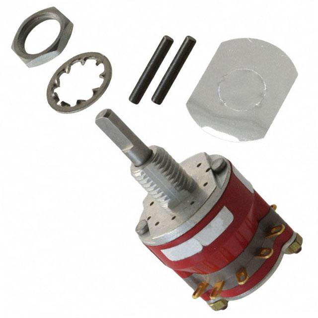

Multi-Deck Rotary Switches SERIES 71 .5-.75" Diameter, 1/4 Amp Features • Performance and Value Leader • Molded-In Position Terminals • Choice of Shaft/Bushing Diameters • 30° and 36° Angles of Throw • Military Qualified MIL-DTL-3786/39 in inches (and millimeters) Rear Views–Style A, B, MA, MB (and sealed versions) 0.125" Diameter Shaft–Styles A and MA (and sealed versions) SEE DETAIL .500 ± .015 (12,7 ± 0,38) DIA. SEE CHART 1 12 1 1 2 SEE NOTE 0.250" Diameter Shaft–Styles B and MB (and sealed versions) .375 ± .020 (9,53 ± 0,51) .750 ± .020 (19,05 ± 0,51) OVER TERMINALS 36° Angle of Throw .312 ± .020 (7,92 ± 0,51) .687 ± .015 (17,45 ± 0,38) DIA. .219 ± .004 (5,56 ± 0,10) SEE DETAIL .500 ± .015 (12,7 ± 0,38) DIA. All dimensions not shown are the same as above. .250 ± .020 (6,35 ± 0,51) 9 10 1 2 BUSHING KEyWAy .066 ± .002 (1,68 ± 0,05) WIDE By .036 ± .003 (0,91 ± 0,08) DEEP FROM A .375 (9,53) DIA. SEE NOTE 3/8-32UNEF-2A THREAD No. of Decks 1 2 3 4 5 6 Dimension A Dimension B .761 (19,33) .979 (24,87) 1.197 (30,40) 1.415 (35,94) 1.633 (41,48) 2.131 (54,13) .031 (0,79) .031 (0,79) .031 (0,79) .031 (0,79) .031 (0,79) .312 (7,92) Approx. Weight No. of Dimension Dimension Grams Decks A B 14 16 18 20 22 24 7 8 9 10 11 12 2.349 (59,66) 2.567 (65,20) 2.785 (70,74) 3.003 (76,28) 3.221 (81,81) 3.439 (87,35) .312 (7,92) .312 (7,92) .312 (7,92) .312 (7,92) .312 (7,92) .312 (7,92) Angle C is 15° in 12 position switches and 36 ° in 10 position switches. Approx. Weight Grams 26 28 30 32 34 36 4 CL OF POSITION NO. 1 CL OF BUSHING KEyWAy 7 5 C GRAyHILL 8 6 SEE CHART .250 + .001 –.002 DIA. (6,36 + 0,25 –0,05) 6 1/4 32UNEF-2A THREAD CL OF POSITION NO. 1 CL OF BUSHING FLATS 9 7 Rotary Switches .125 + .001 –.002 DIA. (3,18 + 0,25 –0,05) .203 ± .005 (5,16 ± 0,13) 10 8 C .562 ± .015 (14,27 ± 0,38) GRAyHILL .250 ± .020 (6,35 ± 0,51) 30° Angle of Throw DIM. B REF. STUD PROJECTION (SEE CHARACTERISTICS) 3 .375 ± .020 (9,53 ± 0,51) .094 ± .010 (2,39 ± 0,25) 30° and 36° Angle of Throw may be interposed on either shaft diameter. DIM. A ± .046 (1,17) 3 .312 ± .020 (7,92 ± 0,51) 4 .687 ± .015 (17,45 ± 0,38) DIA. 5 DIMENSIONS: Standard and Military .750 ± .020 (19,05 ± 0,51) OVER TERMINALS Note: Common location for a single pole per deck switch. For common location on multipole switches see circuit diagrams. Terminal Detail .034 ± .003 (0,86 ± 0,08) .068 ± .005 (1,73 ± 0,13) Grayhill part number and date code marked on detent cover label. Customer part number marked on request. Military part number marked when required. Grayhill, Inc. • 561 Hillgrove Avenue • LaGrange, Illinois 60525-5997 • USA • Phone: 708-354-1040 • Fax: 708-354-2820 • www.grayhill.com Multi-Deck Rotary Switches All dimensions are in millimeters 4mm Diameter Shaft–Style E and ES Rear Views 30° Angle of Throw DIM. A ± 1,2 SEE DETAIL DIM. B REF. STUD PROJECTION (SEE CHARACTERISTICS) 2 6 C 9 7 14,27 ± 0,4 10 8 SEE CHART 1 12 1 1 Ø 12,70 ± 0,4 GRAyHILL 8,00 ± 0,3 3 Ø 17,45 ± 0,4 4 25,00 ± 0,5 5 DIMENSIONS: Metric Ø 4,00 ± 0,03 6,00 + 0,00 –0,08 SEE NOTE 19,05 ± 0,5 OVER TERMINALS M7,0 X 0,75 THREAD CL OF POSITION NO. 1 CL OF BUSHING FLATS 36° Angle of Throw Dim. A Dim. B Approx. Weight Grams 19,33 24,87 30,40 35,94 41,48 54,13 59,66 65,20 70,74 76,28 81,81 87,35 0,79 0,79 0,79 0,79 0,79 7,92 7,92 7,92 7,92 7,92 7,92 7,92 12 14 16 18 20 22 24 26 28 30 32 34 SEE DETAIL Ø 12,70 ± 0,4 Terminal Detail 7 9 10 1 GRAyHILL 2 SEE NOTE 4 .068 ± .005 (1,73 ± 0,13) 5 .034 ± .003 (0,86 ± 0,08) 3 8 6 No. of Decks 1 2 3 4 5 6 7 8 9 10 11 12 19,05 ± 0,5 OVER TERMINALS Grayhill part number and date code marked on detent cover label. Customer part number marked on request. CIRCUIT DIAGRAMS: Standard, Military and Metric Switch is Viewed From Shaft End and Shown in Position No. 1. Note: All common terminals are located above base terminals as shown. 8 30° Angle of Throw 9 10 11 C L OF BUSHING KEyWAy 10 C1 1 6 5 4 3 6 5 2 4 3 8 11 C2 7 12 7 9 8 12 7 C L 1 C1 6 2 C3 9 10 12 C L 1 C1 5 C2 4 C3 C4 10 11 7 C L 1 C1 4 3 2 C2 ONE POLE TWO POLE 7 8 6 36° Angle of Throw 5 THREE POLE C L OF BUSHING KEyWAy 9 10 1 4 3 2 ONE POLE Grayhill, Inc. • 561 Hillgrove Avenue • LaGrange, Illinois C1 C2 7 6 8 12 6 5 2 3 9 8 11 FOUR POLE C4 C5 9 10 7 6 C3 5 4 3 C2 9 10 C L 4 1 3 2 1 2 FIVE OR SIX POLE 8 5 C6 11 12 C1 TWO POLE 60525-5997 • USA • Phone: 708-354-1040 • Fax: 708-354-2820 • www.grayhill.com C L C1 Rotary Switches Note: Common location for a single pole per deck switch. For common location on multipole switches see circuit diagrams. Angle C is 15° in 12 position switches and 36° in 10 position switches. Multi-Deck Rotary Switches SERIES 71 .5-.75" Diameter, 1/4 Amp, PC Mount Features • Terminals From One Side • Minimum Board Footprint • Choice of Shaft/Bushing Diameters • 30° and 36° Angles of Throw • Military Qualified MIL-DTL-3786/39 in inches (and millimeters) Rear Views: Styles AF, BF, MAF, MBF (and sealed versions) 0.125" Diameter Shaft: Styles AF and MAF (and sealed versions) .500 ± .015 (12,7 ± 0,38) DIA. DIM. B REF. STUD PROJECTION (SEE CHARACTERISTICS) .375 ± .020 (9,53 ± 0,51) .250 ± .020 (6,35 ± 0,51) .094 ± .010 (2,39 ± 0,25) 4 .156 ± .010 (3,96 ± 0,25) TyP. 1 12 10 9 .562 ± .015 (14,27 ± 0,38) CL 3 2 11 C OF L BUSHING FLATS 30° Angle of Throw DIM. A ± .046 (1,17) GRAyHILL C .312 ± .020 (7,92 ± 0,51) 5 SEE CHART SHAFT SHOWN IN POSITION ONE 6 .687 ± .015 (17,45 ± 0,38) DIA. 30° and 36° Angle of Throw may be interposed on either shaft diameter. 7 .875 (30°) .725 (36°) ± .015 (22,23, 18,42 ± 0,38) Military Qualified style MAF includes a spacer deck between decks 2 and 3. See dimension chart. .368 (9,35) REF. 8 DIMENSIONS: Standard and Military .125 – .002 + .001 (3,18 – 0,05 + 0,03) DIA. 1/4-32 UNEF-2A THREAD Rotary Switches .015 ± .002 (0,38 ± 0,05) TERMINAL NO. 1 .203 ± .005 (5,16 ± 0,13) .020 ± .003 (0,51 ± 0,08) TyP. .412 ± .010 (10,46 ± 0,25) TyP. SEE NOTE BELOW .125 ± .010 (3,18 ± 0,25) TyP. .037 ± .005 (0,94 ± 0,13) TyP. SEE NOTE CL CL .110 ± .010 (2,79 ± 0,25) TyP. .075 ± .005 (1,91 ± 0,13) TyP. CL CL CL 0.250" Diameter Shaft: Styles BF and MBF (and sealed versions) 1 .156 ± .010 (3,96 ± 0,25) TyP. .250 – .002 + .001 (6,35 – 0,05 + 0,03) DIA. 3/8 32UNEF-2A THREAD Dimension A Standard Style Dimension A Military Style Dimension B All Styles .761 (19,33) .979 (24,87) 1.197 (30,40) 1.415 (35,94) 1.633 (41,48) 2.131 (54,13) .761 (19,33) .979 (24,87) 1.415 (35,94) 1.633 (41,49) N.A. N.A. .031 (0,79) .031 (0,79) .031 (0,79) .031 (0,79) .031 (0,79) .312 (7,92) 10 7 8 9 10 11 12 Angle C is 15° in 12 position switches and 18° in 10 position switches. *Military style switch is 18 grams for 3 decks and 20 grams for 4 decks. Dimension A Dimension B Standard Standard Style Style 2.349 (59,66) 2.567 (65,20) 2.785 (70,74) 3.003 (76,28) 3.221 (81,81) 3.439 (87,35) .312 (7,92) .312 (7,92) .312 (7,92) .312 (7,92) .312 (7,92) .312 (7,92) Approx. Weight Grams 24 26 28 30 32 34 .075 ± .005 (1,91 ± 0,13) TyP. .368 (9,35) REF. .125 ± .010 (3,18 ± 0,25) TyP. SEE NOTE Approx. Weight No. of Grams Decks 12 14 16* 18* 20 22 3 2 7 No. of Decks 1 2 3 4 5 6 .250 ± .020 (6,35 ± 0,51) 8 .219 ± .004 (5,56 ± 0,10) BUSHING KEyWAy .066 ± .002 (1,68 ± 0,05) WIDE By .036 ± .003 (0,91 ± 0,08) DEEP FROM A .375 (9,53) DIA. 9 C OF L BUSHING KEyWAy .500 ± .015 (12,7 ± 0,38) DIA. 4 C All dimensions not shown are the same as above. .312 ± .020 SHAFT (7,92 ± 0,51) SHOWN IN POSITION .375 ± .020 ONE (9,53 ± 0,51) GRAyHILL SEE CHART 36° Angle of Throw 5 .687 ± .015 (17,45 ± 0,38) DIA. Military Qualified style MBF includes a spacer deck between decks 2 and 3. See dimension chart. 6 .875 (30°) .725 (36°) ± .015 (22,23, 18,42 ± 0,38) .037 ± .005 (0,94 ± 0,13) TyP. CC L L Note: Common location for a single pole per deck switch. For common location on two pole switches see circuit diagrams. Grayhill part number and date code marked on detent cover label. Customer part number marked on request. Military part marked required. Seenumber pages F-39when through F-44 for specifications, accessories and ordering information. Grayhill, Inc. • 561 Hillgrove Avenue • LaGrange, Illinois 60525-5997 • USA • Phone: 708-354-1040 • Fax: 708-354-2820 • www.grayhill.com Multi-Deck Rotary Switches DIMENSIONS: Metric All dimensions are in millimeters 4mm Diameter Shaft: Style EF and ESF Rear Views 30° and 36° Angle of Throw may be interposed on either shaft diameter. 30° Angle of Throw 3 4 5 3,96 ± 0,25 TyP. GRAyHILL C OF L BUSHING FLATS 1 12 2 7 8,00 – 0,3 10 9 DIM. B REF. STUD PROJECTION (SEE CHARACTERISTICS) 11 17,45 – 0,4 Ø 12,7 ± 0,38 DIM. A – 1,17 9,35 REF. 8 25,00 – 0,51 22,23 – 0,4 6 14,27 – 0,38 4,00 – 0,03 SEE NOTE M7 X 0,75 THREAD .0,38 – 0,03 TyP. CL CL SEE NOTE BELOW CL 2,79 – 0,25 TyP. C L 10,46 – 0,25 36° Angle of Throw CL 59,66 65,20 70,74 76,28 81,81 87,35 7,92 7,92 7,92 7,92 7,92 7,92 3 7 8 9 10 11 12 24 26 28 30 32 34 4 12 14 16 18 20 22 3,96 ± 0,25 TyP. SEE NOTE Note: Common location for a single pole per deck switch. For common location on two pole switches see circuit diagrams. CL Grayhill part number and date code marked on detent cover label. Customer part number marked on request. 10 1 2 5 0,79 0,79 0,79 0,79 0,79 7,92 18,42 ± 0,04 Approx. Weight Grams 9,35 REF. 3,18 ± 0,25 TyP. 0,94 ± 0,13 TyP. 1,91 ± 0,13 TyP. CL CL 7,62 ± 0,25 CL CIRCUIT DIAGRAMS: Standard, Military and Metric PC Mount Circuit is Viewed From Shaft End and Shown in Position No. 1 CL OF BUSHING KEyWAy OR FLATS ONE POLE 30° Angle of Throw 36° Angle of Throw 12 11 10 9 8 7 6 5 4 3 2 1 C1 CL OF BUSHING KEyWAy OR FLATS ONE POLE 10 9 8 7 6 5 4 3 2 1 C1 TWO POLE TWO POLE CL 12 11 10 9 8 7 6 5 4 3 2 1 C2 C1 Grayhill, Inc. • 561 Hillgrove Avenue • LaGrange, Illinois CL 10 9 8 7 6 5 4 3 2 1 C2 C1 60525-5997 • USA • Phone: 708-354-1040 • Fax: 708-354-2820 • www.grayhill.com Rotary Switches 19,33 24,87 30,40 35,94 41,48 54,13 Approx. Weight No. of Dim. Dim. Grams Decks A B 7 Dim. B 8 Dim. A 9 No. of Decks 1 2 3 4 5 6 Ø 12,7 ± 0,38 GRAyHILL 0,51 – 0,08 TyP. 7,62 ± 0,25 CL CL 6 TERMINAL NO. 1 6,00 + 0,00 0,08 3,18 ± 0,25 TyP. 0,94 ± 0,13 TyP. 1,91 ± 0,13 TyP. Multi-Deck Rotary Switches SERIES 71: PC Board Pattern in inches (and millimeters) All Styles Except 71BT 30° Angle of Throw 36° Angle of Throw COMMON TERMINAL HOLE LOCATION (SEE CHART) COMMON TERMINAL HOLE LOCATION (SEE CHART) B .300 (7,62) TyP. .037 (0,94) .075 (1,91) TyP. A B .300 (7,62) TyP. .037 (0,94) .075 (1,91) TyP. A .110 (2,79 )TyP. .110 TyP. (2,79 ) SHAFT END OF SWITCH .110 (2,79 )TyP. CL OF COMMON FOR DECK ONE Spacer decks can be supplied to facilitate PC board layouts of three or more decks. A spacer deck does not have any terminals and provides no switching function. Dimensionally, it requires the same space as one normal switch deck. Spacer deck can be placed at any location in the switch, per your instructions. Switches which include spacer decks are procured under a special part number. .110 TyP. (2,79 ) SHAFT END OF SWITCH Shown for a two deck switch. Bushing mount is recommended. Number of Poles Per Deck Common Terminal Hole Location 1 2 A A and B series 71: PC Mount Accessory Rotary Switches 1 Metric Mount Styles in inches (and millimeters) /8" and 1/4" Diameter Shaft Styles in millimeters DIMENSIONS APPLy TO BOTH WASHERS. WASHER IS .032 (0,81) THICK .255 ±.002 (6,48 ± 0,05) DIA. .375 ± .002 (9,53 ± 0,05) C L 0.368 ± .003 (9,35 ± 0,08) .687 (17,45) DIA. Ø 17.45 ±0.08 C L 9.35 ±0.08 THICKNESS 0.81 ±0.05 0.030 ±.001 (0,76 ± 0,03) .207 ±.005 (5,26 ± 0,13) FOR USE WITH STyLE AF PARt 71C2054 .130 ±.003 (3,30 ± 0,08) .500 ±.002 (12,7 ± 0,05) FOR USE WITH STyLE BF PARt 71C2053 0.76 ±0.03 12.7 ±0.05 FOR USE WITH STyLE EF PARt 71C2111 For printed circuit styles. Mounting bushing provides additional support for the front end of the switch. Order separately by appropriate part number. Rotary switch discount applies. Grayhill, Inc. • 561 Hillgrove Avenue • LaGrange, Illinois 60525-5997 • USA • Phone: 708-354-1040 • Fax: 708-354-2820 • www.grayhill.com Multi-Deck Rotary Switches SERIES 71 .5-.75" Diameter, 1/4 Amp, Process Sealed Features • No Hand Soldering Required • Sealed to Resist Intrusion by Flux, Solder and Cleaning Solutions • .75" Diameter • 250 mA for 20,000 Cycles • 36°, 1 or 2 Poles, Up to 5 Decks • 10 Positions, Continuous Rotation, or 2-9 Positions With Fixed Stops DIMENSIONS: Standard and Military Style BT in inches (and millimeters) .725 ± .015 (18,42 ± 0,38) Ø .687 ± .015 (17,45 ± 0,38) .310 ± .010 (7,87 ± 0,25) 18° Rear View .275 ± .020 (6,99 ± 0,51) DIM. A ± .046(1,17) .375 ± .020 (9,53 ± 0,51) DIM. B REF. .250 ± .020 (6,35 ± 0,51) .562 ± .015 (14,27 ± 0,38) .250 + .001 –.002 DIA. (6,36 + 0,25 –0,05) .219 ± .004 (5,56 ± 0,10) .100 ± .010 (2,5 ± 0,25) 2 PLS. .428 ± .008 (10,87 ± 0,20) 3/8-32 UNEF-2A THREAD .020 ± .003 (0,51 ± 0,08) TyP. COMMON TERMINAL .110 ± .010 (2,79 ± 0,25) TyP. TERMINAL NO. 1 .015 ± .002 (0,38 ± 0,05) .015 ± .002 (0,38 ± 0,05) TyP. CL CL CL CL Shaft flat is opposite point of contact for pole number one. Shaft is shown here in position 1. Grayhill part number and date code marked on detent cover label. Customer part number marked on request. No. of Decks 1 2 3 4 5 .368 ± .005 (9,35 ± 0,13) .125 ± .010 (3,18 ± 0,25) .156 ± .010 (3,96 ± 0,25) CL .449 ± .008 (11,4 ± 0,20) .037 ± .005 (0,94 ± 0,13) .075 ± .005 (1,91 ± 0,13) TyP. Dimension A Dimension B 0.795 (20,19) 1.040 (26,42) 1.285 (32,64) 1.530 (38,86) 1.775 (45,09) 0.031 (0,79) 0.053 (1,35) 0.076 (1,93) 0.098 (2,49) 0.120 (3,05) Style 71BT: PC Board Pattern CIRCUIT DIAGRAMS Including Integral Front Plate Standoffs Circuit is Viewed From Shaft End and Shown in Position No. 1 36° Angle of Throw 10 9 8 7 6 5 4 3 2 1 C1 TWO POLE CL .029 (0,74) Ø MIN. HOLE 33 PLS. .440 (11,18) .220 (5,59) .036 (0,91) Ø MIN. HOLE 2 PLS. SHAFT END OF SWITCH CL OF BUSHING KEyWAy OR FLATS ONE POLE 10 9 8 7 6 5 4 3 2 1 C2 10 C1 Grayhill, Inc. • 561 Hillgrove Avenue • LaGrange, Illinois .250 (6,35) .500 (12,7) .075 (1,91) 9 PLS. .0375 (0,95) C L OF SWITCH POLE NO. 1 .300 (7,62) .110 (2,79) 5 PLS. .428 (10,87) C OF L STANDOFFS CL OF COMMON TERMINAL 60525-5997 • USA • Phone: 708-354-1040 • Fax: 708-354-2820 • www.grayhill.com Rotary Switches .030 ± .002 (0,76 ± 0,05) TyP. 1 Multi-Deck Rotary Switches SERIES 71 0.5 to 0.75" Diameter, 1/4 Amp, Concentric Shaft Features • Two Switches in the Panel Space of a Single Shaft Rotary in inches (and millimeters) Solder Lug Terminals: Style C .312 ± .020 (7,92 ± 0,51) 30° and 36° Angle of Throw may be interposed on either shaft diameter. DIM. B REF. STUD PROJECTION .375 ± .020 (9,53 ± 0,05) 30° Angle of Throw .500 ± .015 (12,7 ± 0,38) DIA. CL OF POSITION NO. 1 CL OF BUSHING KEyWAy 10 24 26 28 26 28 30 28 30 32 1 .032 (0,81) .032 (0,81) .312 (7,92) .032 (0,81) .312 (7,92) .312 (7,92) .312 (7,92) .312 (7,92) .312 (7,92) 7 8 .034 ± .003 (0,86 ± 0,08) SEE NOTE .068 ± .005 (1,73 ± 0,13) 4 1.415 (35,94) 1.633 (41,49) 2.131 (54,13) 1.633 (41,49) 2.131 (54,13) 2.349 (59,66) 2.131 (54,13) 2.349 (59,66) 2.567 (65,20) SEE DETAIL Terminal Detail 5 Dimension B .500 ± .015 (12,7 ± 0,38) DIA. 6 Rotary Switches Dimension A Approx. Weight Grams 36° Angle of Throw 2 No. of Decks 1 12 1 1 2 BUSHING KEyWAy .066 ± .002 (1,68 ± 0,05) WIDE By .036 ± .003 (0,91 ± 0,08) DEEP FROM A .375 (9,53) DIA. CONTROLLED CONTROLLED By .250 (6,35) By .125 (3,18) DIA. SHAFT DIA. SHAFT .750 ± .020 (19,05 ± 0,51) OVER TERMINALS 9 3/8-32UNEF-2A THREAD SEE NOTE GRAyHILL .219 ± .004 (5,56 ± 0,10) SECTION SECTION B A 6 .094 ± .010 (2,39 ± 0,25) 9 7 .250 + .001 –.002 (6,35 + 0,03 –0,05) DIA. .125 + .001 –.002 DIA. (3,18 + 0,25 –0,05) 10 8 C Sec. A Sec. B 1 1 2 1 3 1 1 2 2 2 3 2 1 3 2 3 3 3 SEE DETAIL .562 ± .015 (14,27 ± 0,38) 3 SEE CHART GRAyHILL .250 ± .020 (6,35 ± 0,05) 3 C L Rear Views DIM. A ± .046 (1,17) 4 .687 ± .015 (17,45 ± 0,38) DIA. 5 DIMENSIONS .750 ± .020 (19,05 ± 0,51) OVER TERMINALS Note: Common location for a single pole per deck switch. For common location on multipole switches see circuit diagrams. Angle C is 15° in 12 position switches and 36 ° in 10 position switches. Grayhill part number and date code marked on detent cover label. Customer part number marked on request. CIRCUIT DIAGRAMS: Solder Lug Terminals Switch is Viewed From Shaft End and Shown in Position No. 1. Note: All common terminals are located above base terminals as shown. 8 30° Angle of Throw 9 C L OF BUSHING 10 11 KEyWAy 9 10 C1 1 6 5 4 3 6 5 2 ONE POLE 7 C L 1 C1 6 7 8 5 1 4 3 C3 C L 1 C1 5 3 4 C1 C2 7 6 9 8 11 12 7 8 12 C L 1 C1 6 5 2 C4 10 11 4 3 2 C2 FOUR POLE C4 C5 9 10 7 6 C3 C6 11 12 1 2 5 C L C1 3 C2 FIVE OR SIX POLE 4 8 9 10 C L 5 4 1 3 2 ONE POLE 10 THREE POLE C L OF BUSHING KEyWAy 9 10 C3 9 C2 TWO POLE 6 36° Angle of Throw 12 2 3 4 8 11 C2 7 12 7 8 2 C1 TWO POLE ADD-A-POT SWiTCHES Contact Grayhill for Series 71 Concentric Add-A-Pot or Add-A-Switch type switches. Grayhill, Inc. • 561 Hillgrove Avenue • LaGrange, Illinois 60525-5997 • USA • Phone: 708-354-1040 • Fax: 708-354-2820 • www.grayhill.com Multi-Deck Rotary Switches DIMENSIONS in inches (and millimeters) Rear Views PC Mount: Style CF 30° and 36° Angle of Throw may be interposed on either shaft diameter. DIM. B REF. STUD PROJECTION .500 ± .015 (12,7 ± 0,38) DIA. 3 SEE NOTE BELOW 4 5 .075 ± .005 (1,91 ± 0,13) TyP. CL .110 ± .010 (2,79 ± 0,25) TyP. CL 36° Angle of Throw .656 (16,66) .412 ± .010 (10,46 ± 0,25) TyP. CL COMMON DECK 1 SECTION A CL CL .500 ± .015 (12,7 ± 0,38) DIA. CL COMMON DECK 1 SECTION B 24 26 28 26 28 30 28 30 32 3 4 5 .032 (0,81) .032 (0,81) .312 (7,92) .032 (0,81) .312 (7,92) .312 (7,92) .312 (7,92) .312 (7,92) .312 (7,92) .368 (9,35) REF. .125 ± .010 (3,18 ± 0,25) TyP. SEE NOTE .075 ± .005 (1,91 ± 0,13) TyP. .037 ± .005 (0,94 ± 0,13) TyP. CL CL Note: Common location for a Single Pole Per Deck Switch. For common location on multipole switches see circuit diagrams. Grayhill part number and date code marked on detent cover label. Customer part number marked on request. CIRCUIT DIAGRAMS: PC Mount Terminals Switch is Viewed From Shaft End and Shown in Position No. 1. Note: All common terminals are located above base terminals as shown. 36° Angle of Throw 30° Angle of Throw CL OF BUSHING KEyWAy OR FLATS 12 11 10 9 8 7 6 5 4 3 2 1 C1 CL 12 11 10 9 8 7 6 5 4 3 2 1 C1 C2 ONE POLE Grayhill, Inc. • 561 Hillgrove Avenue • LaGrange, Illinois TWO POLE CL OF BUSHING KEyWAy OR FLATS 10 9 8 7 6 5 4 3 2 1 C1 ONE POLE CL 10 9 8 7 6 5 4 3 2 1 C1 C2 TWO POLE 60525-5997 • USA • Phone: 708-354-1040 • Fax: 708-354-2820 • www.grayhill.com Rotary Switches Dimension B 1.415 (35,94) 1.633 (41,49) 2.131 (54,13) 1.633 (41,49) 2.131 (54,13) 2.349 (59,66) 2.131 (54,13) 2.349 (59,66) 2.567 (65,20) 7 Dimension A .156 ± .010 (3,96 ± 0,25) TyP. 8 Sec. A Sec. B 1 1 2 1 3 1 1 2 2 2 3 2 1 3 2 3 3 3 Approx. Weight Grams 9 No. of Decks 10 GRAyHILL 1 2 6 .015 ± .002 (0,38 ± 0,05) .368 (9,35) REF. .125 ± .010 (3,18 ± 0,25) TyP. .037 ± .005 (0,94 ± 0,13) TyP. SEE NOTE 3/8-32 UNEF-2A THREAD For additional dimensions and references for shafts, flat orientation and bushing keyway, see drawings for styles 71AF and 71BF. 6 .250 + .001 –.002 (6,35 + 0,03 –0,05) DIA. SEE SOLDER LUG VERSION FOR SHAFT FLATS AND DIMENSIONS .156 ± .010 (3,96 ± 0,25) TyP. .562 ± .015 (14,27 ± 0,38) 1 12 10 9 POSITION NO. 1 2 11 .125 + .001 –.002 DIA. (3,18 + 0,25 –0,05) SECTION B SECTION A .250 ± .020 (6,35 ± 0,05) GRAyHILL .375 ± .020 (9,53 ± 0,05) 7 .687 ± .015 (17,45 ± 0,38) DIA. .020 ± .003 (0,51 ± 0,08) TyP. 30° Angle of Throw DIM. A .312 ± .020 (7,92 ± 0,51) 8 .875 (30°) .725 (36°) ± .015 (22,23, 18,42 ± 0,38) Multi-Deck Rotary Switches SPECIFICATIONS Military Qualification MIL-DTL3786/39 The military style of the Series 71 rotary switch is qualified to MIL-DTL-3786/39. Complete electrical rating information is listed on the following page. The Series 71 rotary switch qualification includes the 30° and the 36° angles of throw, in .125" (3,18) and .250" (6,35) diameter shafts, with solder lug terminals and printed circuit terminals, in sealed and unsealed style switches. Standard variations such as shaft and/or bushing length, etc. that do not affect the switch performance can also be marked as qualified product. Contact Grayhill for complete details. Dimensionally the military style is the same as the standard style with the exception of the PC version of 3 or 4 decks; a spacer deck will be marked to the specification. between decks 2 and 3 adds another deck length to the switch without increasing the number of operative decks. Another difference in the standard and military styles is the mounting hardware. Ordered as options with a standard style switch these items are included with the military style switch: nonturn washer with solder lug style and a non-turn washer plus a mounting bushing washer with the PC terminal style. Complete specification drawings are available from Grayhill, Inc. for the standard military qualified products. Military qualified Series 71 rotary switches may be ordered by the “M” number listed in Military Specification Sheet/39 or by Grayhill part number. All qualified switches Military Shaft and Panel Seal A shaft and panel seal is available to provide watertight mounting of the Series 71 standard military style rotary switches. Sealing is accomplished by an O-ring shaft seal and a panel seal washer. Panel seal dimension differences are shown in the dimensional drawings. When the panel seal is compressed, dimensions are approximately the same as an unsealed switch. If the non-turn washer supplied with the switch is used, it should not be allowed to extend entirely through the panel when mounting a sealed switch. However, the bushing may be used as a non-turn device instead. Switches are provided with a double flat bushing in styles which include the letter A and with a bushing which has a keyway in the styles which include the letter B. SPECIFICATIONS: Materials and Finishes Materials and Finishes Standard Style Rotary Switches Cover: Diallyl per (MIL-M-14) ASTM-D-5948 except for 71 BT (see bushing). Base and Deck Separator: Diallyl per (MILM-14) ASTM-D-5948 Rotor Mounting Plate: Thermoplastic Bushing: Zinc casting, tin/zinc-plated. Through Bolts and Nuts, Shaft and Rear Support Plate, Stop Pins and Stop Arm (All Others): Stainless steel Shaft, Stop Plates, Stop Arm (71BT): Reinforced thermoplastic Detent Rotor: Reinforced thermoplastic for 71BT; phenolic per (MIL-M-14) ASTM-D5948 for all others Detent Balls: Steel, nickel-plated Detent Springs: Tinned music wire Rotor Contact: Silver alloy and beryllium copper Base Contacts, Common Plate and Terminals: Brass, Gold plate .000005" minimum over Silver plate .00005" over nickel .00002". Front Support Plate (71 BT only): Tempered steel, tin/lead-plated. Interdeck Seal (71 BT Only): Silicone Extension: Brass, unplated Mounting Hardware: One mounting nut and one internal tooth lockwasher are supplied with each switch. For switches with A in the style description, the nut is .062" (1,57) thick by .312" (7,92) across flats. For switches with B or C in the style description, the nut is .094" (2,39) thick by .562" (14,27) across flats. Nuts are brass, tin/ zinc-plated or stainless steel. Materials and Finishes Military Qualified Cover, Base and Deck Separator: Diallyl per (MIL-M-14) ASTM-D-5948 Rotor Mounting Plate: Thermoplastic Bushing: Zinc casting, tin/zinc-plated Through Bolts and Nuts, Shaft Extension, Lockwashers, Shaft and Rear Support Plate, Stop Pins and Stop Arm (All Others): Stainless steel Detent Balls: Steel, nickel-plated Detent Springs: Tinned music wire Rotor Contact: Silver alloy and beryllium copper Base Contacts, Common Plate and Terminals: Brass, gold plate .000005" minimum over silver plate .00005" over Nickel .00002". Grayhill, Inc. • 561 Hillgrove Avenue • LaGrange, Illinois Detent Rotor: Phenolic per (MIL-M-14) ASTM-D-5948 Mounting Hardware: One mounting nut and one internal tooth lockwasher are supplied with each Series 71 switch. For switches with Style A in the description, the nut is .062" (1,57) thick by .312" (7,92) across flats. For switches with Style B or C in the description, the nut is .094" (2,39) thick by .562" (14,27) across flats. Nuts are brass, tin/zinc-plated or stainless steel. Additional Hardware: Each switch is supplied with a non-turn washer to use if desired. Additionally, each PC mount switch is supplied with a mounting bushing washer (see PC Mount Accessory). For switches with Style A in the description, non-turn washer is stainless steel; for switches with Style B in the description, non-turn washer is stainless steel. Mounting bushing washer (PC Mount Accessory) is brass, tin/zinc-plated. 60525-5997 • USA • Phone: 708-354-1040 • Fax: 708-354-2820 • www.grayhill.com Multi-Deck Rotary Switches SPECIFICATIONS: Electrical Ratings, Others Electrical Ratings General CURRENT CURRENT CURRENT CURRENT MILLIAMPS MILLIAMPS MILLIAMPS MILLIAMPS CURRENT CURRENT MILLIAMPS MILLIAMPS 600 VOLTAGE 115 VAC 10 OR 30 VDC 25 50 500 StANDARD Standard 400 CyCLES x 1000 RESISTIVE 300 600 VOLTAGE 115 VAC 200 VOLTAGE 30 VDC 500 OR 30 VDC 100 INDUCTIVE 400 RESISTIVE 250 (250 MILLIHENRIES) 300 10 25 50 200 200 VOLTAGE 30 VDC 150 CyCLES x 1000 100 INDUCTIVE 100 250 (250 MILLIHENRIES) 50 10 25 50 200 150 10CyCLES x 1000 25 50 100 CyCLES x 1000 50 VOLTAGE 30 VDC INDUCTIVE 50 10 25 250 (250 MILLIHENRIES) CyCLES x 1000 200 VOLTAGE 30 VDC 150 INDUCTIVE 100 250 (250 MILLIHENRIES) 50 200 MILItARy 150 10 25 50 100 CyCLES x 1000 VOLTAGE 115 VAC 50 800 MILItARy OR 30 VDC 700 RESISTIVE 10Military 25 50 600 500 CyCLES x 1000 VOLTAGE 115 VAC 400 800 300 OR 30 VDC 700 200 RESISTIVE 600 100 500 MILItARy 400 10 25 50 300 CyCLES x 1000 200 100 VOLTAGE 115 VAC 800 MILItARy 10 OR 30 VDC 25 50 700 RESISTIVE 600 CyCLES x 1000 500 VOLTAGE 115 VAC 400 800 300 OR 30 VDC VOLTAGE 30 VDC 700 200 RESISTIVE INDUCTIVE 600 100 250 500 (250 MILLIHENRIES) 400 200 10 25 50 300 VOLTAGE 30 VDC 150 CyCLES x 1000 200 INDUCTIVE 100 100 250 (250 MILLIHENRIES) 50 200 10 25 50 150 10 CyCLES x 1000 25 50 100 CyCLES x 1000 50 VOLTAGE 30 VDC INDUCTIVE 10 (250 MILLIHENRIES) 25 50 250 CyCLES x 1000 200 VOLTAGE 30 VDC 150 INDUCTIVE 100 250 (250 MILLIHENRIES) 50 200 150 10 25 50 100 CyCLES x 1000 50 10 25 CyCLES x 1000 Curves are based on the following failure criteria: Contact Resistance: 50 milliohms maximum (20 milliohms initially). Insulation Resistance: 1,000 megohms minimum between terminals and shaft. (50,000 megohms initially). Voltage Breakdown: 500 Vac minimum between mutually insulated parts. Current Rating: These switches will carry 4 amperes with a maximum contact temperature rise of 20°C. If the life limiting characteristics are less critical than those shown above, if elevated temperatures or reduced pressures are involved, Grayhill can predict the switch life for the application. Meet the Following Requirements of MILDTL-3786: Moisture Resistance: Medium and High Shock; Vibration (10 to 2,000 cps); Thermal Shock (-65°C to 85°C); Salt Spray, Explosion; and Stop Strength (10 in-lb). Electrical Ratings Military Style Curves are based on the following failure criteria: Qualified to the following MIL-DTL-3786/39 circuit values: (also see standard style description.) The Series 71 has been tested to meet the requirements of MIL-DTL-3786, Style SR39, the majority of which are listed here. At 85°C approximately 68% relative humidity and sea level pressure, the switches have been tested to make and break the following loads, as stated in MIL-DTL-3786/39: 125 milliamperes at 28 Vdc resistive; 75 milliamperes at 115 Vac resistive. The switches have also been tested at reduced barometric pressure (70,000 feet), 25°C at approximately 68% relative humidity to make and break the following loads as stated in MIL-DTL3786/39: 50 milliamperes, 28 Vdc resistive; 20 milliamperes, 115 Vac resistive. When tested to the above loads at stated conditions, the Series 71 switches meet the following life-limiting criteria after 25,000 cycles of operation in accordance with MIL-DTL-3786/39. Contact Resistance: 50 milliohms maximum after life. Insulation Resistance: 1,000 megohms minimum between terminals and shaft. Dielectric Strength: 500 Vac (atmospheric pressure) and 350 Vac (reduced pressure) between mutually insulated parts. The Series 71 also meets the requirements of MIL-DTL-3786/39 for moisture resistance, stop strength, rotational torque, vibration (10 through 2,000 cps), medium and high shock, salt spray, explosion, thermal shock (-65°C to 85°C) and terminal pull. When tested at sea level, 25°C and 68% relative humidity with failure criteria of 50 milliohms maximum contact resistance and 500 Vac breakdown voltage, these switches will make and break 250 milliamps at 28 Vdc inductive (250 millihenries) 500 milliamps at 28 Vdc resistive: 500 milliamps at 115 volts Vac, 60 hertz resistive, for 10,000 cycles of operation. Additional Characteristics Standard and Military Styles Rotational Torque: 4-32 ounce-inches, (28230 N•mm) depending on the number of poles per deck and the number of decks. Contacts: Shorting or non-shorting wiping contacts with over 100 grams of contact force. Shaft Flat Orientation: Opposite first position pole no. 1 (See Circuit Diagrams). Terminals: Switches are provided with full circle of terminals regardless of the number of active positions. Extended Studs: Switches of 6 or more decks (or concentric switches of 4 or more) have longer studs and extra stud nuts for recommended double end mounting. Stud hole size is 1/16" diameter for #0-80 NF-2A thread. Stop Strength: 10 pound-inches. Mounting Bushing Strength: 10 poundinches. 50 Grayhill, Inc. • 561 Hillgrove Avenue • LaGrange, Illinois 60525-5997 • USA • Phone: 708-354-1040 • Fax: 708-354-2820 • www.grayhill.com Rotary Switches CURRENT CURRENT CURRENT CURRENT MILLIAMPS MILLIAMPS MILLIAMPS MILLIAMPS CURRENT CURRENT CURRENT CURRENT MILLIAMPS MILLIAMPS MILLIAMPS MILLIAMPS CURRENT CURRENT MILLIAMPS MILLIAMPS Charts: Charts shown are for non-shorting (break before make) contacts. Measurements were made at 25°C and 68% relative humidity. The load life curves show the number of rotational cycles which can be expected for the voltage, current and type of load. Thus, for a standard style switch with a 300 milliampere 115 Vac resistive StANDARD load, the expected life is 15,000 cycles. Reducing the load to 200 milliamperes increases the to 25,000 cycles. Life limiting 600 life VOLTAGE 115 VAC 500StANDARD OR 30 VDC or failure criteria are listed in the rating sections 400 RESISTIVE which follow. 300 600 200 Cycles: A 500 cycle isVOLTAGE 115 VAC a OR 30 VDC 360° rotation and a return 100 through all400switch positions RESISTIVE to the starting StANDARD 10 25 50 position. 300 200 CyCLES x 1000 Voltage: As charts. 100listed in Electrical Ratings Standard Style Multi-Deck Rotary Switches ADJUSTABLE STOPS Set and Reset Stops to Limit Rotation Form, Fit, Function Equivalent to Fixed Stop Styles The adjustable stop Series 71 rotary switches allow you to change the number of positions per pole. Simply remove and relocate stop pins in the holes in the front of the switch. The pins are held in place by a self adhesive sticker which fits over the front plate. This feature is available in the Series 71 single shaft standard switches with either 1/8" or 1/4" diameter shafts with either PC or solder lug terminals. It is not available in military qualified or concentric shaft styles. STOP PIN HOLES STOP PINS STICKER All dimensions, ratings and characteristics are the same as the fixed stop equivalent.The chart shown here describes the adjustable stop style substitutions for the fixed stop styles. Although Series 71 is not an exact dimensional equivalent of the fixed stop styles of Series 8 and 9, it most nearly represents a functional substitution. Fixed Stop Style Adjustable Stop Substitution 08A 09A 71AD 71AD 71A 71AF 71AD 71ADF 71BD 71BDF 71ED 71EDF 71B 71BF 71E 71EF Rotary Switches SHAFT AND PANEL SEAL SHAFT “O” RING PANEL SEAL The shaft is sealed by an O-ring inside the bushing. The panel is sealed by an O-ring at the base of the bushing. The seals do not alter the dimensions as shown in the drawings when the switch is mounted. The panel seal is silicone rubber. The shaft seal is an O-ring per MIL-P-5516B. Grayhill, Inc. • 561 Hillgrove Avenue • LaGrange, Illinois 60525-5997 • USA • Phone: 708-354-1040 • Fax: 708-354-2820 • www.grayhill.com Multi-Deck Rotary Switches ACCESSORIES: Non-Turn Washers in inches (and millimeters) /8" and 1/4" Diameter Shaft Switches 1 The bushing of the Series 71 switch is designed so the switch will not turn if the panel has been cut to fit the exact bushing shape. The bushing for the 1 /8" diameter shaft switch has a double flat; the 1/4" diameter shaft switch has a keyway in the bushing. An alternate means of keeping the switches from turning is to mount them with optional, non-turn washers. .625 ± .010 DIA. (15,89 ± 0,25) Part number 50J1066 is made of Stainless Steel. It is supplied with military switches with Style A in the description. When ordered for standard product, a like number of switches must be ordered. .437 + .010 –.000 (11,10 + 0,25 –0,00) Part number 12C1087-1 is Brass, tin/zinc-plated and may be ordered for standard product. .032 ± .002 (0,81 ± 0,05) 90˚ ± 1˚ .005 ± .003 (0,38 ± 0,08) RADIUS CL .125 ± .010 (3,16 ± 0,25) .120 ± .003 (3,05 ± 0,08) Part number SHH694-5 is Stainless Steel washer supplied with all military style switches with Style B in the description. .400 ± .005 DIA. (10,16 ± 0,13) PART No. 12C1087-1 Standard .625 ± .010 DIA. (15,89 ± 0,25) .025 ± .001 (0,64 ± 0,03) .032 ± .005 (0,81 ± 0,13) 90° ± 1° .250 ± .003 (6,35 ± 0,08) 90° ± 1° .015 (0,38) RADIUS MAX. .125 ± .005 (3,16 ± 0,13) .060 ± .001 (1,52 ± 0,25) .375 ± .005 (9,53 ± 0,13) .015 (0,38) RADIUS MAX. CL .125 ± .005 (3,16 ± 0,13) .125 ± .002 (3,18 ± 0,05) PART No. 50J1066 Military and Standard for 1/8" diameter shaft PART NO. SHH694-5 Military for 1/4" diameter shaft Non-Turn Washer For styles E, ED, EF and EDF. Mounting bushing washer provides non-turn feature. 302 Stainless Steel. Part No. 71 J1103. Contact Grayhill for price. 11,13 ± 0,13 DIA. 0,64 ± 0,05 90˚ ± 1˚ CL 5,08 ± 0,05 1,57 ± 0,08 Grayhill, Inc. • 561 Hillgrove Avenue • LaGrange, Illinois .015 (0,38) RADIUS MAX. 2,36 ± 0,13 60525-5997 • USA • Phone: 708-354-1040 • Fax: 708-354-2820 • www.grayhill.com Rotary Switches 4mm Diameter Shaft Switches Multi-Deck Rotary Switches CHOICES AND LIMITATIONS: Series 71 A = 1/8" Diameter Shaft B = 1/4" Diameter Shaft E = Metric Mount Shaft & Bushing D = Adjustable Stops (Adj. Stop) S = Shaft and Panel Seal (S/P Seal) Basic Style A B E F = PC Mount Terminals T = PC Mount Terminals and Process Sealed Switching Decks & Bushing; no panel seal M = Military All switches without F or T have solder Style Choices With S/P Seal Adj. Stop AS BS ES AF BF EF ASF BSF ESF ADF BDF EDF BT —— —— Rotary Switches MA MB MAF MBF MAS MBS MASF MBSF C CF —— —— For Adjustable Stop styles (with the letter D), use AJ instead of number of positions when ordering. 2 Military Qualified PC mount switches of 3 or 4 operative decks have an additional spacer deck after deck 2. Use total decks to calculate 1 —— 1 2 02 thru 103 02 thru 05 N or S N or S 30° 01 thru 12 01 thru 08 1 2 02 thru 123 02 thru 06 N or S N or S 36° 01 thru 12 01 thru 08 1 2 02 thru 103 02 thru 05 N or S N or S 36° 01 thru 05 01 thru 05 1 2 02 thru 103 02 thru 05 N or S N or S 30° 01 thru 054 01 thru 054 01 thru 054 01 thru 044 01 thru 024 1 2 3 4 6 02 thru 123 02 thru 06 02 thru 04 02 or 03 02 N or S N or S N or S N or S N or S 36° 01 thru 054 01 thru 054 1 2 02 thru 103 02 thru 05 N or S N or S 30° 01 thru 042,4 01 thru 042,4 1 2 02 thru 123 02 thru 06 N or S N or S 36° 01 thru 042,4 01 thru 042,4 1 2 02 thru 103 02 thru 05 N or S N or S 01 thru 03 01 thru 03 01 or 02 01 01 01 1 2 3 4 5 6 02 thru 123 02 thru 06 02 thru 04 02 or 03 02 02 N or S N or S N or S N or S N or S N or S 36° 01 thru 03 01 thru 03 1 2 02 thru 103 02 thru 05 N or S N or S 30° 01 thru 03 01 thru 03 1 2 02 thru 123 02 thru 06 N or S N or S 36° 01 thru 03 01 thru 03 1 2 02 thru 103 02 thru 05 N or S N or S length; but use only the number of operative decks when creating the part number. 3 For 1-pole switches with maximum positions, specify Fixed stop after last position or Continuous rotation when ordering. (Note: 1 p, 71BT, 10 positions, is available only as Continuous). Grayhill, Inc. • 561 Hillgrove Avenue • LaGrange, Illinois Shorting Or Non-Shorting 01 thru 12 01 thru 08 —— 01 thru 12 01 thru 08 01 thru 05 01 thru 04 01 thru 03 01 or 02 Positions Per Pole1 36° 30° Poles Per Deck 30° —— —— —— —— No. Of Decks AD BD ED Angle of Throw lugs C = Concentric Shaft 2 Switches with same Style and Angle of Throw, one behind the other. Limits below apply to either switch section (A or B). 1 2 3 4 55 65 02 thru 123 02 thru 06 02 thru 04 02 or 03 02 02 N or S N or S N or S N or S N or S N or S In addition to qualified types (Solder lug–5 decks; PC mount–4 decks), Grayhill can pro- vide switches with additional decks in the materials of the ‘M’ style. Contact Grayhill. 5 Switches in 30° throw with 5 or 6 poles per deck are not available with adjustable stops. 4 60525-5997 • USA • Phone: 708-354-1040 • Fax: 708-354-2820 • www.grayhill.com Multi-Deck Rotary Switches ORDERING INFORMATION: Single Shaft Switches Series Style*: Letter(s) from the Choices and Limitations chart Angle of Throw: 30° or 36° Number of Decks: As limited by Choices and Limitations chart 71A30–02–1–12N–C Stop Arrangement: Use suffix only when ordering 1 pole with maximum positions. C = Continuous rotation; F = Stop between last and first positions Type of Contacts: N = Non-shorting; S = Shorting Positions Per Pole: 02 to 12 per Choices chart. For adjustable stop switches (D) use AJ here. Poles Per Deck: As limited by the Choices chart * All rotary switches that are required to have military designated markings and testing adhering to MIL-DTL3786 are to be ordered by specifying the military part number identified on the appropriate slash sheet. ORDERING INFORMATION: Concentric Shaft Switches Entire Switch Series and Style: 71C or 71CF Angle of Throw: 30° or 36°. Both switch sections will be the same. Switch Section A (Front Switch) Number of Decks: 1 to 3, per Choices and Limitations chart Poles Per Deck: As limited by the Choices and Limitations chart Positions Per Pole: 02 to 12 per Choices and Limitations chart Type of Contacts: N = Non-shorting; S = Shorting Stop Arrangement: Use suffix only when ordering 1 pole with maximum positions. C = Continuous rotation; F = Stop between last and first positions 71C362110NC–3 2 0 2 S Switch Section B (Rear Switch) Stop Arrangement: Use suffix only when ordering 1 pole with maximum positions. C = Continuous rotation; F = Stop between last and first positions Type of Contacts: N = Non-shorting; S = Shorting Positions Per Pole: 02 to 12 per Choices and Limitations chart. Poles Per Deck: As limited by the Choices and Limitations chart Number of Decks: 1 to 3, per Choices and Limitations chart Available from your local Grayhill Distributor. For prices and discounts, contact a Local Sales Office, an authorized local Distributor or Grayhill. Grayhill, Inc. • 561 Hillgrove Avenue • LaGrange, Illinois 60525-5997 • USA • Phone: 708-354-1040 • Fax: 708-354-2820 • www.grayhill.com Rotary Switches

1. 物料型号:文档中提到的是Grayhill品牌的多面板旋转开关,具体型号为SERIES 71,尺寸从0.5到0.75英寸,电流容量为1/4安培。
2. 器件简介:SERIES 71是Grayhill的一款多面板旋转开关,具有多种特点,如性能和价值领导者、模塑到位的终端、轴/布什直径的选择、30°和36°的投掷角度、军方合格MIL-DTL-3786/39等。
3. 引脚分配:文档中提供了详细的尺寸图表,包括不同轴径和不同角度投掷的开关的尺寸,例如0.125英寸轴径的样式A和MA,以及0.250英寸轴径的样式B和MB。
4. 参数特性:开关的电气特性包括接触电阻、绝缘电阻、电压击穿和电流额定值。标准样式的开关可以承载4安培电流,并且接触温度上升不超过20°C。
5. 功能详解:SERIES 71开关具有多种功能,包括可调止动、轴和面板密封、多种安装选项等。文档还提供了电路图,展示了不同角度投掷和不同极数的开关配置。
6. 应用信息:虽然文档没有直接提供应用案例,但从开关的特性和规格可以推断,这些开关适用于需要精确和可靠控制的应用,如军事、工业和商业设备。
7. 封装信息:文档提供了详细的封装尺寸,包括不同轴径和不同投掷角度的开关的尺寸,以及PC安装和军事安装的特定尺寸。
