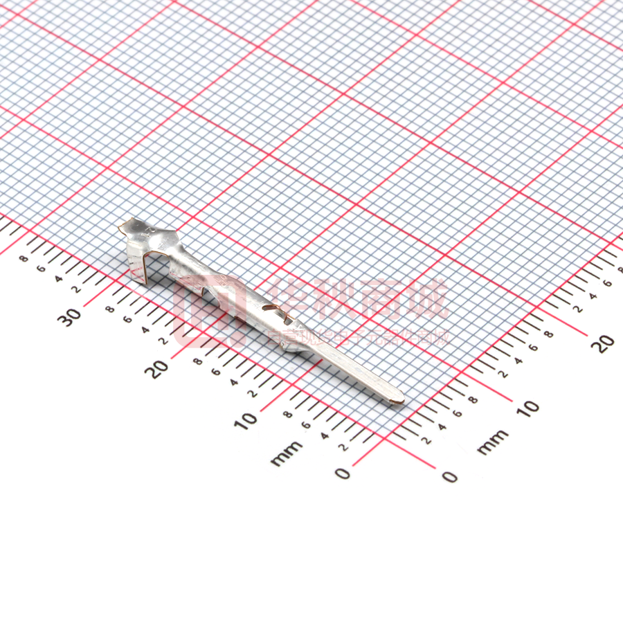

    胶壳端子 20-22AWG
15326268 数据手册
Crimp Information Sheet Terminal Part Number: Surface Plating: Material Thickness [mm]: Cross Section [mm²]: 15326268 Cable Type codes: Crimp Process: Insulation Range Φ[mm]: Seal(s): 1005 Cable type / seal SN 0,30 0,35 | 0,50 (C) CRIMP ONLY - TERMINAL IS APPLIED CRIMP ONLY 1,45 - 1,88 15366021 Arrangement 1005 0,35 / 15366021 1005 0,50 / 15366021 Nominal Insul. diam [mm] 1,60 1,74 Cable type code legend: 1005: Industry Designator: Conductor Material: Conductor Plating: Insul. Material: Insul. Wall Designator: File generated: 2014-07-29 Page 1 of 25 SAE COPPER NONE PVC, PVDF, XLPE THIN Tear-out CCH force [N] [mm] 55 80 1,05 1,10 Tol CCH [mm] 0,05 0,05 CCW [mm] 1,80 1,80 Tol CCW [mm] 0,10 0,10 ICH [mm] 3,30 3,50 Tol ICH [mm] 0,10 0,10 ICW [mm] 3,40 3,40 Tol ICW [mm] 0,10 0,10 Crimp Information Sheet Terminal Part Number: Surface Plating: Material Thickness [mm]: Cross Section [mm²]: 15326268 Cable Type codes: Crimp Process: Insulation Range Φ[mm]: Seal(s): 1005 Cable type / seal SN 0,30 0,50 (SR) SOLDER - REFLOW [LOW IMPEDANCE (SIR) CIRCUIT] 1,60 - 1,88 15366021 Arrangement 1005 0,50 / 15366021 Nominal Insul. diam [mm] 1,74 Cable type code legend: 1005: Industry Designator: Conductor Material: Conductor Plating: Insul. Material: Insul. Wall Designator: File generated: 2014-07-29 Page 2 of 25 SAE COPPER NONE PVC, PVDF, XLPE THIN Tear-out CCH force [N] [mm] 80 1,10 Tol CCH [mm] 0,05 CCW [mm] 1,80 Tol CCW [mm] 0,10 ICH [mm] 3,50 Tol ICH [mm] 0,10 ICW [mm] 3,40 Tol ICW [mm] 0,10 Crimp Information Sheet Terminal Part Number: Surface Plating: Material Thickness [mm]: Cross Section [mm²]: 15326268 Cable Type codes: Crimp Process: Insulation Range Φ[mm]: Seal(s): 1007 Cable type / seal SN 0,30 0,50 (C) CRIMP ONLY - TERMINAL IS APPLIED CRIMP ONLY 2,00 - 2,30 15366060 Arrangement Nominal Insul. diam [mm] 1007 0,50 / 15366060 2,15 Cable type code legend: 1007: Industry Designator: Conductor Material: Conductor Plating: Insul. Material: Insul. Wall Designator: File generated: 2014-07-29 Page 3 of 25 SAE COPPER NONE PVC, XLPA/PVDF, XLPE REGULAR Tear-out CCH force [N] [mm] 80 1,10 Tol CCH [mm] 0,05 CCW [mm] 1,80 Tol CCW [mm] 0,10 ICH [mm] 3,50 Tol ICH [mm] 0,10 ICW [mm] 3,40 Tol ICW [mm] 0,10 Crimp Information Sheet Terminal Part Number: Surface Plating: Material Thickness [mm]: Cross Section [mm²]: 15326268 Cable Type codes: Crimp Process: Insulation Range Φ[mm]: Seal(s): 1007 Cable type / seal SN 0,30 0,50 (SR) SOLDER - REFLOW [LOW IMPEDANCE (SIR) CIRCUIT] 2,00 - 2,30 15366060 Arrangement Nominal Insul. diam [mm] 1007 0,50 / 15366060 2,15 Cable type code legend: 1007: Industry Designator: Conductor Material: Conductor Plating: Insul. Material: Insul. Wall Designator: File generated: 2014-07-29 Page 4 of 25 SAE COPPER NONE PVC, XLPA/PVDF, XLPE REGULAR Tear-out CCH force [N] [mm] 80 1,10 Tol CCH [mm] 0,05 CCW [mm] 1,80 Tol CCW [mm] 0,10 ICH [mm] 3,50 Tol ICH [mm] 0,10 ICW [mm] 3,40 Tol ICW [mm] 0,10 Crimp Information Sheet Terminal Part Number: Surface Plating: Material Thickness [mm]: Cross Section [mm²]: 15326268 Cable Type codes: Crimp Process: Insulation Range Φ[mm]: Seal(s): 1025 Cable type / seal SN 0,30 0,35 | 0,50 (C) CRIMP ONLY - TERMINAL IS APPLIED CRIMP ONLY 1,47 - 1,85 15366021 Arrangement 1025 0,35 / 15366021 1025 0,50 / 15366021 Nominal Insul. diam [mm] 1,55 1,73 Tear-out CCH force [N] [mm] 55 80 1,05 1,10 Tol CCH [mm] 0,05 0,05 Cable type code legend: 1025: Industry Designator: Conductor Material: Conductor Plating: Insul. Material: Insul. Wall Designator: File generated: 2014-07-29 Page 5 of 25 SAE COPPER SN FLUORPOLYM, HDPE, PBT, PE, PVC, XLPE THIN CCW [mm] 1,80 1,80 Tol CCW [mm] 0,10 0,10 ICH [mm] 3,30 3,50 Tol ICH [mm] 0,10 0,10 ICW [mm] 3,40 3,40 Tol ICW [mm] 0,10 0,10 Crimp Information Sheet Terminal Part Number: Surface Plating: Material Thickness [mm]: Cross Section [mm²]: 15326268 Cable Type codes: Crimp Process: Insulation Range Φ[mm]: Seal(s): 1026 Cable type / seal SN 0,30 0,50 (C) CRIMP ONLY - TERMINAL IS APPLIED CRIMP ONLY 2,00 - 2,30 15366060 Arrangement Nominal Insul. diam [mm] 1026 0,50 / 15366060 2,15 Cable type code legend: 1026: Industry Designator: Conductor Material: Conductor Plating: Insul. Material: Insul. Wall Designator: File generated: 2014-07-29 Page 6 of 25 SAE COPPER SN HDPE, PVC, XLPE REGULAR Tear-out CCH force [N] [mm] 80 1,10 Tol CCH [mm] 0,05 CCW [mm] 1,80 Tol CCW [mm] 0,10 ICH [mm] 3,50 Tol ICH [mm] 0,10 ICW [mm] 3,40 Tol ICW [mm] 0,10 Crimp Information Sheet Terminal Part Number: Surface Plating: Material Thickness [mm]: Cross Section [mm²]: 15326268 Cable Type codes: Crimp Process: Insulation Range Φ[mm]: Seal(s): 1035 Cable type / seal SN 0,30 0,50 (C) CRIMP ONLY - TERMINAL IS APPLIED CRIMP ONLY 2,00 - 2,30 15366060 Arrangement Nominal Insul. diam [mm] 1035 0,50 / 15366060 2,15 Cable type code legend: 1035: Industry Designator: Conductor Material: Conductor Plating: Insul. Material: Insul. Wall Designator: File generated: 2014-07-29 Page 7 of 25 SAE COPPER NONE XLPE REGULAR Tear-out CCH force [N] [mm] 80 1,10 Tol CCH [mm] 0,05 CCW [mm] 1,80 Tol CCW [mm] 0,10 ICH [mm] 3,50 Tol ICH [mm] 0,10 ICW [mm] 3,40 Tol ICW [mm] 0,10 Crimp Information Sheet Terminal Part Number: Surface Plating: Material Thickness [mm]: Cross Section [mm²]: 15326268 Cable Type codes: Crimp Process: Insulation Range Φ[mm]: Seal(s): 1047 Cable type / seal SN 0,30 0,35 (C) CRIMP ONLY - TERMINAL IS APPLIED CRIMP ONLY 1,40 - 1,75 15366021 Arrangement Nominal Insul. diam [mm] 1047 0,35 / 15366021 1,58 Cable type code legend: 1047: Industry Designator: Conductor Material: Conductor Plating: Insul. Material: Insul. Wall Designator: File generated: 2014-07-29 Page 8 of 25 SAE COPPER NONE PVC, XLPE THIN Tear-out CCH force [N] [mm] 70 1,05 Tol CCH [mm] 0,05 CCW [mm] 1,80 Tol CCW [mm] 0,10 ICH [mm] 3,30 Tol ICH [mm] 0,10 ICW [mm] 3,40 Tol ICW [mm] 0,10 Crimp Information Sheet Terminal Part Number: Surface Plating: Material Thickness [mm]: Cross Section [mm²]: 15326268 Cable Type codes: Crimp Process: Insulation Range Φ[mm]: Seal(s): 1055 Cable type / seal SN 0,30 0,35 (C) CRIMP ONLY - TERMINAL IS APPLIED CRIMP ONLY 1,45 - 1,75 15366021 Arrangement 1055 0,35 / 15366021 Nominal Insul. diam [mm] 1,60 Cable type code legend: 1055: Industry Designator: Conductor Material: Conductor Plating: Insul. Material: Insul. Wall Designator: File generated: 2014-07-29 Page 9 of 25 SAE COPPER SN HDPE, PVC, XLPE THIN Tear-out CCH force [N] [mm] 70 1,05 Tol CCH [mm] 0,05 CCW [mm] 1,80 Tol CCW [mm] 0,10 ICH [mm] 3,30 Tol ICH [mm] 0,10 ICW [mm] 3,40 Tol ICW [mm] 0,10 Crimp Information Sheet Terminal Part Number: Surface Plating: Material Thickness [mm]: Cross Section [mm²]: 15326268 Cable Type codes: Crimp Process: Insulation Range Φ[mm]: Seal(s): 1092 Cable type / seal SN 0,30 0,50 (C) CRIMP ONLY - TERMINAL IS APPLIED CRIMP ONLY 2,00 - 2,30 15366060 Arrangement Nominal Insul. diam [mm] 1092 0,50 / 15366060 2,15 Cable type code legend: 1092: Industry Designator: Conductor Material: Conductor Plating: Insul. Material: Insul. Wall Designator: File generated: 2014-07-29 Page 10 of 25 SAE ALLOY NONE XLPE REGULAR Tear-out CCH force [N] [mm] 80 1,10 Tol CCH [mm] 0,05 CCW [mm] 1,80 Tol CCW [mm] 0,10 ICH [mm] 3,50 Tol ICH [mm] 0,10 ICW [mm] 3,40 Tol ICW [mm] 0,10 Crimp Information Sheet Terminal Part Number: Surface Plating: Material Thickness [mm]: Cross Section [mm²]: 15326268 Cable Type codes: Crimp Process: Insulation Range Φ[mm]: Seal(s): 2006 Cable type / seal SN 0,30 0,50 (C) CRIMP ONLY - TERMINAL IS APPLIED CRIMP ONLY 2,00 - 2,35 15366060 Arrangement Nominal Insul. diam [mm] 2006 0,50 / 15366060 2,18 Cable type code legend: 2006: Industry Designator: Conductor Material: Conductor Plating: Insul. Material: Insul. Wall Designator: File generated: 2014-07-29 Page 11 of 25 ISO COPPER NONE EPR, PVC, XLPE REGULAR Tear-out CCH force [N] [mm] 80 1,10 Tol CCH [mm] 0,05 CCW [mm] 1,80 Tol CCW [mm] 0,10 ICH [mm] 3,50 Tol ICH [mm] 0,10 ICW [mm] 3,40 Tol ICW [mm] 0,10 Crimp Information Sheet Terminal Part Number: Surface Plating: Material Thickness [mm]: Cross Section [mm²]: 15326268 Cable Type codes: Crimp Process: Insulation Range Φ[mm]: Seal(s): 2010 Cable type / seal 2010 2010 2010 2010 0,35 0,35 0,50 0,50 / / / / SN 0,30 0,35 | 0,50 (C) CRIMP ONLY - TERMINAL IS APPLIED CRIMP ONLY 1,20 - 1,70 12191226 | 15366021 Arrangement 12191226 15366021 12191226 15366021 Nominal Insul. diam [mm] 1,34 1,34 1,50 1,50 Tear-out CCH force [N] [mm] 50 50 80 80 1,15 1,15 1,25 1,25 Tol CCH [mm] 0,05 0,05 0,05 0,05 CCW [mm] 1,65 1,65 1,70 1,70 Tol CCW [mm] 0,10 0,10 0,10 0,10 ICH [mm] 3,30 3,30 3,40 3,40 Tol ICH [mm] 0,10 0,10 0,10 0,10 ICW [mm] 3,50 3,50 3,50 3,50 Tol ICW [mm] 0,10 0,10 0,10 0,10 Cable type code legend: 2010: ACW0219, FIAT T2 FLRY, FL RENAULT R1, FL RENAULT R3, FLR (AGP0219), FLR2X-A, FLR4Y-A, FLR9Y, FLRX-B, FLRY-A, FLRYB, FLRY-B Industry Designator: Conductor Material: Conductor Plating: Insul. Material: DIN Insul. Wall Designator: THIN File generated: 2014-07-29 Page 12 of 25 COPPER NONE PA, POLYOLEFIN, PP, PVC, SYNTHRESIN, XLCOPOLY, XLPBT, XLPE, XLPE/PVDF, XLPVC Crimp Information Sheet Terminal Part Number: Surface Plating: Material Thickness [mm]: Cross Section [mm²]: 15326268 Cable Type codes: Crimp Process: Insulation Range Φ[mm]: Seal(s): 2011 Cable type / seal SN 0,30 0,50 (C) CRIMP ONLY - TERMINAL IS APPLIED CRIMP ONLY 2,00 - 2,30 15366021 | 15366060 Arrangement Nominal Insul. diam [mm] 2011 0,50 / 15366021 2011 0,50 / 15366060 2,15 2,15 Tear-out CCH force [N] [mm] 75 80 1,10 1,10 Cable type code legend: 2011: Industry Designator: Conductor Material: Conductor Plating: Insul. Material: Insul. Wall Designator: File generated: 2014-07-29 Page 13 of 25 FL33X, FLK, FLY, FLYKW, IH WIRE DIN COPPER NONE P/EST, PE, PVC, XLPE REGULAR Tol CCH [mm] 0,05 0,05 CCW [mm] 1,80 1,80 Tol CCW [mm] 0,10 0,10 ICH [mm] 3,50 3,50 Tol ICH [mm] 0,10 0,10 ICW [mm] 3,50 3,40 Tol ICW [mm] 0,10 0,10 Crimp Information Sheet Terminal Part Number: Surface Plating: Material Thickness [mm]: Cross Section [mm²]: 15326268 Cable Type codes: Crimp Process: Insulation Range Φ[mm]: Seal(s): 2016 Cable type / seal SN 0,30 0,35 (C) CRIMP ONLY - TERMINAL IS APPLIED CRIMP ONLY 0,62 - 0,67 15366021 Arrangement Nominal Insul. diam [mm] 2016 0,35 / 15366021 0,65 Cable type code legend: 2016: Industry Designator: Conductor Material: Conductor Plating: Insul. Material: Insul. Wall Designator: File generated: 2014-07-29 Page 14 of 25 DIN-CORE DIN COPPER SN NONE NONE Tear-out CCH force [N] [mm] 50 1,05 Tol CCH [mm] 0,05 CCW [mm] 1,90 Tol CCW [mm] 0,10 ICH [mm] 3,15 Tol ICH [mm] 0,10 ICW [mm] 3,70 Tol ICW [mm] 0,10 Crimp Information Sheet Terminal Part Number: Surface Plating: Material Thickness [mm]: Cross Section [mm²]: 15326268 Cable Type codes: Crimp Process: Insulation Range Φ[mm]: Seal(s): 2017 Cable type / seal SN 0,30 0,35 | 0,50 (C) CRIMP ONLY - TERMINAL IS APPLIED CRIMP ONLY 1,10 - 1,70 15366021 | 12191152 Arrangement 2017 0,35 / 15366021 2017 0,50 / 15366021 2017 0,50 / 12191152 Nominal Insul. diam [mm] 1,25 1,50 1,50 Cable type code legend: 2017: Industry Designator: Conductor Material: Conductor Plating: Insul. Material: Insul. Wall Designator: File generated: 2014-07-29 Page 15 of 25 FLR41X-B, FLRY-A DIN COPPER SN PA, PP, PVC, XLPE THIN Tear-out CCH force [N] [mm] 50 80 80 1,15 1,25 1,25 Tol CCH [mm] 0,05 0,05 0,05 CCW [mm] 1,65 1,70 1,70 Tol CCW [mm] 0,10 0,10 0,10 ICH [mm] 2,90 3,10 3,10 Tol ICH [mm] 0,10 0,10 0,10 ICW [mm] 3,50 3,50 3,50 Tol ICW [mm] 0,10 0,10 0,10 Crimp Information Sheet Terminal Part Number: Surface Plating: Material Thickness [mm]: Cross Section [mm²]: 15326268 Cable Type codes: Crimp Process: Insulation Range Φ[mm]: Seal(s): 2021 Cable type / seal SN 0,30 0,50 (C) CRIMP ONLY - TERMINAL IS APPLIED CRIMP ONLY 1,20 - 1,70 15366021 Arrangement 2021 0,50 / 15366021 Nominal Insul. diam [mm] 1,45 Cable type code legend: 2021: Industry Designator: Conductor Material: Conductor Plating: Insul. Material: Insul. Wall Designator: File generated: 2014-07-29 Page 16 of 25 FLR6Y-A, FLR6Y-B DIN COPPER NONE ETFE, FEP, XLETFE THIN Tear-out CCH force [N] [mm] 80 1,10 Tol CCH [mm] 0,05 CCW [mm] 1,80 Tol CCW [mm] 0,10 ICH [mm] 3,50 Tol ICH [mm] 0,10 ICW [mm] 3,40 Tol ICW [mm] 0,10 Crimp Information Sheet Terminal Part Number: Surface Plating: Material Thickness [mm]: Cross Section [mm²]: 15326268 Cable Type codes: Crimp Process: Insulation Range Φ[mm]: Seal(s): 2021 Cable type / seal SN 0,30 0,50 (R) SOLDER - REFLOW [NON-SIR CIRCUIT] CORE IS DIP SOLD 1,20 - 1,70 15366021 Arrangement 2021 0,50 / 15366021 Nominal Insul. diam [mm] 1,45 Cable type code legend: 2021: Industry Designator: Conductor Material: Conductor Plating: Insul. Material: Insul. Wall Designator: File generated: 2014-07-29 Page 17 of 25 FLR6Y-A, FLR6Y-B DIN COPPER NONE ETFE, FEP, XLETFE THIN Tear-out CCH force [N] [mm] 80 1,10 Tol CCH [mm] 0,05 CCW [mm] 1,80 Tol CCW [mm] 0,10 ICH [mm] 3,50 Tol ICH [mm] 0,10 ICW [mm] 3,40 Tol ICW [mm] 0,10 Crimp Information Sheet Terminal Part Number: Surface Plating: Material Thickness [mm]: Cross Section [mm²]: 15326268 Cable Type codes: Crimp Process: Insulation Range Φ[mm]: Seal(s): 2041 Cable type / seal SN 0,30 0,35 (C) CRIMP ONLY - TERMINAL IS APPLIED CRIMP ONLY 1,23 - 1,40 15366021 Arrangement 2041 0,35 / 15366021 1,32 Cable type code legend: 2041: Industry Designator: Conductor Material: Conductor Plating: Insul. Material: Insul. Wall Designator: File generated: 2014-07-29 Page 18 of 25 Nominal Insul. diam [mm] ISO COPPER NONE PPE THIN Tear-out CCH force [N] [mm] 50 1,10 Tol CCH [mm] 0,05 CCW [mm] 1,80 Tol CCW [mm] 0,10 ICH [mm] 2,60 Tol ICH [mm] 0,10 ICW [mm] 3,50 Tol ICW [mm] 0,10 Crimp Information Sheet Terminal Part Number: Surface Plating: Material Thickness [mm]: Cross Section [mm²]: 15326268 Cable Type codes: Crimp Process: Insulation Range Φ[mm]: Seal(s): 2053 Cable type / seal SN 0,30 0,35 | 0,50 (C) CRIMP ONLY - TERMINAL IS APPLIED CRIMP ONLY 1,20 - 1,60 12191226 Arrangement 2053 0,35 / 12191226 2053 0,50 / 12191226 Nominal Insul. diam [mm] 1,30 1,50 Tear-out CCH force [N] [mm] 50 80 1,15 1,25 Tol CCH [mm] 0,05 0,05 CCW [mm] 1,70 1,70 Cable type code legend: 2053: Industry Designator: Conductor Material: Conductor Plating: Insul. Material: Insul. Wall Designator: File generated: 2014-07-29 Page 19 of 25 PSA T2 ZH ID, PSA T3 ZH ID, PSA T4 ZH ID PSA COPPER NONE POLYOLEFIN, X-POLY ID Tol CCW [mm] 0,10 0,10 ICH [mm] 2,80 2,90 Tol ICH [mm] 0,10 0,10 ICW [mm] 3,60 3,60 Tol ICW [mm] 0,10 0,10 Crimp Information Sheet Terminal Part Number: Surface Plating: Material Thickness [mm]: Cross Section [mm²]: 15326268 Cable Type codes: Crimp Process: Insulation Range Φ[mm]: Seal(s): 2054 Cable type / seal SN 0,30 0,35 | 0,50 (C) CRIMP ONLY - TERMINAL IS APPLIED CRIMP ONLY 1,25 - 1,70 12191226 | 15366021 Arrangement 2054 0,35 / 12191226 2054 0,50 / 15366021 2054 0,50 / 12191226 Nominal Insul. diam [mm] 1,33 1,55 1,55 Tear-out CCH force [N] [mm] 50 80 80 1,15 1,15 1,25 Tol CCH [mm] 0,05 0,05 0,05 CCW [mm] 1,70 1,70 1,70 Tol CCW [mm] 0,10 0,10 0,10 Cable type code legend: 2054: Industry Designator: Conductor Material: Conductor Plating: Insul. Material: Insul. Wall Designator: File generated: 2014-07-29 Page 20 of 25 PSA T2 IR, PSA T3 IR, PSA T3 ZH IR, PSA T4 LH IR PSA COPPER NONE POLYOLEFIN, PVC, X-POLY IR ICH [mm] 2,90 3,30 3,10 Tol ICH [mm] 0,10 0,10 0,10 ICW [mm] 3,50 3,60 3,50 Tol ICW [mm] 0,10 0,10 0,10 Crimp Information Sheet Terminal Part Number: Surface Plating: Material Thickness [mm]: Cross Section [mm²]: 15326268 Cable Type codes: Crimp Process: Insulation Range Φ[mm]: Seal(s): 2083 Cable type / seal SN 0,30 0,35 (C) CRIMP ONLY - TERMINAL IS APPLIED CRIMP ONLY 1,20 - 1,40 15366021 Arrangement Nominal Insul. diam [mm] 2083 0,35 / 15366021 1,30 Cable type code legend: 2083: Industry Designator: Conductor Material: Conductor Plating: Insul. Material: Insul. Wall Designator: File generated: 2014-07-29 Page 21 of 25 ISO COPPER NONE PVC (YW) THIN Tear-out CCH force [N] [mm] 55 1,05 Tol CCH [mm] 0,05 CCW [mm] 1,80 Tol CCW [mm] 0,10 ICH [mm] 2,90 Tol ICH [mm] 0,10 ICW [mm] 3,40 Tol ICW [mm] 0,10 Crimp Information Sheet Terminal Part Number: Surface Plating: Material Thickness [mm]: Cross Section [mm²]: 15326268 Cable Type codes: Crimp Process: Insulation Range Φ[mm]: Seal(s): 3004 Cable type / seal SN 0,30 0,30 | 0,50 (C) CRIMP ONLY - TERMINAL IS APPLIED CRIMP ONLY 1,30 - 1,70 15366021 Arrangement 3004 0,30 / 15366021 3004 0,50 / 15366021 Nominal Insul. diam [mm] 1,40 1,60 Cable type code legend: 3004: Industry Designator: Conductor Material: Conductor Plating: Insul. Material: Insul. Wall Designator: File generated: 2014-07-29 Page 22 of 25 AVSS JIS/JA COPPER NONE PVC, XLPE, X-PVC THIN Tear-out CCH force [N] [mm] 50 88 1,05 1,10 Tol CCH [mm] 0,05 0,05 CCW [mm] 1,75 1,75 Tol CCW [mm] 0,10 0,10 ICH [mm] 3,20 3,30 Tol ICH [mm] 0,10 0,10 ICW [mm] 3,50 3,50 Tol ICW [mm] 0,10 0,10 Crimp Information Sheet Terminal Part Number: Surface Plating: Material Thickness [mm]: Cross Section [mm²]: 15326268 Cable Type codes: Crimp Process: Insulation Range Φ[mm]: Seal(s): 8000 Cable type / seal SN 0,30 0,50 (C) CRIMP ONLY - TERMINAL IS APPLIED CRIMP ONLY 1,40 - 1,60 15366021 Arrangement Nominal Insul. diam [mm] 8000 0,50 / 15366021 1,50 Cable type code legend: 8000: Industry Designator: Conductor Material: Conductor Plating: Insul. Material: Insul. Wall Designator: File generated: 2014-07-29 Page 23 of 25 N/G COPPER NONE SYNTHRESIN THIN Tear-out CCH force [N] [mm] 80 1,10 Tol CCH [mm] 0,05 CCW [mm] 1,80 Tol CCW [mm] 0,10 ICH [mm] 3,50 Tol ICH [mm] 0,10 ICW [mm] 3,40 Tol ICW [mm] 0,10 Crimp Information Sheet Terminal Part Number: Surface Plating: Material Thickness [mm]: Cross Section [mm²]: 15326268 Cable Type codes: Crimp Process: Insulation Range Φ[mm]: Seal(s): 9000 Cable type / seal SN 0,30 0,50 (C) CRIMP ONLY - TERMINAL IS APPLIED CRIMP ONLY 1,90 - 2,05 15366060 Arrangement 9000 0,50 / 15366060 1,98 Cable type code legend: 9000: Industry Designator: Conductor Material: Conductor Plating: Insul. Material: Insul. Wall Designator: File generated: 2014-07-29 Page 24 of 25 Nominal Insul. diam [mm] MISC COPPER NONE PVDF MIX Tear-out CCH force [N] [mm] 80 1,10 Tol CCH [mm] 0,05 CCW [mm] 1,80 Tol CCW [mm] 0,10 ICH [mm] 3,50 Tol ICH [mm] 0,10 ICW [mm] 3,40 Tol ICW [mm] 0,10 Crimp Information Sheet Terminal Part Number: Surface Plating: Material Thickness [mm]: Cross Section [mm²]: 15326268 Cable Type codes: Crimp Process: Insulation Range Φ[mm]: Seal(s): 9003 Cable type / seal SN 0,30 0,50 (C) CRIMP ONLY - TERMINAL IS APPLIED CRIMP ONLY 1,92 - 2,06 15366060 Arrangement 9003 0,50 / 15366060 1,99 Cable type code legend: 9003: Industry Designator: Conductor Material: Conductor Plating: Insul. Material: Insul. Wall Designator: File generated: 2014-07-29 Page 25 of 25 Nominal Insul. diam [mm] N/G COPPER SN PVDF MIX Tear-out CCH force [N] [mm] 80 1,10 Tol CCH [mm] 0,05 CCW [mm] 1,80 Tol CCW [mm] 0,10 ICH [mm] 3,50 Tol ICH [mm] 0,10 ICW [mm] 3,40 Tol ICW [mm] 0,10
