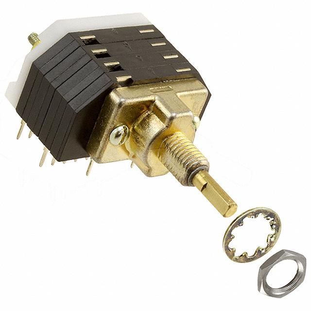

C2/C3 - SERIES 0.82 / 1.2" WIDE SPECIFICATIONS AND ORDERING INFORMATION 0.25 AMP @ 28 VDC The C2/C3 Series offers an 8 position and a 12 position vertical P.C. board mountable design. Standard designs utilize a 30° index angle and polyester insulation. C SPECIFICATIONS ELECTRICAL MECHANICAL Current and Voltage Rating: Make and break resistive load 0.25 amp @ 28 VDC; 0.1 amp @ 125 VAC. Current Carrying Capacity: 6 amps. Dielectric Strength: 1,000 VAC between current carrying parts and ground. Contact Resistance: Average initial 30 milliohms. Insulation Resistance: In excess of 10,000 megohms. Materials and Finishes: All parts utilize non-corrosive materials as standard. Terminals and Contacts: Brass with silver plate as standard. Insulation: Polyester. Index: Dual-ball, hill and valley. Index Life: 25,000 cycles minimum. Index Torque: Switches have lowest practical torque consistent with crisp detenting and smooth, reliable operation. Index Angles: Positive 30° standard, 60°, and 90° available. Index Stops: Fixed standard, adjustable, or continuous available. Stop Strength: 8 in. lbs. minimum. Hardware: Mounting nut and lockwasher are shipped assembled. STANDARD PART NUMBER C3 - 12 PIN CONSTRUCTION SWITCHES - 30° INDEXING ADJUSTABLE STOPS SET @ 2 POS. - P.C. TERMINALS C2 - 8 PIN CONSTRUCTION SWITCHES - 30° INDEXING ADJUSTABLE STOPS SET @ 2 POS. - P.C. TERMINALS ACTIVE POLES/ POLES POSITIONS DECK 01 02 02 03 04 04 05 06 02-08 02-08 02-04 02-08 02-04 02-08 02-08 02-04 1 1 2 1 2 1 1 2 NO. OF DECKS 1 2 1 3 2 4 5 3 SHORTING C2P0108S - A C2P0208S - A C2P0204S - A C2P0308S - A C2P0404S - A C2P0408S - A C2P0508S - A C2P0604S - A NONSHORTING FIG. C2P0108N - A C2P0208N - A C2P0204N - A C2P0308N - A C2P0404N - A C2P0408N - A C2P0508N - A C2P0604N - A CD CD CI CD CI CD CD CI * ACTIVE POLES/ POLES POSITIONS DECK 01 02 02 03 03 04 04 06 02-12 02-12 02-06 02-04 02-12 02-06 02-12 02-04 1 1 2 3 1 2 1 3 NO. OF DECKS 1 2 1 1 3 2 4 2 SHORTING C3P0112S - A C3P0212S - A C3P0206S - A C3P0304S - A C3P0312S - A C3P0406S - A C3P0412S - A C3P0604S - A NONSHORTING C3P0112N - A C3P0212N - A C3P0206N - A C3P0304N - A C3P0312N - A C3P0406N - A C3P0412N - A C3P0604N - A FIG. * CA CA CH CK CA CH CA CK * FIGURES ARE SHOWN ON PAGE 55. C2 - DIMENSIONS - 8 PIN DESIGN C2P - STANDARD 8–PIN PER DECK ARRANGEMENT A 195° 1/4" DIAMETER SHAFTS ARE AVAILABLE. CONTACT FACTORY. • ELECTRONIC PRODUCTS UNIT OF ELECTRO SWITCH CORP. 8 2010 Yonkers Road Raleigh, NC 27604 Telephone: (888) ROTARYS or (919) 833-0707 Fax: (800) 909-9171 or (919) 833-8016 C2/C3 - SERIES ADDITIONAL OPTIONS AND ORDERING INFORMATION How to Order Additional Options: 2 DIGIT SERIES INSULATION TYPE C2 P-POLYESTER 01 - MIN. C3 TOTAL POLES P-POLYESTER 01 - MIN. ACTIVE POSITIONS 08 - MAX @ 30° 04 - MAX @ 60° 03 - MAX @ 90° 12 - MAX @ 30° 06 - MAX @ 60° 04 - MAX @ 90° CONTACT TYPE TERMINAL TYPE N - NON SHORTING S - SHORTING INDEX ANGLE STOP TYPE SHAFT/ BUSHING SHAFT FLAT 30° 60° 90° F - FIXED C - CONT. A - ADJ. SEE CHART "A" SEE CHART "B" (SPECIFY) (SPECIFY) (SPECIFY) N - NON SHORTING S - SHORTING CUSTOMERS SPECIFIED ORDER NUMBER FOR STANDARD OPTIONS C ADDITIONAL OPTIONS P (SPECIFY) (SPECIFY) (SPECIFY) SHAFT AND FLAT OPTIONS PRINTED CIRCUIT BOARD PATTERN C2 8–PIN DECK (SPECIFY) C3 12–PIN DECK SHAFT AS VIEWED WITH NON-TURN LUG AT 9 O'CLOCK AND SHAFT IN EXTREME CCW POSITION AND STRUT BOLTS ORIENTED VERTICALLY. NOTES: 1. The standard spacing for the row of terminals to the mounting 2. The standard spacing for the row of terminals to the mounting C3 - 1/8” dia. shaft from the first surface is .390 in. 1/4” dia. shaft from the first surface is .481 in. DIMENSIONS - U W Y Z 12 PIN DESIGN C3P - STANDARD 12–PIN PER DECK ARRANGEMENT NOTE: 1. ONE DECK EQUALS TWO WAFERS. 2. ADD .300" FOR EACH ADDITIONAL DECK. 1/4" DIAMETER SHAFTS ARE AVAILABLE. 3. 12 FIXED POSITION USES ADJUSTABLE STOP DIMENSIONS. CONTACT FACTORY. CUSTOM SWITCHES ARE AVAILABLE. CONTACT THE FACTORY WITH YOUR COMPLETE SPECIFICATIONS. • ELECTRONIC PRODUCTS UNIT OF ELECTRO SWITCH CORP. 2010 Yonkers Road Raleigh, NC 27604 Telephone: (888) ROTARYS or (919) 833-0707 Fax: (800) 909-9171 or (919) 833-8016 9
