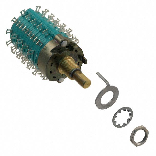

    SWITCH ROTARY 15P-4POS ENCLD 28V
C4D1504N-A 数据手册
C4 - SERIES SPECIFICATIONS AND ORDERING INFORMATION 1.5" DIAMETER 0.5 AMP @ 28 VDC The C4 Series provides a versatile, fully enclosed design, that helps keep dirt and moisture out of the contact area while locking in life time lubricants. IP67 Rating Available. C SPECIFICATIONS ELECTRICAL Current and Voltage Rating: Make and break resistive load 0.5 amp @ 28 VDC; 0.3 amp @ 125 VAC. Current Carrying Capacity: 15 amps. Dielectric Strength: 1,000 VAC between current carrying parts and ground. Contact Resistance: Average initial 3 milliohms. Insulation Resistance: In excess of 10,000 megohms. Hardware: Mounting nut and lockwasher are shipped assembled. MECHANICAL Materials and Finishes: All parts utilize non-corrosive materials as standard. Terminals and Contacts: Brass with silver plate as standard. Insulation: Diallyl phthalate. Index: Dual-ball, hill and valley. Index Life: 25,000 cycles minimum. Index Torque: Switches have lowest practical torque consistent with crisp detenting and smooth, reliable operation. Index Angles: 30° standard, 36°, 45°, 60°, and 90° available. Index Stops: Fixed standard, adjustable or continuous available. Stop Strength: 15 in. lbs. minimum. STANDARD PART NUMBER SOLDER LUG - ADJUSTABLE STOPS SWITCHES - 30° INDEXING - STOPS SET @ 2 POS. ACTIVE POLES/ POLES POSITIONS DECK 01 02 02 03 03 04 04 05 02-12 02-06 02-12 02-12 02-04 02-12 02-06 02-12 1 2 1 1 3 1 2 1 NO. OF DECKS 1 1 2 3 1 4 2 5 SHORTING C4D0112S - A C4D0206S - A C4D0212S - A C4D0312S - A C4D0304S - A C4D0412S - A C4D0406S - A C4D0512S - A NONSHORTING FIG. C4D0112N - A C4D0206N - A C4D0212N - A C4D0312N - A C4D0304N - A C4D0412N - A C4D0406N - A C4D0512N - A CA CH CA CA CK CA CH CA * ACTIVE POLES/ POLES POSITIONS DECK 06 06 06 08 09 10 12 15 02-06 02-04 02-12 02-06 02-04 02-06 02-04 02-04 2 3 1 2 3 2 3 3 NO. OF DECKS 3 2 6 4 3 5 4 5 SHORTING C4D0606S - A C4D0604S - A C4D0612S - A C4D0806S - A C4D0904S - A C4D1006S - A C4D1204S - A C4D1504S - A NONSHORTING C4D0606N - A C4D0604N - A C4D0612N - A C4D0806N - A C4D0904N - A C4D1006N - A C4D1204N - A C4D1504N - A FIG. * CH CK CA CH CK CH CK CK * FIGURES ARE SHOWN ON PAGE 55. DIMENSIONS C4D STANDARD CONSTRUCTION Q • ELECTRONIC PRODUCTS UNIT OF ELECTRO SWITCH CORP. 10 2010 Yonkers Road Raleigh, NC 27604 Telephone: (888) ROTARYS or (919) 833-0707 Fax: (800) 909-9171 or (919) 833-8016 C4 - SERIES ADDITIONAL OPTIONS AND ORDERING INFORMATION How to Order Additional Options: 2 DIGIT SERIES INSULATION TYPE C4 D - DIALLYL TOTAL POLES ACTIVE POSITIONS CONTACT TYPE 01 - MIN. 12 - MAX @ 30° 10 - MAX@ 36° 08 - MAX @ 45° 06 - MAX @ 60° 04 - MAX @ 90° S - SHORTING N - NON SHORTING TERMINAL TYPE L - SOLDER LUG P - FRONT P.C. R - REAR P.C. (30° & 36° ONLY) CUSTOMERS SPECIFIED ORDER NUMBER FOR STANDARD OPTIONS 4 STOP TYPE 30° 36° F - FIXED A- A 45° 60° 90° (30°,60°,90° ONLY) SHAFT/ BUSHING D SHAFT FLAT J . (NOT IN 45°) Q - QUICK CONNECT C INDEX ANGLE SEE CHART "A" SEE CHART "B" (SPECIFY) (SPECIFY) (SPECIFY) C - CONT. C ADDITIONAL OPTIONS D (SPECIFY) (SPECIFY) PRINTED CIRCUIT BOARD HOLE PATTERNS (SPECIFY) (SPECIFY) (SPECIFY) SHAFT, BUSHING, AND FLAT OPTIONS 30° INDEX, 1 AND 2 POLE SHAFT AS VIEWED WITH NON-TURN LUG AT 9 O'CLOCK AND SHAFT IN EXTREME CCW POSITION AND STRUT BOLTS ORIENTED VERTICALLY. U W Y Z PRINTED CIRCUIT BOARD TERMINAL OPTIONS 36° INDEX, 10 POSITION FRONT PRINTED CIRCUIT R REAR PRINTED CIRCUIT P CUSTOM SWITCHES ARE AVAILABLE. CONTACT THE FACTORY WITH YOUR COMPLETE SPECIFICATIONS. • ELECTRONIC PRODUCTS UNIT OF ELECTRO SWITCH CORP. 2010 Yonkers Road Raleigh, NC 27604 Telephone: (888) ROTARYS or (919) 833-0707 Fax: (800) 909-9171 or (919) 833-8016 11
