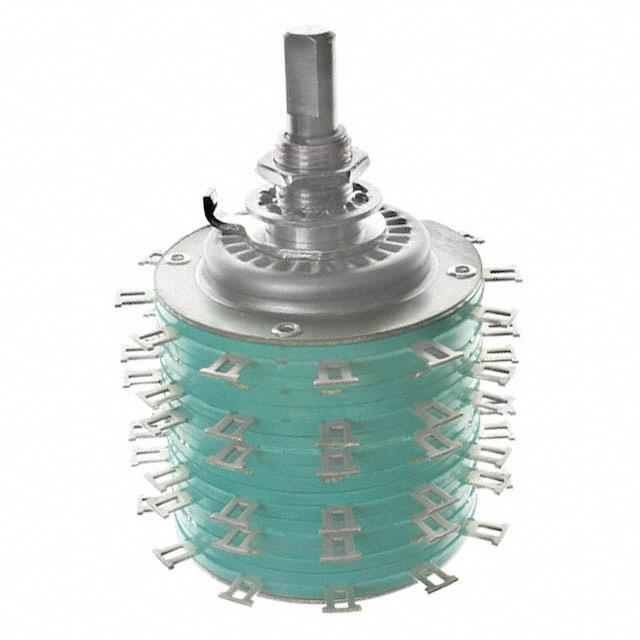

    SWITCH ROTARY 3P-23POS ENCLOSED
C7D0323N 数据手册
C7 - SERIES 2 1/32" DIAMETER SPECIFICATIONS AND ORDERING INFORMATION 1.0 AMP @ 28 VDC The C7 Series provides a fully enclosed, modular design that enables switching up to 24 positions. Our standard design offers 15° indexing, and solder lug terminals. C SPECIFICATIONS ELECTRICAL MECHANICAL Current and Voltage Rating: Make and break resistive load 1.0 amp @ 28 VDC; 0.5 amp @ 125 VAC. Current Carrying Capacity: 25 amps. Dielectric Strength: 1,000 VAC between current carrying parts and ground. Contact Resistance: Average initial 3 milliohms. Insulation Resistance: In excess of 10,000 megohms. Materials and Finishes: All parts utilize non-corrosive materials as standard. Terminals and Contacts: Brass with silver plate as standard. Insulation: Diallyl phthalate. Index: Single-ball, hill and valley. Index Life: 25,000 cycles minimum. Index Torque: Switches have lowest practical torque consistent with crisp detenting and smooth, reliable operation. Index Angles: 15° standard, 30°, 60°, and 90° available. Index Stops: Fixed standard, continuous, or adj. available. Stop Strength: 25 in. lbs. minimum. Hardware: Mounting nut and lockwasher are shipped assembled. STANDARD PART NUMBER 15° INDEXING - FIXED STOPS 15° INDEXING - CONTINUOUS ROTATION SOLDER LUG TERMINALS SOLDER LUG TERMINALS ACTIVE POLES POSITIONS 01 23 02 23 03 23 04 23 30° INDEXING 01 12 02 12 03 12 POLES/ DECK NO. OF DECKS 1 1 1 1 1 2 3 4 1 1 1 1 2 3 SHORTING C7D0123S C7D0223S C7D0323S C7D0423S C7D0112S -30 C7D0212S -30 C7D0312S -30 NONSHORTING FIG. * C7D0123N C7D0223N C7D0323N C7D0423N CF CF CF CF C7D0112N -30 C7D0212N -30 C7D0312N -30 CA CA CA ACTIVE POLES POSITIONS 01 24 02 24 03 24 04 24 30° INDEXING 01 12 02 12 03 12 POLES/ DECK NO. OF DECKS 1 1 1 1 1 2 3 4 1 1 1 1 2 3 SHORTING C7D0124S - C C7D0224S - C C7D0324S - C C7D0424S - C NONSHORTING C7D0124N - C C7D0224N - C C7D0324N - C C7D0424N - C FIG. * CG CG CG CG C7D0112S -30C C7D0112N -30C CA C7D0212S -30C C7D0212N -30C CA C7D0312S -30C C7D0312N -30C CA * FIGURES ARE SHOWN ON PAGE 55. DIMENSIONS STANDARD CONSTRUCTION - 15° INDEX ANGLE (3 WAFER DECK) • ELECTRONIC PRODUCTS UNIT OF ELECTRO SWITCH CORP. 14 Q .187 QUICK CONNECT 2010 Yonkers Road Raleigh, NC 27604 Telephone: (888) ROTARYS or (919) 833-0707 Fax: (800) 909-9171 or (919) 833-8016 ADDITIONAL OPTIONS AND ORDERING INFORMATION C7 - SERIES How to Order Additional Options: 2 DIGIT SERIES INSULATION TYPE TOTAL POLES ACTIVE POSITIONS C7 D - DIALLYL 01 - MIN. 24 - MAX @ 15° CONTACT TYPE S - SHORTING N - NON SHORTING TERMINAL TYPE L - SOLDER LUG Q - QUICK CONNECT INDEX ANGLE STOP TYPE SHAFT/ BUSHING SHAFT FLAT 15° F - FIXED SEE CHART "A" SEE CHART "B" (SPECIFY) (SPECIFY) (SPECIFY) 23 - POS. MAX. C - CONT. 24 - POS. MAX. C7 D - DIALLYL 01 - MIN. 12 - MAX @ 30° 06 - MAX @ 60° 04 - MAX @ 90° S - SHORTING N - NON SHORTING AL - SOLDER LUG30° Q - QUICK 60° CONNECT 90° CUSTOMERS SPECIFIED ORDER NUMBER FOR STANDARD OPTIONS C 7 Adjustable A23 - POS. MAX. C C - CONT. a - Adjustable ADDITIONAL OPTIONS D (SPECIFY) (SPECIFY) (SPECIFY) (SPECIFY) (SPECIFY) SHAFT AND FLAT OPTIONS SHORTING AND NON-SHORTING SWITCHING IS NOT GUARANTEED ON THE 15° INDEXING C7 SERIES. SHAFT AS VIEWED WITH NON-TURN LUG AT 9 O'CLOCK AND SHAFT IN EXTREME CCW POSITION . U W Y Z DIMENSIONS STANDARD CONSTRUCTION - 30° INDEX ANGLE (2 WAFER DECK) CUSTOM SWITCHES ARE AVAILABLE. CONTACT THE FACTORY WITH YOUR COMPLETE SPECIFICATIONS. • ELECTRONIC PRODUCTS UNIT OF ELECTRO SWITCH CORP. 2010 Yonkers Road Raleigh, NC 27604 Telephone: (888) ROTARYS or (919) 833-0707 Fax: (800) 909-9171 or (919) 833-8016 15
