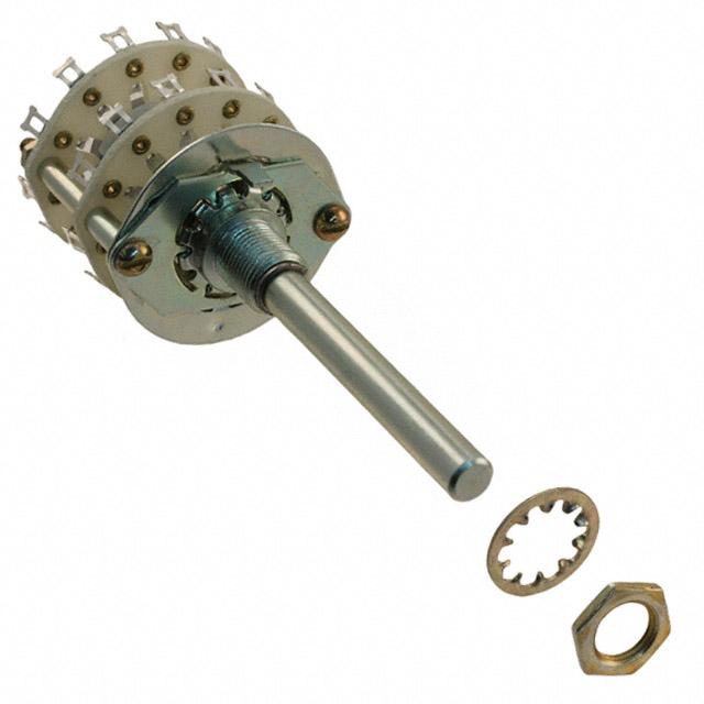

    SWITCH ROTARY DP-11POS OPEN 28V
D4G0211N 数据手册
D4 - SERIES SPECIFICATIONS AND ORDERING INFORMATION 1.437" DIAMETER 1.5 AMPS @ 28 VDC The D4 Series switch is the most economical and versatile switch in our open frame rotary line. This series offers the quality feel of a ball and spring index mechanism and is available with up to 12 positions and 30° or 60° indexing. SPECIFICATIONS D ELECTRICAL MECHANICAL Current and Voltage Rating: Make and break resistive load 1.5 amps @ 28 VDC; 0.5 amp @ 115 VAC. Current Carrying Capacity: 9 amps. Dielectric Strength: 1,500 VAC between current carrying parts and ground. Contact Resistance: Average initial 3.5 milliohms. Insulation Resistance: Glass epoxy in excess of 750,000 megohms. Ceramic in excess of 1,000,000 megohms. Diallyl in excess of 900,000 megohms. Hardware: Mounting nut and lockwasher are shipped assembled. Materials and Finishes: All parts utilize non-corrosive materials as standard. Clips and Rotors: Brass with silver plate as standard. Insulation: Glass epoxy, ceramic, or diallyl phthalate. Index: Single-ball, hill and valley. Index Life: 25,000 cycles minimum. Index Torque: Switches have lowest practical torque consistent with crisp detenting and smooth, reliable operation. Index Angles: Positive 30° standard, 60° available. Index Stops: Adjustable standard, fixed or continuous. Stop Strength: 10 in. lbs. minimum. STANDARD PART NUMBER GLASS EPOXY INSULATION CERAMIC INSULATION SWITCHES - SOLDER LUG TERMINALS - 30° INDEX - ADJUSTABLE STOPS ACTIVE POLES/ POLES POSITIONS SECTION 01 02-11 1 02 02-11 1 02 02-05 2 03 02-11 1 03 02-03 3 04 02-11 1 04 02-05 2 05 02-11 1 06 02-11 1 06 02-05 2 06 02-03 3 09 02-03 3 NO. OF SECTIONS 1 2 1 3 1 4 2 5 6 3 2 3 SHORTING D4G0111S D4G0211S D4G0205S D4G0311S D4G0303S D4G0411S D4G0405S D4G0511S D4G0611S D4G0605S D4G0603S D4G0903S NONSHORTING D4G0111N D4G0211N D4G0205N D4G0311N D4G0303N D4G0411N D4G0405N D4G0511N D4G0611N D4G0605N D4G0603N D4G0903N SWITCHES - SOLDER LUG TERMINALS - 30° INDEX - ADJUSTABLE STOPS FIG. * DA DA DG DA DM DA DG DA DA DG DM DM ACTIVE POLES/ POLES POSITIONS SECTION 01 02-12 1 02 02-12 1 02 02-06 2 03 02-12 1 03 02-05 3 04 02-12 1 04 02-06 2 05 02-12 1 05 02-03 5 06 02-12 1 06 02-06 2 06 02-05 3 NO. OF SECTIONS 1 2 1 3 1 4 2 5 1 6 3 2 SHORTING D4C0112S D4C0212S D4C0206S D4C0312S D4C0305S D4C0412S D4C0406S D4C0512S D4C0503S D4C0612S D4C0606S D4C0605S NONSHORTING D4C0112N D4C0212N D4C0206N D4C0312N D4C0305N D4C0412N D4C0406N D4C0512N D4C0503N D4C0612N D4C0606N D4C0605N FIG. * DD DD DL DD DO DD DL DD DR DD DL DO * FIGURES ARE SHOWN ON PAGES 55 AND 56. DIMENSIONS STANDARD CONSTRUCTION D4G - STANDARD GLASS EPOXY CONSTRUCTION • ELECTRONIC PRODUCTS UNIT OF ELECTRO SWITCH CORP. 24 2010 Yonkers Road Raleigh, NC 27604 Telephone: (888) ROTARYS or (919) 833-0707 Fax: (800) 909-9171 or (919) 833-8016 ADDITIONAL OPTIONS AND ORDERING INFORMATION D4 - SERIES How to Order Additional Options: 2 DIGIT SERIES INSULATION TYPE TOTAL POLES ACTIVE POSITIONS D4 G - GLASS C - CERAMIC D - DIALLYL 01 - MIN. 12 - MAX @ 30° 06 - MAX @ 60° CONTACT TYPE N - NON SHORTING S - SHORTING TERMINAL TYPE L - SOLDER LUG R - REAR P.C. INDEX ANGLE STOP TYPE 30° 60° A - ADJ. F - FIXED C - CONT. CUSTOMERS SPECIFIED ORDER NUMBER FOR STANDARD OPTIONS D SHAFT/ BUSHING SHAFT FLAT SEE CHART “A” SEE CHART “B” (SPECIFY) (SPECIFY) (SPECIFY) ADDITIONAL OPTIONS 4 (SPECIFY) ADJUSTABLE STOP MECHANISM (SPECIFY) (SPECIFY) (SPECIFY) (SPECIFY) SHAFT, BUSHING, AND FLAT OPTIONS D SHAFT AS VIEWED WITH NON-TURN LUG AT 9 O'CLOCK AND SHAFT IN EXTREME CCW POSITION AND STRUT BOLTS ORIENTED VERTICALLY. REMOVE STOP LUGS TO ACHIEVE MORE POSITIONS. U W Y Z INSULATION AND PRINTED CIRCUIT BOARD TERMINAL OPTIONS D4C - CERAMIC CONSTRUCTION D4D -DIALLYL PHTHALATE CONSTRUCTION DIALLYL PHTHALATE P.C. BOARD MOUNTING PATTERN R CUSTOM SWITCHES ARE AVAILABLE. CONTACT THE FACTORY WITH YOUR COMPLETE SPECIFICATIONS. • ELECTRONIC PRODUCTS UNIT OF ELECTRO SWITCH CORP. 2010 Yonkers Road Raleigh, NC 27604 Telephone: (888) ROTARYS or (919) 833-0707 Fax: (800) 909-9171 or (919) 833-8016 25

物料型号:D4系列开关,包括玻璃环氧树脂、陶瓷和二醛酸盐绝缘材料的型号。
器件简介:D4系列是开放式框架旋转系列中最经济、最多样化的开关,具有球和弹簧索引机制的优质触感,提供多达12个位置和30°或60°的索引。
引脚分配:文档列出了不同型号的开关,包括其活动极、位置、每节极数、节数、短路和非短路配置。
参数特性: - 电气特性:包括电流和电压等级、电流承载能力、介电强度、接触电阻和绝缘电阻。 - 机械特性:包括材料和表面处理、夹子和转子材料、绝缘材料、索引机制、索引寿命、索引扭矩、索引角度、索引停止和停止强度。
功能详解:文档提供了如何订购额外选项的指南,包括终端、索引停止、轴/轴类型、角度类型、衬套和平面。
应用信息:适用于需要旋转选择功能的电子设备。
封装信息:提供了D4G标准玻璃环氧树脂结构的尺寸信息。
