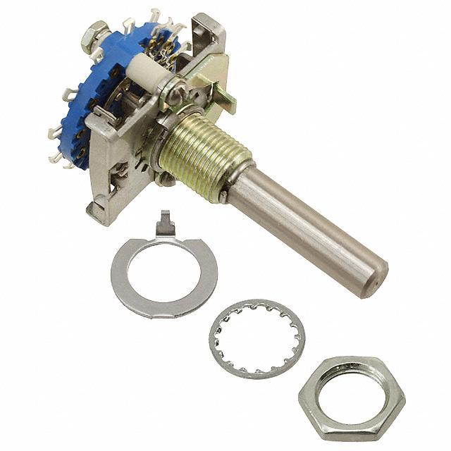

    SWITCH ROTARY 2-5POS 250MA 115V
D2D0305N 数据手册
D2 - SERIES SPECIFICATIONS AND ORDERING INFORMATION 1" DIAMETER 0.55 AMP @ 28 VDC The D2 Series switch is used where space is at a premium. This dual-ball side thrust index offers exceptional torque control and is available in 30°, 36°, 45°, and 60° angles. Standard designs utilize diallyl phthalate or ceramic insulation, solder lug terminals, and 30° adjustable stop indexing. SPECIFICATIONS D ELECTRICAL MECHANICAL Current and Voltage Rating: Make and break resistive load 0.55 amp @ 28 VDC; 0.25 amp @ 115 VAC. Current Carrying Capacity: 7 amps. Dielectric Strength: 750 VAC between current carrying parts and ground. Contact Resistance: Average initial 5 milliohms. Insulation Resistance: Diallyl in excess of 900,000 megohms. Glass in excess of 750,000 megohms. Ceramic in excess of 1,000,000 megohms. Hardware: Mounting nut and lockwasher are shipped assembled. Materials and Finishes: All parts utilize non-corrosive materials as standard. Clips and Rotors: Brass with silver plate as standard. Insulation: Diallyl phthalate, glass, or ceramic. Index: Dual-ball, side thrust design. Index Life: 25,000 cycles minimum. Index Torque: Switches have lowest practical torque consistent with crisp detenting and smooth, reliable operation. Index Angles: Positive 30° standard, 36°, 45°, and 60° available. Index Stops: Adjustable standard, fixed or continuous. Stop Strength: 10 in. lbs. minimum. STANDARD PART NUMBER DIALLYL PHTHALATE INSULATION - ADJUSTABLE STOPS CERAMIC INSULATION - ADJUSTABLE STOPS SWITCHES - SOLDER LUG TERMINALS - 30° INDEX - SET @ 2 POS. SWITCHES - SOLDER LUG TERMINALS - 30° INDEX - SET @ 2 POS. - 1/8 DIA. SHAFT ACTIVE POLES/ POLES POSITIONS SECTION 01 02 02 03 03 04 06 06 02-12 02-06 02-12 02-05 02-12 02-06 02-05 02-06 NO. OF SHORTING NONSECTIONS SHORTING 1 2 1 3 1 2 3 2 1 1 2 1 3 2 2 3 D2D0112S D2D0206S D2D0212S D2D0305S D2D0312S D2D0406S D2D0605S D2D0606S D2D0112N D2D0206N D2D0212N D2D0305N D2D0312N D2D0406N D2D0605N D2D0606N FIG. * DE DL DE DO DE DL DO DL ACTIVE POLES/ POLES POSITIONS SECTION 01 02 02 03 03 04 06 06 02-11 02-05 02-11 02-03 02-11 02-05 02-05 02-03 1 2 1 3 1 2 2 3 NO. OF SHORTING NONSECTIONS SHORTING 1 1 2 1 3 2 3 2 D2C0111S D2C0205S D2C0211S D2C0303S D2C0311S D2C0405S D2C0605S D2C0603S D2C0111N D2C0205N D2C0211N D2C0303N D2C0311N D2C0405N D2C0605N D2C0603N FIG. * DB DG DB DN DB DG DG DN * FIGURES ARE SHOWN ON PAGES 55 AND 56. DIMENSIONS STANDARD CONSTRUCTION D2D DIALLYL PHTHALATE INSULATION • ELECTRONIC PRODUCTS UNIT OF ELECTRO SWITCH CORP. 20 D2C CERAMIC INSULATION 2010 Yonkers Road Raleigh, NC 27604 Telephone: (888) ROTARYS or (919) 833-0707 Fax: (800) 909-9171 or (919) 833-8016 D2 - SERIES ADDITIONAL OPTIONS AND ORDERING INFORMATION How to Order Additional Options: 2 DIGIT SERIES INSULATION TYPE TOTAL POLES ACTIVE POSITIONS D2 D - DIALLYL 01 - MIN. 12 - MAX @ 30° 10 - MAX @ 36° 08 - MAX @ 45° 06 - MAX @ 60° S - SHORTING N - NON SHORTING 11 - MAX @ 30° S - SHORTING N - NON SHORTING (30°,45°,60°) G - GLASS (30°,36°,45°,60°) D2 C - CERAMIC 01 - MIN. (30°,60°) 1/8 SHAFT CONTACT TYPE TERMINAL TYPE INDEX ANGLE STOP TYPE L - SOLDER LUG V - VERT. P.C. 30° R - (REAR P.C. NOT CERAMIC) 30° 36° 45° 60° A - ADJ. F - FIXED C - CONT. L - SOLDER LUG 30° 60° A - ADJ. F - FIXED C - CONT. CUSTOMERS SPECIFIED ORDER NUMBER FOR STANDARD OPTIONS D SHAFT/ BUSHING SHAFT FLAT SEE CHART “A” SEE CHART “B” (SPECIFY) (SPECIFY) (SPECIFY) ADDITIONAL OPTIONS 2 (SPECIFY) (SPECIFY) (SPECIFY) (SPECIFY) (SPECIFY) SHAFT, BUSHING, AND FLAT OPTIONS INSULATION OPTION D2G GLASS EPOXY INSULATION D SHAFT AS VIEWED WITH NON-TURN LUG AT 3 O'CLOCK AND SHAFT IN EXTREME CCW POSITION AND STRUT BOLTS ORIENTED VERTICALLY. U W Y Z PRINTED CIRCUIT BOARD TERMINAL OPTIONS R REAR P.C. DIALLYL ONLY V VERTICALP.C. CUSTOM SWITCHES ARE AVAILABLE. CONTACT THE FACTORY WITH YOUR COMPLETE SPECIFICATIONS. • ELECTRONIC PRODUCTS UNIT OF ELECTRO SWITCH CORP. 2010 Yonkers Road Raleigh, NC 27604 Telephone: (888) ROTARYS or (919) 833-0707 Fax: (800) 909-9171 or (919) 833-8016 21
