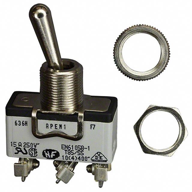

    钮子开关 单刀双掷 1万次 面板安装 15A 250V -20℃~+55℃
636H 数据手册
1 H 00 SW -6 N 00 -6 PANEL SWITCHES 80 -1 H 600H-600NH series Toggle switches • high amperage DISTINCTIVE FEATURES Robust mechanism High current/voltage rating Insulated or metal lever UL, CSA and NF-VDE (EN 61058-1) approved ELECTRICAL SPECIFICATIONS • Max. current/voltage ratings : see tables below • Peak current : 30 A max. during 1/2 sine, 250 VAC • Initial contact resistance : 10 mΩ max. • Insulation resistance : 1,000 MΩ min. at 500 VDC • Dielectric strength : 2,000 Vrms 50 Hz min. between terminals 2,500 Vrms 50 Hz min. between terminals and frame • Electrical life : 10,000 cycles at full load APPROVED RATINGS 600H - 600NH Models Functions UL CSA NF-VDE UL 1054 CSA 22-2 EN 61058-1 ON - OFF (1) Single and double pole Three pole 15 A 1/2 HP 125-250 VAC ON - ON (6) Other (4-5-7-8-9) 10 A 1/2 HP 125-250 VAC ON - OFF (1) & ON - ON (6) 15 A 1/2 HP 125-250 VAC Other (4-5-7-8-9) 10 A 1/2 HP 125-250 VAC 10(4) A 400 VAC T 85/55 (600H) T 125/55 (600NH) FOR INFORMATION Max. current/voltage rating w. resistive load Functions Ratings Electrical life ON - OFF ON - ON 15 A 250 VAC 10 A 24 VDC 15 A 12 VDC 10,000 cycles ON OFF ON 15 A 250 VAC 5 A 24 VDC 6,000 cycles 10,000 cycles Other 15 A 125 VAC 12 A 250 VAC 5 A 24 VDC 10,000 cycles The company reserves the right to change specifications without notice. 1 PANEL SWITCHES 600H-600NH series Toggle switches • high amperage GENERAL SPECIFICATIONS TERMINALS • Torque : 1.50 Nm (1.10 Ft.lb) max. applied to nut • Panel thickness : 4.5 mm (.177) max. between 2 nuts • Operating temperature : -20 °C to +55 °C (-4 °F to +131 °F) MATERIALS 600H/2 & 600NH/2 600H & 600NH • Case : polyester UL94-V0 • Actuator : - 600H : brass, nickel plated - 600NH : black polyamide ELECTRICAL FUNCTIONS • Bushing : brass, nickel plated KEYWAY • Contacts : silver/nickel alloy APEM products may be recycled at end-of-life for the re-claiming of valuable metal components. AGENCY APPROVALS EN 61058-1 EN 61058-1 Availability : see chart on previous page. Marking : approved models are standard marked. 2 PANEL CUT-OUT Toggle switches • high amperage BUILD YOUR PART NUMBER BASIC PART NUMBER 6 NUMBER OF POLES SERIES 3 Single pole ACTUATOR AND TERMINALS ELECTRICAL FUNCTIONS 1 ON - OFF MOMENTARY H Metal lever, screw terminals H/2 Metal lever, solder lug/quickconnect terminals * H/3 Metal lever, normalized quick-connect terminals NH Insulated lever, screw terminals 4 Double pole 5 MOM - ON 5 Three pole 6 ON - ON 7 MOM OFF MOM 8 ON OFF MOM 9 ON OFF ON NH/2 4 ON ON MOM ON ON ON ON MOM MOM Insulated lever, solder lug/ quick-connect terminals NH/3 Insulated lever, normalized quick-connect terminals * For 4 pole, see 660 series. -1R ON ON MOM -2R MOM ON MOM * On request. Must not have blank in "momentary" box. OPTIONS FOR 600H SERIES ONLY LOCKING LEVERS OPTIONS For models with metal lever only ACTUATOR OPTIONS -1V 1 locked position -4 30 mm (1.181) long actuator T Tropicalized case -2V 2 locked positions -5 40 mm (1.574) long actuator K Front panel sealing -3V 3 locked positions -6 Retro style actuator L Bushing 16 mm (.629) LUXE TKLUXE G Chrome finish X2595 Ergonomic flat plastic actuator Front panel sealing + T and LUXE Black finish GK Black finish + front panel sealing G-038 Black finish + luminous tip on lever ABOUT THIS SERIES On the following pages, you will find successively basic part numbers of switches and options in the same order as in above chart. Notice : please note that not all combinations of above numbers are available. Refer to following pages for further information. Switch guards are available to prevent inadvertent lever operation. See "Switch Guards" section on website. Sealing boots are available on 600H series to protect the switches against dust and water. See "Sealing Boots" section of website. Mounting accessories : standard hardware supplied with all models : - 600H and series : 1 hex nut U166 and 1 knurled nut U411 - 600NH series : 1 hex nut U166 and 1 knurled nut U522 3 PANEL SWITCHES 600H-600NH series Toggle switches • high amperage A = Angle of throw KEYWAY Screw 631H/2 631H 30° ON - OFF 635H/2 635H 26° MOM - ON 636H/2 636H 30° ON - ON 637H/2 637H 30° MOM OFF MOM 638H/2 638H 36° ON OFF MOM 639H/2 639H 36° ON OFF 10.50 (.413) 15.00 (.59) 11.00 (.433) 1 2 3 14.90 (.586) Solder lug 17.50 (.689) 14.00 (.551) A III Ø12.00x0.75 SI (.472DIAx0.75 IS) 7.10 (.279) I 2-3 29.50 (1.161) II II A III 2-1 0.80 (.031) METAL LEVER - SINGLE POLE I ON Angle of throw with K sealing option : functions 1, 5, 6, 7 : 26° - functions 8, 9 : 32° - OFF 644H/2 644H* 33° ON ON ON 644H/2-1R 644H-1R* 33° ON ON MOM 644H/2-2R 644H-2R* 33° MOM ON MOM 645H/2 645H 26° MOM - ON 646H/2 646H 26° ON - ON 647H/2 647H 26° MOM OFF MOM 648H/2 648H 26° ON OFF MOM 649H/2 649H 32° ON OFF ON B5 A3 B6 11.00 (.433) A III Ø12.00x0.75 SI (.472DIAx0.75 IS) * Function 4 : SP in DP case - see "Technical information" on website KEYWAY 1 4 7 2 5 8 651H 24° ON - OFF 655H/2 655H 15° MOM - ON 656H/2 656H 24° ON - ON 657H/2 657H 24° MOM OFF MOM 658H/2 658H 24° ON OFF MOM 659H/2 659H 28° ON OFF 10.50 (.413) 24.00 (.949) 11.00 (.433) 9 A III Ø12.00x0.75 SI (.472DIAx0.75 IS) 12.00 (.472) ON 12.00 (.472) KEYWAY I 2-3 Solder lug Screw 631NH/2 631NH 28° ON - OFF 635NH/2 635NH 24° MOM - ON 636NH/2 636NH 28° ON - ON 637NH/2 637NH 33° MOM OFF MOM 638NH/2 638NH 33° ON OFF MOM 639NH/2 639NH 33° ON OFF ON 14.00 (.551) 1 2 3 13.50 (.531) 11.50 (.453) 15.00 (.59) 11.00 (.433) I II III 15.00 (.59) II A Ø12.00x0.75 SI (.472DIAx0.75 IS) 7.10 (.279) III 2-1 29.50 (1.161) A 6 3 17.50 (.689) 14.90 (.586) 651H/2 34.50 (1.358) 7.10 (.279) I 2-3 5-6 8-9 0.80 (.031) II 0.80x6.35 (.031x.25) A III 2-1 5-4 8-7 INSULATED LEVER - SINGLE POLE 4 A2 31.80 (1.252) Screw B4 11.00 (.433) METAL LEVER - THREE POLE Solder lug A1 21.40 (.846) 14.65 (.578) 26° ON 10.50 (.413) 6.80 (.267) 641H 17.50 (.689) 0.80 (.031) 641H/2 21.50 (.846) 29.70 (1.169) A KEYWAY I 2-3 5-6 II Screw II I Solder lug III 2-1 5-4 II METAL LEVER - DOUBLE POLE I PANEL SWITCHES 600H-600NH series Toggle switches • high amperage KEYWAY 21.50 (.846) 13.50 (.531) Screw 641NH/2 641NH 26° ON - OFF 644NH/2 644NH* 30° ON ON ON A1 B4 644NH/2-1R 644NH-1R* 26° ON ON MOM A2 B5 644NH/2-2R 644NH-2R* 26° MOM ON MOM 645NH/2 645NH 26° MOM - ON A3 B6 646NH/2 646NH 26° ON - ON 647NH/2 647NH 26° MOM OFF MOM 648NH/2 648NH 30° ON OFF MOM 649NH/2 649NH 30° ON OFF ON 29.70 (1.169) Solder lug 21.50 (.846) 11.00 (.433) I II A III 11.00 (.433) Ø12.00x0.75 SI (.472DIAx0.75 IS) * Function 4 : SP in DP case - see "Technical information" on website KEYWAY INSULATED LEVER - THREE POLE Screw 651NH/2 651NH 24° ON - OFF 655NH/2 655NH 15° MOM - ON 656NH/2 656NH 24° ON - ON 657NH/2 657NH 24° MOM OFF MOM 658NH/2 658NH 24° ON OFF MOM 659NH/2 659NH 28° ON OFF 24.00 (.949) 11.00 (.433) 7 4 1 11.20 (.44) I 8 5 2 14.90 (.586) Solder lug 13.50 (.531) 34.50 (1.358) I 2-3 5-6 8-9 II A III 3 12.00 (.472) 6 12.00 (.472) 9 Ø12.00x0.75 SI (.472DIAx0.75 IS) ON 7.10 (.279) II 0.80x6.35 (.031x0.25) III 2-1 5-4 8-7 31.80 (1.252) A 11.50 (.452) 14.70 (.579) I 2-3 5-6 6.80 (.267) A II III 2-1 5-4 0.80x6.35 (.031x.25) INSULATED LEVER - DOUBLE POLE All models also available with normalized quick-connect terminals H/3 or NH/3. OPTIONS BASIC P/N For 600H series only T Tropicalized diallylphthalate case (-40 °C to +85 °C) (-40 °F to +185 °F) K 1 Front panel sealing by 1 O-ring and sealing washer. Protects the switch against water and dust. Panel seal withstands 1 bar pressure and remains sealed even when switch is operated L Special threaded bushing, length 16 mm (.629) LUXE Chrome plated lever and cap nut U117 TK LUXE Options T, K and LUXE. G Black finish on bushing, lever and nuts. Includes tropicalization (option T) and locking ring U12. GK Option G + front panel sealing by O-ring and sealing washer (as described in option K) G-038 Option G + fluorescent tip on lever. White fluorescent tip becomes luminous when submitted to ultra violet rays. 1 O-ring 2 Sealing washer 2 GK G-38 5 PANEL SWITCHES 600H-600NH series Toggle switches • high amperage LOCKING LEVERS BASIC P/N For 600H series only For 1 and 2 pole models. For 3-pole models, refer to 6000 series. -1V 1 locked position 20.40 (.811) Ø11.90-32NS (15/32''32NS) -2V 2 locked positions 11.90 (.468) Ø11.90-32NS (15/32''32NS) 11.90 (.468) Ø11.90-32NS (15/32''32NS) 19.40 (.763) 19.40 (.763) KEYWAY 11.90 (.468) -3V 3 locked positions ACTUATOR OPTIONS BASIC P/N For 600H series only For 1 and 2 pole models. Ø6.00 (.236DIA) Ø6.30 (.248DIA) 40.00 (1.574) 15.00 (.590) -4 30 mm (1.181) long actuator -5 40 mm ( 1.574) long actuator -6 Retro style actuator (gold plated or chrome plated : on request) X2595 Ergonomic flat plastic actuator Ø6.00 (.236DIA) 30.00 (1.181) -4 10.50 (.413) -5 2.80 (.110) 26.30 (1.035) PANEL SWITCHES 600H-600NH series FICHIER C60LX2033 7/02/02 ECH 0.6 X2595 6 -6
