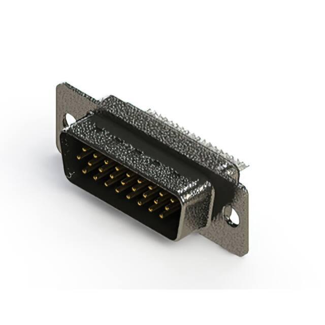

637/638 SERIES D-Sub Connectors: Vertical, High Density Features: • • • • • • • • Plug and receptacle in 15, 26, 44, 62 or 78 contact sizes Pin and socket contact mating design with P.C. tail termination Metal shell provides EMI/RFI shielding, plug shell indents provide grounding and additional mating retention Grounding features include boardlock for exceptional retention to P.C. board Mounting options for panel mount or connector mating include through hole, threaded hole and threaded standoffs D-shaped connector mating outline provides polarization Design based on requirements of MIL-C-24038, EIA RS-232 and RS-449 High profile available in receptacle only Specifications: Insulator Material PBT with glass fiber, UL 94V-0, color: Black Contact Material Plug (pin): Brass Receptacle (socket): Brass or phosphor bronze Contact Plating Selective gold (see ordering code) over nickel for the mating area, tin plating for tail area Shell Material Nickel plated steel (optional tin plating) Current Rating 3 amps Contact Resistance 15 milliohms maximum Insulation Resistance 1000 megaohms minimum Dielectric Withstanding Voltage 500 V AC rms at Sea Level Operating Temperature -55°C To +85°C (upto +125°C for high temp) Insertion Force 16 oz (4.45 N) Maximum Per Contact Position Withdrawal Force 1 oz (0.28 N) Minimum Per Contact Position Ordering Code: www.edac.net Contact P/N: 638-292-271 "Wire Gauge (AWG): 24 - 26 Contact P/N: 637-292-271 Wire Gauge (AWG): 24 - 26 customerservice@edac.net 637/638 SERIES D-Sub Connectors: Vertical, High Density PLUG 637 SERIES STANDARD PROFILE CRIMP TYPE A±0.35 44 5.0 62 PIN 31.75 2.99 21 42 62 1.785 0.625 Ø1.05-62 HOLES 16.66 1 10 2-Ø3.05 23.52 Ø1.05-44 HOLES 12.50 2.29 Ø1.05-26 HOLES 30 44 1.655 12.50 2.50 15 5 10 1 6 3.96 2.80 0.635 26 1.655 0.635 6.10±0.35 15 PIN 23.52 31 9 18 19 44 PIN 1 16 16.00±0.35 2.29 2.80 15 11 1.40 0.89 2-Ø3.05 78 CONTACT 2.29 3.96 43 2.41 15~62 CONTACT 26 PIN 16.66 3.96 31.75 1 22 4.8±0.5 5.6 MAX 10°-2 15.40±0.25 31 6.10±0.35 Ø3.20 REF 30 4.0 REF 12.60±0.25 15 3.96 8.48±0.15 1 16 16.00±0.35 0.9 6.00 6.10±0.35 3.96 C±0.15 2-#4-40UNC 12.60±0.25 B±0.10 Ø1.05-15 HOLES RECEPTACLE 638 SERIES STANDARD PROFILE CRIMP TYPE A±0.35 C±0.15 0.9 6.0 30 31 44 5.6 MAX 10°-2 62 PIN 16.66 2.29 22 Ø1.05-62 HOLES 1 18 26 43 0.625 2.80 9 3.96 3.96 16.66 1 1.785 1.655 12.50 2.29 2.80 1 30 44 1.655 0.635 16 31 NUMBER OF CONTACTS 5 11 15 1.40 Ø1.05-44 HOLES www.edac.net 19 Ø1.05-26 HOLES 15 PIN 23.52 3.96 3.96 15 0.635 16.00±0.35 6.00±0.35 10 2-Ø3.05 44 PIN 23.52 2.29 15~62 CONTACT 15.40±0.25 31.75 2.99 21 42 62 4.8±0.5 26 PIN 31.75 2.41 6.00±0.35 Ø3.20 REF 1 16 15 16.00±0.35 4.0 1.6 12.60±0.25 6.10±0.35 3.96 7.90±0.15 2-#4-40UNC 12.60±0.25 B±0.10 78 CONTACT 12.50 2.54 Ø1.05-15 HOLES 1 6 11 0.89 2-Ø3.05 A Inch B (mm) C PLUG Inch (mm) Inch (mm) C RECEPTACLE Inch (mm) 15 1.213 (30.80) .984 (24.99) .666 (16.92) .642 (16.30) 26 1.541 (39.15) 1.312 (33.32) .994 (25.25) .970 (24.65) 44 2.087 (53.00) 1.852 (47.04) 1.534 (38.96) 1.512 (38.40) 62 2.728 (69.30) 2.500 (63.50) 2.182 (55.42) 2.157 (54.80) customerservice@edac.net 637/638 SERIES D-Sub Connectors: Vertical, High Density 78 PIN STANDARD PROFILE PLUG 637 SERIES 2-Ø3.20 6.24 2.08 15.40±0.38 Ø3.05 61.10 2.42 2.08 67.00±0.38 61.10±0.25 52.80±0.13 11.30±0.13 78-Ø1.10 2.420 2.08 6.24 13.42±0.25 0.60 4.50±0.38 0.5 MAX 1.0 MAX 6.10±0.25 11.00±0.25 RECOMMENDED PCB LAYOUT RECEPTACLE 638 SERIES 67.00±0.38 61.10±0.25 52.20±0.13 2.08 61.10 2.42 2-Ø3.20 6.24 2.08 15.40±0.38 Ø3.05 10.90±0.13 78-Ø1.10 2.420 www.edac.net 4.50±0.38 0.5 MAX 1.0 MAX 6.00±0.25 10.90±0.25 RECOMMENDED PCB LAYOUT 0.60 2.08 6.24 13.42±0.25 customerservice@edac.net 637/638 SERIES D-Sub Connectors: Vertical, High Density RECEPTACLE 638 SERIES HIGH PROFILE A±0.30 B±0.10 2 X #4-40 UNC 7.90±0.15 78S=10.90±0.15 C±0.15 1 78S=15.4±0.3 12.6±0.3 Ø0.7±0.05 D±0.25 www.edac.net NUMBER OF CONTACTS Inch (mm) 15 1.213 26 1.543 44 62 78 15S=2.29 26S=2.29 PITCH 44S=2.29 62S=2.41 78S=2.41 A 4.10 5.4±0.25 9.4±0.3 11.0±0.20 0.9 5.8±0.2 10°±1.5°-2 3.96±0.1 10.9±0.2 C B D Inch (mm) Inch (mm) (30.80) .984 (24.99) .643 (39.20) 1.312 (33.32) .972 2.087 (53.00) 1.852 2.732 (69.40) 2.500 2.638 (67.00) 2.406 Inch (mm) (16.34) .756 (19.20) (24.70) 1.091 (27.70) (47.04) 1.512 (38.40) 1.618 (41.10) (63.50) 2.157 (54.80) 2.256 (57.30) (61.10) 2.055 (52.20) 2.169 (55.10) customerservice@edac.net

物料型号:637系列为插头(PIN),638系列为插座(SOCKET)。
器件简介:这些连接器具有多种接触尺寸(15、26、44、62或78接触点),并采用金属壳体提供EMI/RFI屏蔽。
引脚分配:文档提供了不同接触点(15、26、44、62、78)的详细尺寸和布局。
参数特性:包括绝缘材料、接触材料、接触镀层、壳体材料、电流额定值、接触电阻、绝缘电阻、耐电压、工作温度范围、插入力和拔出力。
功能详解:文档描述了连接器的设计特点,如极化设计、基于MIL-C-24038、EIA RS-232和RS-449的要求。
应用信息:适用于需要高密度垂直连接器的应用场合。
封装信息:提供了标准轮廓和高轮廓的选项,以及多种安装选项,包括通孔、螺纹孔和螺纹支架。
订购代码示例:637-015-230-047,包括系列、接触完成代码、终止方式、接触代码、绝缘体样式和法兰安装选项。
