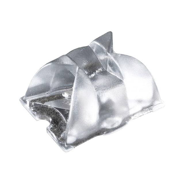

CA13474_STRADA-A2 数据手册
PRODUCT DATASHEET CA13474_STRADA-A2 STRADA-A2 Symmetric IESNA Type I (medium) beam for narrow roads and paths with long pole distance and tilted armature. Optimized for CREE XT-E. Assembly with installation tape. SPECIFICATION: Dimensions 19.6 x 15.5 mm Height 10.5 mm Fastening tape, pin ROHS compliant yes MATERIALS: Component Type Material Colour STRADA-A2 Single lens PMMA clear VOSU-WU-M-365-TAPE Tape Acrylic foam Finish ORDERING INFORMATION: Component CA13474_STRADA-A2 » Box size: Qty in box MOQ MPQ Single lens Last update: 08/11/2023 Subject to change without prior notice LEDiL is a registered trademark of LEDiL Oy in the European Union, USA, and certain other countries. Box weight (kg) 6.3 1/6 PRODUCT DATASHEET CA13474_STRADA-A2 See also our general installation guide: www.ledil.com/installation_guide Last update: 08/11/2023 Subject to change without prior notice LEDiL is a registered trademark of LEDiL Oy in the European Union, USA, and certain other countries. 2/6 PRODUCT DATASHEET CA13474_STRADA-A2 OPTICAL RESULTS (MEASURED): LED XP-G2 FWHM / FWTM 141.0 + 41.0° Efficiency 88 % Peak intensity 0.9 cd/lm LEDs/each optic 1 Light colour White Required components: LED XT-E FWHM / FWTM 141.0 + 41.0° Efficiency 87 % Peak intensity 0.9 cd/lm LEDs/each optic 1 Light colour White Required components: LED NVSW219D FWHM / FWTM 140.0 + 43.0° / 178.0 + 142.0° Efficiency 90 % Peak intensity 0.9 cd/lm LEDs/each optic 1 Light colour White Required components: LED NVSW319B FWHM / FWTM 146.0 + 43.0° / 179.0 + 155.0° Efficiency 90 % Peak intensity 0.8 cd/lm LEDs/each optic 1 Light colour White Required components: Last update: 08/11/2023 Subject to change without prior notice LEDiL is a registered trademark of LEDiL Oy in the European Union, USA, and certain other countries. 3/6 PRODUCT DATASHEET CA13474_STRADA-A2 OPTICAL RESULTS (MEASURED): LED LH351Z FWHM / FWTM 133.0 + 38.0° Efficiency 91 % Peak intensity 1.1 cd/lm LEDs/each optic 1 Light colour White Required components: Last update: 08/11/2023 Subject to change without prior notice LEDiL is a registered trademark of LEDiL Oy in the European Union, USA, and certain other countries. 4/6 PRODUCT DATASHEET CA13474_STRADA-A2 OPTICAL RESULTS (SIMULATED): LED LUXEON Rebel Plus FWHM / FWTM 129.0 + 31.0° / 163.0 + 49.0° Efficiency 93 % Peak intensity 1.7 cd/lm LEDs/each optic 1 Light colour White Required components: LED OSCONIQ P 3737 (3W version) FWHM / FWTM 134.0 + 38.0° / 62.0 + 37.0° Efficiency 92 % Peak intensity 1.1 cd/lm LEDs/each optic 1 Light colour White Required components: Last update: 08/11/2023 Subject to change without prior notice LEDiL is a registered trademark of LEDiL Oy in the European Union, USA, and certain other countries. 5/6 PRODUCT DATASHEET CA13474_STRADA-A2 GENERAL INFORMATION: NOTE: The typical beam angle will be changed by different color, chip size and chip position tolerance. The typical total beam angle is the full angle measured where the luminous intensity is half of the peak value. MATERIALS: As part of our continuous research and improvement processes, and to ensure the best possible quality and availability of our products, LEDiL reserves the right to change material grades without notice. PRODUCT DATA USER AGREEMENT AND DISCLAIMER: The measured data in the provided downloadable LEDiL Product Datasheets and Mechanical 2D-Drawings is rounded and provided as reference for planning. LEDiL Oy's optical specifications have been verified by conducting performance testing of the products in accordance with the company's quality system. The reported data are averaged results of multiple measurements with typical variation. LEDiL Oy reserves the right to without prior notification make changes and improvements to its products. LEDiL Oy assumes neither warranty, nor guarantee nor any other liability of any kind for the contents and correctness of the provided data. The provided data has been generated with highest diligence but the provided data may in reality not represent the complete possible variation range of all intrinsic parameters. Therefore, in certain cases a deviation from the provided data could occur. LEDiL Oy Joensuunkatu 13 FI-24240 SALO Finland LEDiL Inc. 228 West Page Street Suite D Sycamore IL 60178 USA Ledil Optics Technology (Shenzhen) Co., Ltd. # 405 , Block B Casic Motor Building Shenzhen 518057 P.R.CHINA Local sales and technical support www.ledil.com/ where_to_buy Shipping locations Salo, Finland Hong Kong, China Distribution Partners www.ledil.com/ where_to_buy LEDiL Oy reserves the right to undertake technical changes of its products without further notification which could lead to changes in the provided data. LEDiL Oy assumes no liability of any kind for the possible deviation from any provided data or any other damage resulting from the usage of the provided data. The user agrees to this disclaimer and user agreement with the download or usage of the provided files. Last update: 08/11/2023 Subject to change without prior notice LEDiL is a registered trademark of LEDiL Oy in the European Union, USA, and certain other countries. 6/6
