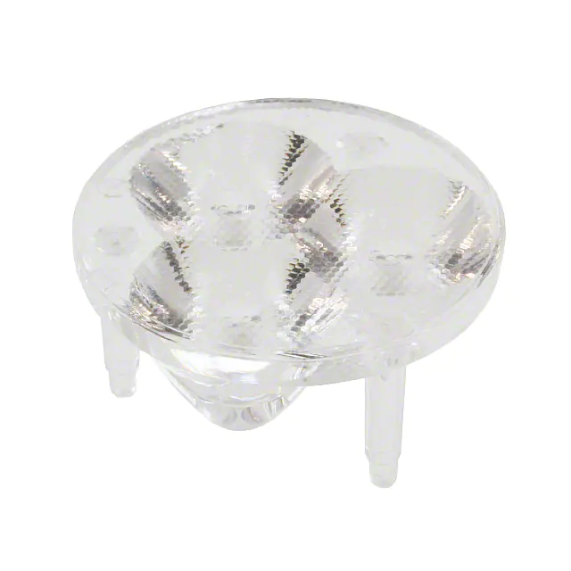

    Lens with Integrated Mount Clear 21° Spot INTEMATIX C3535 Adhesive, Position Pins
C10754_CUTE-3-SS 数据手册
PRODUCT DATASHEET C10754_CUTE-3-SS CUTE-3-SS ~12° smooth spot beam with 3 mm high location pins SPECIFICATION: Dimensions Height Fastening ROHS compliant Ø 35.0 mm 15 mm glue, pin yes MATERIALS: Component Type Material Colour CUTE-3-SS Multi-lens PMMA clear Finish Length 35.0 ORDERING INFORMATION: Component C10754_CUTE-3-SS » Box size: 480 x 280 x 300 mm Qty in box 630 MOQ MPQ 90 45 Last update: 13/05/2024 Subject to change without prior notice LEDiL is a registered trademark of LEDiL Oy in the European Union, USA, and certain other countries. Box weight (kg) 6.9 1/12 PRODUCT DATASHEET C10754_CUTE-3-SS See also our general installation guide: www.ledil.com/installation_guide Last update: 13/05/2024 Subject to change without prior notice LEDiL is a registered trademark of LEDiL Oy in the European Union, USA, and certain other countries. 2/12 PRODUCT DATASHEET C10754_CUTE-3-SS OPTICAL RESULTS (MEASURED): LED XM-L FWHM / FWTM 19.0° / 38.0° Efficiency 91 % Peak intensity 5.3 cd/lm LEDs/each optic 1 Light colour/type White Required components: LED XM-L2 FWHM / FWTM 20.0° / 37.0° Efficiency 90 % Peak intensity 6.4 cd/lm LEDs/each optic 1 Light colour/type White Required components: LED XP-E FWHM / FWTM 11.0° / 21.0° Efficiency 93 % Peak intensity 15.4 cd/lm LEDs/each optic 1 Light colour/type White Required components: Last update: 13/05/2024 Subject to change without prior notice LEDiL is a registered trademark of LEDiL Oy in the European Union, USA, and certain other countries. 3/12 PRODUCT DATASHEET C10754_CUTE-3-SS OPTICAL RESULTS (MEASURED): LED XP-G FWHM / FWTM 15.0° / 28.0° Efficiency 93 % Peak intensity 9.5 cd/lm LEDs/each optic 1 Light colour/type White Required components: LED XP-G2 FWHM / FWTM 14.0° / 27.0° Efficiency 94 % Peak intensity 10.3 cd/lm LEDs/each optic 1 Light colour/type White Required components: LED XP-G2 HE FWHM / FWTM 17.0° / 33.0° Efficiency 96 % Peak intensity 7.8 cd/lm LEDs/each optic 1 Light colour/type White Required components: Last update: 13/05/2024 Subject to change without prior notice LEDiL is a registered trademark of LEDiL Oy in the European Union, USA, and certain other countries. 4/12 PRODUCT DATASHEET C10754_CUTE-3-SS OPTICAL RESULTS (MEASURED): LED XT-E FWHM / FWTM 12.0° / 28.0° Efficiency 88 % Peak intensity 8.7 cd/lm LEDs/each optic 1 Light colour/type White Required components: LED LUXEON A FWHM / FWTM 13.0° Efficiency 91 % LEDs/each optic 1 Light colour/type White Required components: LED LUXEON Rebel FWHM / FWTM 12.0° / 23.0° Efficiency 91 % Peak intensity 12.2 cd/lm LEDs/each optic 1 Light colour/type White Required components: Last update: 13/05/2024 Subject to change without prior notice LEDiL is a registered trademark of LEDiL Oy in the European Union, USA, and certain other countries. 5/12 PRODUCT DATASHEET C10754_CUTE-3-SS OPTICAL RESULTS (MEASURED): LED LUXEON Rebel ES FWHM / FWTM 13.0° Efficiency 91 % LEDs/each optic 1 Light colour/type White Required components: LED NCSxx19A FWHM / FWTM 12.0° Efficiency 89 % LEDs/each optic 1 Light colour/type White Required components: LED NVSxx19A FWHM / FWTM 13.0° / 29.0° Efficiency 94 % Peak intensity 9.2 cd/lm LEDs/each optic 1 Light colour/type White Required components: Last update: 13/05/2024 Subject to change without prior notice LEDiL is a registered trademark of LEDiL Oy in the European Union, USA, and certain other countries. 6/12 PRODUCT DATASHEET C10754_CUTE-3-SS OPTICAL RESULTS (MEASURED): LED OSLON Square EC FWHM / FWTM 17.0° / 32.0° Efficiency 83 % Peak intensity 8.5 cd/lm LEDs/each optic 1 Light colour/type White Required components: LED OSLON SSL 150 FWHM / FWTM 13.0° Efficiency % LEDs/each optic 1 Light colour/type White Required components: LED OSLON SSL 80 FWHM / FWTM 10.0° / 22.0° Efficiency 90 % Peak intensity 15.2 cd/lm LEDs/each optic 1 Light colour/type White Required components: Last update: 13/05/2024 Subject to change without prior notice LEDiL is a registered trademark of LEDiL Oy in the European Union, USA, and certain other countries. 7/12 PRODUCT DATASHEET C10754_CUTE-3-SS OPTICAL RESULTS (MEASURED): LED Z5 FWHM / FWTM 10.0° Efficiency % LEDs/each optic 1 Light colour/type White Required components: LED Z5M1/Z5M2 FWHM / FWTM 14.0° / 27.0° Efficiency 88 % Peak intensity 11.7 cd/lm LEDs/each optic 1 Light colour/type White Required components: Last update: 13/05/2024 Subject to change without prior notice LEDiL is a registered trademark of LEDiL Oy in the European Union, USA, and certain other countries. 8/12 PRODUCT DATASHEET C10754_CUTE-3-SS OPTICAL RESULTS (SIMULATED): LED XM-L HVW FWHM / FWTM 19.0° Efficiency % LEDs/each optic 1 Light colour/type White Required components: LED XP-E2 FWHM / FWTM 10.0° / 21.0° Efficiency 95 % Peak intensity 19.1 cd/lm LEDs/each optic 1 Light colour/type White Required components: LED XP-G2 FWHM / FWTM 14.0° / 26.0° Efficiency 94 % Peak intensity 11.8 cd/lm LEDs/each optic 1 Light colour/type White Required components: Last update: 13/05/2024 Subject to change without prior notice LEDiL is a registered trademark of LEDiL Oy in the European Union, USA, and certain other countries. 9/12 PRODUCT DATASHEET C10754_CUTE-3-SS OPTICAL RESULTS (SIMULATED): LED XP-G2 HE FWHM / FWTM 16.0° / 32.0° Efficiency 96 % Peak intensity 8.1 cd/lm LEDs/each optic 1 Light colour/type White Required components: LED XP-G3 FWHM / FWTM 16.0° / 32.0° Efficiency 91 % Peak intensity 8 cd/lm LEDs/each optic 1 Light colour/type White Required components: LED XT-E HVW FWHM / FWTM 15.0° Efficiency % LEDs/each optic 1 Light colour/type White Required components: Last update: 13/05/2024 Subject to change without prior notice LEDiL is a registered trademark of LEDiL Oy in the European Union, USA, and certain other countries. 10/12 PRODUCT DATASHEET C10754_CUTE-3-SS OPTICAL RESULTS (SIMULATED): LED LUXEON IR Domed 60 (L1I0-0xxx060000000) FWHM / FWTM 13.0° / 29.0° Efficiency 94 % Peak intensity 10.2 cd/lm LEDs/each optic 1 Light colour/type IR Required components: LED LH351B FWHM / FWTM 16.0° / 30.0° Efficiency 95 % Peak intensity 8.8 cd/lm LEDs/each optic 1 Light colour/type White Required components: LED LH351C FWHM / FWTM 16.0° / 32.0° Efficiency 96 % Peak intensity 8.5 cd/lm LEDs/each optic 1 Light colour/type White Required components: Last update: 13/05/2024 Subject to change without prior notice LEDiL is a registered trademark of LEDiL Oy in the European Union, USA, and certain other countries. 11/12 PRODUCT DATASHEET C10754_CUTE-3-SS GENERAL INFORMATION: NOTE: The typical beam angle will be changed by different color, chip size and chip position tolerance. The typical total beam angle is the full angle measured where the luminous intensity is half of the peak value. MATERIALS: As part of our continuous research and improvement processes, and to ensure the best possible quality and availability of our products, LEDiL reserves the right to change material grades without notice. PRODUCT DATA USER AGREEMENT AND DISCLAIMER: The measured data in the provided downloadable LEDiL Product Datasheets and Mechanical 2D-Drawings is rounded and provided as reference for planning. LEDiL Oy's optical specifications have been verified by conducting performance testing of the products in accordance with the company's quality system. The reported data are averaged results of multiple measurements with typical variation. LEDiL Oy reserves the right to without prior notification make changes and improvements to its products. LEDiL Oy assumes neither warranty, nor guarantee nor any other liability of any kind for the contents and correctness of the provided data. The provided data has been generated with highest diligence but the provided data may in reality not represent the complete possible variation range of all intrinsic parameters. Therefore, in certain cases a deviation from the provided data could occur. LEDiL Oy Joensuunkatu 13 FI-24240 SALO Finland LEDiL Inc. 228 West Page Street Suite D Sycamore IL 60178 USA Ledil Optics Technology (Shenzhen) Co., Ltd. # 405 , Block B Casic Motor Building Shenzhen 518057 P.R.CHINA Local sales and technical support www.ledil.com/ where_to_buy Shipping locations Poznan, Poland Hong Kong, China Distribution Partners www.ledil.com/ where_to_buy LEDiL Oy reserves the right to undertake technical changes of its products without further notification which could lead to changes in the provided data. LEDiL Oy assumes no liability of any kind for the possible deviation from any provided data or any other damage resulting from the usage of the provided data. The user agrees to this disclaimer and user agreement with the download or usage of the provided files. Last update: 13/05/2024 Subject to change without prior notice LEDiL is a registered trademark of LEDiL Oy in the European Union, USA, and certain other countries. 12/12
