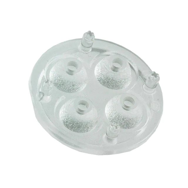

    LENS FOR CREE XP-E/C/G 4 UP
C10923_GT4-W 数据手册
PRODUCT DATASHEET C10923_GT4-W GT4-W ~40° wide beam SPECIFICATION: Dimensions Height Fastening ROHS compliant Ø 35.0 mm 9 mm glue, pin yes MATERIALS: Component Type Material Colour GT4-W Multi-lens PMMA clear Finish Length 35.0 ORDERING INFORMATION: Component C10923_GT4-W » Box size: 300 x 250 x 250 mm Qty in box 864 MOQ MPQ 144 144 Last update: 13/05/2024 Subject to change without prior notice LEDiL is a registered trademark of LEDiL Oy in the European Union, USA, and certain other countries. Box weight (kg) 4.7 1/7 PRODUCT DATASHEET C10923_GT4-W See also our general installation guide: www.ledil.com/installation_guide Last update: 13/05/2024 Subject to change without prior notice LEDiL is a registered trademark of LEDiL Oy in the European Union, USA, and certain other countries. 2/7 PRODUCT DATASHEET C10923_GT4-W OPTICAL RESULTS (MEASURED): LED XB-D FWHM / FWTM 36.0° Efficiency 91 % Peak intensity 1.6 cd/lm LEDs/each optic 1 Light colour/type White Required components: LED XP-E FWHM / FWTM 37.0° / 67.0° Efficiency 87 % Peak intensity 1.7 cd/lm LEDs/each optic 1 Light colour/type White Required components: LED XP-G FWHM / FWTM 45.0° / 76.0° Efficiency 87 % Peak intensity 1.2 cd/lm LEDs/each optic 1 Light colour/type White Required components: Last update: 13/05/2024 Subject to change without prior notice LEDiL is a registered trademark of LEDiL Oy in the European Union, USA, and certain other countries. 3/7 PRODUCT DATASHEET C10923_GT4-W OPTICAL RESULTS (MEASURED): LED LUXEON A FWHM / FWTM 41.0° / 74.0° Efficiency % LEDs/each optic 1 Light colour/type White Required components: LED LUXEON Rebel ES FWHM / FWTM 33.0° / 60.0° Efficiency 89 % Peak intensity 2 cd/lm LEDs/each optic 1 Light colour/type White Required components: LED OSLON SSL 150 FWHM / FWTM 36.0° / 63.0° Efficiency 87 % Peak intensity 1.8 cd/lm LEDs/each optic 1 Light colour/type White Required components: Last update: 13/05/2024 Subject to change without prior notice LEDiL is a registered trademark of LEDiL Oy in the European Union, USA, and certain other countries. 4/7 PRODUCT DATASHEET C10923_GT4-W OPTICAL RESULTS (MEASURED): LED OSLON SSL 80 FWHM / FWTM 33.0° / 66.0° Efficiency 91 % Peak intensity 1.7 cd/lm LEDs/each optic 1 Light colour/type White Required components: LED Double Dome (GM2BB) FWHM / FWTM 42.0° Efficiency % LEDs/each optic 1 Light colour/type White Required components: Last update: 13/05/2024 Subject to change without prior notice LEDiL is a registered trademark of LEDiL Oy in the European Union, USA, and certain other countries. 5/7 PRODUCT DATASHEET C10923_GT4-W OPTICAL RESULTS (SIMULATED): LED Synios P2720 1/4 mm FWHM / FWTM 33.0° / 67.0° Efficiency 94 % Peak intensity 2.1 cd/lm LEDs/each optic 1 Light colour/type White Required components: LED Z5 FWHM / FWTM 36.0° Efficiency % LEDs/each optic 1 Light colour/type White Required components: Last update: 13/05/2024 Subject to change without prior notice LEDiL is a registered trademark of LEDiL Oy in the European Union, USA, and certain other countries. 6/7 PRODUCT DATASHEET C10923_GT4-W GENERAL INFORMATION: NOTE: The typical beam angle will be changed by different color, chip size and chip position tolerance. The typical total beam angle is the full angle measured where the luminous intensity is half of the peak value. MATERIALS: As part of our continuous research and improvement processes, and to ensure the best possible quality and availability of our products, LEDiL reserves the right to change material grades without notice. PRODUCT DATA USER AGREEMENT AND DISCLAIMER: The measured data in the provided downloadable LEDiL Product Datasheets and Mechanical 2D-Drawings is rounded and provided as reference for planning. LEDiL Oy's optical specifications have been verified by conducting performance testing of the products in accordance with the company's quality system. The reported data are averaged results of multiple measurements with typical variation. LEDiL Oy reserves the right to without prior notification make changes and improvements to its products. LEDiL Oy assumes neither warranty, nor guarantee nor any other liability of any kind for the contents and correctness of the provided data. The provided data has been generated with highest diligence but the provided data may in reality not represent the complete possible variation range of all intrinsic parameters. Therefore, in certain cases a deviation from the provided data could occur. LEDiL Oy Joensuunkatu 13 FI-24240 SALO Finland LEDiL Inc. 228 West Page Street Suite D Sycamore IL 60178 USA Ledil Optics Technology (Shenzhen) Co., Ltd. # 405 , Block B Casic Motor Building Shenzhen 518057 P.R.CHINA Local sales and technical support www.ledil.com/ where_to_buy Shipping locations Poznan, Poland Hong Kong, China Distribution Partners www.ledil.com/ where_to_buy LEDiL Oy reserves the right to undertake technical changes of its products without further notification which could lead to changes in the provided data. LEDiL Oy assumes no liability of any kind for the possible deviation from any provided data or any other damage resulting from the usage of the provided data. The user agrees to this disclaimer and user agreement with the download or usage of the provided files. Last update: 13/05/2024 Subject to change without prior notice LEDiL is a registered trademark of LEDiL Oy in the European Union, USA, and certain other countries. 7/7
