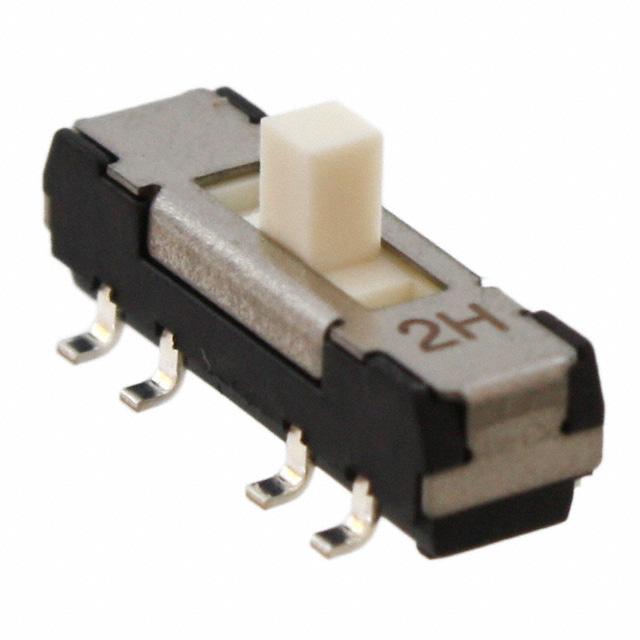

    滑动开关 SMD 双刀三掷 立贴
CL-SB-23B-01T 数据手册
CL-SB SLIDE SWITCHES CL-SB内部構造図.eps RoHS compliant INTERNAL STRUCTURE 2 3 1 6 4 5 Part name ■ FEATURES ● Wide variety (circuit composition, operating direction, terminal shape: J-hook, Gull wing, Through hole pins) ● Standardization of the silver contacts as well as gold contacts ● Stroke is 2mm ● Using heat-resistant resin to support reflow soldering mounting ● Adopted Twin-contacts mechanism Material Flammability ① Cover Stainless steel (SUS 304) — ② Slider Polyamido UL94V-0 ③ Housing Polyphenylenesulphide UL94V-0 ④ Moving contact Copper alloy, gold or silver plate — ⑤ Fixed contact Copper alloy, gold or silver plate — ⑥ Terminal pin Copper alloy, gold or silver plate — ■ PART NUMBER DESIGNATION CL - SB - 2 3 B - 0 2 T Series name Form of packaging T : Taping Blank : Bulk in plastic bag No. of poles 1:1 pole 2:2 poles Contact material No. of positions 1:Silver   2:Gold 2:2 positions 3:3 positions Setting position Shape of terminal A:J-hook B:Gull wing C:Through hole pins C1:PC terminals with one on the operation side and others on the opposite side ※1 C4:Terminals aligned laterally on one side ※1 ※1: Please check the following LIST OF PART NUMBERS. ※ Please refer to the LIST OF PART NUMBERS when placing orders. 0:Top setting 1:Side setting CL-SB SLIDE SWITCHES ■LIST OF PART NUMBERS Setting position No. of poles No. of positions 2 1 3 Top setting 2 2 3 2 1 3 Side Setting 2 2 3 1 2 Oontact material Silver Gold CL-SB-12A-01T CL-SB-12A-02T CL-SB-12A-01 CL-SB-12A-02 CL-SB-12B-01T CL-SB-12B-02T CL-SB-12B-01 CL-SB-12B-02 CL-SB-12C-01 CL-SB-12C-02 CL-SB-13A-01T CL-SB-13A-02T CL-SB-13A-01 CL-SB-13A-02 CL-SB-13B-01T CL-SB-13B-02T CL-SB-13B-01 CL-SB-13B-02 CL-SB-13C-01 CL-SB-13C-02 CL-SB-22A-01T CL-SB-22A-02T CL-SB-22A-01 CL-SB-22A-02 CL-SB-22B-01T CL-SB-22B-02T CL-SB-22B-01 CL-SB-22B-02 CL-SB-22C-01 CL-SB-22C-02 CL-SB-23A-01T CL-SB-23A-02T CL-SB-23A-01 CL-SB-23A-02 CL-SB-23B-01T CL-SB-23B-02T CL-SB-23B-01 CL-SB-23B-02 CL-SB-23C-01 CL-SB-23C-02 CL-SB-12A-11T CL-SB-12A-12T CL-SB-12A-11 CL-SB-12A-12 CL-SB-12B-11T CL-SB-12B-12T CL-SB-12B-11 CL-SB-12B-12 CL-SB-12C-11 CL-SB-12C-12 CL-SB-13A-11T CL-SB-13A-12T CL-SB-13A-11 CL-SB-13A-12 CL-SB-13B-11T CL-SB-13B-12T CL-SB-13B-11 CL-SB-13B-12 CL-SB-13C-11 CL-SB-13C-12 CL-SB-22A-11T CL-SB-22A-12T CL-SB-22A-11 CL-SB-22A-12 CL-SB-22B-11T CL-SB-22B-12T CL-SB-22B-11 CL-SB-22B-12 CL-SB-22C-11 CL-SB-22C-12 CL-SB-23A-11T CL-SB-23A-12T CL-SB-23A-11 CL-SB-23A-12 CL-SB-23B-11T CL-SB-23B-12T CL-SB-23B-11 CL-SB-23B-12 CL-SB-23C-11 CL-SB-23C-12 CL-SB-12C1-11 ー CL-SB-12C4-11 ー ※Verify the above part numbers when placing orders. Taping version can be supplied only in reel unit. Shape of terminal A(J-hook) B(Gull wing) C(Through hole pins) A(J-hook) B(Gull wing) C(Through hole pins) A(J-hook) B(Gull wing) C(Through hole pins) A(J-hook) B(Gull wing) C(Through hole pins) A(J-hook) B(Gull wing) C(Through hole pins) A(J-hook) Form of packaging Pieces in package Taping 500pcs. / reel Plastic bag 50pcs. / pack Taping 500pcs. / reel Plastic bag 50pcs. / pack Plastic bag 50pcs. / pack Taping 500pcs. / reel Plastic bag 50pcs. / pack Taping 500pcs. / reel Plastic bag 50pcs. / pack Plastic bag 50pcs. / pack Taping 500pcs. / reel Plastic bag 50pcs. / pack Taping 500pcs. / reel Plastic bag 50pcs. / pack Plastic bag 50pcs. / pack Taping 500pcs. / reel Plastic bag 50pcs. / pack Taping 500pcs. / reel Plastic bag 50pcs. / pack Plastic bag 50pcs. / pack Taping 500pcs. / reel Plastic bag 50pcs. / pack Taping 500pcs. / reel Plastic bag 50pcs. / pack Plastic bag 50pcs. / pack Taping 500pc s. / reel Plastic bag 50pcs. / pack Taping 500pcs. / reel Plastic bag 50pcs. / pack Plastic bag 50pcs. / pack Taping 500pcs. / reel Plastic bag 50pcs. / pack Taping 500pcs. / reel Plastic bag 50pcs. / pack Plastic bag 50pcs. / pack Taping 500pcs. / reel Plastic bag 50pcs. / pack Taping 500pcs. / reel Plastic bag 50pcs. / pack C(Through hole pins) Plastic bag 50pcs. / pack C1(Through hole pins) C4(Through hole pins) Plastic bag 50pcs. / pack Plastic bag 50pcs. / pack B(Gull wing) C(Through hole pins) A(J-hook) B(Gull wing) C(Through hole pins) A(J-hook) B(Gull wing) CL-SB SLIDE SWITCHES ■ STANDARD SPECIFICATIONS Operating temperature range ■ ELECTRICAL CHARACTERISTICS Contact rating Non-switching Switching Minimum −40 ~ 85 °C Storage temperature range Sealing      Non- Washable * * 0.21 g (CL-SB-12 -0 ) 0.22 g (CL-SB-22*-0*) 0.26 g (CL-SB-13*-0*) 0.28 g (CL-SB-23*-0*) 0.21 g (CL-SB-12C1-11) Net weight DC50 V 200 mA DC12 V 200 mA DC20 mV 1 μA (Gold contacts) DC5 V 10 mA (Silver contacts) * * 0.21 g (CL-SB-12 -1 ) 0.23 g (CL-SB-22*-1*) 0.27 g (CL-SB-13*-1*) 0.29 g (CL-SB-23*-1*) 0.19 g (CL-SB-12C4-11) Contact timing Non-shorting    70mΩ maximum (Gold contacts)  50mΩ maximum (Silver contacts) Contact resistance ■ MECHANICAL CHARACTERISTICS No. of positions Stroke Insulation resistance 2, 3 Operation force   A→B / C→B      ※ 2 3 Contacts 1.5 ± 1.0 N {0.153 ± 0.102kgf} (CL-SB-*3*-**)   B→A / B→C 2.5 ± 1.5 N {0.255 ± 0.153kgf} Stop strength 20 N {2.04 kgf} 15 s Solderability 245 ± 3 °C, 2 ~ 3 s AC500 V, 60 s Dielectric strength ■ ENVIRONMENTAL CHARACTERISTICS Substrate bending Pull-off strength A B C 10000 cycles, DC12 ± 0.5V, 200 ± 10mA Humidity 40 °C, Relative humidity 90 ~ 95 %, 240 h,  No load High temperature exposure 85 °C, 96 h, No load Manual soldering:350 ± 10 °C, 3 ~ 4 s Low temperature exposure −40 °C, 96 h, No load Width 90 mm, bend 3 mm, 5 s, 1 time ※1 A B 5 N {0.51 kgf} 10s Thermal shock −40 (0.5 h) ~ 85 °C ( 0.5 h ), 5 cycles Reflow profile for soldering heat evaluation〉 { } : Reference only ※ 2 ※2 A B C (℃) 250 Peak : 250 0 ℃ 200 Pre Heating Zone +5 Over 230 ℃ Temperature A B Load life Flow : 260 ± 3 °C, 5 ~ 6 s 5 N {0.51 kgf} 10 s Shear 490 m/s2, 11 ms 6 directions for 3 times each Shock (Please refer to the profile below) Soldering heat (Amplitude) 1.5 mm or (Acceleration) 98 m/s2, 10-500-10 Hz, 3 directions for 2 h each Vibration Reflow:255 °C (Peak temperature) ※2 100 MΩ minimum (DC500 V) 2 mm 2 Contacts   A ⇔ B        ※ 1 (CL-SB-*2*-**)  1.5 ± 1.0 N {0.153 ± 0.102kgf} ※ 1 ※1 1.5 mA 1 kHz 20 mV maximum 150 100 50 180 ℃ 150 ℃ 90±30 s 30±10 s Heating time Soldering Zone Reflow : two times maximum 4_5-6p 4_5-6p 4_5-6p CL-SB SLIDE SWITCHES ■ OUTLINE DIMESIONS Unless otherwise specified, tolerance: ± 0.3 (Unit: mm) ● CL-SB-12B-01 ● CL-SB-12B-02 8.5 1 3 1 0.8 2 1.5 6.8 3.5 1 2 c 4 5 0.6 2.5 1.5 2 0.6 2.5 8.5 c 4 1 8.5 Travel 2 1.5 6 2 3 5 6 2 3 cc 4 c c 5 Production date code 1 2 c Travel 2 2 23.5 c 5 23.5 3.52 3 3.5 3.5 3 3.5 3 6 1.5 1 2 23.5 0.4min 1.5 2.5 2.5 0.4min 0.4min 2.5 2.5 2.5 Terminal No.① Terminal No.① 6 2 3 5 6 1 2 3 Production date c code Schematic c 4 5 6 Production1.5 date code 1 2 3 c Schematic 1.5 Production date code 2 1.5 0.25 0.6 2.5 2.5 3.3 0.6 2.5 3.3 2.5 5 cc 4 Travel 1.5 0.25 0.25 3 3.5 0.25 Schematic 2 1.5 c 1 Travel 1.5 0.6 2.5 0.25 3.3 4 28.5 3 c 2.5 3.5 3.3 3.3 Travel 1.5 Schematic 0.4min 2 0.6 2.5 ● CL-SB-22C-01 8.5 ● CL-SB-22C-02 3 c 2.5 Production date code 0.6 2.5 3.5 2 3 6 0.6 2.5 2.5 0.4min 0.4min 2.5 2.5 c 4 1 5 6 2 3 5 6 2 3 cc 4 Terminal No.① 2.5 0.6 2.5 Travel 3 1 Travel 5 2 2 c 5 6 2 3 5 6 cc 4 Schematic 1 2 3 Production date code c Schematic Travel 8.5 6 Production date code 2 1.5 c 1 8.5 Schematic 4 c 4 c Production date code 8.5 6 0.25 3.3 8.5 Schematic 1 Schematic 3.5 3.5 2.5 1.5 2.5 1.5 2.5 5 4 8.5 Production date code Schematic 4 3 1 2.5 3 Production date code 8.5 Schematic 8.5 Schematic 1 8.5 5 2 cc 4 Travel 2 Terminal No.① 1.5 6 Travel Terminal No.① 0.25 3.5 2.5 5 Production date code Terminal No.①1.5 0.6 2.5 2.5 Terminal No.① Schematic 2 2 2.5 0.25 1.5 1.5 Terminal No.① Production date code 3.5 0.25 23.5 3.5 2.5 0.6 2.5 Terminal No.① 1 1.5 Travel 0.4min 2.5 c 4 8.5 Travel 2 1.5 1.5 Production date code Terminal No.① Travel 2 0.6 1.5 2.5 2.5 0.4min 2.5 ● CL-SB-22B-01 8.5 ● CL-SB-22B-02 6 1 2 3 1.5 c Schematic 2 3.5 3.5 3 Schematic 2 c c 2Schematic 3.5 1.5 0.4min 0.25 1 c Production date code 3 Travel 3.5 6 2 c Production1 date 2 3 code 1.5 CO.20.4min φ0.8 8.5 Production date code 1.5 Terminal No.① 8.5 Travel 2 23.5 3.5 2 5 1 Schematic Schematic Production date code 3 3.5 3 0.6 2.5 6.8 0.25 3.3 2.5 1 3.5 0.25 3.3 0.6 2.5 3.5 3 2 2 0.6 3 1.5 3 Schematic 3.5 3.5 6 cc 4 Travel 2 3.50.8 0.25 0.8 5 2.5 φ0.8 Schematic 2 Terminal No.① 1.5 Terminal No.① Schematic 3.5 2 0.25 3.3 8.5 Production date code 3.5 1 3.5 3.5 2 3.5 c 4 2 φ0.8 Terminal No.① 1.5 8.5 Travel 1.5 2 c 0.6 Travel CO.20.4min 2.5 2.5 2 2.5 2.5 φ0.8 2 3.5 1.5 6.8 0.6 CO.20.4min 2.5 2.5 2.5 2.5 φ0.8 6.8 3.5 CO.2 φ0.8 8.5 8.5 ● CL-SB-22A-01 ● CL-SB-22A-02 Terminal No.① 1.5 1.5 6.8 φ0.8 0.8 2 2 1.5 3.5 2.5 0.8 0.6 2.5 2.5 φ0.8 2 1.5 0.25 0.25 2.5 1.5 Terminal No.① 1.5 3.5 2.5 0.8 3.5 φ0.8 6.8 2 1.5 Production code 2 date3.5 0.6Travel CO.2 2.5 2 2.5 φ0.8 1.5 6.8 0.6 CO.2 2.5 2.5 Terminal No.① 2.5 c Travel 1.5 3.5 1.5 φ0.8 2.5 Production 1date 2 3 code Travel Travel 2 3.50.8 2 3 Production 1date code c Schematic 2 3.5 2 Terminal No.① Terminal No.① 8.5 Travel φ0.8 2.5 Schematic Production date code 8.5 Terminal No.① 3 c 1 Schematic 2.5 ● CL-SB-12C-11 8.5 ● CL-SB-12C-12 Schematic 3 c 2 2.5 0.6 Terminal No.① 0.4min 2.5 8.5 Production date code 1.5 0.4min φ 0.8 1.5 1.5 1.5 2 CO.2 2.5 Travel 1.5 1 0.4min 2.5 ● CL-SB-12B-11 8.5 ● CL-SB-12B-12 3 c 6.8 φ 0.8 0.4min 3 Production date code 2.5 2 φ 0.8 CO.2 2 c 1.5 1.5 1.5 1 0.6 2.5 2.5 Terminal No.① Schematic 8.5 3.52 23.5 0.25 CO.2 φ 0.8 ● CL-SB-12A-11 8.5 ● CL-SB-12A-12 φ 0.8 6.8 0.6 2.5 1 Schematic 2 2.5 6.8 2.5 0.4min 0.25 φ 0.8 φ 0.8 Terminal No.① 1.5 2.5 2.5 0.25 Terminal No.① 1.5 0.4min 3 Production date 1.5 code Travel 1.5 4 2 Travel 2 c 5 6 Production date code 2 3.5 1 2 c 3 Schematic 1.5 0.6 2.5 2.5 CO.2 CO.2 φ 0.8 2 2 0.25 0.8 6.8 φ 0.8 Travel 20.6 1.52.5 2.5 0.25 3.5 φ 0.8 6.8 0.6 2.5 Terminal No.① 1.5 Production date code 0.25 2.5 1.5 1.5 φ 0.8 1.5 Schematic 2 1.5 Travel 28.5 1.5 1 date 2 3 code Production c Travel 0.8 Terminal No.① CO.2 0.25 3.50.8 0.8 2 φ 0.8 0.25 23.5 1.5 Production date code Travel 20.6 1.52.5 2.5 Terminal No.① 1.5 3.50.8 3.52 2 1.5 1 c Production date code Schematic 3.5 3 2 c 1.5 Schematic Travel 8.5 2 0.25 Production1 date code 2 3 Travel 3 3 3 3.5 Travel 8.5 2 2 c Schematic Production date code 3.5 3.5 Production date code Schematic 2 c Schematic 8.5 3.5 3 1 0.25 2 c 3 Schematic 8.5 3.5 1 2 c 0.25 2 c Schematic 8.5 3.5 8.5 8.5 1 1.5 ● CL-SB-12C-01 ● CL-SB-12C-02 .5 ● CL-SB-12A-01 ● CL-SB-12A-02 2 3.5 CL-SB 3.5 1 5 6 2 3 c 8.5 1 Schematic Production date code 6 2 3 c 1 2 1.5 1.5 2 3 c 2 1.5 0.25 3 1.5 Terminal No.① 0.6 2.5 2.5 0.4min 0.4min 2.5 ● CL-SB-22C-11 ● CL-SB-22C-12 6 2 3 c 8.5 1 5 6 2 3 c 8.5 1 2.5 2.5 Terminal No.① 0.6 2.5 2.5 12 1 2 3 4 c 1 2 c 1 2 3.5 Production date code 2 2 Travel 1.5 12 1 2 3 4 Schematic Production date code Travel 2 1.5 Travel 1.5date code Production 2 Terminal No.① 1.5 0.6 2 3 0.6 φ0.8 2 C0.2 0.4min φ0.8 2 2 2 3 2 5 c 1 2 C0.2 0.4min φ0.8 2 5 c 1 2 1 2 2 1 2 c 12 1 2 5 5 6 1 2 3.5 12 c c 3 Terminal No.① 2 c 2 12 C0.2 2.5 0.4min 0.4min 5 6 1 2 12 2.5 c c 2 2 2 2 Terminal No.① 2 2 0.6 2 2 2 12 7 8 2 3.5 3.3 0.25 0.6 3.3 5 6 c 0.25 7 8 1 2 c  3 4 3 4 Schematic c 7 8 5 6 1 2 Travel Terminal No.① 0.4min 2.5 1.5 3.5 1.5 2.5 2 3.5 3.5 2 3 3.5 2 0.4min 2.5 φ0.8 5 3 4 Schematic C0.2 0.25 1.5 2.5 2 3 4 Production date code 3 4 Production date code 2 1.5 Travel 2 3.5 1.5 3.5 0.8 3.5 φ0.8 2 φ0.8 2 2 7 8 c 7 8 Schematic 5 6 1 2 Travel 0.6 3 5 Terminal No.① 0.6 1.5 2 φ0.8 2 c Schematic 3 φ0.8 C0.2 2 1.5 2 3 4 Production date code c 3.5 2 1.5 c Schematic 3 4 12 Schematic c 7 8 5 6 Production 1 2 date   3 4 code c 3 4 Schematic Production date code 3.5 2 3 2 2 0.8 φ0.8 0.6 5 C0.2 2 0.25 3.3 3 4 Production date code 3.5 3 3.5 3.5 φ0.8 2 2 2 Travel 2 1.5 Travel 3.5 2.5 0.6 2 1.5 2.5 1.5 2 2 Production date code 0.25 1.5 2 2 0.8 3.5 c 1 2 2 0.25 3.3 Schematic 0.25 2 2 12 3 4 Production date code 1.5 Travel 2 0.6 Terminal No.① Travel 2 2 0.8 3.5 2.5 2 Schematic Travel 2 2 12 Production date code Terminal No.① 0.6 Terminal No.① ● CL-SB-13C-11 12 ● CL-SB-13C-12 Schematic φ0.8 0.4min 2.5 3 4 Schematic 12 2 2.5 ● CL-SB-13B-11 12 ● CL-SB-13B-12 ● CL-SB-13A-11 12 ● CL-SB-13A-12 Terminal No.① 0.4min 2.5 3 φ0.8 2 0.8 2 5 3.5 2 0.25 Terminal No.① C0.2 φ0.8 2 2 3 1.5 0.25 2 2 5 0.8 3.5 3.5 2 0.25 0.6 φ0.8 C0.2 φ0.8 2 0.25 0.8 3.5 3.5 2 2 3 0.8 Terminal No.① 0.6 φ0.8 2 1.5 1.5 1.5 1.5 2 2 2 2 1.5 Production date code 3 3.5 1.5 1.5 0.25 2 2 2 2 3 4 Production date code 2 2 1.5 Travel c Schematic Travel 2 1.5 Production date code 3 4 Schematic 3.5 12 c 1 2 3 4 Schematic 3 4 Schematic Travel c 3.5 12 3.5 Schematic 0.25 3.3 ● CL-SB-13C-01 ● CL-SB-13C-02 12 c 3.5 3 0.4min 0.4min ● CL-SB-13B-01 ● CL-SB-13B-02 1 2 3 2.5 3.5 2.5 12 3.5 0.25 1.5 2.5 1.5 ● CL-SB-13A-01 ● CL-SB-13A-02 Terminal No.① 2 3.5 2.5 3.5 0.25 1.5 3.5 2.5 0.6 Terminal No.① 0.6 2.5 2 1.5 3.5 2 1.5 2 2.5 2 c Production date code Travel Travel 1.5 6 Travel 2 2 5 Schematic Production date code Production date code c 4 Schematic Schematic 3.5 c 4 2.5 1 5 0.25 3.3 1.5 c 4 0.6 2.5 2.5 1.5 8.5 Terminal No.① Unless otherwise specified, tolerance: ± 0.3 (Unit: mm) ● CL-SB-22B-11 ● CL-SB-22B-12 ● CL-SB-22A-11 ● CL-SB-22A-12 Terminal No.① 2.5 2.5 Terminal No.① 3.5 2 0.25 3.5 2 3.5 0.6 2.5 2.5 ■ OUTLINE DIMESIONS 3.5 6 Production date code Travel 2 1.5 5 Schematic Production date code 1.5 c 4 8.5 Travel Travel 2 5 Schematic SLIDE SWITCHES 1.5 c 4 3.5 c 4 3.5 8.5 Travel 2 Schematic 2 Production date code C0.2 Terminal No.① 1.5 φ0.8 2 C0.2 0.4min φ0.8 2 2 3 2 5 2 Terminal No.① 2 2 ● CL-SB-12C1-11  2 2.5 2.5 2 0.6 2 2.5 2.5 1 2 c 3 3.5 3 Production date code Terminal No. ① 0.6 2.5 2.5 3.5 1.5 1.5 1.5 2.4 0.25 0.25 3.3 3.5 3 2 2.5 3.5 2 0.6 2.5 0.25 3.3 2 2 0.6 2 3.3 5 6 1 2 c c 0.25 7 8 3 4 Schematic Production date code c 5 6 1 2 2 1.5 2 2 Travel 2 1.5 7 8 c 3 4 Schematic 3.5 Production date code 2 2 2 2 2 Terminal No.① Travel 2.5 0.6 2 2 0.6 0.4min 0.4min 2 2 2 2 2 Terminal No.① Schematic 2 Terminal No. ① 2.5 2 3.5 0.4min 2.5 Production date code 2 2 12 3 4 Schematic 1.5 2.5 3.5 3.5 3 3.5 c 3 Travel 2 Travel 8.5 c 1.5 3.5 0.4min 8.5 2 2 7 8 ● CL-SB-12C4-11  1 1.5 3 3.5 3 3.5 2 c Terminal No.① 1.5 1.5 3.5 0.25 1.5 0.25 3 4 Production date code 3.5 2 2 0.25 3.5 0.6 2 2 2 2 1.52 2 2 c 2 0.25 0.6 7 8 1.5 Schematic ● CL-SB-23C-11 12 ● CL-SB-23C-12 Schematic Terminal No.① 2.5 3.5 2 3.5 1.5 1.5 2 1 2 1 2 Travel 0.25 1.5 3.5 2 7 8 5 6 1.5 2 1.5 2 2 c 2 2 3.5 2.5 2 5 6 Travel 3 4 Production date code c 1 2 c  3 4 2 Terminal No.① 2.5 Production date code 1.5 3.5 c 5 6 Production date code 0.4min 2.5 3 1 2 2 0.4min 2 2 7 8 Schematic 1.5 Terminal No.① 0.6 2 2 12 c 12 1.5 Terminal No.① 2.5 2.5 Schematic 3.5 5 6 Production date code Production date code 2 2 0.4min 0.4min 3 4 12 Travel 2 0.25 c 2 ● CL-SB-23B-11 12 ● CL-SB-23B-12 7 8 7 8 1.5 1.5 2.5 3.5 1 2 c Schematic 2 0.6 2 1.5 5 6 c 0.25 3.5 0.25 3.3 2.5 2 ● CL-SB-23A-11 12 ● CL-SB-23A-12 Travel 2 Terminal No.① 2 5 6 Travel 3 4 1.5 2 2 1.5 3.5 2 2 2.5 3.5 0.25 3.5 0.6 Terminal No.① 0.6 2 1.5 c 3.5 2 2 3.3 Schematic 7 8 Production date code 2 Terminal No.① 2 0.6 2 3 0.6 2 0.25 Travel 2 1.5 c Schematic 1.5 Travel 0.25 2 1.5 2 1 2 1.5 Production date code 2 3 4 5 6 2 2 3.5 3.3 1 2 c  3 4 3 4 Schematic 2 0.6 2 12 Production date code Travel 2 2 3.5 Production date code 2 1.5 ● Terminal CL-SB-23C-01 No.① 2 2 2 ● CL-SB-23C-02 3.5 c c 2 7 8 12 7 8 3.5 3.5 c c 2.5 Schematic 3.5 3.5 2 3.5 Travel Terminal No.① 5 6 1 2 1 2 1.5 0.4min 2.5 3 4 5 6 2 0.4min 12 Production date code 1.5 C0.2 φ0.8 Terminal No.① 3 4 3 c 12 2 0.6 φ0.8 2 Travel 2 2 3.50.4min 2.5 2.5 0.4min 5 7 8 Schematic Travel 2 1.52 2 3.5 1 2 c C0.2 2 2 2 2 ● CL-SB-23B-01 3 5 Terminal No.① ● CL-SB-23B-02 1.5 5 6 2 φ0.8 1.5 3 Terminal No.① C0.2 12 0.62 3.5 0.6 φ0.8 φ0.8 ● Terminal CL-SB-23A-01 No.① 2 2 2 2 3 5 ● CL-SB-23A-02 3.5 3.5 φ0.8 2 2 c 1 2 Schematic 1.5 3.5 Production date code 3.5 2 0.8 2.5 2 1.5 2.5 0.8 3.5 5 2 Travel 0.8 2 C0.2 0.25 2 φ0.8 1.5 0.8 3.5 2 2 0.6 1.5 3 0.25 1.5 Production date code Travel Production date code Travel 2 2 3 4 SLIDE SWITCHES 3 4 Schematic 1.5 3.5 c CL-SB 12 Travel 2 2 1 2 Production date code 1 2 c 3 4 2 1.5 0.25 3.3 Schematic 3.5 c Schematic 2 2 3 4 12 Production date code 1 2 c 2.5 12 Travel 2 2 Schematic Schematic 2 2 12 1 2 3 4 0.25 c 1 2 Terminal No.① 0.6 Terminal No.① 2.5 12 12 φ0.8 0.4min 2.5 1.5 2 5 2.5 φ0.8 2 2 3 1.5 φ0.8 2 0.25 Terminal No.① 2 0.6 0.25 3.3 CL-SB SLIDE SWITCHES ■RECOMMENDED P.C.B. PAD OUTLINE DIMENSIONS ● CL-SB-12B-□□ ● CL-SB-12A-□□ 6 – 1.2 6.8 6.8 (Unit:mm) ● CL-SB-22A-□□ 1.2 3 5.8 2 – φ 0.9 holes 2.5 2.5 ● CL-SB-22B-□□ 2.5 2.5 2.5 2.5 ● CL-SB-13A-□□ ● CL-SB-13B-□□ 6 – 1.2 4 – 1.2 2.5 4 3 1.2 2 4.4 5.8 3 2 – φ 0.9 holes 5 3 5 3 4 – 1.2 5.8 1.2 4.4 2 – φ 0.9 holes 4.4 3 – 1.2 3 – 1.2 2 – φ 0.9 holes 2 2 4 2 2.5 ● CL-SB-23A-□□ ● CL-SB-23B-□□ 8 – 1.2 2 4 3 2 2 5.8 4.4 1.2 8 – 1.2 2 4 ■SIZE OF P.C.B. PROCESSING ● CL-SB-12C-□□ ● CL-SB-12C1-11 (Unit: mm) ● CL-SB-13C-□□ 2 4 2 6 – φ 0.8 holes 3.3 3.3 3.3 3 − φ 0.8 holes ● CL-SB-22C-□□ 4 – φ 0.8 holes 2.5 2.5 2.5 ● CL-SB-12C4-11 ● CL-SB-23C-□□ 8 – φ 0.8 holes 2.5 3.3 2.5 2 4 2 3 − φ 0.8 holes 2.5 CL-SB SLIDE SWITCHES ■ PACKAGING SPECIFICATIONS ● The smallest unit of bulk pack in plastic bag is 10 pcs. per pack.Orders will be accepted for unit of minimum 10 pcs., i.e., 10, 20, 30 pcs., etc. ● Boxing of bulk in a plastic bag is performed with 50 pcs. per box. ● Taping version is packaged in 500 pcs. per reel. Orders will be accepted for units of 500 pcs., i.e., 500, 1000, 1500, pcs., etc. ● Taping version is boxed with one reel (500 pcs.). Maximum number of consecutive missing pieces=2 Leader length and reel dimension are shown in the diagrams below: ● Embossed tape dimensions ● Reel dimensions (Unit: mm) (Conforms to JIS C 0806-3) (EIAJ ET-7200A に準拠 In accordance with EIAJ ET-7200A) 25.4±1 Empty Empty Filled 2±0.5 φ13±0.2 40 mm min. φ330±2 Head 20 pitches min. Leader 400 mm min. Direction of feed φ80±1 End φ21±0.8 Part No. label 29.4±1 〈Tape dimensions〉            Unless otherwise specified, tolerance: ± 0.3 (Unit: mm) ± 7.3 12±0.1 4±0.1 2±0.1 2±0.1 1.75±0.1 2±0.1 0.5±0.1 0.5±0.1 11.5±0.1 (CL-SB-22B-02T) (CL-SB-22B-02T) Installation exampleexample Installation 24 4±0.1 7.3 7.3 DirectionDirection of feed of feed 2±0.1 0.5±0.1 0.5±0.1 12±0.1 12±0.1 φ1.5 +0.1 0 φ1.5 04±0.1 +0.1 4±0.1 2±0.1 2±0.1 .75±0.1 +0.1 .75±0.1 φ1.5 04±0.1 +0.1 0 4±0.1 7.3 F CL-SB-22A/22B-1□T F CL-SB-22A/22B-1□T .75±0.1 +0.1 0 φ1.5 Terminal Terminal No.1 No.1 E CL-SB-12A/12B-1□T CL-SB-12A/12B-1□T 12±0.1 φ1.5 +0.1 0 ± Direction Direction of feed of feed E (CL-SB-12B-02T) (CL-SB-12B-02T) Installation example example Installation φ1.5 24 24 Terminal Terminal No.1 No.1 12±0.1 12±0.1 0.5±0.1 0.5±0.1 11.5±0.1 2±0.1 24 2±0.1 .75±0.1 12±0.1 4±0.1 1.75±0.1 +0.1 φ1.5 04±0.1 11.5±0.1 +0.1 0 CL-SB-22A/22B-0□T B CL-SB-22A/22B-0□T (Conforms to JIS C 0806) 1.75±0.1 12±0.1 φ1.5 B CL-SB-12A/12B-0□T A CL-SB-12A/12B-0□T 11.5±0.1 A ● CL-SB-22A/22B-0 □ T 1.75±0.1 ● CL-SB-12A/12B-0 □ T 0.5±0.1 0.5±0.1 CL-SB SLIDE SWITCHES 〈Tape dimensions〉               ● CL-SB-23A/23B-0 □ T Direction Direction of of feed feed ± 7.3 (CL-S B-13B-02T) (CL-S B-13B-02T) Installation example Installation example 5.3 1.75±0.1 1.75±0.1 1.75±0.1 2±0.1 2±0.1 Terminal Terminal No.1 No.1 5.3 Direction feed Direction of of feed 1.75±0.1 1.75±0.1 (CL-SB-23B-12T) 0.5±0.1 0.5±0.1 (CL-SB-23B-12T) Installation Installation example example 24 24 12±0.1 12±0.1 4±0.1 4±0.1 0.5±0.1 0.5±0.1 (CL-SB-22B-12T) (CL-SB-22B-12T) Installation Installation exampleexample (CL-SB-23B-02T) (CL-SB-23B-02T) Installation example Installation example 5.3 5.3 5.3 Direction Direction of feed of feed 5.3 7.37.3 Direction feed Direction of of feed CL-SB-23A/23B-1□T H H CL-SB-23A/23B-1□T +0.1 12±0.1 12±0.1 4±0.1 4±0.1 2±0.1 2±0.1 Terminal Terminal No.1 No.1 0.5±0.1 0.5±0.1 (CL-SB-23B-12T) (CL-SB-23B-12T) Installation example Installation example 24 24 (CL-SB-13B-12T) (CL-SB-13B-12T) Installation example Installation example +0.1 φ1.5 φ1.5 0 0 1.75±0.1 1.75±0.1 0.5±0.1 0.5±0.1 11.5±0.1 11.5±0.1 11.5±0.1 11.5±0.1 1.75±0.1 1.75±0.1 (JIS C 0806 に一致 Conforms to JIS C 0806) 24 24 Terminal Terminal No.1 No.1 +0.1 2±0.1 2±0.1 ● CL-SB-23A/23B-1□ T CL-SB-13A/13B-1□T GG CL-SB-13A/13B-1□T 2±0.1 2±0.1 +0.1 φ1.5 φ1.5 0 0 TerminalTerminal No.1 No.1 4±0.1 Direction Direction of of feed feed ● CL-SB-13A/13B-1□ T 12±0.1 12±0.1 4±0.1 4±0.1 No.1 No.1 7.37.3 Direction feed Direction of of feed +0.1 +0.1 Terminal +0.1 Terminal 0 φ1.5 0 4±0.1 24 0.5±0.1 0.5±0.1 (CL-SB-12B-12T) (CL-SB-12B-12T) InstallatiInstallati on example on example 12±0.1 12±0.1 φ1.5 0.5±0.1 0.5±0.1 1.75±0.1 1.75±0.1 11.5±0.1 1.75±0.1 11.5±0.1 11.5±0.1 (CL-SB-13B-12T) (CL-SB-13B-12T) 0.5±0.10.5±0.1 Installation Installation example example 5.3 5.3 Direction Direction of feed of feed +0.1 φ1.5 φ1.5 0 0 7.3 24 24 Direction Direction of of feed feed +0.1 +0.1 00 11.5±0.1 11.5±0.1 11.5±0.1 11.5±0.1 Terminal Terminal No.1 No.1 F CL-SB-22A/22B-1□T F CL-SB-22A/22B-1□T (Conforms to JIS C 0806) φ 4±0.1 2±0.1 φ1.5 1.5 4±0.1 2±0.1 11.5±0.1 24 11.5±0.1 1.75±0.1 2±0.1 2±0.1 2±0.1 2±0.1 7.3 Direction Direction of feed of feed CL-SB-23A/23B-0□T DDCL-SB-23A/23B-0□T 24 12±0.1 12±0.1 +0.1+0.1 φ1.5 4±0.1 φ1.5 4±0.1 0 0 TerminalTerminal No.1 No.1 (CL-SB-22B-02T) (CL-SB-22B-02T) Installation Installation exampleexample 7.3 7.3 12±0.1 12±0.1 24 No.1 No.1 (CL-SB-23B-02T) (CL-SB-23B-02T) 0.5±0.10.5±0.1 Installation Installation example example Direction Direction of of feed feed 0.5±0.1 0.5±0.1 24 24 11.5±0.1 +0.1 +0.1 Terminal Terminal 0 φ1.5 0 4±0.1 4±0.1 TerminalTerminal No.1 No.1 7.3 7.3 7.3 1.75±0.1 1.75±0.1 11.5±0.1 1.75±0.1 11.5±0.1 2±0.1 2±0.1 12±0.1 12±0.1 φ1.5 2±0.1 2±0.1 4±0.1 HH CL-SB-23A/23B-1□T CL-SB-23A/23B-1□T ● CL-SB-22A/22B-1 □T 12±0.1 E CL-SB-12A/12B-1□T CL-SB-12A/12B-1□T CL-SB-13A/13B-0□T C C CL-SB-13A/13B-0□T No.1 No.1 24 ± 1.75±0.1 1.75±0.1 12±0.1 4±0.1 4±0.1 +0.1 +0.1 Terminal Terminal 1.5 0 4±0.1 0φ 24 24 E φ1.5 0.5±0.1 0.5±0.1 24 (CL-SB-12B-02T) (CL-SB-12B-02T) Installation Installation exampleexample G G CL-SB-13A/13B-1□T CL-SB-13A/13B-1□T ● CL-SB-12A/12B-1 □T +0.1 2±0.1 2±0.1 12±0.1 12±0.1 Direction Direction of feed of feed +0.1 φ φ1.5 1.5 00 4±0.1 4±0.1 11.5±0.1 24 24 +0.1 (CL-S B-13B-02T) (CL-S B-13B-02T) 0.5±0.1 0.5±0.1 Installation Installation example example 11.5±0.1 24 TerminalTerminal No.1 No.1 12±0.1 12±0.1 B CL-SB-22A/22B-0□T CL-SB-22A/22B-0□T +0.1 φ φ1.5 1.5 00 11.5±0.1 11.5±0.1 11.5±0.1 1.75±0.1 12±0.1 12±0.1 Terminal Terminal 2±0.1 2±0.1 4±0.1 No.1 4±0.1 No.1 +0.1 +0.1 0 φ1.5 0 B 0.5±0.1 0.5±0.1 1.75±0.1 2±0.1 2±0.1 4±0.1 4±0.1 11.5±0.1 24 24 φ1.5 12±0.1 A 12±0.1 CL-SB-12A/12B-0□T CL-SB-12A/12B-0□T D D CL-SB-23A/23B-0□T CL-SB-23A/23B-0□T 24 +0.1 1.75±0.1 1.75±0.1 A +0.1 φ φ1.5 1.5 00 (Conforms to JIS C 0806) 1.75±0.1 C CL-SB-13A/13B-0□T C CL-SB-13A/13B-0□T 11.5±0.1 11.5±0.1 1.75±0.1 ● CL-SB-13A/13B-0 □ T Unless otherwise specified, tolerance: ± 0.3 (Unit: mm) 5.35.3 Direction feed Direction of of feed 5.35.3
