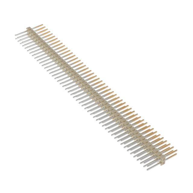

    排针 间距:2.54mm 2x48P 直插
HTSW-148-16-L-D-LL 数据手册
F-215 (Rev 26AUG15) HTSW–116–11–G–S TSW–209–09–F–S–RA HTSW–115–05–L–Q (2.54 mm) .100" THROUGH-HOLE .025" SQ POST HEADER Mates with: SSW, SSQ, SSM, ESW, ESQ, BCS, BSW, CES, SLW, IDSD, IDSS, SMSD, SMSS SPECIFICATIONS For complete specifications see www.samtec.com?TSW or www.samtec.com?HTSW Insulator Material: TSW: Black Glass Filled Polyester HTSW: Natural Liquid Crystal Polymer Terminal Material: Phosphor Bronze Plating: Au or Sn over 50µ" (1.27 µm) Ni Operating Temp Range: -55°C to +125°C with Gold -55°C to +105°C with Tin Voltage Rating: 550 VAC mated with SSW; 500 VAC mated with BCS or ESQ; 450 VAC -RA/-RE mated with BCS or SSM 400 VAC mated with CES RoHS Compliant: Yes Lead–Free Solderable: HTSW: Yes TSW: Wave Only TYPE STRIP (2.54 mm) Centers, –1 = .100" All Positions Filled TSW = Standard Strip HTSW (5.08) .200 (2.54) .100 (2.54) .100 50 02 (2.54) .100 100 (2.54) (5.02) .100 .198 –D 99 150 (2.54) (7.62) .100 .300 (5.08) (7.56) .200 .298 01 03 –T 148 150 (5.08) (7.56) .200 .298 (7.62) .300 –Q 5.2 A 5.7 A 5.2 A 6.3 A 5.2 A 4.6 A 4.3 A 1 POSITION POWERED PER ROW RECOGNITIONS For complete scope of recognitions see www.samtec.com/quality FILE NO: 090871_0_000 01 Right Angle Versions –S 01 01 03 CURRENT RATING (PER PIN) TSW mated with (2.54) .100 (2.48) .098 (5.08) .200 ESW SSW SLW SSQ SSM BCS SNT (5.08 mm) Centers, – 2 = .200" Every Other Position Filled = Hi-Temp Strip (2.54) .100 x No. of Positions Straight Pin Versions NO. PINS PER ROW PIN CENTERS TSW 148 = .100" (2.54 mm) Center Version HTSW (2.54) .100 x No. of Positions (2.54) .100 (3.02) .119 (1.78) .070 (3.09) (1.78) .122 .070 –S 01 BCS TSW HORIZONTAL ALSO AVAILABLE 50 (2.54) .100 (6.10) .240 (1.78) .070 (5.56) .219 (1.78) .070 (8.12) .320 01 99 03 150 (2.54) .100 (5.08) .200 01 148 03 150 (5.08) .200 (8.12) .320 (8.10) .319 01 TSW HTSW 02 thru 25 = .200" (5.08 mm) Center Version –T –Q (1.78) .070 (1.78) .070 Note: Some lengths, styles and options are non-standard, non-returnable. (8.10) .319 –D (1.78) .070 (1.78) .070 (MOQ Required) • Other platings Contact Samtec. 100 02 APPLICATIONS 01 thru 50 148 WWW.SAMTEC.COM Due to technical progress, all designs, specifications and components are subject to change without notice. TSW–109–10–F–D–RA TSW–114–16–G–S–RE HTSW–120–13–T–D TSW–112–07–G–T TSW, HTSW SERIES PLATING OPTION LEAD STYLE ROW OPTION OTHER OPTIONS –S –F –L –NA = Right Angle (using straight body for coplanar mating with SSW-RA series) = Double Row –G = 10µ" (0.25 µm) Gold on post, Gold flash on balance –T –T = Triple Row = Locking Clip (Styles –08 thru –13 & –22 only) = Right Angle –D = 10µ" (0.25 µm) Gold on post, Matte Tin on tail –LC – RA or –RE = Single Row = Gold flash on post, Matte Tin on tail IDSS or IDSD STRIP ASSEMBLY LOCKING CLIP .025" SQ TERMINAL STRIP (TSW) PC BOARD Requires 4 pin minimum (NA with -T,-Q,-RA or -RE) (1.27) .050 = Matte Tin Straight Pin Versions * * * * A B C STYLE – 05 (3.30) .130 (2.41) .095 (2.54) .100 (5.08) .200 (10.16) .400 (12.70) .500 (15.24) .600 (17.78) .700 (22.86) .900 (8.51) .335 (7.62) .300 (10.92) .430 (13.46) .530 (18.54) .730 (21.08) .830 (23.62) .930 (26.16) 1.030 (31.24) 1.230 (13.46) .530 (2.67) .105 (2.67) .105 –18 – 06 – 07 – 08 – 09 –10 –11 –12 –13 –14 * * * –15 –16 –17 (2.79) .110 (7.87) .310 (2.79) .110 (18.54) .730 (21.08) .830 * * * * * * * * ▲ (5.84) .230 (8.13) .320 (13.21) .520 (8.13) .320 (15.74) .620 –19 – 20 – 21 – 22 – 24 – 25 – 26 – 27 – 28 – 29 – 30 + + * Available with – LL (Locking Lead) Option (0.64) .025 SQ Post (7.62) .300 – 23 – 41 – 42 (2.92) .115 (5.33) .210 (3.20) .126 (25.40) 1.000 (20.32) .800 (23.11) .910 (18.03) .710 (0.89) .035 (1.27) .050 B C (23.62) .930 (26.16) 1.030 (31.24) 1.230 (36.32) 1.430 (16.00) .630 (11.30) .445 (12.15) .480 (16.00) .630 (11.58) .456 (33.78) 1.330 (28.70) 1.130 (33.78) 1.330 (28.70) 1.130 (9.27) .365 (11.94) .470 (18.29) .720 (20.83) .820 (25.91) 1.020 (30.99) 1.220 – 08 – 09 –10 –11 (5.84) .230 (6.73) .265 (8.13) .320 (5.84) .230 (8.13) .320 (5.84) .230 (8.13) .320 SINGLE (– S) –RA LEAD STYLE –12 –13 * * * –16 – 21 – 22 – 25 – 27 – 28 – 29 – 30 A (2.29) .090 (7.37) .290 (9.91) .390 (12.45) .490 (14.99) .590 (20.07) .790 (5.08) .200 (25.15) .990 (4.83) .190 (2.54) .100 (22.61) .890 (17.53) .690 (20.32) .800 (15.24) .600 DOUBLE (– D) TRIPLE (–T & – Q) A A (2.29) .090 (7.37) .290 (9.91) .390 (12.45) .490 (14.99) .590 (20.07) .790 (5.08) .200 (2.29) .090 (7.37) .290 (9.91) .390 (12.45) .490 (14.99) .590 C (5.84) .230 (8.13) .320 (5.84) .230 (8.13) .320 (5.84) .230 (8.13) .320 with HTSW only. B (2.54) .100 LEAD STYLE A B – RA (1.52) .060 (0.64) .025 SQ Tail ▲ – RE Specify -07 for best mate with IDXX Series IDC Cable – 09 (4.83) .190 (7.37) .290 (9.91) .390 (12.45) .490 (17.53) .690 (2.54) .100 (22.61) .890 (2.29) .090 (20.07) .790 (14.99) .590 –10 –11 –12 –13 –16 – 21 N/A N/A – 22 (4.83) .190 (2.54) .100 (4.83) .190 (2.54) .100 – 27 – 28 N/A A C (5.84) .230 (8.13) .320 (5.84) .230 *Available with – LA (Locking Lead) Option (17.53) .690 N/A N/A (15.24) .600 A (0.46) .018 DIA Tail SINGLE (5.08) .200 C ▲Except: Style –26 – RE LEAD STYLE N/A + Style –41 & –42 available C –“XXX” = Polarized Position (Specify “LEAD STYLE” from chart and select –RA or –RE from other options) A (2.79) .110 Two leads per strip crimped in opposite directions on or near centerline. See charts for available styles. N/A with single row 1 or 2 positions. Recommended hole size (1.02 mm ± 0.03 mm) .040" ± .001" Right Angle Versions (Specify “LEAD STYLE” from chart) STYLE = –RA Option with –LL Option = Locking Lead = Double Row (5.08 mm) .200" row space • Elevated Right Angle option • Shunts Contact Samtec –LA –LL –Q OTHER SOLUTIONS (1.78) .070 C A (2.54) .100 B (2.54) .100 (4.06) .160 WWW.SAMTEC.COM Due to technical progress, all designs, specifications and components are subject to change without notice. (2.54) .100

物料型号: - HTSW–116–11–G–S - HTSW–115–05–L–Q - TSW–209–09–F–S–RA
器件简介: - TSW和HTSW系列是高性能的互连系统,提供多种配置和选项以满足不同的应用需求。
引脚分配: - 引脚中心间距有.100" (2.54 mm)和.200" (5.08 mm)两种标准版本。 - 引脚分配包括直插针版本和直角版本。
参数特性: - 绝缘材料:TSW为黑色玻璃填充聚酯,HTSW为天然液晶聚合物。 - 端子材料:磷青铜。 - 镀层:金或锡覆盖50µ" (1.27 µm)镍。 - 工作温度范围:-55°C至+125°C(金镀层),-55°C至+105°C(锡镀层)。 - 电压等级:与不同系列配合时有不同的电压等级。
功能详解: - 提供了详细的电流额定值(每针)和不同配合情况下的电流承载能力。 - 提供了锁紧夹选项和极化位置选项。
应用信息: - 适用于多种应用场景,包括通过孔和扩展寿命产品。
封装信息: - 提供了详细的引脚布局和尺寸信息,以及不同的引脚样式和选项。
