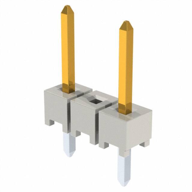

THROUGH-HOLE .025" SQ POST HEADER (2.54 mm) .100" PITCH • TSW/HTSW SERIES TSW/HTSW - SERIES Board Mates: SSW, SSQ, SSM, ESW, ESQ, BCS, BSW, CES, SLW Cable Mates: IDSD, IDSS = Standard Strip SPECIFICATIONS = Hi-Temp Strip Insulator Material: TSW: PBT HTSW: Natural LCP Terminal Material: Phosphor Bronze Plating: Au or Sn over 50 µ" (1.27 µm) Ni Operating Temp Range: -55 °C to +125 °C with Gold -55 °C to +105 °C with Tin Voltage Rating: 550 VAC mated with SSW; 500 VAC mated with BCS; 515 VAC mated with ESQ; 450 VAC -RA/-RE mated with BCS or SSM; 400 VAC mated with CES Lead–Free Solderable: HTSW: Yes TSW: No, Lead Wave Only - PIN CENTERS TSW –1 Specify LEAD STYLE from chart = .100" (2.54 mm) Center Version –2 02 thru 25 = .200" (5.08 mm) Centers, (Every other position filled) = .200" (5.08 mm) Center Version (2.54) .100 x No. of Positions –S LEAD STYLE 01 thru 50 = .100" (2.54 mm) Centers, (All positions filled) HTSW - NO. PINS PER ROW A (2.48) .098 (2.54) .100 C B A –D (5.08) .200 (5.02) .198 C B A –T (7.56) .298 (7.62) .300 CURRENT RATING (PER PIN) TSW mated with C B A ESW SSW SLW SSQ SSM BCS SNT 5.2 A 5.7 A 5.2 A 6.3 A 5.2 A 4.6 A 4.3 A –Q 2 POSITIONS POWERED (7.56) .298 (7.62) .300 TSW ALSO AVAILABLE C HTSW MOQ Required B Straight Pin Versions Other Platings OTHER SOLUTIONS Elevated Right-angle option Shunts LEAD STYLE B C STRAIGHT PIN VERSIONS A *–05 (8.51) .335 (3.30) .130 (2.67) .105 *–19 (26.16) 1.030 (7.62) .300 (2.41) .095 (2.67) .105 *– 20 (31.24) 1.230 B (2.79) .110 *– 07 (10.92) .430 (2.54) .100 *– 21 (36.32) 1.430 (2.79) .110 *– 08 (13.46) .530 (5.08) .200 *– 22 (16.00) .630 (7.62) .300 – 09 (18.54) .730 (10.16) .400 *– 23 (11.30) .445 –10 (21.08) .830 (12.70) .500 *– 24 (12.15) .480 –11 (23.62) .930 (15.24) .600 *– 25 (16.00) .630 –12 (26.16) 1.030 (17.78) .700 ▲ – 26 (11.58) .456 (3.20) .126 –13 (31.24) 1.230 (22.86) .900 – 27 (33.78) 1.330 (25.40) 1.000 –14 (13.46) .530 – 28 (28.70) 1.130 (20.32) .800 *–16 F-224 A LEAD STYLE *– 06 *–15 Note: Some lengths, styles and options are non-standard, non-returnable. STRAIGHT PIN VERSIONS (18.54) .730 *–17 (21.08) .830 *–18 (23.62) .930 (2.79) .110 (7.87) .310 (2.79) .110 (5.84) .230 (8.13) .320 (2.92) .115 (5.33) .210 (13.21) .520 – 29 (33.78) 1.330 (23.11) .910 (8.13) .320 – 30 (28.70) 1.130 (18.03) .710 C (20.83) .820 (25.91) 1.020 (30.99) 1.220 (5.84) .230 (6.73) .265 (8.13) .320 (5.84) .230 (8.13) .320 (15.74) .620 +– 41 (9.27) .365 (0.89) .035 (5.84) .230 (18.29) .720 +– 42 (11.94) .470 (1.27) .050 (8.13) .320 * Available with –LL (Locking Lead) Option Specify -07 for best mate with IDXX Series IDC Cable + Style –41 & –42 available with HTSW only. ▲ Except: Style –26 (0.46) .018 DIA Tail samtec.com?TSW or samtec.com?HTSW Unless otherwise approved in writing by Samtec, all parts and components are designed and built according to Samtec’s specifications which are subject to change without notice. - - - PLATING OPTION –F – RA or –RE = Single Row –L = Right-angle –D = 10 µ" (0.25 µm) Gold on post, Matte Tin on tail –NA = Double Row –G = Right-angle (Using straight body for coplanar mating with SSW-RA series) –T = 10 µ" (0.25 µm) Gold on post, Gold flash on balance = Triple Row –T –Q = Matte Tin –LL = Locking Lead See charts for available styles. Not available with single row 1 or 2 positions. Recommended hole size (1.02 mm ± 0.03 mm) .040" ± .001) = Double Row (5.08 mm).200"row space C (2.54) .100 x No. of Positions –S OTHER OPTION –S = Gold flash on post, Matte Tin on tail (3.02) .119 - ROW OPTION D –LC (3.09) .122 = Locking Clip (Styles –08 thru –13 & –22 only) (Requires 4 pin minimum) (Not available with T, –Q, –RA or–RE) E C –D –LA = –RA Option with –LL Option (6.10) .240 (5.56) .219 –“XXX” = Polarized Position E C –T (8.12) .320 (8.10) .319 E C –Q (8.12) .320 RIGHT-ANGLE VERSIONS (8.10) .319 TSW HTSW -RA LEAD STYLE E D – RA (1.52) .060 – RE (4.06) .160 RIGHT-ANGLE VERSIONS -RE LEAD STYLE – 09 –10 –11 –12 –13 –16 – 21 – 22 – 27 – 28 C – 08 Right-Angle Versions LEAD STYLE SINGLE (–S) C (5.84) .230 (8.13) .320 (5.84) .230 SINGLE E (4.83) .190 (7.37) .290 (9.91) .390 (12.45) .490 (17.53) .690 (2.54) .100 (22.61) .890 (2.29) .090 (20.07) .790 (14.99) .590 E (2.29) .090 DOUBLE (–D) TRIPLE (–T & –Q) E E (2.29) .090 (2.29) .090 – 09 (7.37) .290 (7.37) .290 (7.37) .290 –10 (9.91) .390 (9.91) .390 (9.91) .390 –11 (5.84) .230 –12 –13 *–16 – 21 *– 22 *– 25 – 27 – 28 – 29 (8.13) .320 (5.84) .230 (8.13) .320 (5.84) .230 (8.13) .320 (12.45) .490 (12.45) .490 (12.45) .490 (14.99) .590 (14.99) .590 (14.99) .590 (20.07) .790 (20.07) .790 N/A (5.08) .200 (5.08) .200 (5.08) .200 (25.15) .990 N/A N/A (4.83) .190 (4.83) .190 (4.83) .190 (2.54) .100 (2.54) .100 (2.54) .100 (22.61) .890 N/A (17.53) .690 (17.53) .690 (20.32) .800 N/A N/A – 30 (15.24) .600 (15.24) .600 * Available with –LA (Locking Lead) Option samtec.com?TSW or samtec.com?HTSW Unless otherwise approved in writing by Samtec, all parts and components are designed and built according to Samtec’s specifications which are subject to change without notice. F-224

物料型号为TSW/HTSW系列,包括板对板连接器和电缆对板连接器。
器件简介为通过孔0.025英寸正方形端头(2.54毫米),100英寸间距的TSW/HTSW系列连接器。
绝缘体材料为PBT(TSW)或天然LCP(HTSW),端头材料为磷青铜,镀层为金或锡覆盖50微英寸(1.27微米)镍。
工作温度范围为-55°C至+125°C(金镀层)或-55°C至+105°C(锡镀层)。
电压等级为550 VAC(与SSW配合使用),500 VAC(与BCS配合使用),515 VAC(与ESQ配合使用),450 VAC(-RA/-RE与BCS或SSM配合使用),400 VAC(与CES配合使用)。
HTSW系列可焊接,而TSW系列仅可进行铅波焊接。
引脚分配包括01至50个引脚,引脚中心为.100英寸(2.54毫米)或.200英寸(5.08毫米)中心版本。
HTSW系列的电流额定值(每引脚)为5.2A至6.3A,具体取决于与哪种类型的连接器配合使用。
参数特性包括绝缘体材料、端头材料、镀层、工作温度范围、电压等级和可焊接性。
功能详解应用信息未在文档中明确说明,但根据上下文,这些连接器可能用于需要高可靠性和电气性能的板对板或电缆对板连接。
封装信息包括直插针版本和其他镀层选项,以及提升直角选项和分流器等其他解决方案。
还提供了不同引脚长度和样式的详细规格。
