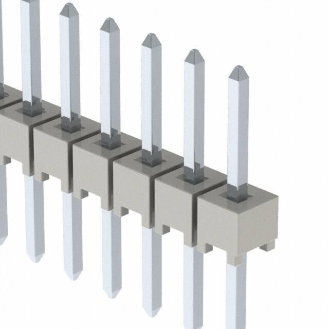

    CONN HEADER VERT 18POS 2.54MM
HTSW-118-08-T-S 数据手册
THROUGH-HOLE .025" SQ POST HEADER (2.54 mm) .100" PITCH • TSW/HTSW SERIES TSW/HTSW - SERIES Board Mates: SSW, SSQ, SSM, ESW, ESQ, BCS, BSW, CES, SLW Cable Mates: IDSD, IDSS = Standard Strip SPECIFICATIONS = Hi-Temp Strip Insulator Material: TSW: PBT HTSW: Natural LCP Terminal Material: Phosphor Bronze Plating: Au or Sn over 50 µ" (1.27 µm) Ni Operating Temp Range: -55 °C to +125 °C with Gold -55 °C to +105 °C with Tin Voltage Rating: 550 VAC mated with SSW; 500 VAC mated with BCS; 515 VAC mated with ESQ; 450 VAC -RA/-RE mated with BCS or SSM; 400 VAC mated with CES Lead–Free Solderable: HTSW: Yes TSW: No, Lead Wave Only - PIN CENTERS TSW –1 Specify LEAD STYLE from chart = .100" (2.54 mm) Center Version –2 02 thru 25 = .200" (5.08 mm) Centers, (Every other position filled) = .200" (5.08 mm) Center Version (2.54) .100 x No. of Positions –S LEAD STYLE 01 thru 50 = .100" (2.54 mm) Centers, (All positions filled) HTSW - NO. PINS PER ROW A (2.48) .098 (2.54) .100 C B A –D (5.08) .200 (5.02) .198 C B A –T (7.56) .298 (7.62) .300 CURRENT RATING (PER PIN) TSW mated with C B A ESW SSW SLW SSQ SSM BCS SNT 5.2 A 5.7 A 5.2 A 6.3 A 5.2 A 4.6 A 4.3 A –Q 2 POSITIONS POWERED (7.56) .298 (7.62) .300 TSW ALSO AVAILABLE C HTSW MOQ Required B Straight Pin Versions Other Platings OTHER SOLUTIONS Elevated Right-angle option Shunts LEAD STYLE B C STRAIGHT PIN VERSIONS A *–05 (8.51) .335 (3.30) .130 (2.67) .105 *–19 (26.16) 1.030 (7.62) .300 (2.41) .095 (2.67) .105 *– 20 (31.24) 1.230 B (2.79) .110 *– 07 (10.92) .430 (2.54) .100 *– 21 (36.32) 1.430 (2.79) .110 *– 08 (13.46) .530 (5.08) .200 *– 22 (16.00) .630 (7.62) .300 – 09 (18.54) .730 (10.16) .400 *– 23 (11.30) .445 –10 (21.08) .830 (12.70) .500 *– 24 (12.15) .480 –11 (23.62) .930 (15.24) .600 *– 25 (16.00) .630 –12 (26.16) 1.030 (17.78) .700 ▲ – 26 (11.58) .456 (3.20) .126 –13 (31.24) 1.230 (22.86) .900 – 27 (33.78) 1.330 (25.40) 1.000 –14 (13.46) .530 – 28 (28.70) 1.130 (20.32) .800 *–16 F-224 A LEAD STYLE *– 06 *–15 Note: Some lengths, styles and options are non-standard, non-returnable. STRAIGHT PIN VERSIONS (18.54) .730 *–17 (21.08) .830 *–18 (23.62) .930 (2.79) .110 (7.87) .310 (2.79) .110 (5.84) .230 (8.13) .320 (2.92) .115 (5.33) .210 (13.21) .520 – 29 (33.78) 1.330 (23.11) .910 (8.13) .320 – 30 (28.70) 1.130 (18.03) .710 C (20.83) .820 (25.91) 1.020 (30.99) 1.220 (5.84) .230 (6.73) .265 (8.13) .320 (5.84) .230 (8.13) .320 (15.74) .620 +– 41 (9.27) .365 (0.89) .035 (5.84) .230 (18.29) .720 +– 42 (11.94) .470 (1.27) .050 (8.13) .320 * Available with –LL (Locking Lead) Option Specify -07 for best mate with IDXX Series IDC Cable + Style –41 & –42 available with HTSW only. ▲ Except: Style –26 (0.46) .018 DIA Tail samtec.com?TSW or samtec.com?HTSW Unless otherwise approved in writing by Samtec, all parts and components are designed and built according to Samtec’s specifications which are subject to change without notice. - - - PLATING OPTION –F – RA or –RE = Single Row –L = Right-angle –D = 10 µ" (0.25 µm) Gold on post, Matte Tin on tail –NA = Double Row –G = Right-angle (Using straight body for coplanar mating with SSW-RA series) –T = 10 µ" (0.25 µm) Gold on post, Gold flash on balance = Triple Row –T –Q = Matte Tin –LL = Locking Lead See charts for available styles. Not available with single row 1 or 2 positions. Recommended hole size (1.02 mm ± 0.03 mm) .040" ± .001) = Double Row (5.08 mm).200"row space C (2.54) .100 x No. of Positions –S OTHER OPTION –S = Gold flash on post, Matte Tin on tail (3.02) .119 - ROW OPTION D –LC (3.09) .122 = Locking Clip (Styles –08 thru –13 & –22 only) (Requires 4 pin minimum) (Not available with T, –Q, –RA or–RE) E C –D –LA = –RA Option with –LL Option (6.10) .240 (5.56) .219 –“XXX” = Polarized Position E C –T (8.12) .320 (8.10) .319 E C –Q (8.12) .320 RIGHT-ANGLE VERSIONS (8.10) .319 TSW HTSW -RA LEAD STYLE E D – RA (1.52) .060 – RE (4.06) .160 RIGHT-ANGLE VERSIONS -RE LEAD STYLE – 09 –10 –11 –12 –13 –16 – 21 – 22 – 27 – 28 C – 08 Right-Angle Versions LEAD STYLE SINGLE (–S) C (5.84) .230 (8.13) .320 (5.84) .230 SINGLE E (4.83) .190 (7.37) .290 (9.91) .390 (12.45) .490 (17.53) .690 (2.54) .100 (22.61) .890 (2.29) .090 (20.07) .790 (14.99) .590 E (2.29) .090 DOUBLE (–D) TRIPLE (–T & –Q) E E (2.29) .090 (2.29) .090 – 09 (7.37) .290 (7.37) .290 (7.37) .290 –10 (9.91) .390 (9.91) .390 (9.91) .390 –11 (5.84) .230 –12 –13 *–16 – 21 *– 22 *– 25 – 27 – 28 – 29 (8.13) .320 (5.84) .230 (8.13) .320 (5.84) .230 (8.13) .320 (12.45) .490 (12.45) .490 (12.45) .490 (14.99) .590 (14.99) .590 (14.99) .590 (20.07) .790 (20.07) .790 N/A (5.08) .200 (5.08) .200 (5.08) .200 (25.15) .990 N/A N/A (4.83) .190 (4.83) .190 (4.83) .190 (2.54) .100 (2.54) .100 (2.54) .100 (22.61) .890 N/A (17.53) .690 (17.53) .690 (20.32) .800 N/A N/A – 30 (15.24) .600 (15.24) .600 * Available with –LA (Locking Lead) Option samtec.com?TSW or samtec.com?HTSW Unless otherwise approved in writing by Samtec, all parts and components are designed and built according to Samtec’s specifications which are subject to change without notice. F-224
