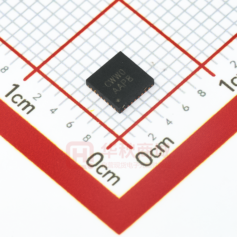

    QFN32_4X4MM_EP
    AW21024QNR
AW21024QNR 数据手册
AW21024 Sep. 2019 V1.0 24-CHANNEL INTELLIGENT 8-BIT RGB LED DRIVER FEATURES GENERAL DESCRIPTION  AW21024 is a 24-channel high precision constant current LED driver. Each channel has individual 8bit DC current setting for color-mixing and 8-bit PWM current for brightness control. The global current of each channel is recommended to be 50mA configured via register GCCR and external Resistor REXT. Individual 256-level PWM for dimming  Individual 256-level current for color-mixing a l  ti Global 256-level DC current configuration High-precision current sinks  Device-to-device error: ±5%  Channel-to-channel error: ±5% n   Group control mode, autonomous breathing pattern and rapid RGB control mode are provided for flexible, high efficiency lighting effect programming and fast display updating. EMI and audible noise reduction  Phase delay and phase inverting scheme  Spread spectrum function d e  24-channel RGB LED Driver Flexible LED lighting pattern control  LED open/short detection per channel  Auto power saving mode when all LEDs off > 32ms o n Over-temperature protection  400 kHz I2C interface, 16 selectable addresses  Power supply: 2.7V~5.5V  QFN 4mmX4mmX0.85mm-32L package ic AW21024 is available in QFN 4mmX4mmX 0.85mm-32L package. It operates from 2.7V to 5.5V over the temperature range of -40°C to +85°C. in Smart speaker AW21024 can be turned off with minimum current consumption by either pulling the EN pin low or using the software shutdown feature. C  APPLICATIONS Programmable phase-shifting and spread spectrum technology are utilized to reduce EMI and audible noise caused by MLCC when LEDs turn on or off simultaneously. fi  E-sports devices w Smart home appliance a TYPICAL APPLICATION CIRCUIT VLED VDD 27 25 AD0 26 AD1 VIO R1 4.7k Ω VDD C2 0.1 μF C1 1 μF R2 4.7k Ω LED24 24 LED23 23 LED22 22 . . . AW21024 29 28 MCU 30 31 SCL CLED 1 μF RG RR . . . SDA EN LED3 ISET LED2 REXT 4kΩ 33 RB GND LED1 Note: The resistors(RR,RG,RB ) 3 2 1 RBLUE=(VLED-VF-0.5V)/IOUT R GREEN=(VLED-VF-0.5V)/IOUT RRED=(VLED-VF-0.5V)/IOUT between LED and IC are only for thermal reduction AW21024 Application circuit www.awinic.com 1 Copyright © 2019 SHANGHAI AWINIC TECHNOLOGY CO., LTD AW21024 Sep. 2019 V1.0 PIN CONFIGURATION AND TOP MARK AW21024QNR (Top View) AW21024QNR (Top View) 25 32 1 a l 24 n ti 33 GND 9 16 d e 17 8 PIN DEFINITION o n fi CWW0 – AW21024QNR XXXX – Production Tracing Code NAME DESCRIPTION 1~24 LED1~LED24 Constant current sink, connect to LED’s cathode 25~26 AD0,AD1 I2C address setting, connects to GND, VDD, SCL or SDA for different device address of I2C. Internally pulled down to GND with a resistor of 1MΩ 27 VDD 28 SDA 29 SCL ic Power supply EN Serial data I/O for I2C interface in w 30 C No. Serial clock input for I2C interface Shutdown the chip when pulled low. ISET Input terminal used to connect an external resistor. This regulates the global output current. When REXT=4.0kΩ, global current of LED is 20mA. 32 NC Not connected 33 GND Ground a 31 www.awinic.com 2 Copyright © 2019 SHANGHAI AWINIC TECHNOLOGY CO., LTD AW21024 Sep. 2019 V1.0 FUNCTIONAL BLOCK DIAGRAM VDD POR OSC OTP UVLO O/S Detection a l Bandgap PWM Modulation BR Digital Control COL n AD I2C Interface LED Driver EN Phase Control d e SDA ti SCL Global Current Setting GND o n fi ISET LED1-24 VDD 27 ic 25 26 a w MCU LED24 24 LED23 23 LED22 22 AD0 . . . AW21024 29 SCL 28 SDA 30 EN 31 LED3 ISET LED2 REXT 4kΩ 33 VLED RB CLED 1 μF RG RR AD1 R2 4.7k Ω in R1 4.7k Ω VDD C2 0.1 μF C1 1 μF VIO C TYPICAL APPLICATION CIRCUITS LED1 GND Note: The resistors(RR,RG,RB ) . . . 3 2 1 RBLUE=(VLED-VF-0.5V)/IOUT R GREEN=(VLED-VF-0.5V)/IOUT RRED=(VLED-VF-0.5V)/IOUT between LED and IC are only for thermal reduction AW21024 Application circuit www.awinic.com 3 Copyright © 2019 SHANGHAI AWINIC TECHNOLOGY CO., LTD AW21024 Sep. 2019 V1.0 ORDERING INFORMATION Temperature Package Marking Moisture Sensitivity Level Environmental Information Delivery Form AW21024QNR -40°C~85°C QFN 4X4-32L CWW0 MSL3 ROHS+HF 6000 units/ Tape and Reel a l Part Number ti ABSOLUTE MAXIMUM RATINGS(NOTE1) RANGE n PARAMETERS -0.3V to 6V d e Supply voltage range VDD Input voltage range SCL, SDA, EN, AD0,AD1 -0.3V to VDD Output voltage range LED1~LED24 -0.3V to VDD Operating free-air temperature range o n Maximum operating junction temperature TJMAX fi Junction-to-ambient thermal resistance θJA Storage temperature TSTG Lead temperature (soldering 10 seconds) 36.4°C/W -40°C to 85°C 160°C -65°C to 150°C 260°C HBM ic CDM C ESD (NOTE 2) JESD78E in Test condition: ±2000V ±1500V Latch-Up +IT:200mA -IT:-200mA a w NOTE1: Conditions out of those ranges listed in "absolute maximum ratings" may cause permanent damages to the device. In spite of the limits above, functional operation conditions of the device should within the ranges listed in "recommended operating conditions". Exposure to absolute-maximum-rated conditions for prolonged periods may affect device reliability. NOTE2: The human body model is a 100pF capacitor discharged through a 1.5kΩ resistor into each pin. Test method: MIL-STD-883H Method 3015.8(HBM). ESDA/TEDEC JS-002-2018(CDM). www.awinic.com 4 Copyright © 2019 SHANGHAI AWINIC TECHNOLOGY CO., LTD AW21024 Sep. 2019 V1.0 ELECTRICAL CHARACTERISTICS TA=25°C,VDD=3.6V (unless otherwise noted) , REXT=4kΩ PARAMETER TEST CONDITION MIN TYP MAX UNIT 5.5 V Power supply voltage and current Power supply voltage ISD_VDD Shutdown current of VDD EN=GND Standby current of VDD VEN=3.6V,CHIPEN= 0 2.7 All LEDs off >32ms VEN=VDD, GCR.CHIPEN=1, Quiescent current in active mode VEN=VDD, fi IACT_VDD 1 μA 10 μA ti VEN=3.6V, GCR.APSE=1, n Power-save mode current consumption 3 d e ISTB_VDD 0.1 a l VDD GCR.CHIPEN=1, o n GCCR.GCC=0xFF, 3 10 μA 2 4 mA 10 12 mA 0.1 1 μA 20.0 +5% mA +5 % COLX=0xFF VEN=0V, ILEAKAGE Output leakage current IMAX Maximum global current of LEDX GCCR.GCC=0xFF, IMATCH Output current match accuracy GCCR.GCC=0xFF, VDROPOUT Dropout voltage when the LED current has dropped 5% FOSC OSC clock frequency C ic in BRX=COLX=0xFF BRX=COLX=0xFF ILEDX=20mA w a TSD VLEDX=5.5V -5% -5 150 200 250 mV -5% 16 +5% MHz Thermal shutdown threshold 150 °C Thermal shutdown hysteresis 20 °C AD0,AD1, EN VIL Input low level AD0,AD1,EN VIH Input high level AD0,AD1,EN RADPD Internal pull down resistance AD0,AD1, VDD=3.6V RENPD Internal pull down resistance EN, VDD=3.6V 0.4 1.2 V V 1M Ω 400k Ω I2C Interface www.awinic.com 5 Copyright © 2019 SHANGHAI AWINIC TECHNOLOGY CO., LTD AW21024 Sep. 2019 PARAMETER TEST CONDITION VOL Output low level SDA,IOL = 10 mA VIH Input high level SCL, SDA VIL Input low level SCL, SDA MIN TYP V1.0 MAX UNIT 0.1 V 1.2 V 0.4 V MIN - THD:STA (Repeat-start) Start condition hold time TLOW Low level width of SCL THIGH High level width of SCL TSU:STA (Repeat-start) Start condition setup time THD:DAT Data hold time TSU:DAT Data setup time TR TF Falling time of SDA and SCL TSU:STO Stop condition setup time TBUF Time between start and stop condition UNIT 400 kHz - μs 1.3 - μs 0.6 - μs 0.6 - μs 0 - μs 0.1 - μs Rising time of SDA and SCL - 0.3 μs - 0.3 μs 0.6 - μs 1.3 - μs in ic o n fi d e 0.6 n Interface Clock frequency MAX C FSCL TYP ti PARAMETER a l I2C INTERFACE TIMING VIH w SDA tBUF VIL tLOW tHIGH tR tF VIH SCL a VIL Stop tHD:STA Start tHD:DAT tSU:DAT tSU:STA Start tSU:STO Stop I2C Interface Timing www.awinic.com 6 Copyright © 2019 SHANGHAI AWINIC TECHNOLOGY CO., LTD AW21024 Sep. 2019 V1.0 DETAILED FUNCTIONAL DESCRIPTION OPERATION MODE AND RESET POWER ON RESET a l Upon initial power-up, the AW21024 is reset by internal power-on-reset, and all registers are reset to default value, and LED driver is shut down. ti Once the supply voltage VDD drops below the threshold voltage VPOR_VDD (2.0V), the power-on-reset will be activated to reset the device again. By reading the bit PORST of the register UVCR (address 79h), whether the device has been reset can be determined. VDD d e n Below is the recommended operation timing: POR threshold POR 200μs Initial Note: The device need about 200μs for initalization after Power ON Initial 200μs Note: OSC operate stable need 200μs after CHIPEN=1 o n CHIPEN fi Note: Recommend CHIPEN=1 after Initial (bit CHIPEN of GCR register) OSC Note: After OSC stable, light effect can be set Determined by light effect Light effect C Configure ……………………………… SOFTWARE RESET ic Power Up Timing in By writing 00H to register RESET (address 7Fh), the software reset is triggered. After software reset, all registers will be reset to the default value and enter into standby mode. a w After the software reset command is input through I2C or power on reset, it needs to wait at least 2ms before any other I2C command can be accepted. Soft Reset 200μs Initial Note: The device need about 200μs for initalization after Power ON Initial Note: Recommend CHIPEN=1 after Initial (bit CHIPEN of GCR register) CHIPEN 200μs Note: OSC operate stable need 200μs after CHIPEN=1 …………………………… OSC Note: After OSC stable, light effect can be set Configure Determined by light effect Light effect Software Reset Timing www.awinic.com 7 Copyright © 2019 SHANGHAI AWINIC TECHNOLOGY CO., LTD AW21024 Sep. 2019 V1.0 SHUTDOWN MODE The AW21024 enters into shutdown mode automatically when EN is pulled to low level. In this situation, I2C interface is not accessible, all registers can not be configured and will be reset. a l STANDBY MODE ti The AW21024 enters into standby mode automatically when EN is pulled low or the bit CHIPEN of the register GCR (address 00h) is set to “0” or UVLO is triggered(UVST=1) in active mode, meanwhile all registers will not be reset. In standby mode, all analog blocks are power down but I2C interface is accessible, and all registers can be configured. d e n When POR is triggered, the device enters into standby mode and all registers will be reset (more information is showed in POWER ON RESET). ACTIVE MODE fi When EN is in high level, and the bit CHIPEN of the register GCR (address 00h) is set to “1”, the AW21024 enters into the active mode. o n AUTO POWER-SAVE MODE C The bit APSE of the register GCR (address 00h) is set to “1”, the auto power-save mode is enabled. When all LEDs are off and the value of all register BR0~BR23 are 0x00H for more than 32ms, AW21024 automatically enters into standby mode for power saving. Once writing a non-zero value into any register among BR0~BR23, the device exits power-save mode immediately. a w in ic VCC power up EN=L Shutdown From all states EN=H Software reset Initialization From all states APSE=1 && All LEDs off >32ms UVST=H or PORST=H POWER SAVE Stand-by From all states 2 I C Command Chipen=0 Chipen=1 TSD=H Active Thermal Shutdown TSD=L AW21024 Operating Mode Transition www.awinic.com 8 Copyright © 2019 SHANGHAI AWINIC TECHNOLOGY CO., LTD AW21024 Sep. 2019 V1.0 I2C INTERFACE The AW21024 supports the I2C protocol. The maximum frequency supported by the I2C is 400kHz. The pullup resistor for the SDA and SCL can be selected from 1k to 10kΩ. Usually, 4.7kΩ is recommended for 400kHz I2C. The voltage from 1.8V to 3.3V is allowed for the I2C interface. Additionally, the I2C device supports continuous read and write operations. a l DEVICE ADDRESS A2:A1 GND 00 00 GND VDD 00 01 GND SCL 00 10 GND SDA 00 11 VDD GND 01 VDD VDD 01 VDD SCL 01 VDD SDA SCL GND SCL VDD SCL SCL SCL SDA SDA A0 Device Address d e A4:A3 31h 32h 33h 00 34h 01 35h 10 36h 01 11 10 00 10 01 39h 10 10 3ah 10 11 3bh GND 11 00 3ch SDA VDD 11 01 3dh SDA SCL 11 10 3eh SDA 11 11 3fh ic in w 37h 0/1 38h 1Ch a SDA 011 Broadcast Address 30h fi GND A7:A5 o n AD0 C AD1 n ti The I2C device address is 7-bit (A7~A1), followed by a R/W bit A0 (Read=1/Write=0). Set A0 to “0” for writing and “1” for reading. The values of bit A1 and bit A2 are depended on the connection of pin AD0 and the values of [A4:A3] are depended on the connection of pin AD1, there are 4 options: VDD, GND, SCL and SDA for each AD. The A7 to A5 is “011” constantly. The device also supports using a broadcast slave address of 1Ch to access registers. All slave addresses as followed. I2C START/STOP I2C start: SDA changes from high level to low level when SCL is high level. I2C stop: SDA changes from low level to high level when SCL is high level. SDA SCL S/Sr P S: START condition Sr: START Repeated condition P: STOP condition I2C Start/Stop Condition Timing www.awinic.com 9 Copyright © 2019 SHANGHAI AWINIC TECHNOLOGY CO., LTD AW21024 Sep. 2019 V1.0 DATA VALIDATION When SCL is high level, SDA level must be constant. SDA can be changed only when SCL is low level. SDA Change of Data Allowed ti Data Line Stable Data Valid a l SCL d e ACK (ACKNOWLEDGEMENT) n Data Validation Diagram ACK means the successful transfer of I2C bus data. After master sends an 8-bit data, SDA must be released; SDA is pulled to GND by slave device when slave acknowledges. o n fi When master reads, slave device sends 8-bit data, releases the SDA and waits for ACK from master. If ACK is send and I2C stop is not send by master, slave device sends the next data. If ACK is not send by master, slave device stops to send data and waits for I2C stop. Data Output by Transmiter C Not Acknowledge(NACK) Data Output by Receiver ic SCL From Master Acknowledge(ACK) 2 1 in 9 Clock Pulse for Acknowledgement START condition I2C ACK Timing w WRITE CYCLE 8 a One data bit is transferred during each clock pulse. Data is sampled during the high state of the serial clock (SCL). Consequently, throughout the clock’s high period, the data should remain stable. Any changes on the SDA line during the high state of the SCL and in the middle of a transaction, aborts the current transaction. New data should be sent during the low SCL state. This protocol allows a single data line to transfer both command/control information and data using the synchronous serial clock. Each data transaction is composed of a start condition, a number of byte transfers (set by the software) and a stop condition to terminate the transaction. Every byte written to the SDA bus must be 8 bits long and is transferred with the most significant bit first. After each byte, an Acknowledge signal must follow. In a write process, the following steps should be followed: a) Master device generates START condition. The “START” signal is generated by lowering the SDA signal while the SCL signal is high. b) Master device sends slave address (7-bit) and the data direction bit R/W = 0). www.awinic.com 10 Copyright © 2019 SHANGHAI AWINIC TECHNOLOGY CO., LTD AW21024 Sep. 2019 V1.0 Slave device sends acknowledge signal if the slave address is correct. d) Master sends control register address (8-bit) e) Slave sends acknowledge signal f) Master sends data byte to be written to the addressed register g) Slave sends acknowledge signal h) If master will send further data bytes the control register address will be incremented by one after acknowledge signal (repeat step f and g) i) Master generates STOP condition to indicate write cycle end a l c) 0 1 2 3 4 5 6 7 8 0 1 2 3 4 5 6 7 8 0 1 2 3 4 n SCL ti j) 5 6 7 8 A6 A5 A4 A3 A2 A1 A0 R/WAck A7 A6 A5 A4 A3 A2 A1 A0 Ack D7 D6 D5 D4 D3 D2 D1 D0 Start Device Address Register Address Write Data d e SDA Ack Stop I2C Write Byte Cycle fi READ CYCLE o n In a read cycle, the following steps should be followed: Master device generates START condition b) Master device sends slave address (7-bit) and the data direction bit (R/W = 0). c) Slave device sends acknowledge signal if the slave address is correct. d) Master sends control register address (8-bit) e) Slave sends acknowledge signal f) Master generates STOP condition followed with START condition or REPEAT START condition g) Master device sends slave address (7-bit) and the data direction bit (R/W = 1). h) Slave device sends acknowledge signal if the slave address is correct. i) Slave sends data byte from addressed register. j) If the master device sends acknowledge signal, the slave device will increase the control register address by one, then send the next data from the new addressed register. k) If the master device generates STOP condition, the read cycle is ended. a w in ic C a) www.awinic.com 11 Copyright © 2019 SHANGHAI AWINIC TECHNOLOGY CO., LTD AW21024 Sep. 2019 SCL 0 1 2 3 4 5 SDA A6 A5 A4 A3 A2 A1 7 8 0 1 2 3 4 5 6 A0 R/W Ack A7 A6 A5 A4 A3 A2 A1 1 2 3 4 5 A6 A5 A4 A3 A2 A1 6 7 8 0 A0 R/W Ack D7 …… 0 1 2 3 4 5 A6 A5 A4 A3 A2 A1 S ... 6 D6 …… D1 7 8 D0 Ack stop Read Data Device Address Separated Read/write transaction …… 1 6 7 8 0 A0 R/W Ack D7 Device Address 1 ... 6 7 D6 …… D1 D0 8 a l 0 RS P Register Address n …… Using Repeat start…… A0 Ack ti Device Address 8 7 Ack Read Data stop d e start 6 V1.0 I2C Read Byte Cycle UNDER VOLTAGE LOCK OUT (UVLO) o n fi When bit UVDIS of the register UVCR (address 79h) is set to “0”, the device monitors the voltage of VDD. If the voltage drops below threshold (2.4V typically), the bit UVST of the register UVCR (address 79h) will be set to “1”. After read-out, the register UVCR will be clear. C If both bit UVDIS and bit UVPD of the register UVCR (address 79h) is set to “0”, UVLO protection function is enabled. Once the event of under voltage occurs, the bit CHIPEN of the register GCR (address 00h) will be cleared to “0”, and then the device will enter into standby mode. If the voltage of VDD rises above the UVLO threshold and then write “1” to bit CHIPEN, the device will enter into active mode again. By default, control bits UVDIS, UVPD are all “0”. Both UVLO monitor and protection are enabled. ic OVER TEMPERATURE PROTECTION (OTP) in When bit OTDIS of the register OTCR (address 77h) is set to “0”, the over-temperature detection is enabled. Once the temperature of this device reaches 150℃, the over-temperature condition is detected, and the bit w OTST of the register OTCR (address 77h) will be set to “1”. The OTST will be cleared to “0” after reading the register OTCR. a If both bit OTDIS and bit OTPD of the register OTCR (address 77h) is set to “0”, the Over-Temperature Protection (OTP) function is enabled. Once the event of over-temperature occurs, the bit CHIPEN of the register GCR (address 00h) will be cleared to “0”, and then the device will enter into standby mode. When the temperature returns below 130°C, the device will enter into active mode again after writing “1” to bit CHIPEN. By default, control bits OTDIS and OTPD are all “0”, both OT monitor and OT protection are enabled. LED OPEN/SHORT DETECTION AW21024 supports LED open/short detection. When bit OSDE[1:0] of the register OSDCR(address 71h) is set to “11” , open detection is enabled, and the detection results can be read out via the registers OSST0~2 (72h~74h). Similarly, when set bit OSDE [1:0] of the register OSDCR (address 71h) to “10”, short detection is enabled, and the results also can be read out via the registers OSST0~2. We recommend the bit PWMDIS [6:5] of the register SSCR (address 78h) being set to “11” and maintain about www.awinic.com 12 Copyright © 2019 SHANGHAI AWINIC TECHNOLOGY CO., LTD AW21024 Sep. 2019 V1.0 1mA current of each LED when the open/short function is enabled. CURRENT SETTING The average output current of LEDn (n=1, 2, …, 24) can be expressed by the following formula, K GCC WB COLn BRn     REXT 255 255 255 256 n=1, 2, 3, …, 24 a l I OUT ( n )  n ti Where K=80V, REXT is the value of external resistor, GCC is the 8bit global current configured by the register GCCR (address 6Eh), WB is 8bit white balance parameter configured by the register WBR/WBG/WBB (address 90h/91h/92h), COLn is 8bit individual constant current parameter, and BRn is 8bit individual PWM modulated current parameter. d e The maximum output current is decided by the REXT and the GCC when WB=255, COLn=255, BRn=256. For an example: when REXT = 4kΩ, GCC=0xFF, IOUT= IMAX=20mA. fi AW21024 supports white balance calibration function via 3 registers consisting of register WBR, WBG, and WBB. Therein, WBR is used for LED X (X=1, 4, 7, …, 22), WBG is used for LEDY (Y=2, 5, 8, …, 23), WBB is used for LEDZ (Z=3, 6, 9, …, 24). The default value of registers WBR/WBG/WBB is 0xff. o n Each LED current of AW21024 features 8bit DC current and 8bit PWM modulated current that are decided by COL source and BR source respectively. The BR and COL sources are as follows. Mode General Mode Breathing Pattern Controller (BPC) Group Control Mode Paramete r GEn=0 GEn=1 and PATEN=1 GEn=1 and PATEN=0 RGBMD= 0 RGBMD= 1 #1 BR0 BR0 #2 BR1 #3 BR2 #4 #5 BR Source COL Source COL Source GCOLDIS=1 GCOLDIS=0 GCOLDIS=1 COL0 GCOLR COL0 GCOLR COL0 BR0 COL1 GCOLG COL1 GCOLG COL1 BR0 COL2 GCOLB COL2 GCOLB COL2 BR3 BR1 COL3 GCOLR COL3 GCOLR COL3 BR4 BR1 COL4 GCOLG COL4 GCOLG COL4 BR5 BR1 COL5 GCOLB COL5 GCOLB COL5 … … … … … … … #22 BR21 BR7 COL21 GCOLR COL21 GCOLR COL21 #23 BR22 BR7 COL22 GCOLG COL22 GCOLG COL22 #24 BR23 BR7 COL23 GCOLB COL23 GCOLB COL23 a … w #6 in GCOLDIS=0 ic LED NO. BR Source C COL Source BR Source Source BPC FADEL Notes: GEn (n=0~7) refers to BPC/Group-Control-Mode control bit in register GCFG0 (address ABh). PATEN is BPC control bit in register PATCFG (address A0h), GCOLDIS is group color disable bit in register GCFG1(address ACh), GCOLR/GCOLG/GCOLB is for group color control decided by register GCOLR/GCOLG/GCOLB (address A8h~A9h). More details will be introduced later. UPDATE www.awinic.com 13 Copyright © 2019 SHANGHAI AWINIC TECHNOLOGY CO., LTD AW21024 Sep. 2019 V1.0 After configuring the BR parameters, should write 0x00 to register UPDATE (address 49h) to update the data. PWM MODLULATION PWM FREQUENCY 001 010 011 100 101 PWM Freq. [Hz] 62k 32k 4k 2k 1k 500 244 111 122 d e PWM PHASE CONTROL 110 ti 000 n CLKFRQ[2:0] a l The PWM frequency is decided by bits CLKFRQ [2:0] in register GCR (address 00h). Following table shows the relationship of PWM frequency and the CLKFRQ [2:0]. To avoid the MLCC audible noise, it’s recommended to use the PWM frequency lower than 500 Hz or higher than 20 kHz. Phase2 LED7~LED12 Phase3 0 C Phase1 LED1~LED6 o n fi To reduce the peak load current and ceramic-capacitor audible ringing, AW21024 supports 4 PWM phase shifting (Phase1~Phas4) and phase-inverting scheme. When setting PDE in register PHCR (address 70h) to “1”, the phase shifting scheme is enabled, and each adjacent phase differs by 60 degrees,which meaning only 6 of 24 LEDs could switch on in the same time. π /3 2π /3 ic LED13~LED18 Phase4 in LED19~LED24 3π /3 Phase Shift Scheme a w When setting PIEn in register PHCR (address 70h, n=1~4) to “1”, the PWM phase of the even-numbered channels is inverted. As shown below, if setting PIEn to “1”, the even-numbered channels (i.e. 6x(n-1)+2, 6x(n1)+4, 6(n-1)+6) are switched off when the odd-numbered channels (i.e. 6x(n-1)+1, 6x(n-1)+3, 6(n-1)+5) are switched on, which is good for reducing the input-current ripple. For an example, when setting PIE0 to “1”, the channels of LED2, LED4 and LED6 are switched off when the channels of LED1, LED3 and LED5 are switched on. www.awinic.com 14 Copyright © 2019 SHANGHAI AWINIC TECHNOLOGY CO., LTD AW21024 Sep. 2019 V1.0 PIEn=”0” LED[6*(n-1) +1 ] LED[6*(n-1) +3 ] LED[6*(n-1) +5 ] a l LED[6*(n-1) +2 ] LED[6*(n-1) +4 ] LED[6*(n-1) +6 ] PIEn=”1” ti LED[6*(n-1) +1 ] LED[6*(n-1) +3 ] LED[6*(n-1) +5 ] d e n LED[6*(n-1) +2 ] LED[6*(n-1) +4 ] LED[6*(n-1) +6 ] Phase Invert Scheme fi PWM DISABLE o n If the bits PWMDIS [1:0] in register SSCR (address 78h) is set to “11”, the PWM output is disabled, and the duty of each PWM is forced to 100%. In this mode, the BR parameter is not valid, but the COL parameter is still effective. And the PWM outputs of LED1~12 and LED13~24 enabled or not are decided by the bit 0~1 of PWMDIS respectively. C It should be noted that when performing open-short detection, the bits PWMDIS [1:0] need to be set to “11”. SPREAD SPECTRUM in ic PWM is a troublesome for some application which is concerned about EMI. AW21024 has spread spectrum function to optimize the EMI performance. If bit SSE in register SSCR (address 78h) is set to “1”, spread spectrum function is enabled. By setting the bit SSR in register SSCR, four spread spectrum range 5%/15%/25%/35% can be selected. The total electromagnetic emitting energy can spread into a wider range of frequency band that significantly degrades the peak energy of EMI. w RGB CONFIGURE MODE a To achieve fast register configuration for RGB applications, AW21024 provides an RGB configuration mode by setting the bit RGBMD in register GCR2 (address 7Ah). In RGB mode, every 3 adjacent LEDs share a same BR parameter. If RGBMD=1, register BR0~BR7 configure brightness parameters for corresponding 8 RGB groups (every 3 adjacent LEDs form a RGB group). In other words, in RGB mode, only registers BR0~BR7 need to be configured, and the registers BR8~BR23 not valid any more. If RGBMD=0, register BR0~BR23 configure brightness parameters for corresponding 24 LEDs independently, more details as follows, BR parameter source LED No. #1 www.awinic.com 15 RGBMD=0 RGBMD=1 BR0 BR0 Copyright © 2019 SHANGHAI AWINIC TECHNOLOGY CO., LTD AW21024 Sep. 2019 BR1 #3 BR2 #4 BR3 #5 BR4 #6 BR5 … … #22 BR21 #23 BR22 #24 BR23 BR1 … BR7 a l #2 V1.0 ti PATTERN CONTROLLERS fi d e n There is a breathing pattern controller (BPC) in the device. When bit PATEN in register PATCGF (address A0h) is set to “1”, breathing pattern controller is enabled. Pattern controller can be configured as autonomous breathing mode or manual-controlled mode. Each RGB consisting of every three adjacent LEDs can be configured as pattern controlled mode or normal mode by register GCFG0. For example, when setting GCFG0 = 0x01 and PATEN=1, the RGB1 which consists of LED1~LED3 will work in BPC mode and other LED will work in normal mode. o n AUTONOMOUS BREATHING MODE ic C When bit PATMD in register PATCFG is set to “1”, the pattern controller works in autonomous breathing mode. In this mode, the pattern controller will generate a breathing lighting effect, which is configured by the userdefined timing parameter. The waveform of the breathing lighting effect is shown in the following figure. The parameter T0~T3 define 4 key periods in a complete breathing cycle. T0~T3 composite a breathing loop, denoting the rise-time, on-time, fall-time and off- time respectively. Register FADEH (A6h) and FADEL (A7h) control the max and min brightness of the breathing respectively. in FADEH T0 T1 T2 T3 LED Breath Timing in Pattern Mode a w FADEL The start point and end point of autonomous breathing loop are configurable. The loop starting point could be selected among T0~T3, which is set by bits LB [1:0] in register PATT2 (address A4h). The end point of the loop can only be selected between the end of T0 and the end of T2, which is determined by bits LE [1:0] in register PATT2. The repeat times is determined by the end point defined. If bits LE [1:0] is not “00”, the end point of breathing loop is the end of T0, and the loop counter increment by 1 at the end of T0. If bit LE [1:0] is “00”, the loop end point is the end of T2, and the loop counter increment by 1 at the end of T2. The repeat times is decided by bit RPT [11:8] of register PATT2 (address A4h) and RPT [7:0] of register PATT3 (address A5h). When setting RPT [11:0] to “0”, the breathing pattern will run unlimited times. After the breathing pattern is over, the status bit ENDFLAG in register PATGO (address A2h) will be set to “1”, and ENDFLAG will be cleared to “1” after reading out through I 2C bus. Once breathing loop start again or pattern controller switches to manual mode by setting PATMD bit to “0”, the ENDFLAG will also be cleared. www.awinic.com 16 Copyright © 2019 SHANGHAI AWINIC TECHNOLOGY CO., LTD AW21024 Sep. 2019 V1.0 When bit RUN in register PATGO is set to “1”, breathing pattern is started. The full process of the autonomous breathing is as follows: Set GCOLR/G/B, FADEH/L parameter. b) Set GCFG0 to select the LED in breathing pattern mode or not. c) Configure PATT0, PATT1, PATT2, and PATT3 for parameters T0~T3, start/stop point, and repeat times. d) Set PATEN=1 to enable breathing pattern mode. e) Set PATMD=1 and RAMPE=1 to select auto breathing mode and enable breathing ramp. f) Set RUN=1 to start the breath pattern. ti a l a) MANUAL CONTROL MODE d e n If bit PATMD is set to “0”, manual control mode is selected. In manual control mode, user could program the bit SWITCH of register PATCFG to control the output of pattern controller. When bit SWITCH is “1”, the output of pattern controller is decided by register FADEH. When bit SWITCH is set as “0”, the output is the decided by register FADEL. fi If bit RAMPEN in register PATCFG is set to “1”, the smooth ramp up/down will be enabled. At the same time, if SWITCH changes from “0” to “1”, the output will be ramp up to FADEH smoothly. Similarly, if SWITCH changes from “1” to “0”, the output of the pattern controller will ramp down to FADEL smoothly. FADEH FADEH C PATCFG.RAMPE =0 FADEL o n However, if the RAMPEN is set to “0”, the output of the pattern controller will change to FADEH or FADEL directly with no ramp as the SWITCH changes. ic PATCFG.RAMPE =1 fade-out fade-in FADEL in Set PATCFG.SWITCH =1 Set PATCFG.SWITCH =0 a w Manual Control Mode www.awinic.com 17 Copyright © 2019 SHANGHAI AWINIC TECHNOLOGY CO., LTD AW21024 Sep. 2019 V1.0 REGISTER CONFIGURATION REGISTER LIST ADDR NAME W/R Bit7 Bit6 Bit5 Bit4 Bit3 00H GCR W/R APSE 01H ~ 18H BR0 ~ BR23 W/R BR0~BR23 Bit2 CLKFRQ Bit1 - Bit0 Default CHIPEN 00H a l 00H 49H UPDATE W/R UPDATE 4AH ~ 61H COL0 ~ COL23 W/R COL0~COL23 6EH GCCR W/R GCC 70H PHCR W/R 71H OSDCR W/R 72H OSST0 R OSST [7:0] 00H 73H OSST1 R OSST [15:8] 00H 74H OSST2 R OSST [23:16] 00H 77H OTCR W/R 78H SSCR W/R 79H UVCR W/R 7AH GCR2 W/R 7CH GCR4 - 7EH VER R 7FH RESET W/R 90H WBR W/R 91H WBG W/R 92H WBB W/R A0H PATCFG A2H ti PIE OTH fi OTST OTPD o n TRST - PWMDIS REXT_ST STH d e - TROF n - SSE UVST PORST OTDIS SSR OCPTH OCPD UVPD - in W/R 00H OSDE 00H TRTH 00H CLT 00H UVDIS 00H RGBMD 00H SRF 00H A8H RESET/ID 18H WBR FFH WBG FFH WBB FFH - W/R SRR 00H VERSION ic C - 00H SWITCH - RAMPE PATMD PATEN 00H ENDF LAG PATST RUN 00H PATT0 W/R T0 T1 00H PATT1 W/R T2 T3 00H RPT[11:8] 00H a A3H PATGO w A1H PDE 00H A4H PATT2 W/R A5H PATT3 W/R RPT[7:0] 00H A6H FADEH W/R FADEH 00H A7H FADEL W/R FADEL 00H A8H GCOLR W/R GCOLR 00H A9H GCOLG W/R GCOLG 00H AAH GCOLB W/R GCOLB 00H ABH GCFG0 W/R ACH GCFG1 www.awinic.com W/R LE GE7 LB GE6 GE5 GE4 GCOL DIS - 18 GE3 GE2 GE1 - GE0 00H 00H Copyright © 2019 SHANGHAI AWINIC TECHNOLOGY CO., LTD AW21024 Sep. 2019 V1.0 REGISTER DETAILED DESCRIPTION GCR:Global Control Register(Address 00H) Description RW 3:1 RESERVED R 0 CHIPEN RW Reserved n CLKFRQ Chip enable 0: disable 1: enable 000 0 0 C 6:4 a l OSC frequency selection 000: 16MHz 001: 8MHz 010: 1MHz 011: 512kHz 100: 256kHz 101: 125kHz 110: 62.5kHz 111: 31.25kHz 0 ti RW Auto power-saving mode enable 0: disable 1: enable Default d e APSE R/W fi 7 Symbol o n Bit Symbol 7:0 BR R/W w in Bit ic BR:BR Register(Address 01H~18H) RW Description Individual 8bit BR parameter for LED1~24 After configuring the BR registers, should write 0x00 to register UPDATE to update the data. Default 0x00 UPDATE: Update Register(Address 49H) Symbol R/W UPDATE W a Bit 7:0 Description Write 0x00 to update BR register. Default 0x00 COL0~COL35:COL Register(Address 4AH~61H) Bit Symbol R/W 7:0 COL RW www.awinic.com Description Individual 8bit COL parameter for LED1~24. 19 Default 0x00 Copyright © 2019 SHANGHAI AWINIC TECHNOLOGY CO., LTD AW21024 Sep. 2019 V1.0 GCCR:Global Control Register(Address 6EH) Symbol R/W 7:0 GCC RW Description Default Global current control. 0x00 a l Bit 7 PDE RW 6:4 RESERVED R Description PWM phase delay enable 0: disable 1: enable Reserved n R/W d e Symbol Default 0 0 fi Bit ti PHCR:Phase Control Register(Address 70H) PIE3 RW 2 PIE2 RW PWM phase invert for LED14, LED16 and LED18 0: Phase invert disabled 1: Phase invert enabled 0 1 PIE1 RW PWM phase invert for LED8, LED10 and LED12 0: Phase invert disabled 1: Phase invert enabled 0 PWM phase invert for LED2, LED4 and LED6 0: Phase invert disabled 1: Phase invert enabled 0 C ic RW in PIE0 w 0 o n 3 PWM phase invert for LED20, LED22 and LED24 0: Phase invert disabled 1: Phase invert enabled 0 OSDCR:Open Short Detect Control Register(Address 71H) Symbol a Bit 7:4 RESERVED R/W R Description Reserved 3 OTH RW Open threshold 0: 0.1V 1: 0.2V 2 STH RW Short threshold 0: VDD-1V 1: VDD-0.5V www.awinic.com 20 Default 0000 0 0 Copyright © 2019 SHANGHAI AWINIC TECHNOLOGY CO., LTD AW21024 Sep. 2019 1:0 OSDE RW Open short detect enable 0x: detect disable 10: short detect enable 11: open detect enable V1.0 00 OSST0~2:Open/Short Status Register (Address 72H~74H) R Description Open/short status of LED1~LED24 0: no open/short event detected 1: open/short event detected Symbol 0x00 d e OTCR:Over Temperature Control Register (Address 77H) Bit Default a l OSST R/W ti 7:0 Symbol n Bit R/W Description Default Thermal roll off percentage of IOUT TROF RW 01: 75% 10: 55% 11: 30% R Over-temperature status 0: none over-temperature 1: over-temperature 0 RW Over-temperature(OT) protect disable 0: OT protect enable, when OT event occurs, device will clear GCR.CHIPEN to 0. 1: OT protect disable 0 RW Over-temperature detect disable 0: OT detect enable, when OT event occurs, OTCR.OTST will be set. 1: OT detect disable OTDIS 0 RW Thermal roll off threshold 00: 140°C 01: 120°C 10: 100°C 11: 90°C 1:0 TRTH 00 C 0 a 2 OTPD R ic 3 OTST 00 Thermal roll off status 0: none roll off 1: roll off in 4 TRST w 5 o n 7:6 fi 00: 100% SSCR:Spread Spectrum Control Register (Address 78H) Bit Symbol www.awinic.com R/W Description 21 Default Copyright © 2019 SHANGHAI AWINIC TECHNOLOGY CO., LTD AW21024 Sep. 2019 7 RESERVED R 6 PWMDIS1 RW 5 PWMDIS0 RW Reserved V1.0 0 0: PWM duty of LED 13~24 determined by BR12~BR23 0 1: PWM duty of LED 13~24 fixed as 100% 0: PWM duty of LED 1~12 determined by BR0~BR11 1:0 CLT a l ti RW Spread spectrum cycle time 00: 1980μs (default) 01: 1200μs 10: 820μs 11: 660μs n RW d e SSR Spread spectrum range 00: ±5% 01: ±15% 10: ±25% 11: ±35% fi 3:2 RW o n SSE Spread spectrum enable 0: Disable 1: Enable C 4 0 1: PWM duty of LED 1~12 fixed as 100% 0 00 00 UVCR:UVLO Control Register (Address 79H) REXT_ST R/W R Description Default REXT status 00: Normal 10: REXT is open 01: REXT is short or OCP 11: Not defined 00 OCP Threshold 0: 85mA 1: 55mA 0 OCP disable 0: enable OCP 1: disable OCP 0 w in 7:6 Symbol ic Bit RW 4 OCPD RW 3 PORST R Power-up reset status 0: no power-on reset 1: power-on reset (cleared after read out) 0 2 UVST R UVLO status 0: No UVLO detected 1: UVLO detected 0 OCPTH a 5 www.awinic.com 22 Copyright © 2019 SHANGHAI AWINIC TECHNOLOGY CO., LTD AW21024 Sep. 2019 0 UVPD UVDIS RW 0 RW UVLO detect disable 0: UVLO detect enable, when under-voltage event occurs, UVCR.UVST will be set. 1: UVLO detect disable 0 a l 1 UVLO protect disable 0: UVLO protect enable, when under-voltage event occurs, device will clear GCR.CHIPEN to 0. 1: UVLO protect disable 7:1 RESERVED R RGBMD RW Default Reserved RGB configure mode enable 0: disable 1: enable, every 3 LEDs share a common brightness. 0000 000 0 o n fi 0 Description n R/W d e Symbol ti GCR2:Global Control Register 2(Address 7AH) Bit V1.0 GCR4:Global Control Register 4(Address 7CH) R/W 7:3 RESERVED R 2 SRR RW Description Reserved C Symbol Default 0000 0 Slew rate control for LED output rising time 0: 1ns 1: 6ns 0 Slew rate control for LED output falling time 00: 1ns 01: 3ns 10: 6ns 11:10ns 00 in ic Bit SRF RW a w 1:0 VER:Version Register (Address 7Eh) Bit Symbol R/W 7:0 VER R Description Chip version Default 0xA8 RESET: Software Reset Register (Address 7FH) Bit Symbol www.awinic.com R/W Description 23 Default Copyright © 2019 SHANGHAI AWINIC TECHNOLOGY CO., LTD AW21024 Sep. 2019 7:0 RESET RW Write 00H to the register will reset all registers to their default value. The chip ID 0x18 will be read out from the register. V1.0 0x18 WBR: Red Scaling for White Balance(Address 90H) 7:0 WBR RW Description Red Scaling for White Balance. WBG: Green Scaling for White Balance(Address 91H) R/W 7:0 WBG RW Description d e Symbol 0xFF Green Scaling for White Balance. Default 0xFF fi Bit Default a l R/W ti Symbol n Bit Symbol R/W 7:0 WBB RW Description Blue Scaling for White Balance. Default 0xFF C Bit o n WBB: Blue Scaling for White Balance(Address 92H) PATCFG: Pattern Configure Register(Address A0H) 7:4 RESERVED R SWITCH Description Reserved Default 0000 RW Switch on or off at manual mode. 0: LED off 1: LED on 0 Ramp enable 0: ramp disable 1: ramp enable 0 w 3 R/W ic Symbol in Bit RW 1 MODE RW Breath pattern control mode selection 0: manual mode (default) 1: auto breath pattern mode 0 0 PATEN RW Auto breath pattern controller enable 0: disable 1: enable 0 RAMPE a 2 PATGO: Pattern Configure Register(Address A1H) www.awinic.com 24 Copyright © 2019 SHANGHAI AWINIC TECHNOLOGY CO., LTD AW21024 Sep. 2019 Bit Symbol R/W Description 7:3 RESERVED R Reserved 0 0 Default 0000 0 ENDFLG R 1 STATE R Auto breath pattern status 0: pattern is stop 1: pattern is running ti RW Auto breath pattern run control Write “1” to run auto breath pattern Note: You shall write “0” and then write “1” to this bit to restart a new auto breath pattern. 0 d e n RUN a l 2 Auto breath pattern loop end flag 0: loop is not over 1: loop is over (will be cleared after reading out) 0 V1.0 PATT0: Pattern Timer0(Address A2H) Bit Symbol R/W Description T0 Time 0s 1000 2.1s 0.13s 1001 2.6s 0.26s 1010 3.1s 0.38s 1011 4.2s 0100 0.51s 1100 5.2s 0101 0.77s 1101 6.2s 0110 1.04s 1110 7.3s 0111 1.6s 1111 8.3s T1 Time T1 Time 0000 0.04s 1000 2.1s 0001 0.13s 1001 2.6s 0010 0.26s 1010 3.1s 0011 0.38s 1011 4.2s 0100 0.51s 1100 5.2s 0101 0.77s 1101 6.2s 0110 1.04s 1110 7.3s 0111 1.6s 1111 8.3s 0000 0001 RW 0010 0011 C RISE a 3:0 w in ic 7:4 Time o n T0 ON RW fi Ramp rise time Default 0000 Hold on time 0000 PATT1: Pattern Timer1(Address A3H) Bit Symbol www.awinic.com R/W Description 25 Default Copyright © 2019 SHANGHAI AWINIC TECHNOLOGY CO., LTD AW21024 Sep. 2019 V1.0 Ramp fall time Time 0000 0s 1000 2.1s 0001 0.13s 1001 2.6s 0010 0.26s 1010 3.1s 0011 0.38s 1011 4.2s 0100 0.51s 1100 5.2s 0101 0.77s 1101 6.2s 0110 1.04s 1110 7.3s 0111 1.6s 1111 T3 Time T3 0000 0.04s 0001 0.13s 0010 0.26s 0011 0.38s 0100 0.51s RW 0101 0110 1001 2.6s 1010 3.1s 1011 4.2s 1100 5.2s 0.77s 1101 6.2s 1.04s 1110 7.3s 1.6s 1111 8.3s 0000 C 0111 2.1s fi OFF Time 1000 o n 3:0 8.3s d e Hold off time 0000 a l RW T2 ti FALL Time n 7:4 T2 PATT2: Pattern Control Register 1(Address A4H) Symbol R/W Description ic Bit Default End point of the auto-breath pattern LE RW in 7:6 3:0 LB RW RPT[11:8] RW 4 MSB of loop times. w 00 Other: pattern finally stop at ON state Start point of the auto-breath loop pattern 00: pattern start from RISE state 01: pattern start from ON state 10: pattern start from FALL state 11: pattern start from OFF state a 5:4 00: pattern finally stop at OFF state 00 0000 PATT3: Pattern Control Register 2 (Address A5H) Bit Symbol R/W 7:0 RPT[7:0] RW www.awinic.com Description 8 LSB of auto-breath pattern repeat times Note: when RPT[11:0]=0, the pattern will run forever. In this case, you can switch auto-breath mode to manual 26 Default 0x00 Copyright © 2019 SHANGHAI AWINIC TECHNOLOGY CO., LTD AW21024 Sep. 2019 V1.0 mode and then turn the pattern off. FADEH: Maximum Brightness for Auto Breath (Address A6H) R/W 7:0 FADEH RW Description Default Maximum brightness configure for auto breath. a l Symbol 0x00 d e n ti Bit FADEL: Minimum Brightness for Auto Breath(Address A7H) R/W 7:0 FADEL RW Description fi Symbol Minimum brightness configure for auto breath. o n Bit Default 0x00 Symbol R/W 7:0 GCOLR RW Description Red mixing for group color. in ic Bit C GCOLR: Red Mixing for Group Color (Address A8H) Default 0x00 GCOLG: Green Mixing for Group Color(Address A9H) GCOLG R/W RW Description Green mixing for group color. Default 0x00 a 7:0 Symbol w Bit GCOLB: Blue Mixing for Group Color(Address AAH) Bit Symbol R/W 7:0 GCOLB RW Description Blue mixing for group color. Default 0x00 GCFG0: Group Configure Register0 (Address ABH) www.awinic.com 27 Copyright © 2019 SHANGHAI AWINIC TECHNOLOGY CO., LTD AW21024 Sep. 2019 Symbol R/W Description Default Group-Control-Mode/Pattern-Control-Mode enable for LED1~LED24 If bit PATEN in register PATCFG is set to “0”, GE[0]=1: LED1~3 work in group mode GE[1]=1: LED4~6 work in group mode GE[2]=1: LED7~9 work in group mode GE[3]=1: LED10~12 work in group mode GE[4]=1: LED13~15 work in group mode GE[5]=1: LED16~18 work in group mode GE[6]=1: LED19~21 work in group mode GE[7]=1: LED22~24 work in group mode GE[7:0] RW 0x00 n 7:0 ti a l Bit V1.0 o n fi d e If bit PATEN in register PATCFG is set to “1”, GE[0]=1: LED1~3 work in auto breath pattern mode GE[1]=1: LED4~6 work in auto breath pattern mode GE[2]=1: LED7~9 work in auto breath pattern mode GE[3]=1: LED10~12 work in auto breath pattern mode GE[4]=1: LED13~15 work in auto breath pattern mode GE[5]=1: LED16~18 work in auto breath pattern mode GE[6]=1: LED19~21 work in auto breath pattern mode GE[7]=1: LED22~24 work in auto breath pattern mode Symbol R/W 7:5 RESERVED R in GCOLDIS RW a w 4 3:0 RESERVED www.awinic.com R Description Reserved ic Bit C GCFG1: Group Configure Register1 (Address ACH) 000 Group/pattern color disable 0: Group/pattern color enable, all LEDs in group/pattern mode share the common COL parameters decided by GCOL_R/G/B. 1: Group/pattern color disable, all LEDs’ color parameter in group/pattern mode is configured by their respective register COL. Reserved 28 Default 0 0000 Copyright © 2019 SHANGHAI AWINIC TECHNOLOGY CO., LTD AW21024 Sep. 2019 V1.0 APPLICATION INFORMATION REXT The selection of REXT determined the maximum LED1~LED24 current Imax as described in below formula (1). I max  K (1) REXT a l Where K = 80V, the recommended minimum value of REXT is 1KΩ. When REXT = 2KΩ, Imax = 40mA fi PCB LAYOUT CONSIDERATION d e n ti When REXT = 4KΩ, Imax = 20mA. o n AW21024 is a 24-channel LEDs driver programmed via I2C compatible interface. When all LEDs are operating, the device power dissipation is large. To obtain the good thermal performance and avoid thermal shutdown, PCB layout should be considered carefully. Here are some guidelines: C 1. The C1、C2、 CLED should be placed as close to the chip as possible. 2. The REXT should be placed as close to the chip as possible. a w in ic 3. The Thermal PAD must be well connecting to the GND of the PCB, and add as many thermal vias as possible beneath the thermal PAD on the PCB for the heat conductivity of the device and PCB. www.awinic.com 29 Copyright © 2019 SHANGHAI AWINIC TECHNOLOGY CO., LTD AW21024 Sep. 2019 V1.0 TAPE AND REEL INFORMATION TAPE DIMENSIONS REEL DIMENSIONS P1 P0 P2 K0 W a l B0 D1 A0 ti Cavity d e n A0:Dimension designed to accommodate the component width B0:Dimension designed to accommodate the component length K0:Dimension designed to accommodate the component thickness W:Overall width of the carrier tape P0:Pitch between successive cavity centers and sprocket hole P1:Pitch between successive cavity centers P2:Pitch between sprocket hole D1:Reel Diameter D0:Reel Width D0 fi QUADRANT ASSIGNMENTS FOR PIN 1 ORIENTATION IN TAPE Pin 1 Q1 Q2 Q1 Q2 Q1 Q2 Q3 Q4 Q3 Q4 Q3 Q4 o n Sprocket Holes Q1 Q2 Q3 Q4 User Direction of Feed a w in ic C Pocket Quadrants www.awinic.com 30 Copyright © 2019 SHANGHAI AWINIC TECHNOLOGY CO., LTD AW21024 Sep. 2019 V1.0 PACKAGE DESCRIPTION PIN1 CORNER a l 4.00±0.10 d e fi TOP VIEW n ti 4.00±0.10 0.20 REF o n 0.85±0.05 0.00~0.05 C SIDE VIEW 2.80 T YP 9 16 0.40 TYP 8 2.90±0.10 SYMM ℄ 32x(0.20±0.05) 0.30 REF 32x(0.30±0.05) 1 24 32 25 SYMM 0.30 REF ℄ a w in ic 17 2.90±0.10 BOTTOM VIEW Unit:mm www.awinic.com 31 Copyright © 2019 SHANGHAI AWINIC TECHNOLOGY CO., LTD AW21024 Sep. 2019 V1.0 LAND PATTERN DATA 3.00 REF 32 X 0.25 REF 1 a l 25 32 SYMM 3.00 REF n 2.90 REF ti 24 d e ℄ 8 17 SYMM o n ℄ fi 16 9 32X 0.20 TYP 32X 0.40 TYP 0.40 TYP SOLDER MASK OPENING ic 0.05 MAX All AROUND C 2.90 REF in METAL NON SOLDER MASK DEFINED 0.05 MIN All AROUND SOLDER MASK OPENING METAL UNDER SOLDER MASK SOLDER MASK DEFINED a w Unit:mm www.awinic.com 32 Copyright © 2019 SHANGHAI AWINIC TECHNOLOGY CO., LTD AW21024 Sep. 2019 V1.0 REVISION HISTORY Date Change Record V1.0 Sep. 2019 Officially released a w in ic C o n fi d e n ti a l Version www.awinic.com 33 Copyright © 2019 SHANGHAI AWINIC TECHNOLOGY CO., LTD AW21024 Sep. 2019 V1.0 DISCLAIMER All trademarks are the property of their respective owners. Information in this document is believed to be accurate and reliable. However, Shanghai AWINIC Technology Co., Ltd (AWINIC Technology) does not give any representations or warranties, expressed or implied, as to the accuracy or completeness of such information and shall have no liability for the consequences of use of such information. a l AWINIC Technology reserves the right to make changes to information published in this document, including without limitation specifications and product descriptions, at any time and without notice. Customers shall obtain the latest relevant information before placing orders and shall verify that such information is current and complete. This document supersedes and replaces all information supplied prior to the publication hereof. d e n ti AWINIC Technology products are not designed, authorized or warranted to be suitable for use in medical, military, aircraft, space or life support equipment, nor in applications where failure or malfunction of an AWINIC Technology product can reasonably be expected to result in personal injury, death or severe property or environmental damage. AWINIC Technology accepts no liability for inclusion and/or use of AWINIC Technology products in such equipment or applications and therefore such inclusion and/or use is at the customer’s own risk. fi Applications that are described herein for any of these products are for illustrative purposes only. AWINIC Technology makes no representation or warranty that such applications will be suitable for the specified use without further testing or modification. o n All products are sold subject to the general terms and conditions of commercial sale supplied at the time of order acknowledgement. C Nothing in this document may be interpreted or construed as an offer to sell products that is open for acceptance or the grant, conveyance or implication of any license under any copyrights, patents or other industrial or intellectual property rights. ic Reproduction of AWINIC information in AWINIC data books or data sheets is permissible only if reproduction is without alteration and is accompanied by all associated warranties, conditions, limitations, and notices. AWINIC is not responsible or liable for such altered documentation. Information of third parties may be subject to additional restrictions. a w in Resale of AWINIC components or services with statements different from or beyond the parameters stated by AWINIC for that component or service voids all express and any implied warranties for the associated AWINIC component or service and is an unfair and deceptive business practice. AWINIC is not responsible or liable for any such statements. www.awinic.com 34 Copyright © 2019 SHANGHAI AWINIC TECHNOLOGY CO., LTD
