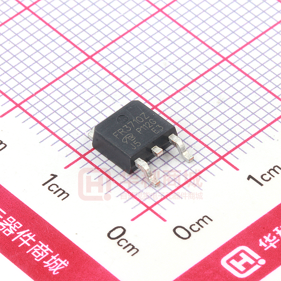

    MOSFETs N-沟道 100V 45A TO-252(DPAK)
IRFR3710ZTRPBF-VB 数据手册
IRFR3710ZTRPBF-VB www.VBsemi.com IRFR3710ZTRPBF-VB Datasheet N-Channel 100-V (D-S) MOSFET FEATURES PRODUCT SUMMARY VDS (V) RDS(on) () 100 0.0185 at VGS = 10 V ID (A)a 45 Qg (Typ.) 38 nC • Trench Power MOSFET • 100 % Rg and UIS Tested APPLICATIONS TO-252 D • Primary Side Switch • Isolated DC/DC Converter G G D S S N-Channel MOSFET Top View ABSOLUTE MAXIMUM RATINGS (TA = 25 °C, unless otherwise noted) Parameter Symbol Limit Drain-Source Voltage VDS 100 Gate-Source Voltage VGS ± 20 TC = 25 °C Continuous Drain Current (TJ = 150 °C) TC = 100 °C TA = 25 °C 45 Continuous Source-Drain Diode Current Single Pulse Avalanche Current Avalanche Energy TC = 25 °C TA = 25 °C L = 0.1 mH Maximum Power Dissipation TA = 25 °C 6.8b IDM 140 IS 45 2b IAS 35 EAS 101 A a mJ 136.4 68.2 PD W 3b 1.5b TA = 100 °C TJ, Tstg Operating Junction and Storage Temperature Range a 9.2b TC = 25 °C TC = 100 °C V 30 ID TA = 100 °C Pulsed Drain Current Unit °C - 55 to 175 THERMAL RESISTANCE RATINGS Parameter Maximum Junction-to-Ambient Symbol b Maximum Junction-to-Case Steady State Typical Maximum RthJA 40 50 RthJC 0.85 1.1 Unit °C/W Notes: a. Package limited. b. Surface mounted on 1" x 1" FR4 board. 服务热线:400-655-8788 1 IRFR3710ZTRPBF-VB www.VBsemi.com SPECIFICATIONS (TJ = 25 °C, unless otherwise noted) Parameter Symbol Test Conditions Min. VDS VGS = 0 V, ID = 250 µA 100 Typ. Max. Unit Static Drain-Source Breakdown Voltage VDS Temperature Coefficient VDS/TJ VGS(th) Temperature Coefficient VGS(th)/TJ Gate-Source Threshold Voltage ID = 250 µA VGS(th) VDS = VGS, ID = 250 µA Gate-Source Leakage IGSS VDS = 0 V, VGS = ± 20 V Zero Gate Voltage Drain Current IDSS On-State Drain Currenta Drain-Source On-State Resistancea V 110 mV/°C - 12.5 2.5 5 V ± 100 nA VDS = 100 V, VGS = 0 V 1 VDS = 100 V, VGS = 0 V, TJ = 125 °C 50 µA ID(on) VDS 5 V, VGS = 10 V RDS(on) VGS = 10 V, ID = 15 A 0.0185  gfs VDS = 15 V, ID = 15 A 33 S Forward Transconductancea 30 A Dynamicb Input Capacitance Ciss 2400 Output Capacitance Coss Reverse Transfer Capacitance Crss 80 Total Gate Charge Qg 38 Gate-Source Charge Qgs Gate-Drain Charge Qgd Gate Resistance Turn-On Delay Time VDS = 50 V, VGS = 10 V, ID = 50 A Rg f = 1 MHz VDD = 50 V, RL = 1  ID  50 A, VGEN = 10 V, Rg = 1  tr td(off) Fall Time 230 pF 70 14 nC 12 td(on) Rise Time Turn-Off Delay Time VDS = 50 V, VGS = 0 V, f = 1 MHz tf 1.6 2.5 12 20 10 20 18 35 8 15  ns Drain-Source Body Diode Characteristics Continuous Source-Drain Diode IS Pulse Diode Forward Currenta ISM Body Diode Voltage VSD Body Diode Reverse Recovery Time trr Body Diode Reverse Recovery Charge Qrr Reverse Recovery Fall Time ta Reverse Recovery Rise Time tb TC = 25 °C 35 100 IS = 15 A IF = 50 A, dI/dt = 100 A/µs, TJ = 25 °C A 0.85 1.5 V 80 120 ns 160 240 nC 57 23 ns Notes: a. Pulse test; pulse width  300 µs, duty cycle  2 %. b. Guaranteed by design, not subject to production testing. Stresses beyond those listed under “Absolute Maximum Ratings” may cause permanent damage to the device. These are stress ratings only, and functional operation of the device at these or any other conditions beyond those indicated in the operational sections of the specifications is not implied. Exposure to absolute maximum rating conditions for extended periods may affect device reliability. 2 服务热线:400-655-8788 IRFR3710ZTRPBF-VB www.VBsemi.com TYPICAL CHARACTERISTICS (25 °C, unless otherwise note) 100 2.0 VGS = 10 V thru 8 V 1.6 I D - Drain Current (A) I D - Drain Current (A) 80 VGS = 7 V 60 40 20 1.2 0.8 TC = 25 °C 0.4 VGS = 6 V TC = 125 °C TC = - 55 °C 0 0.0 0 1 2 3 4 5 0 2 4 6 8 VDS - Drain-to-Source Voltage (V) VGS - Gate-to-Source Voltage (V) Output Characteristics Transfer Characteristics 10 0.036 75 45 R DS(on) - On-Resistance (Ω) g fs - Transconductance (S) TC = - 55 °C 60 TC = 25 °C TC = 125 °C 30 15 0.027 VGS = 10 V 0.018 0.009 0.000 0 0 20 10 30 40 0 50 20 40 60 80 ID - Drain Current (A) ID - Drain Current (A) Transconductance On-Resistance vs. Drain Current 100 3500 0.10 2800 C - Capacitance (pF) R DS(on) - On-Resistance (Ω) ID = 15 A 0.08 0.06 0.04 TA = 150 °C Ciss 2100 1400 700 0.02 Coss TA = 25 °C 0 0.00 4 5 6 7 8 9 10 Crss 0 20 40 60 80 VGS - Gate-to-Source Voltage (V) VDS - Drain-to-Source Voltage (V) On-Resistance vs. Gate-to-Source Voltage Capacitance 服务热线:400-655-8788 100 3 IRFR3710ZTRPBF-VB www.VBsemi.com TYPICAL CHARACTERISTICS (25 °C, unless otherwise noted) 20 2.5 ID = 15 A VDS = 50 V 15 R DS(on) - On-Resistance (Normalized) VGS - Gate-to-Source Voltage (V) ID = 20 A VDS = 80 V 10 5 0 0 20 40 60 80 1.0 - 25 0 25 50 75 100 125 150 Qg - Total Gate Charge (nC) TJ - Junction Temperature (°C) Gate Charge On-Resistance vs. Junction Temperature 175 0.7 TJ = 150 °C 0.2 VGS(th) Variance (V) 10 I S - Source Current (A) VGS = 10 V 1.5 0.5 - 50 100 100 TJ = 25 °C 1 0.1 0.01 0.001 0.0 2.0 - 0.3 ID = 5 mA - 0.8 - 1.3 - 1.8 0.2 0.4 0.6 0.8 1.0 - 2.3 - 50 1.2 ID = 250 µA - 25 0 VSD - Source-to-Drain Voltage (V) 25 50 75 100 125 150 175 TJ - Temperature (°C) Source-Drain Diode Forward Voltage Threshold Voltage 600 300 500 240 Power (W) Power (W) 400 180 120 200 TA = 25 °C 60 0 0.001 TC = 25 °C 100 0 0.01 0.1 1 10 100 1000 Time (s) Single Pulse Power, Junction-to-Ambient 4 300 0 .001 0.01 0.1 1 10 Time (s) Single Pulse Power, Junction-to-Case 服务热线:400-655-8788 IRFR3710ZTRPBF-VB www.VBsemi.com TYPICAL CHARACTERISTICS (25 °C, unless otherwise noted) 1000 1000 10 1 ms 1 10 ms 100 ms 0.1 1s 10 s 100 s, DC TA = 25 °C Single Pulse 0.01 0.1 100 10 µs, 100 µs Limited by R DS(on)* I D - Drain Current (A) I D - Drain Current (A) 100 10 1.0 100 Limited by R DS(on)* 1 ms 10 ms 100 ms, DC 1 TC = 25 °C Single Pulse 0.01 0.1 10 1.0 100 1000 VDS - Drain-to-Source Voltage (V) * VGS > minimum VGS at which R DS(on) is specified VDS - Drain-to-Source Voltage (V) * VGS > minimum VGS at which R DS(on) is specified Safe Operating Area, Junction-to-Case Safe Operating Area, Junction-to-Ambient 60 10 50 I D - Drain Current (A) 8 I D - Drain Current (A) 100 µs 10 0.1 1000 10 µs 6 4 2 Package Limited 40 30 20 10 0 0 0 25 50 75 100 125 150 175 TA - Ambient Temperature (°C) Current Derating**, Junction-to-Ambient 0 25 50 75 100 125 150 175 TC - Case Temperature (°C) Current Derating**, Junction-to-Case ** The power dissipation PD is based on TJ(max.) = 175 °C, using junction-to-case thermal resistance, and is more useful in settling the upper dissipation limit for cases where additional heatsinking is used. It is used to determine the current rating, when this rating falls below the package limit. 服务热线:400-655-8788 5 IRFR3710ZTRPBF-VB www.VBsemi.com TYPICAL CHARACTERISTICS (25 °C, unless otherwise noted) 4.0 180 3.5 160 140 120 2.5 Power (W) Power (W) 3.0 2.0 1.5 100 80 60 1.0 40 0.5 20 0.0 0 0 25 50 75 100 125 150 TA - Ambient Temperature (°C) Power Derating**, Junction-to-Ambient 175 0 25 50 75 100 125 150 175 TC - Case Temperature (°C) Power Derating**, Junction-to-Case ** The power dissipation PD is based on TJ(max) = 175 °C, using junction-to-case thermal resistance, and is more useful in settling the upper dissipation limit for cases where additional heatsinking is used. It is used to determine the current rating, when this rating falls below the package limit. 6 服务热线:400-655-8788 IRFR3710ZTRPBF-VB www.VBsemi.com TYPICAL CHARACTERISTICS (25 °C, unless otherwise noted) Normalized Effective Transient Thermal Impedance 1 Duty Cycle = 0.5 0.2 0.1 Notes: 0.1 PDM t1 0.05 t2 1. Duty Cycle, D = t1 t2 2. Per Unit Base = RthJA = 50 °C/W 0.02 3. TJM - TA = PDMZthJA(t) Single Pulse 0.01 10 -4 10 -3 10 -2 4. Surface Mounted 10 -1 1 100 10 1000 Square Wave Pulse Duration (s) Normalized Thermal Transient Impedance, Junction-to-Ambient 1 Normalized Effective Transient Thermal Impedance Duty Cycle = 0.5 0.2 0.1 0.1 0.05 0.02 Single Pulse 0.01 10 -4 10 -3 10 -2 10 -1 1 Square Wave Pulse Duration (s) Normalized Thermal Transient Impedance, Junction-to-Case 服务热线:400-655-8788 7 IRFR3710ZTRPBF-VB www.VBsemi.com Disclaimer All products due to improve reliability, function or design or for other reasons, product specifications and data are subject to change without notice. Taiwan VBsemi Electronics Co., Ltd., branches, agents, employees, and all persons acting on its or their representatives (collectively, the "Taiwan VBsemi"), assumes no responsibility for any errors, inaccuracies or incomplete data contained in the table or any other any disclosure of any information related to the product.(www.VBsemi.com) Taiwan VBsemi makes no guarantee, representation or warranty on the product for any particular purpose of any goods or continuous production. To the maximum extent permitted by applicable law on Taiwan VBsemi relinquished: (1) any application and all liability arising out of or use of any products; (2) any and all liability, including but not limited to special, consequential damages or incidental ; (3) any and all implied warranties, including a particular purpose, non-infringement and merchantability guarantee. Statement on certain types of applications are based on knowledge of the product is often used in a typical application of the general product VBsemi Taiwan demand that the Taiwan VBsemi of. Statement on whether the product is suitable for a particular application is non-binding. It is the customer's responsibility to verify specific product features in the products described in the specification is appropriate for use in a particular application. Parameter data sheets and technical specifications can be provided may vary depending on the application and performance over time. All operating parameters, including typical parameters must be made by customer's technical experts validated for each customer application. Product specifications do not expand or modify Taiwan VBsemi purchasing terms and conditions, including but not limited to warranty herein. Unless expressly stated in writing, Taiwan VBsemi products are not intended for use in medical, life saving, or life sustaining applications or any other application. Wherein VBsemi product failure could lead to personal injury or death, use or sale of products used in Taiwan VBsemi such applications using client did not express their own risk. Contact your authorized Taiwan VBsemi people who are related to product design applications and other terms and conditions in writing. The information provided in this document and the company's products without a license, express or implied, by estoppel or otherwise, to any intellectual property rights granted to the VBsemi act or document. Product names and trademarks referred to herein are trademarks of their respective representatives will be all. Material Category Policy Taiwan VBsemi Electronics Co., Ltd., hereby certify that all of the products are determined to be oHS compliant and meets the definition of restrictions under Directive of the European Parliament 2011/65 / EU, 2011 Nian. 6. 8 Ri Yue restrict the use of certain hazardous substances in electrical and electronic equipment (EEE) - modification, unless otherwise specified as inconsistent.(www.VBsemi.com) Please note that some documents may still refer to Taiwan VBsemi RoHS Directive 2002/95 / EC. We confirm that all products identified as consistent with the Directive 2002/95 / EC European Directive 2011/65 /. Taiwan VBsemi Electronics Co., Ltd. hereby certify that all of its products comply identified as halogen-free halogen-free standards required by the JEDEC JS709A. Please note that some Taiwanese VBsemi documents still refer to the definition of IEC 61249-2-21, and we are sure that all products conform to confirm compliance with IEC 61249-2-21 standard level JS709A.
