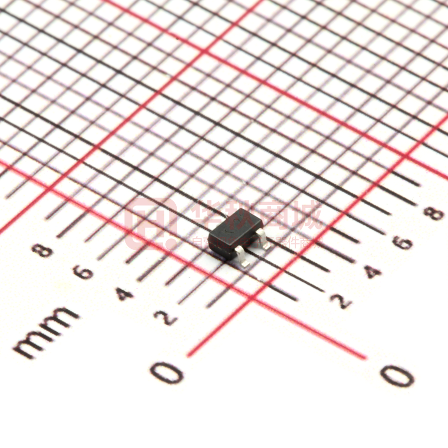

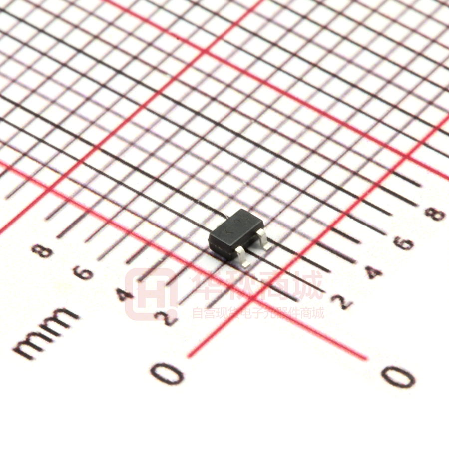

SI1304BDL-VB www.VBsemi.com SI1304BDL-VB Datasheet N-Channel 20 V (D-S) MOSFET FEATURES PRODUCT SUMMARY VDS (V) RDS(on) () ID (A)a 0.036 at VGS = 10 V 4 20 0.040 at VGS = 4.5 V 3.8 0.048 at VGS = 2.5 V 3.6 Qg (Typ.) 4 nC APPLICATIONS SOT-323 SC-70 (3-LEADS) G S D 1 3 • Halogen-free According to IEC 61249-2-21 Definition • Trench Power MOSFET • 100 % Rg Tested • Compliant to RoHS Directive 2002/95/EC D • Portable Devices - Load Switch - Battery Switch • Load Switch for Motors, Relays and Solenoids G 2 Top View S ABSOLUTE MAXIMUM RATINGS (TA = 25 °C, unless otherwise noted) Parameter Symbol Limit Drain-Source Voltage VDS 20 Gate-Source Voltage VGS ± 12 TC = 70 °C TA = 25 °C 3.6a ID 4a, b, c 3.7b, c TA = 70 °C IDM Pulsed Drain Current (t = 300 µs) TC = 25 °C Continuous Source-Drain Diode Current TA = 25 °C Maximum Power Dissipation TA = 25 °C 20 IS 1.3b, c 2.8 1.8 PD W 1.56b, c 1.0b, c TA = 70 °C TJ, Tstg Operating Junction and Storage Temperature Range A 2.3a TC = 25 °C TC = 70 °C V 4a TC = 25 °C Continuous Drain Current (TJ = 150 °C) Unit - 55 to 150 °C THERMAL RESISTANCE RATINGS Parameter Maximum Symbol Typical Maximum t5s RthJA 60 80 Steady State RthJF 34 45 Junction-to-Ambientb, d Maximum Junction-to-Foot (Drain) Unit °C/W Notes: a. Package limited, TC = 25 °C. b. Surface mounted on 1" x 1" FR4 board. c. t = 5 s. d. Maximum under steady state conditions is 125 °C/W. 服务热线:400-655-8788 1 SI1304BDL-VB www.VBsemi.com SPECIFICATIONS (TJ = 25 °C, unless otherwise noted) Parameter Symbol Test Conditions Min. VDS VGS = 0 V, ID = 250 µA 20 Typ. Max. Unit Static Drain-Source Breakdown Voltage VDS Temperature Coefficient VDS/TJ VGS(th) Temperature Coefficient VGS(th)/TJ Gate-Source Threshold Voltage VGS(th) Gate-Source Leakage IGSS Zero Gate Voltage Drain Current IDSS On-State Drain Currenta ID(on) Drain-Source On-State Resistancea Forward Transconductancea RDS(on) gfs ID = 250 µA VDS = VGS, ID = 250 µA V 23 mV/°C - 3.2 0.6 1.3 VDS = 0 V, VGS = ± 4.5 V ± 0.5 VDS = 0 V, VGS = ± 12 V ± 25 VDS = 20 V, VGS = 0 V 1 VDS = 20 V, VGS = 0 V, TJ = 55 °C VDS  5 V, VGS = 4.5 V V µA 10 15 A VGS = 10 V, ID = 3.7 A 0.036  VGS = 4.5 V, ID = 3.6 A 0.040 VGS = 2.5 V, ID = 1.5 A 0.048 VDS = 15 V, ID = 3.7 A 17 VDS = 15 V, VGS = 10 V, ID = 3.7 A 8.8 13.5 4 6 VDS = 15 V, VGS = 4.5 V, ID = 3.7 A 0.9 S Dynamicb Total Gate Charge Qg Gate-Source Charge Qgs Gate-Drain Charge Qgd Gate Resistance Rg Turn-On Delay Time Rise Time Turn-Off DelayTime Fall Time Turn-On Delay Time Rise Time Turn-Off DelayTime Fall Time 1.1 f = 1 MHz td(on) 0.4 2 4 0.29 0.58 0.4 0.8 1.9 3.8 tf 0.75 1.5 td(on) 0.1 0.2 0.15 0.3 tr td(off) tr td(off) nC VDD = 15 V, RL = 4.1  ID  3.7 A, VGEN = 4.5 V, Rg = 1  VDD = 15 V, RL = 4.1  ID  3.7 A, VGEN = 10 V, Rg = 1  tf 3 6 0.75 1.5 k µs Drain-Source Body Diode Characteristics Continuous Source-Drain Diode Current IS Pulse Diode Forward Current ISM Body Diode Voltage VSD Body Diode Reverse Recovery Time trr Body Diode Reverse Recovery Charge Qrr Reverse Recovery Fall Time ta Reverse Recovery Rise Time tb TC = 25 °C 2.3 20 IS = 3.7 A, VGS = 0 V IF = 3.7 A, dI/dt = 100 A/µs, TJ = 25 °C A 0.85 1.2 V 12 25 ns 5 10 nC 6.5 5.5 ns Notes: a. Pulse test; pulse width  300 µs, duty cycle  2 %. b. Guaranteed by design, not subject to production testing. Stresses beyond those listed under “Absolute Maximum Ratings” may cause permanent damage to the device. These are stress ratings only, and functional operation of the device at these or any other conditions beyond those indicated in the operational sections of the specifications is not implied. Exposure to absolute maximum rating conditions for extended periods may affect device reliability. 服务热线:400-655-8788 2 SI1304BDL-VB www.VBsemi.com TYPICAL CHARACTERISTICS (TA = 25 °C, unless otherwise noted) 40 1.E-01 1.E-03 30 IGSS - Gate Current (A) IGSS - Gate Current (mA) 1.E-02 20 TJ = 25 °C 1.E-04 TJ = 150 °C 1.E-05 1.E-06 TJ = 25 °C 1.E-07 10 1.E-08 1.E-09 0 1.E-10 0 3 12 9 6 0 18 15 3 6 9 12 15 18 VGS - Gate-to-Source Voltage (V) VGS - Gate-Source Voltage (V) Gate Current vs. Gate-to-Source Voltage Gate Current vs. Gate-to-Source Voltage 20 10 VGS = 5 V thru 3 V VGS = 2.5 V 8 ID - Drain Current (A) ID - Drain Current (A) 16 12 VGS = 2 V 8 4 6 TC = 25 °C 4 2 VGS = 1.5 V 0 0.0 0.5 1.0 1.5 2.0 2.5 0 0.0 3.0 0.5 1.0 2.0 VDS - Drain-to-Source Voltage (V) VGS - Gate-to-Source Voltage (V) Output Characteristics Transfer Characteristics 0.16 2.5 10 VGS - Gate-to-Source Voltage (V) ID = 3.7 A RDS(on) - On-Resistance (Ω) 1.5 0.12 VGS = 2.5 V 0.08 VGS = 4.5 V 0.04 VGS = 10 V 0 VDS = 15 V 8 VDS = 14 V 6 VDS = 7.5 V 4 2 0 0 4 8 12 16 ID - Drain Current (A) On-Resistance vs. Drain Current 20 0 2 4 6 8 10 Qg - Total Gate Charge (nC) Gate Charge 服务热线:400-655-8788 3 SI1304BDL-VB www.VBsemi.com TYPICAL CHARACTERISTICS (TA = 25 °C, unless otherwise noted) 1.6 100 VGS = 10 V; ID = 3.7 A 1.5 VGS = 4.5 V; ID = 3.7 A VGS = 2.5 V; ID = 1.5 A IS - Source Current (A) RDS(on) - On-Resistance (Normalized) 1.4 1.3 1.2 1.1 1.0 TJ = 150 °C 10 TJ = 25 °C 1 0.9 0.8 0.7 - 50 0.1 - 25 0 25 50 75 100 125 150 0.0 0.4 0.6 0.8 1.0 VSD - Source-to-Drain Voltage (V) Normalized On-Resistance vs. Junction Temperature Source-Drain Diode Forward Voltage 1.2 1.2 0.10 ID = 3.7 A 1.1 0.08 1.0 0.06 TJ = 125 °C VGS(th) (V) RDS(on) - On-Resistance (Ω) 0.2 TJ - Junction Temperature (°C) 0.04 0.9 ID = 250 μA 0.8 0.7 TJ = 25 °C 0.02 0.6 0 0.0 2.0 4.0 6.0 8.0 0.5 - 50 10.0 - 25 0 25 50 75 VGS - Gate-to-Source Voltage (V) TJ - Temperature (°C) On-Resistance vs. Gate-to-Source Voltage Threshold Voltage 100 125 150 100 30 Limited by RDS(on)* 25 ID - Drain Current (A) 10 Power (W) 20 15 10 100 μs 1 1 ms 10 ms 100 ms 1s 10 s DC 0.1 TA = 25 °C Single Pulse 5 BVDSS Limited 0 0.001 0.01 0.1 1 10 100 Time (s) Single Pulse Power, Junction-to-Ambient 1000 0.01 0.1 1 10 100 VDS - Drain-to-Source Voltage (V) * VGS > minimum VGS at which RDS(on) is specified Safe Operating Area, Junction-to-Ambient 服务热线:400-655-8788 4 SI1304BDL-VB www.VBsemi.com TYPICAL CHARACTERISTICS (TA = 25 °C, unless otherwise noted) 8 3.0 2.5 Power Dissipation (W) ID - Drain Current (A) 6 Package Limited 4 2.0 1.5 1.0 2 0.5 0 0.0 0 25 50 75 100 TC - Case Temperature (°C) Current Derating* 125 150 25 50 75 100 125 150 T F - Foot Temperature (°C) Power Derating * The power dissipation PD is based on TJ(max) = 150 °C, using junction-to-case thermal resistance, and is more useful in settling the upper dissipation limit for cases where additional heatsinking is used. It is used to determine the current rating, when this rating falls below the package limit. 服务热线:400-655-8788 5 SI1304BDL-VB www.VBsemi.com TYPICAL CHARACTERISTICS (TA = 25 °C, unless otherwise noted) 1 Normalized Effective Transient Thermal Impedance Duty Cycle = 0.5 0.2 0.1 Notes: 0.05 PDM 0.1 t1 0.02 t2 1. Duty Cycle, D = t1 t2 2. Per Unit Base = R thJA = 125 °C/W 3. T JM - TA = PDMZthJA(t) Single Pulse 0.01 10 -4 4. Surface Mounted 10 -3 10 -2 10 -1 1 100 10 1000 Square Wave Pulse Duration (s) Normalized Thermal Transient Impedance, Junction-to-Ambient 1 Normalized Effective Transient Thermal Impedance Duty Cycle = 0.5 0.2 0.1 0.1 0.05 0.02 Single Pulse 0.01 10 -4 10 -3 10 -2 10 -1 1 10 Square Wave Pulse Duration (s) Normalized Thermal Transient Impedance, Junction-to-Foot 服务热线:400-655-8788 6 SI1304BDL-VB www.VBsemi.com SCĆ70: 3ĆLEADS MILLIMETERS 3 E1 E 1 2 e b e1 D c A2 A L 0.08 c A1 Dim A A1 A2 b c D E E1 e e1 L INCHES Min Nom Max Min Nom Max 0.90 – 1.10 0.035 – 0.043 – – 0.10 – – 0.004 0.80 – 1.00 0.031 – 0.039 0.25 – 0.40 0.010 – 0.016 0.10 – 0.25 0.004 – 0.010 1.80 2.00 2.20 0.071 0.079 0.087 1.80 2.10 2.40 0.071 0.083 0.094 1.15 1.25 1.35 0.045 0.049 0.053 0.65BSC 0.026BSC 1.20 1.30 1.40 0.047 0.051 0.055 0.10 0.20 0.30 0.004 0.008 0.012 7_Nom 7_Nom ECN: S-03946—Rev. C, 09-Jul-01 DWG: 5549 服务热线:400-655-8788 7 SI1304BDL-VB www.VBsemi.com 0.045 (1.143) (0.648) 0.022 (0.559) 0.026 0.025 (0.622) (2.438) 0.096 RECOMMENDED MINIMUM PADS FOR SC-70: 3-Lead 0.027 (0.686) 0.071 (1.803) Recommended Minimum Pads Dimensions in Inches/(mm) 8 服务热线:400-655-8788 SI1304BDL-VB www.VBsemi.com Disclaimer All products due to improve reliability, function or design or for other reasons, product specifications and data are subject to change without notice. Taiwan VBsemi Electronics Co., Ltd., branches, agents, employees, and all persons acting on its or their representatives (collectively, the "Taiwan VBsemi"), assumes no responsibility for any errors, inaccuracies or incomplete data contained in the table or any other any disclosure of any information related to the product.(www.VBsemi.com) Taiwan VBsemi makes no guarantee, representation or warranty on the product for any particular purpose of any goods or continuous production. To the maximum extent permitted by applicable law on Taiwan VBsemi relinquished: (1) any application and all liability arising out of or use of any products; (2) any and all liability, including but not limited to special, consequential damages or incidental ; (3) any and all implied warranties, including a particular purpose, non-infringement and merchantability guarantee. Statement on certain types of applications are based on knowledge of the product is often used in a typical application of the general product VBsemi Taiwan demand that the Taiwan VBsemi of. Statement on whether the product is suitable for a particular application is non-binding. It is the customer's responsibility to verify specific product features in the products described in the specification is appropriate for use in a particular application. Parameter data sheets and technical specifications can be provided may vary depending on the application and performance over time. All operating parameters, including typical parameters must be made by customer's technical experts validated for each customer application. Product specifications do not expand or modify Taiwan VBsemi purchasing terms and conditions, including but not limited to warranty herein. Unless expressly stated in writing, Taiwan VBsemi products are not intended for use in medical, life saving, or life sustaining applications or any other application. Wherein VBsemi product failure could lead to personal injury or death, use or sale of products used in Taiwan VBsemi such applications using client did not express their own risk. Contact your authorized Taiwan VBsemi people who are related to product design applications and other terms and conditions in writing. The information provided in this document and the company's products without a license, express or implied, by estoppel or otherwise, to any intellectual property rights granted to the VBsemi act or document. Product names and trademarks referred to herein are trademarks of their respective representatives will be all. Material Category Policy Taiwan VBsemi Electronics Co., Ltd., hereby certify that all of the products are determined to be RoHS compliant and meets the definition of restrictions under Directive of the European Parliament 2011/65 / EU, 2011 Nian. 6. 8 Ri Yue restrict the use of certain hazardous substances in electrical and electronic equipment (EEE) - modification, unless otherwise specified as inconsistent.(www.VBsemi.com) Please note that some documents may still refer to Taiwan VBsemi RoHS Directive 2002/95 / EC. We confirm that all products identified as consistent with the Directive 2002/95 / EC European Directive 2011/65 /. Taiwan VBsemi Electronics Co., Ltd. hereby certify that all of its products comply identified as halogen-free halogen-free standards required by the JEDEC JS709A. Please note that some Taiwanese VBsemi documents still refer to the definition of IEC 61249-2-21, and we are sure that all products conform to confirm compliance with IEC 61249-2-21 standard level JS709A.
