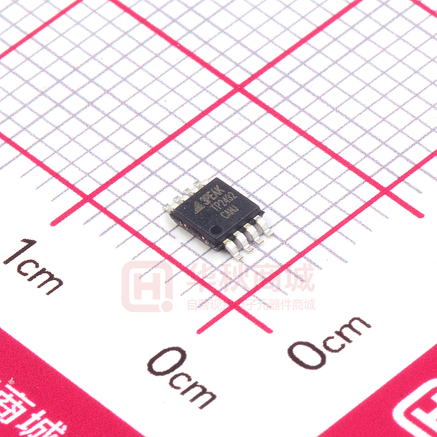

TP2432-VR
TP2432-VR
    3PEAK(思瑞浦)
    MSOP-8
    运算放大器 MSOP-8
TP2432-VR 数据手册
3PEAK TP2431/TP2432 /TP2434 1.6MHz Bandwidth, Micropower Low Noise Op-amps Features Description ◼ Low Noise: 13nV/√Hz(f= 1kHz) ◼ Supply Current: 190μA/ch ◼ Offset Voltage: 1 mV (max) ◼ Low THD+N: 0.0005% ◼ Supply Range: 2.2V to 5.5V ◼ Low Input Bias Current: 0.3pA Typical ◼ EMIRR IN+: 85 dB( under 2.4GHz) ◼ Slew Rate: 0.9 V/μs ◼ Gain-bandwidth Product: 1.6MHz ◼ Rail-to-Rail I/O ◼ High Output Current: 70mA (1.0V Drop) ◼ –40°C to 125°C Operation Range The single TP2431, dual TP2432, and quad TP2434 operational amplifiers combine excellent DC accuracy with Rail-to-Rail operation at the input and output. Since the common-mode voltage extends from VCC to VEE, the devices can operate from either a single supply (2.2V to 5.5V) or split supplies (±1.1V to ±2.75V). Each op amp requires less than 190μA of supply current. Even with this low current, the op amps are capable of driving a 1kΩ load, and the input-referred voltage noise is only 13nV/√Hz. In addition, these op amps can drive loads in excess of 2000pF. The precision performance of the TP2431/TP2432/ TP2434 combined with their wide input and output dynamic range, low-voltage, single-supply operation, and very low supply current, make them an ideal choice for battery-operated equipment, industrial, and data acquisition and control applications. Applications The TP2431 is single channel version available in 8-pin SOP and 5-pin SOT23 packages. The TP2432 is dual channel version available in 8-pin SOP and MSOP packages. The TP2434 is quad channel version available in 14-pin SOP and TSSOP packages. ⚫ Portable Equipment ⚫ Battery-Powered Instruments ⚫ Data Acquisition and Control ⚫ Low-Voltage Signal Conditioning ⚫ Communications ⚫ Security 3PEAK and the 3PEAK logo are registered trademarks of 3PEAK INCORPORATED. All other trademarks are the property of their respective owners. Pin Configuration (Top View) TP2432 8-Pin SOP/MSOP (-S Suffix) (-S and -V Suffixes) NC 1 8 NC Out A 1 ﹣In 2 7 ﹢Vs ﹣In A 2 ﹢In 3 6 Out ﹢In A 3 ﹣Vs 4 5 NC ﹣Vs 4 Out 1 ﹣Vs 2 +In 3 A B 8 ﹢Vs 7 Out B 6 ﹣In B 5 ﹢In B TP2431 5-Pin SOT23 TP2434 14-Pin SOP/TSSOP (-T Suffix) (-S and -T Suffixes) 5 ﹢Vs Out A ﹣In A 1 2 A 4 -In TP2431U 5-Pin SOT23 -T Suffixes 1 - Vs 2 -In 3 5 14 Out D 13 ﹣In D D 3 12 ﹢In D ﹢Vs 4 11 ﹣Vs ﹢In B 5 10 ﹢In C ﹣In B 6 9 ﹣In C Out B 7 8 Out C + Vs 0.15 0.1 0.05 C 0 1.5 2.5 3.5 4.5 Supply Voltage (V) A +In 0.25 0.2 ﹢In A B Quiescent Current vs. Supply Voltage Supply current (mA) TP2431 8-Pin SOP 4 OUT Order Information www.3peak.com Rev. C.3 1 TP2431 / TP2432 / TP2434 1.6MHz Bandwidth, Micropower Low Noise Op-amps Model Name TP2431 TP2432 TP2434 Order Number Package Marking Information Transport Media, Quantity TP2431-TR 5-Pin SOT23 Tape and Reel, 3,000 431 TP2431U-TR 5-Pin SOT23 Tape and Reel, 3,000 43U TP2432-SR 8-Pin SOP Tape and Reel, 4,000 TP2432 TP2432-VR 8-Pin MSOP Tape and Reel, 3,000 TP2432 TP2434-SR 14-Pin SOP Tape and Reel, 2,500 TP2434 TP2434-TR 14-Pin TSSOP Tape and Reel, 3,000 TP2434 Absolute Maximum Ratings Note 1 Supply Voltage: V+ – V– Note 2............................7.0V Current at Supply Pins……………............... ±60mA Input Voltage............................. V– – 0.3 to V+ + 0.3 Operating Temperature Range........–40°C to 125°C Input Current: +IN, –IN Note 3.......................... ±20mA Maximum Junction Temperature................... 150°C Output Current: OUT.................................... ±160mA Storage Temperature Range.......... –65°C to 150°C Output Short-Circuit Duration Note 4…......... Indefinite Lead Temperature (Soldering, 10 sec) ......... 260°C Note 1: Stresses beyond those listed under Absolute Maximum Ratings may cause permanent damage to the device. Exposure to any Absolute Maximum Rating condition for extended periods may affect device reliability and lifetime. Note 2: The op amp supplies must be established simultaneously, with, or before, the application of any input signals. Note 3: The inputs are protected by ESD protection diodes to each power supply. If the input extends more than 500mV beyond the power supply, the input current should be limited to less than 10mA. Note 4: A heat sink may be required to keep the junction temperature below the absolute maximum. This depends on the power supply voltage and how many amplifiers are shorted. Thermal resistance varies with the amount of PC board metal connected to the package. The specified values are for short traces connected to the leads. ESD, Electrostatic Discharge Protection Symbol Parameter Condition HBM Human Body Model ESD ANSI/ESDA/JEDEC JS-001 4 kV CDM Charged Device Model ESD ANSI/ESDA/JEDEC JS-002 1 kV Thermal Resistance 2 Package Type θJA θJC Unit 5-Pin SOT23 250 81 ° C/W 8-Pin SOP 158 43 ° C/W 8-Pin MSOP 210 45 ° C/W 14-Pin SOP 120 36 ° C/W 14-Pin TSSOP 180 35 ° C/W Rev. C.3 www.3peakic.com.cn Minimum Level Unit TP2431/TP2432 / TP2434 1.6MHz Bandwidth, Micropower Low Noise Op-amps Electrical Characteristics The specifications are at TA = 27° C. VS = +2.7 V to +5.5 V, or ± 1.35 V to ± 2.75 V, RL = 2kΩ, CL =100pF.Unless otherwise noted. SYMBOL VOS VOS TC IB PARAMETER CONDITIONS Input Offset Voltage VCM = VDD/2 Input Offset Voltage Drift -40° C to 125° C Input Bias Current MIN TYP MAX UNITS -1 ± 0.3 +1 mV 1 2 μV/° C TA = 27 ° C 0.3 pA TA = 85 ° C 150 pA TA = 125 ° C 300 pA 0.001 pA IOS Input Offset Current Vn Input Voltage Noise f = 0.1Hz to 10Hz 4.1 μVPP en in Input Voltage Noise Density Input Current Noise 13 nV/√Hz fA/√Hz CIN Input Capacitance f = 1kHz f = 1kHz Differential Common Mode VCM = 2V to 3V CMRR PSRR Common Mode Rejection Ratio Common-mode Input Voltage Range Power Supply Rejection Ratio AVOL VCM 85 2 7.76 6.87 110 V– -0.1 pF dB V++0.1 V VCM = 2.5V, VS = 4.8V to 5V 75 100 dB Open-Loop Large Signal Gain RLOAD = 2kΩ 100 130 dB VOL, VOH Output Swing from Supply Rail RLOAD = 2kΩ ROUT Closed-Loop Output Impedance G = 1, f =1kHz, IOUT = 0 RO Open-Loop Output Impedance f = 1kHz, IOUT = 0 ISC Output Short-Circuit Current Sink or source current VDD Supply Voltage IQ 15 95 mV 0.002 Ω 125 Ω 130 mA 2.2 Quiescent Current per Amplifier 45 190 5.5 V 280 μA PM Phase Margin RLOAD = 1kΩ, CLOAD = 60pF 80 ° GM Gain Margin RLOAD = 1kΩ, CLOAD = 60pF 15 dB Gain-Bandwidth Product f = 1kHz AV = 1, VOUT = 1.5V to 3.5V, CLOAD = 60pF, RLOAD = 1kΩ 1.6 MHz 0.84 V/μs 58.6 4.4 4.4 kHz 0.0003 % 110 dB GBWP SR FPBW tS THD+N Xtalk Slew Rate Full Power Bandwidth Note 1 Settling Time, 0.1% Settling Time, 0.01% Total Harmonic Distortion and Noise Channel Separation AV = –1, 1V Step f = 1kHz, AV =1, RL = 2kΩ, VOUT = 1Vp-p f = 1kHz, RL = 2kΩ 0.36 μs Note 1: Full power bandwidth is calculated from the slew rate FPBW = SR/π • VP-P www.3peak.com Rev. C.3 3 TP2431 / TP2432 / TP2434 1.6MHz Bandwidth, Micropower Low Noise Op-amps Typical Performance Characteristics VS = ±2.75V, VCM = 0V, RL = Open, unless otherwise specified. Offset Voltage Production Distribution Unity Gain Bandwidth vs. Temperature 2.5 5000 4500 2 4000 GBW(MHz) Population 3500 3000 2500 2000 1.5 1 1500 0.5 1000 500 0 0 -50 0 50 100 150 Temperature(℃) Offset Voltage(uV) Input Voltage Noise Spectral Density 130 200 110 150 90 100 70 50 50 0 30 -50 10 -100 -10 -150 -30 -200 -50 1000 Noise(nV/√Hz) VCC= +5V RL= 1kΩ Phase (°) Gain(dB) Open-Loop Gain and Phase 100 10 -250 0.1 10 1k 100k 1 10M 1 10 Frequency (Hz) 1k 10k 100k 1M Frequency(Hz) Input Bias Current vs. Temperature Input Bias Current vs. Input Common Mode Voltage 5.00E-16 1.00E-11 Input Bias Current(A) 1.00E-13 Input Bias Current(A) 100 1.00E-15 5.00E-17 1.00E-17 1.00E-19 5.00E-18 1.00E-21 -10 10 30 50 70 90 110 Temperature(℃) 4 Rev. C.3 www.3peakic.com.cn 130 150 0 1 2 3 4 Common Mode Voltage(V) 5 6 TP2431/TP2432 / TP2434 1.6MHz Bandwidth, Micropower Low Noise Op-amps Typical Performance Characteristics VS = ±2.75V, VCM = 0V, RL = Open, unless otherwise specified. (Continued) Common Mode Rejection Ratio CMRR vs. Frequency 140 120 120 100 100 CMRR(dB) CMRR(dB) 140 80 60 80 60 40 40 20 20 0 0 0 1 2 3 1 4 10 100 1k 10k 100k 1M 10M Frequency(Hz) Common Mode Voltage(V) Quiescent Current vs. Temperature Short Circuit Current vs. Temperature 180 0.205 160 ISINK 140 120 Ishort(mA) Supply current(mA) 0.2 0.195 0.19 ISOURCE 100 80 60 40 0.185 20 0 0.18 -50 -25 0 25 50 75 100 125 -50 150 0 50 150 Temperature(℃) Temperature(℃) Power-Supply Rejection Ratio Quiescent Current vs. Supply Voltage 0.25 120 100 Supply current (mA) 0.2 80 PSRR(dB) 100 PSRR+ 60 PSRR- 40 0.15 0.1 0.05 20 0 1 10 100 1k 10k Frequency(Hz) www.3peak.com 100k 1M 10M 0 1.5 2.5 3.5 4.5 Supply Voltage (V) Rev. C.3 5 TP2431 / TP2432 / TP2434 1.6MHz Bandwidth, Micropower Low Noise Op-amps Typical Performance Characteristics VS = ±2.75V, VCM = 0V, RL = Open, unless otherwise specified. (Continued) Power-Supply Rejection Ratio vs. Temperature CMRR vs. Temperature 140 120 120 100 CMRR(-dB) PSRR(-dB) 100 80 60 80 60 40 40 20 20 0 0 -50 0 50 100 -50 150 0 50 100 Temperature(℃) Temperature(℃) EMIRR IN+ vs. Frequency Large-Scale Step Response 140 Output Voltage (2V/div) EMIRR IN+ (dB) 120 100 80 60 40 20 Gain= +1 RL= 10kΩ 0 10 100 1000 10000 Frequency (MHz) Time (10ms/div) Time (5μs/div) 6 2V/div Positive Over-Voltage Recovery Gain= +10 ±V= ±2.5V 1V/div Gain= +10 ±V= ±2.5V 1V/div 2V/div Negative Over-Voltage Recovery Rev. C.3 www.3peakic.com.cn Time (5μs/div) 150 TP2431/TP2432 / TP2434 1.6MHz Bandwidth, Micropower Low Noise Op-amps Typical Performance Characteristics VS = ±2.75V, VCM = 0V, RL = Open, unless otherwise specified. (Continued) 0.1 Hz TO 10 Hz Input Voltage Noise Offset Voltage vs Common-Mode Voltage 200 Vcc=±2.5V -200 Offset voltage(μV) Output Voltage (2μV/div) 0 -400 -600 -800 -1000 -1200 -2.5 Time (1s/div) -0.5 0.5 1.5 2.5 Common-mode voltage(V) Positive Output Swing vs. Load Current Negative Output Swing vs. Load Current 0 140 -20 -40℃ 120 25℃ 100 -40 -60 +125℃ Iout(mA) Iout(mA) -1.5 80 60 -80 -100 -120 +125℃ -140 40 25℃ -160 20 -180 0 -40℃ -200 0 1 2 3 Vout Dropout (V) www.3peak.com 4 5 0 1 2 3 4 5 Vout Dropout (V) Rev. C.3 7 TP2431 / TP2432 / TP2434 1.6MHz Bandwidth, Micropower Low Noise Op-amps Pin Functions -IN: Inverting Input of the Amplifier. possible should be used between power supply pins or +IN: Non-Inverting Input of Amplifier. between supply pins and ground. OUT: Amplifier Output. The voltage range extends to V- or -Vs: Negative Power Supply. It is normally tied to within mV of each supply rail. ground. It can also be tied to a voltage other than V+ or +Vs: Positive Power Supply. Typically the voltage ground as long as the voltage between V+ and V– is from is from 2.2V to 5.5V. Split supplies are possible as long 2.2V to 5.5V. If it is not connected to ground, bypass it as the voltage between V+ and V– is between 2.2V and with a capacitor of 0.1μF as close to the part as possible. 5.5V. A bypass capacitor of 0.1μF as close to the part as Operation The TP2431/TP2432/TP2434 can operate from a single +2.2V to +5.5V power supply, or from ±1.1V to ±2.75V power supplies. The power supply pin(s) must be bypassed to ground with a 0.1μF capacitor as close to the pin as possible. The single TP2431, dual TP2432 and quad TP2434 op amps combine excellent DC accuracy with rail-to-rail operation at both input and output. With their precision performance, wide dynamic range at low supply voltages, and very low supply current, these op amps are ideal for battery-operated equipment, industrial, and data acquisition and control applications. Applications Information Rail-to-Rail Inputs and Outputs The TP243x op amps are designed to be immune to phase reversal when the input pins exceed the supply voltages, therefore providing further in-system stability and predictability. Figure 1 shows the input voltage exceeding the supply voltage without any phase reversal. Figure 1. No Phase Reversal Input ESD Diode Protection The TP2431 incorporates internal electrostatic discharge (ESD) protection circuits on all pins. In the case of input and output pins, this protection primarily consists of current-steering diodes connected between the input and power-supply pins. These ESD protection diodes also provide in-circuit input overdrive protection, as long as the current is limited to 10 mA as stated in the Absolute Maximum Ratings table. Many input signals are inherently current-limited to less than 10 mA; therefore, a limiting resistor is not required. Figure 2 shows how a series input resistor (RS) may be added to the driven input to limit the input current. The added resistor contributes thermal noise at the amplifier input and the 8 Rev. C.3 www.3peakic.com.cn TP2431/TP2432 / TP2434 1.6MHz Bandwidth, Micropower Low Noise Op-amps value should be kept to the minimum in noise-sensitive applications. Current-limiting resistor required if input voltage exceeds supply rails by >0.5V. V+ 500Ω IN+ +2.5V Ioverload 10mA max TP2431 500Ω VIN IN- Vout 5kΩ -2.5V VINPUT ESD DIODE CURRENT LIMITING- UNITY GAIN Figure 2. Input ESD Diode EMI Susceptibility and Input Filtering Operational amplifiers vary in susceptibility to electromagnetic interference (EMI). If conducted EMI enters the device, the dc offset observed at the amplifier output may shift from the nominal value while EMI is present. This shift is a result of signal rectification associated with the internal semiconductor junctions. While all operational amplifier pin functions can be affected by EMI, the input pins are likely to be the most susceptible. The TP2431 operational amplifier family incorporates an internal input low-pass filter that reduces the amplifier response to EMI. Both common-mode and differential mode filtering are provided by the input filter. The filter is designed for a cutoff frequency of approximately 400 MHz (–3 dB), with a roll-off of 20 dB per decade. 140 EMIRR IN+ (dB) 120 100 80 60 40 20 0 10 100 1000 10000 Frequency (MHz) Figure 3. TP2431 EMIRR IN+ vs Frequency PCB Surface Leakage In applications where low input bias current is critical, Printed Circuit Board (PCB) surface leakage effects need to be considered. Surface leakage is caused by humidity, dust or other contamination on the board. Under low humidity conditions, a typical resistance between nearby traces is 1012Ω. A 5V difference would cause 5pA of current to flow, which is greater than the TP2431/2432/2434 OPA’s input bias current at +27°C (±0.3pA, typical). It is recommended to use multi-layer PCB layout and route the OPA’s -IN and +IN signal under the PCB surface. www.3peak.com Rev. C.3 9 TP2431 / TP2432 / TP2434 1.6MHz Bandwidth, Micropower Low Noise Op-amps The effective way to reduce surface leakage is to use a guard ring around sensitive pins (or traces). The guard ring is biased at the same voltage as the sensitive pin. An example of this type of layout is shown in Figure 6 for Inverting Gain application. 1. For Non-Inverting Gain and Unity-Gain Buffer: a) Connect the non-inverting pin (VIN+) to the input with a wire that does not touch the PCB surface. b) Connect the guard ring to the inverting input pin (VIN–). This biases the guard ring to the Common Mode input voltage. 2. For Inverting Gain and Trans-impedance Gain Amplifiers (convert current to voltage, such as photo detectors): a) Connect the guard ring to the non-inverting input pin (VIN+). This biases the guard ring to the same reference voltage as the op-amp (e.g., VDD/2 or ground). b) Connect the inverting pin (VIN–) to the input with a wire that does not touch the PCB surface. Guard Ring VIN+ VIN- +VS Figure 4 The Layout of Guard Ring Power Supply Layout and Bypass The TP2431/2432/2432 OPA’s power supply pin (VDD for single-supply) should have a local bypass capacitor (i.e., 0.01μF to 0.1μF) within 2mm for good high frequency performance. It can also use a bulk capacitor (i.e., 1μF or larger) within 100mm to provide large, slow currents. This bulk capacitor can be shared with other analog parts. Ground layout improves performance by decreasing the amount of stray capacitance and noise at the OPA’s inputs and outputs. To decrease stray capacitance, minimize PC board lengths and resistor leads, and place external components as close to the op amps’ pins as possible. Proper Board Layout To ensure optimum performance at the PCB level, care must be taken in the design of the board layout. To avoid leakage currents, the surface of the board should be kept clean and free of moisture. Coating the surface creates a barrier to moisture accumulation and helps reduce parasitic resistance on the board. Keeping supply traces short and properly bypassing the power supplies minimizes power supply disturbances due to output current variation, such as when driving an ac signal into a heavy load. Bypass capacitors should be connected as closely as possible to the device supply pins. Stray capacitances are a concern at the outputs and the inputs of the amplifier. It is recommended that signal traces be kept at least 5mm from supply lines to minimize coupling. A variation in temperature across the PCB can cause a mismatch in the Seebeck voltages at solder joints and other points where dissimilar metals are in contact, resulting in thermal voltage errors. To minimize these thermocouple effects, orient resistors so heat sources warm both ends equally. Input signal paths should contain matching numbers and types of components, where possible to match the number and type of thermocouple junctions. For example, dummy components such as zero value resistors can be used to match real resistors in the opposite input path. Matching components should be located in close proximity and should be oriented in the same manner. Ensure leads are of equal length so that thermal conduction is in equilibrium. Keep heat sources on the PCB as far away from amplifier input circuitry as is practical. The use of a ground plane is highly recommended. A ground plane reduces EMI noise and also helps to maintain a constant temperature across the circuit board. 10 Rev. C.3 www.3peakic.com.cn TP2431/TP2432 / TP2434 1.6MHz Bandwidth, Micropower Low Noise Op-amps Package Outline Dimensions SOT23-5 www.3peak.com Rev. C.3 11 TP2431 / TP2432 / TP2434 1.6MHz Bandwidth, Micropower Low Noise Op-amps Package Outline Dimensions SOP-8 A2 C θ L1 A1 e E D Symbol E1 b 12 Rev. C.3 www.3peakic.com.cn Dimensions Dimensions In In Millimeters Inches Min Max Min Max A1 0.100 0.250 0.004 0.010 A2 1.350 1.550 0.053 0.061 b 0.330 0.510 0.013 0.020 C 0.190 0.250 0.007 0.010 D 4.780 5.000 0.188 0.197 E 3.800 4.000 0.150 0.157 E1 5.800 6.300 0.228 0.248 e 1.270 TYP 0.050 TYP L1 0.400 1.270 0.016 0.050 θ 0° 8° 0° 8° TP2431/TP2432 / TP2434 1.6MHz Bandwidth, Micropower Low Noise Op-amps Package Outline Dimensions MSOP-8 Dimensions Dimensions In In Millimeters Inches Min Max Min Max A 0.800 1.200 0.031 0.047 A1 0.000 0.200 0.000 0.008 A2 0.760 0.970 0.030 0.038 b 0.30 TYP 0.012 TYP C 0.15 TYP 0.006 TYP D 2.900 e 0.65 TYP E 2.900 3.100 0.114 0.122 E1 4.700 5.100 0.185 0.201 L1 0.410 0.650 0.016 0.026 θ 0° 6° 0° 6° Symbol E E1 A A2 e b D 3.100 0.114 0.122 0.026 A1 R1 R θ L1 www.3peak.com L L2 Rev. C.3 13 TP2431 / TP2432 / TP2434 1.6MHz Bandwidth, Micropower Low Noise Op-amps Package Outline Dimensions TSSOP-14 Dimensions In Millimeters Symbol MIN TYP MAX A - - 1.20 A1 0.05 - 0.15 A2 0.80 0.90 1.05 b 0.19 - 0.30 C 0.09 - 0.20 D 4.86 4.96 5.10 E 4.30 4.40 4.50 E1 6.20 6.40 6.60 e L 0.65 BSC 0.45 H θ 14 Rev. C.3 www.3peakic.com.cn 0.60 0.75 0.25 BSC 0° - 8° TP2431/TP2432 / TP2434 1.6MHz Bandwidth, Micropower Low Noise Op-amps Package Outline Dimensions SOP-14 D E1 Dimensions E In Millimeters Symbol e b A A2 A1 MIN TYP MAX A 1.35 1.60 1.75 A1 0.10 0.15 0.25 A2 1.25 1.45 1.65 b 0.36 D 8.53 8.63 8.73 E 5.80 6.00 6.20 E1 3.80 3.90 4.00 e L www.3peak.com 1.27 BSC 0.45 0.60 L1 1.04 REF L2 0.25 BSC θ L L1 0.49 0° 0.80 8° θ L2 Rev. C.3 15 TP2431 / TP2432 / TP2434 1.6MHz Bandwidth, Micropower Low Noise Op-amps Revision History Date Revision Notes 2022/4/30 C.2 Update order information. 2023/7/18 C.3 The following updates are all about the new datasheet formats or typo, the actual product remains unchanged. Remove the maximum value of IB at TA = 27 °C due to test coverage. IMPORTANT NOTICE AND DISCLAIMER Copyright© 3PEAK 2012-2023. All rights reserved. Trademarks. Any of the 思瑞浦 or 3PEAK trade names, trademarks, graphic marks, and domain names contained in this document /material are the property of 3PEAK. You may NOT reproduce, modify, publish, transmit or distribute any Trademark without the prior written consent of 3PEAK. Performance Information. Performance tests or performance range contained in this document/material are either results of design simulation or actual tests conducted under designated testing environment. Any variation in testing environment or simulation environment, including but not limited to testing method, testing process or testing temperature, may affect actual performance of the product. Disclaimer. 3PEAK provides technical and reliability data (including data sheets), design resources (including reference designs), application or other design recommendations, networking tools, security information and other resources "As Is". 3PEAK makes no warranty as to the absence of defects, and makes no warranties of any kind, express or implied, including without limitation, implied warranties as to merchantability, fitness for a particular purpose or non-infringement of any third-party’s intellectual property rights. Unless otherwise specified in writing, products supplied by 3PEAK are not designed to be used in any life-threatening scenarios, including critical medical applications, automotive safety-critical systems, aviation, aerospace, or any situations where failure could result in bodily harm, loss of life, or significant property damage. 3PEAK disclaims all liability for any such unauthorized use. 16 Rev. C.3 www.3peakic.com.cn
