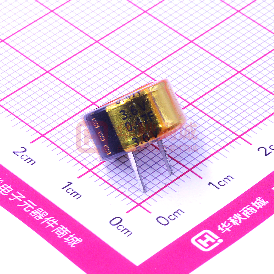

Coin Cell Series
CBH (3.6 V) 系列
Introduction
Applications
Ø12.5 Ø11.5 Coin High temperature, Long life type
Able to be used at wide temperature from -25℃ to 85℃
Long life Endurance : 2,000 hours at +85℃
RoHS directive compliant
Memory back-up for video and
audio
equipment,
cameras,
printers, flash, tuners, TV, rice
cookers and remote controls
