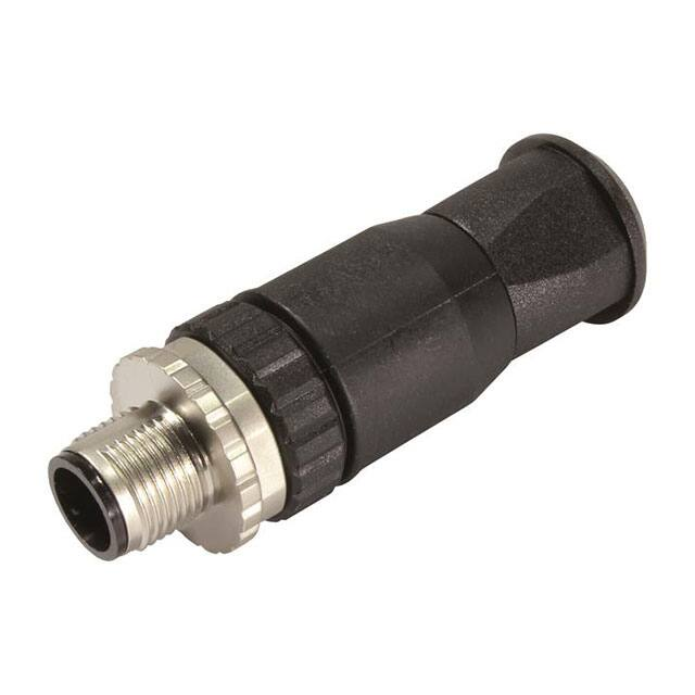

M8 with screw termination Technical characteristics M8 Type 3 poles 4 poles max. 0.5 mm² max. AWG 20 max. 0.5 mm² max. AWG 20 General data Conductor cross section Cable diameter 4 – 5.5 mm 4 – 5.5 mm Temperature range -30 °C … +85 °C -30 °C … +85 °C Degree of protection IP67 IP67 Mating cycles ≥ 100 ≥ 100 Recommended tightening torque / Hexagonal wrench Knurled screw / nut 0.4 Nm / SW 13 0.4 Nm / SW 13 Recommended tightening torque screw termination 0.1 Nm 0.1 Nm Rated current 4 A @ 40 °C 4 A @ 40 °C Rated voltage 60 V 30 V Electrical characteristics Materials Contact material Brass Brass Contact plating Gold Gold Contact carrier material PA PA Housing material PA, zinc die-cast (shielded) PA, zinc die-cast (shielded) Material knurled screw / nut Zinc die-cast Zinc die-cast Further information and data sheets see www.HARTING.com 87 M8 with screw termination, unshielded Male, 3 poles   Male, 4 poles Female, 3 poles    Female, 4 poles Identification Part number M8 screw, unshielded 88 Male, straight version 3 poles 4 poles 21 02 359 1301 21 02 359 1401 Male, angled version 3 poles 4 poles 21 02 359 3301 21 02 359 3401 Female, straight version 3 poles 4 poles 21 02 359 2301 21 02 359 2401 Female, angled version 3 poles 4 poles 21 02 359 4301 21 02 359 4401 Further information and data sheets see www.HARTING.com Drawing Dimensions in mm M8 with screw termination, shielded Male, 3 poles   Male, 4 poles Female, 3 poles    Female, 4 poles Identification Part number Drawing Dimensions in mm M8 screw, shielded Male, straight version 3 poles 4 poles 21 02 369 1301 21 02 369 1401 Female, straight version 3 poles 4 poles 21 02 369 2301 21 02 369 2401 Further information and data sheets see www.HARTING.com 89 Notes 90 M12 with screw termination Technical characteristics M12 Type 4 poles 5 poles 8 poles Conductor cross section max. 1.5 mm² max. AWG 16 max. 1.5 mm² max. AWG 16 max. 0.5 mm² max. AWG 20 Cable diameter 4 – 8 mm 4 – 8 mm 4 – 8 mm Temperature range -30 °C … +85 °C -30 °C … +85 °C -30 °C … +85 °C Degree of protection IP67 IP67 IP67 Mating cycles ≥ 100 ≥ 100 ≥ 100 Recommended tightening torque / Hexagonal wrench Knurled screw / nut 0.6 Nm / SW 18 0.6 Nm / SW 18 0.6 Nm / SW 18 Recommended tightening torque screw termination 0.3 Nm 0.3 Nm 0.3 Nm Rated current 7.5 A @ 40 °C 7.5 A @ 40 °C 2 A @ 40 °C Rated voltage 250 V 60 V 30 V Contact material Brass Brass Brass Contact plating Gold Gold Gold Contact carrier material PA PA PA Housing material PA, zinc die-cast (shielded) PA, zinc die-cast (shielded) PA, zinc die-cast (shielded) Material knurled screw / nut Zinc die-cast Zinc die-cast Zinc die-cast General data Electrical characteristics Materials Further information and data sheets see www.HARTING.com 91 M12 with screw termination, unshielded A-coding   Male, 4 poles   A-coding   A-coding   Male, 5 poles   A-coding   A-coding Male, 8 poles A-coding Female, 4 poles  Female, 5 poles  Female, 8 poles Identification Part number M12 screw, unshielded 92 Male, straight version 4 poles, A-coding 5 poles, A-coding 8 poles, A-coding 21 03 319 1401 21 03 319 1501 21 03 319 1801 Male, angled version 4 poles, A-coding 5 poles, A-coding 8 poles, A-coding 21 03 319 3401 21 03 319 3501 21 03 319 3801 Female, straight version 4 poles, A-coding 5 poles, A-coding 8 poles, A-coding 21 03 319 2401 21 03 319 2501 21 03 319 2801 Female, angled version 4 poles, A-coding 5 poles, A-coding 8 poles, A-coding 21 03 319 4401 21 03 319 4501 21 03 319 4801 Further information and data sheets see www.HARTING.com Drawing Dimensions in mm M12 with screw termination, shielded A-coding Male, 4 poles   A-coding A-coding     Male, 5 poles     A-coding   A-coding   Male, 8 poles   A-coding   B-coding   Male, 5 poles   B-coding   D-coding Male, 4 poles D-coding Female, 4 poles  Female, 5 poles  Female, 8 poles  Female, 5 poles  Female, 4 poles Identification Part number Drawing Dimensions in mm M8 screw, shielded Male, straight version 4 poles, A-coding 5 poles, A-coding 8 poles, A-coding 5 poles, B-coding 4 poles, D-coding 21 03 329 1401 21 03 329 1501 21 03 329 1801 21 03 349 1501 21 03 389 1402 Female, straight version 4 poles, A-coding 5 poles, A-coding 8 poles, A-coding 5 poles, B-coding 4 poles, D-coding 21 03 329 2401 21 03 329 2501 21 03 329 2801 21 03 349 2501 21 03 389 2402 Further information and data sheets see www.HARTING.com 93 M12 Slim Design Technical characteristics M12 Slim Design M12 Crimp A-coding M12 Crimp D-coding har-speed M12 Slim Design X-coding Conductor cross section 4/5 poles: 0.13 - 0.82 mm² AWG 26-18 8 poles: 0.13 - 0.33 mm² AWG 26-22 0.13 - 0.82 mm² AWG 26-18 0.08 - 0.25 mm² AWG 28-23 Cable diameter 5.7 - 8.8 mm 5.7 - 8.8 mm 5.7 - 8.8 mm Temperature range -40 °C … +85 °C -40 °C … +85 °C -40 °C … +85 °C Degree of protection IP65 / IP67 IP65 / IP67 IP65 / IP67 Mating cycles 500 500 500 Recommended tightening torque / Hexagonal wrench 0.6 Nm / SW 15 0.6 Nm / SW 15 0.6 Nm / SW 15 Rated current 4/5 poles: 4 A 8 poles: 2 A 4A 0,5 A Rated voltage 4 poles: 250 V 5 poles:   60 V 8 poles:   30 V 250 V 48 V Transmission performance (Category) X Cat. 5 Cat. 6A Contact material Brass Brass Brass Contact plating Gold Gold Gold Contact carrier material LCP LCP LCP Housing material ZP410 ZP410 ZP410 Type M12 Slim Design General data Electrical characteristics Materials 94 Further information and data sheets see www.HARTING.com M12 Slim Design A-coding   A-coding   A-coding Female, 4 poles  Female, 5 poles  Female, 8 poles D-coding   X-coding Female, 4 poles  Female, 8 poles Identification Part number Drawing Dimensions in mm M12 Slim Design Female, straight version 4/5 poles, A-coding 0.13 - 0.82 mm² AWG 26 - 18 21 03 821 2505 Female, straight version 8 poles, A-coding 0.13 - 0.33 mm² AWG 26 - 22 21 03 821 2805 Female, straight version 4 poles, D-coding 0.13 - 0.82 mm² ÂWG 26 - 18 21 03 881 2405 Female, straight version 8 poles, X-coding 0.08 - 0.25 mm² AWG 28 - 23 21 03 881 2805 Further information and data sheets see www.HARTING.com 95 M12 Slim Design A-coding A-coding   Male, 4 poles   Male, 5 poles   D-coding   Male, 4 poles   A-coding   Male, 8 poles X-coding Male, 8 poles Identification Part number M12 Slim Design 96 Male, angled version 4/5 poles, A-coding 0.13 - 0.82 mm² AWG 26 - 18 21 03 821 3505 Male, angled version 8 poles, A-coding 0.13 - 0.33 mm² AWG 26 - 22 21 03 821 3805 Male, angled version 4 poles, D-coding 0.13 - 0.82 mm² ÂWG 26 - 18 21 03 881 3405 Male, angled version 8 poles, X-coding 0.08 - 0.25 mm² AWG 28 - 23 21 03 881 3805 Further information and data sheets see www.HARTING.com Drawing Dimensions in mm M12 Slim Design A-coding   A-coding   A-coding Female, 4 poles  Female, 5 poles  Female, 8 poles D-coding   X-coding Female, 4 poles  Female, 8 poles Identification Part number Drawing Dimensions in mm M12 Slim Design Female, angled version 4/5 poles, A-coding 0.13 - 0.82 mm² AWG 26 - 18 21 03 821 4505 Female, angled version 8 poles, A-coding 0.13 - 0.33 mm² AWG 26 - 22 21 03 821 4805 Female, angled version 4 poles, D-coding 0.13 - 0.82 mm² ÂWG 26 - 18 21 03 881 4405 Female, angled version 8 poles, X-coding 0.08 - 0.25 mm² AWG 28 - 23 21 03 881 4805 Further information and data sheets see www.HARTING.com 97 M12 PFT Slim Design D-coding Female, 4 poles X-coding Female, 8 poles Identification Part number M12 PFT Slim Design 98 Female 4 poles, D-coding 0.13 - 0.82 mm² ÂWG 26 - 18 21 03 881 2425 Female 8 poles, X-coding 0.08 - 0.25 mm² AWG 28 - 23 21 03 881 2825 Further information and data sheets see www.HARTING.com Drawing Dimensions in mm Notes 99 har-speed M12 Panel feed-throughs with cable Technical characteristics har-speed M12 Panel feed-throughs with cable General data Temperature range -40 °C … +85 °C Degree of protection IP65 / IP67 Mating cycles 500 Recommended tightening torque / Hexagonal wrench 2.0 Nm / SW 18 Electrical characteristics Rated current 0.5 A Rated voltage 48 V Transmission performance (Category) Cat. 6A Materials 100 Contact material Brass Contact plating Gold Contact carrier material LCP Housing material ZP410 Further information and data sheets see www.HARTING.com har-speed M12 Panel feed-throughs with cable X-coding Female, 8 poles Identification Part number Drawing Dimensions in mm har-speed M12 PFT with cable with 0.3 m cable “MegaLine F10-120S/F 11Y flex Cat 7A 4x (2x AWG37/7) PIMF”. Other lengths on request 21 33 080 0850 003 with 0.3 m cable “HA-VIS EtherRail Cat7 4x (2x AWG 24/7)”. Other lengths on request 21 33 070 0853 003 Further information and data sheets see www.HARTING.com 101 M12 Power Technical characteristics M12 Power Type HARAX® M12 Power M12 Power Crimp 0.75 – 1.5 mm² AWG 18-16 0.5 – 2.5 mm² AWG 20-14 General data Conductor cross section Cable diameter 5.8 - 13.5 mm 5.8 - 13.5 mm Temperature range -40 °C … +85 °C -40 °C … +85 °C Degree of protection IP65 / IP67 IP65 / IP67 Mating cycles 500 500 Recommended tightening torque / Hexagonal wrench 0.6 Nm / SW 17 0.6 Nm / SW 17 Electrical characteristics Rated current 12 A 16 A Rated voltage 63 V DC 63 V DC Contact material Copper Copper Contact plating Gold Gold Materials 102 Contact carrier material PA PA Housing material ZP410 ZP410 Further information and data sheets see www.HARTING.com M12 Power L-coding Male, 5 poles L-coding Female, 5 poles Identification Part number Drawing Dimensions in mm M12 Power Crimp Male 5 poles, L-coding 21 03 896 1505 Female 5 poles, L-coding 21 03 896 2505 Male 5 poles, L-coding 21 03 296 1505 Female 5 poles, L-coding 21 03 296 2505 M12 Power HARAX ® Further information and data sheets see www.HARTING.com 103 M12 Power Panel feed-through L-coding Male, 5 poles L-coding Female, 5 poles Identification Part number M12 Power Panel feed-through 104 Male 5 poles, L-coding 30 cm conductors, 1.5 mm² 30 cm conductors, 2.5 mm² 21 03 596 1505 21 03 599 1505 Female 5 poles, L-coding 30 cm conductors, 1.5 mm² 30 cm conductors, 2.5 mm² 21 03 596 2505 21 03 599 2505 Other lengths on request Further information and data sheets see www.HARTING.com Drawing Dimensions in mm M12 Power PCB adapter L-coding Male, 5 poles Identification Part number Drawing Dimensions in mm M12 Power PCB adapter male M12 Power PCB adapter Packaging: 6  0 pieces in a tray Order housings separately Male 5 poles, L-coding 21 03 396 1505 Housing Packaging: 6  0 pieces in a tray for rear mounting for front mounting 21 03 302 1000 21 03 302 1001 M12 Power PCB adapter incl. housing Packaging: 1  piece incl. housing Male 5 poles, L-coding for rear mounting for front mounting 21 03 396 1530 21 03 396 1531 Further information and data sheets see www.HARTING.com 105 M12 Power PCB adapter L-coding Female, 5 poles Identification Part number M12 Power PCB adapter female M12 Power PCB adapter Packaging: 6  0 pieces in a tray Order housings separately Female 5 poles, L-coding 21 03 396 2505 Housing Packaging: 6  0 pieces in a tray for rear mounting for front mounting 21 03 302 2000 21 03 302 2001 M12 Power PCB adapter incl. housing Packaging: 1  piece incl. housing Female 106 5 poles, L-coding for rear mounting for front mounting 21 03 396 2530 21 03 396 2531 Further information and data sheets see www.HARTING.com Drawing Dimensions in mm Accessories M12 Power crimp contacts Identification Part number Drawing Dimensions in mm M12 Power individual contacts Turned male contacts 23.2 mm length AWG 21 AWG 20 AWG 16 AWG 14 / 0.5  mm² / 0.75 mm² / 1.5  mm² / 2.5  mm² 21 01 100 9923 21 01 100 9924 21 01 100 9925 21 01 100 9926 Turned FE* male contacts 24.8 mm length AWG 21 AWG 20 AWG 16 AWG 14 / 0.5  mm² / 0.75 mm² / 1.5  mm² / 2.5  mm² 21 01 100 9927 21 01 100 9928 21 01 100 9929 21 01 100 9930 Turned female contacts 23.2 mm length / 0.5  mm² / 0.75 mm² / 1.5  mm² / 2.5  mm² 21 01 100 9931 21 01 100 9932 21 01 100 9933 21 01 100 9934 AWG 21 AWG 20 AWG 16 AWG 14 Hand crimp tool 09 99 000 0509 Positioner (To be ordered separately) 09 99 000 0638 *FE: function grounding 107
